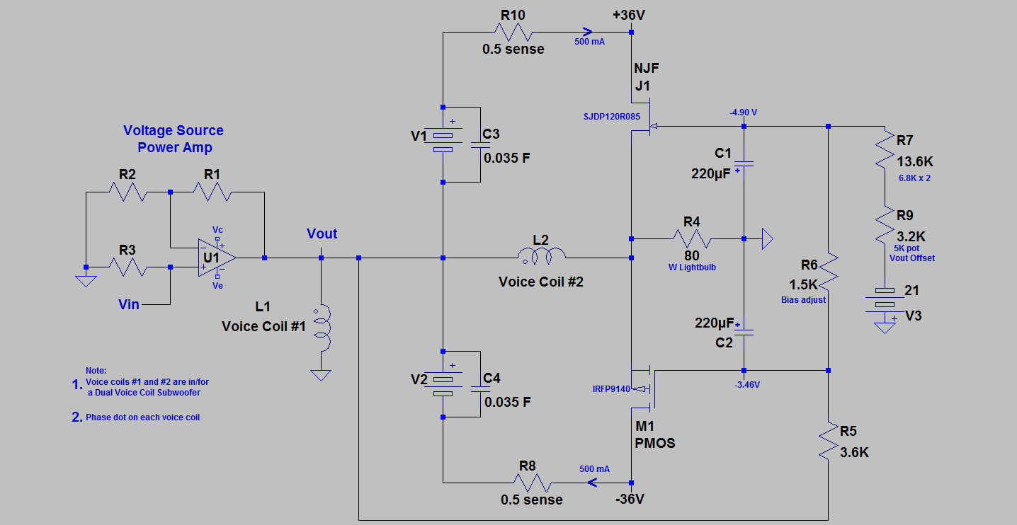

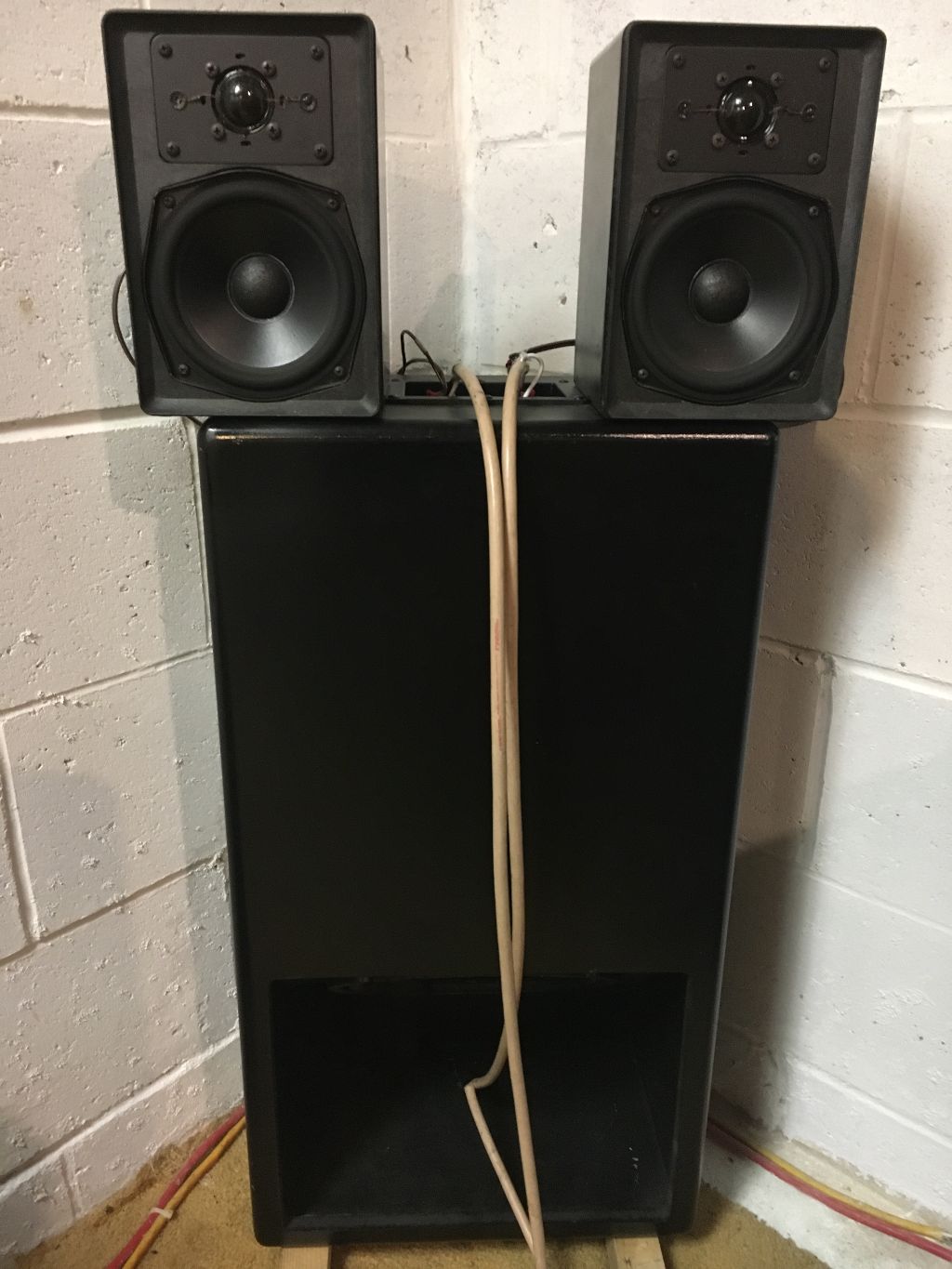

Listening application of a DIY DEF amp.
This post is the application part of the DEF power amp which I have already mentioned in post #291 of The DEF thread by Mr. Pass. I'll cut to the chase and describe:
1. The listening [unfinished] room in the basement of the home. It is 20 feet by 20 feet by 13 feet high. The diagonal on the floor is ~28 feet [corner to corner] and corresponds to one 40 Hz cycle. This 40 Hz is [per the Pass patent ] the gravest of these resonances [meaning standing waves]. This hobby room has useful clutter fill which is most probably beneficial for scattering sound.
2. A picture of the application loudspeaker is attached. This loudspeaker system sits in a corner. The big box is a Dual Voice Coil subwoofer once supplied by MCM Electronics. The diameter of the driver is 10 inches. It fires at the floor at a 45 degree angle towards the opposing corner[28 feet away]. There is a dual two-way crossover inside its box. Its spec are unknown but can be measured. Each 8 Ohm voice coil and its high pass section are independent from the other. The satellites are 4 Ohm A/D/S/ L300.
3. The attached schematic is for the power amp using DEF wired in common gate configuration. This style amp has informative background posts in the DEF thread. I'll show pictures of the Voltage Source and the DEF Common Gate amps in the next post.

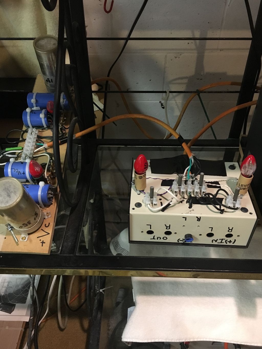

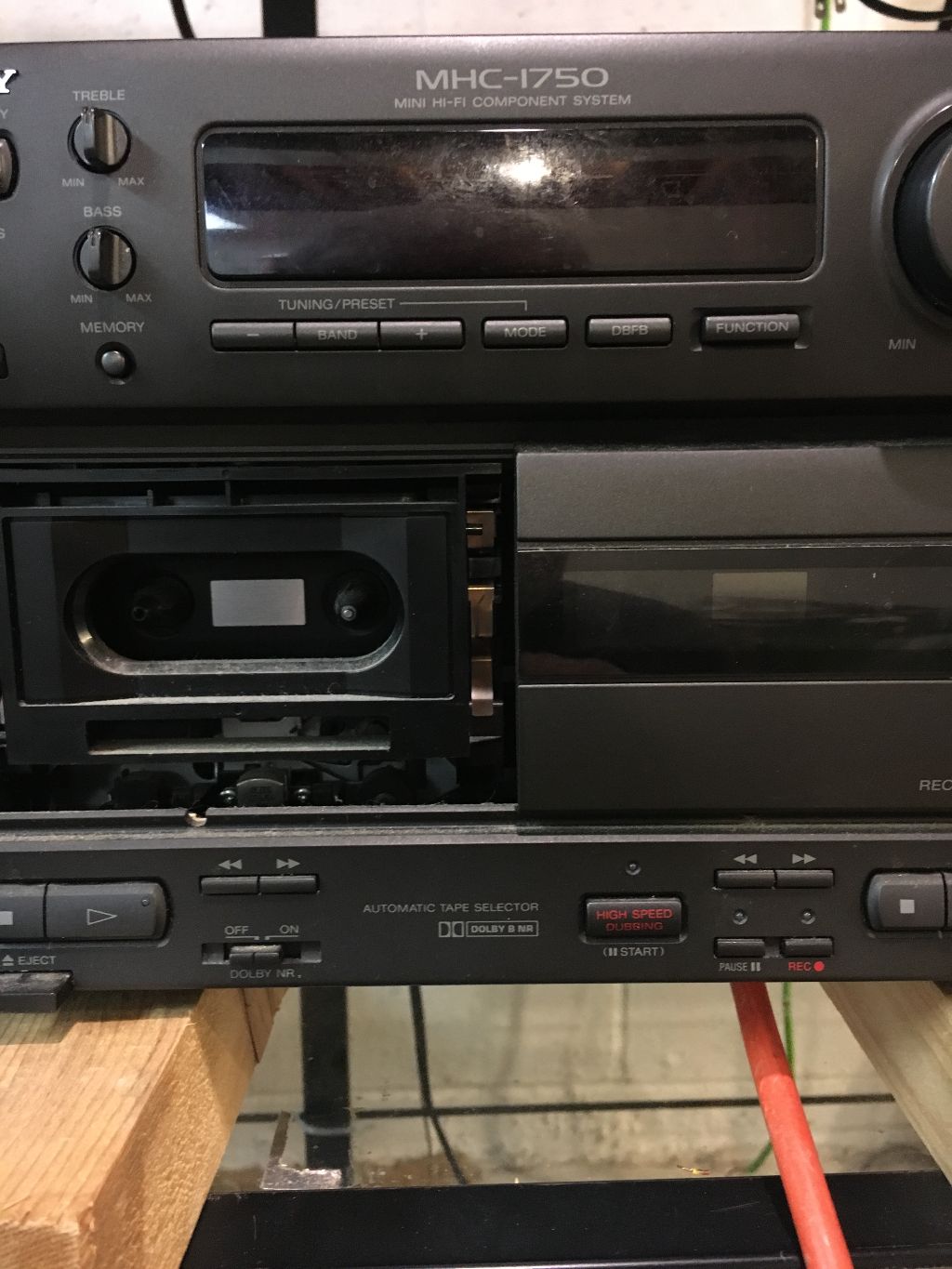

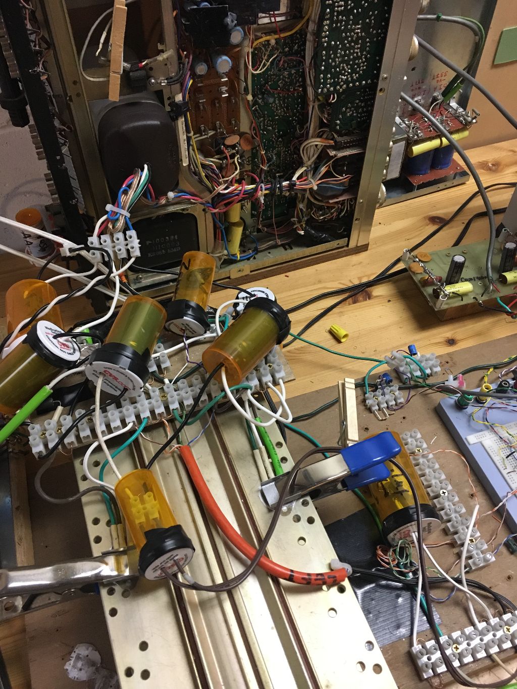

The prototype power amp
This post shows and describes the Voltage Source Amp [VSA] and the DEF amp [DEFcg] which are in the attached and same schematic I showed in the previous post.
1. DEFcG is shown in the far left view. The FETs are clamped down on the tunnel heat sinks. A fan in the back of this heat sink moves air through it and out. The plastic pill containers house PSU electrolytic caps, fuses, etc. The +/-V PSU of a spent radio receiver [back of the picture] powers DEFcg. The AC voltage on its power cord goes to a variac which then adjusts the rail voltages to DEFcg. The bias to the FETS [Vgs] is always turned on before the power rail voltages are introduced and increased.
2. The power amp inside the pictured SONY MHC 1750 is the VSA. Its stereo power amp is built around an STK 412-770E thick film/hybrid chip. Its power rail voltages are +/-30 Vdc. I augmented its internal PSU's storage capacity with 2 external storage banks of electrolytic caps which are shown in the right view. The value of the external caps per rail is 0.05 Farad. The caps are slowly charged up through a 5 W/125 Vac light bulb [cold R ~280 Ohms] by using the SONY's PSU via a 3 conductor red cord. After 5 minutes, the 2 terminals of each light bulb are manually shunted/shorted across so as to expose the full capacity of the caps to the STK 412 power amp. This action is quite effective because I'm dealing with some mean bass energy in the listening room.
The loudspeaker system from the previous post is connected as shown in the schematic. The VSA and DEFcg are independently turned on while joined as in the schematic. SONY has a mechanical relay in series with its music power output which is enabled by switch [top left of unit called standby] and is a great precautionary feature.
The overall special power amp [OPA = VSA + DEFcg] is stable.
Notes
1. In any study, one needs a control amp for acoustic comparison. The L and R channels in SONY are the controls. One channel drives one coil of the subwoofer, and the second channel drives the second coil. The music input signal [Vin] to both SONY amps must be the same/identical. So, one gets a reference sound.
2. By contrast, OPA is the test amp. Its sound in the same loudspeaker system is the subject of comparison with that of the control.
Notes

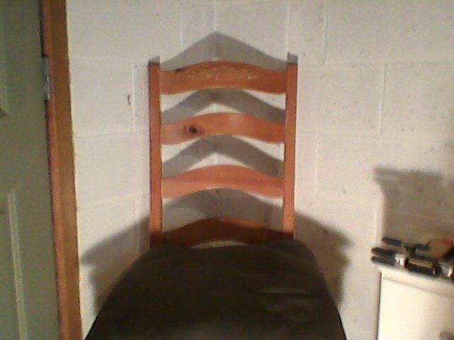

Two important details
1. My listening position in the room which I have already described. It is in/at the corner opposite to the loudspeaker system which is 28 feet away along the floor diagonal. Any room corner is already known to be acoustically filthy. So, this listening application is an acid test to my subjective experiments which have an objective to determine the acoustic value of the sound system. I have a pic of the chair in the corner. I can also sit/squat on the floor in the same corner, and I can lay down with my head close to the onset of the Cartesian coordinates of this corner [loosely the epicenter of the acoustic filth].
2. The music source [Vin] is the headphone output of a SONY CDP-515 CD player. I use the R channel, and its volume is controlled remotely.
Here are the 2 important perceptions from auditioning music [played in mono] as described:
1. Music played by using the Control Amps in SONY MHC 1750 [described in the previous post] was not a satisfying experience [could be torture]. The bass was deep, mushy, and heavy. Tiresome.
2. Music played by using the Test Amp [OPA from the previous post] was a very satisfying experience. The bass of this sound system was deep, detailed, and tight. The performance of the satellite speakers was brilliant. Something good is going on; because I'd sit for 1 hour plus during several tests and enjoyed the resultant immense and alive-like sound.
Why? I have a plausible explanation which I'll post next.

1. I am a Bass Trap when I sit in the corner and listen to music. My muscles, some adipose tissues, and the garments I wear are naturally absorbing of base energy. Push comes to shove I may even consider cloaking myself with additional approved bass trap materials to augment the performance of " yours truly" bass trap. I'd say I'll be one funny sight to behold, but absolutely no itchy fiberglass stuff!
2. An error on my part. The longest dimension in my test room is the diagonal from a ceiling corner to the opposite floor corner, and not that on the floor only. The new wavelength of the most offending room resonance [per Pass patent] is ~36 Hz instead of 40 Hz.

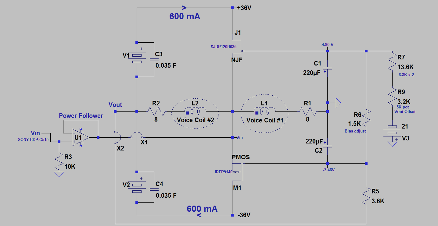

The prototype amp/loudspeaker system which I listened to and mentioned in the previous post was modified and improved. The new schematic is attached. Additional info is found in the last two posts of the "DEF" thread. Please note the following relevant changes:
1. The location and circuit arrangement of the encircled two voice coils 1 and 2 of the dual voice coil [DVC] subwoofer. The indicated relative phase of the voice coils enables Positive Feedback. Positive feedback is preferred in this application
2. The previous voltage source amp [VSA] which has a possible voltage gain = 21 X [say that of SONY MHC 1750 amp] was replaced with a power buffer/follower [see post in DEF thread].
3. The bias or current idle of the FETs was increased to +/-0.6A. The ideal and future bias will best be at ~+/-1.3 A at +/- 23 Vdc . Because it is the primary source of power to the load.
4. The power buffer/follower delivers a small amount of music power to the voice coil #1 of the subwoofer and thus to its satellite loudspeaker. Little output emanates from this satellite loudspeaker. Consequently, this satellite loudspeaker can be replaced with an 8 Ohm non-inductive power resistor [so as to load the internal high pass crossover network]; but without an effect on sound.
What has not changed?
1. The loudspeaker system is the same and is in the same corner of the room.
2. My listening position is in the opposite corner along the floor diagonal [~28 feet away].
Subjective observations:
1. The bass is thunderous, clean and tight.
2. The rest of the audio spectrum is highly detailed. Vocals are intelligible and crystal clear.
3. Could not detect standing waves by walking towards the walls of the room.
4. Listening to this system for an hour+ was a satisfying experience. And that is my objective
5. This music system is stable against oscillation; provided the power buffer to its input is connected [see the last 2 posts in the DEF thread].
More to post on absorbing acoustic trash in the listening room...
Best
Anton

Thank you yentzee and oreo382 for your posts. I hope that you experiment with this set up. One's ears are the final and sole judge..
While I trust my ears to some extent, I trust a propper REW before/after meassurement even more.
Some day I might even build this one here and then I will surely post some of the meassurements here.
Hello Schlumpfpeter and thanks for your post. Mr. Pass [and others] do encourage DIYers to experiment and to test [personal] or their hypotheses. How else can I unravel possible sonic/subjective improvements? I continue to experiment with the subject matter. IMHO, minimizing standing waves [SW] and their impact in my listening room is the last frontier to conquer; but with an additional enhancement. I hope that you and others:
1. Had the opportunity to experiment with the remarkable DEF circuit of Mr. Pass. A gem!
2. Noted in my posts the suggested and evolved hypothesis to use any loudspeaker in the corner of the listening room so as to enable it to do double duty [like a bat]. Send high fidelity music to my ears and simultaneously "suppress" the returning [SW] echoes. This approach will also free space in the room for "dancing" from absent expensive loudspeakers which can be toppled over as lovers sway back and fro.!
Best wishes
Anton

That is indeed, a very interesting idea, to use the speaker itself for the cancelation of the standing waves. Only thing which comes to my mind is that you would need to have a speaker using a double coiled subwoofer. I don't think that those special SWs are that common, at least I haven't seen one.
Is this schematic specifically designed to work with a dual coil speaker and the amp you mentioned or would it be possible to use this schematic but instead use any amplifier and get the "modulating" signal from an electret sitting in front of the sub, and feeding the signal after preamp into the circuit where the coil from the sub is located?
