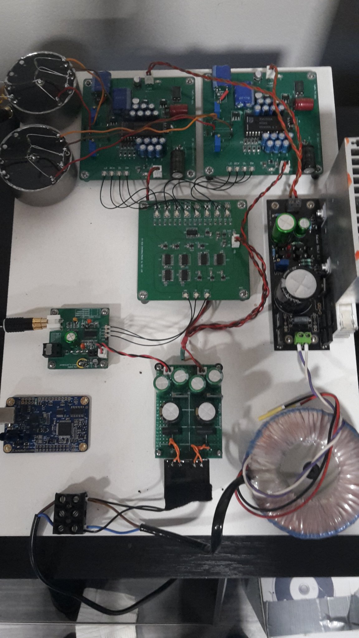

Hello, I'm still continuing to build a DAC, I use supercapacitors and +5-5V power lines LT3045 smoothed 2x supercapacitors 10F in series, the green ones, I would also try the batteries but I don't know how to connect and charge them, for now I'm playing SPDIF, USB is ready, the output is bisesik transformer.
That’s great to hear. I built the ACA mini and am running it in on a 6s lipo and it’s just amazing sounding.I also enjoy the D3 for a long time now. Thank you once again to Ryan for all the work he put into this DAC. To be honest, most of the mods i made to this DAC were removed again, because the difference was not big enough for me. What stayed is my battery PSU with LifePo4 Batteries. This was really a game changer for this DAC. It sound even better now. Of course 22 LifePo4s are a bit overkill, but i wanted to have all the voltages battery based and I receive the batteries very, very cheap... The only thing I didnt try was the supercapacitors, perhaps I will try it in the next months.
https://www.diyaudio.com/community/threads/pictures-of-your-diy-pass-amplifier.166784/page-327
Your setup looks very good! I do not think the hassle with batteries on 5v will give you a worth while improvement, especially because you will need a regulator behind the batteries to produce the 5v and you already have the ultracaps on the boards.Hello, I'm still continuing to build a DAC, I use supercapacitors and +5-5V power lines LT3045 smoothed 2x supercapacitors 10F in series, the green ones, I would also try the batteries but I don't know how to connect and charge them, for now I'm playing SPDIF, USB is ready, the output is bisesik transformer.
Nice to see you are using the ultracaps, did you compare with the oscon? I would like to know if it is worth while.
is your IV resistor on the secondary side of the transformer?
Hi, I'm using ultracap as recommended by wlowes, sometimes they charge for about 1 minute when turned on. The sound seems better to me, I can't judge 100%. I use resistors on the primary and secondary for the transformer. I'll try buffers and another transformer as recommended by bisesik.
I thought 2 transformers per channel. I play on WLS2018 and F5. The sound is nice analog, I listen all day and it doesn't bother me at all.

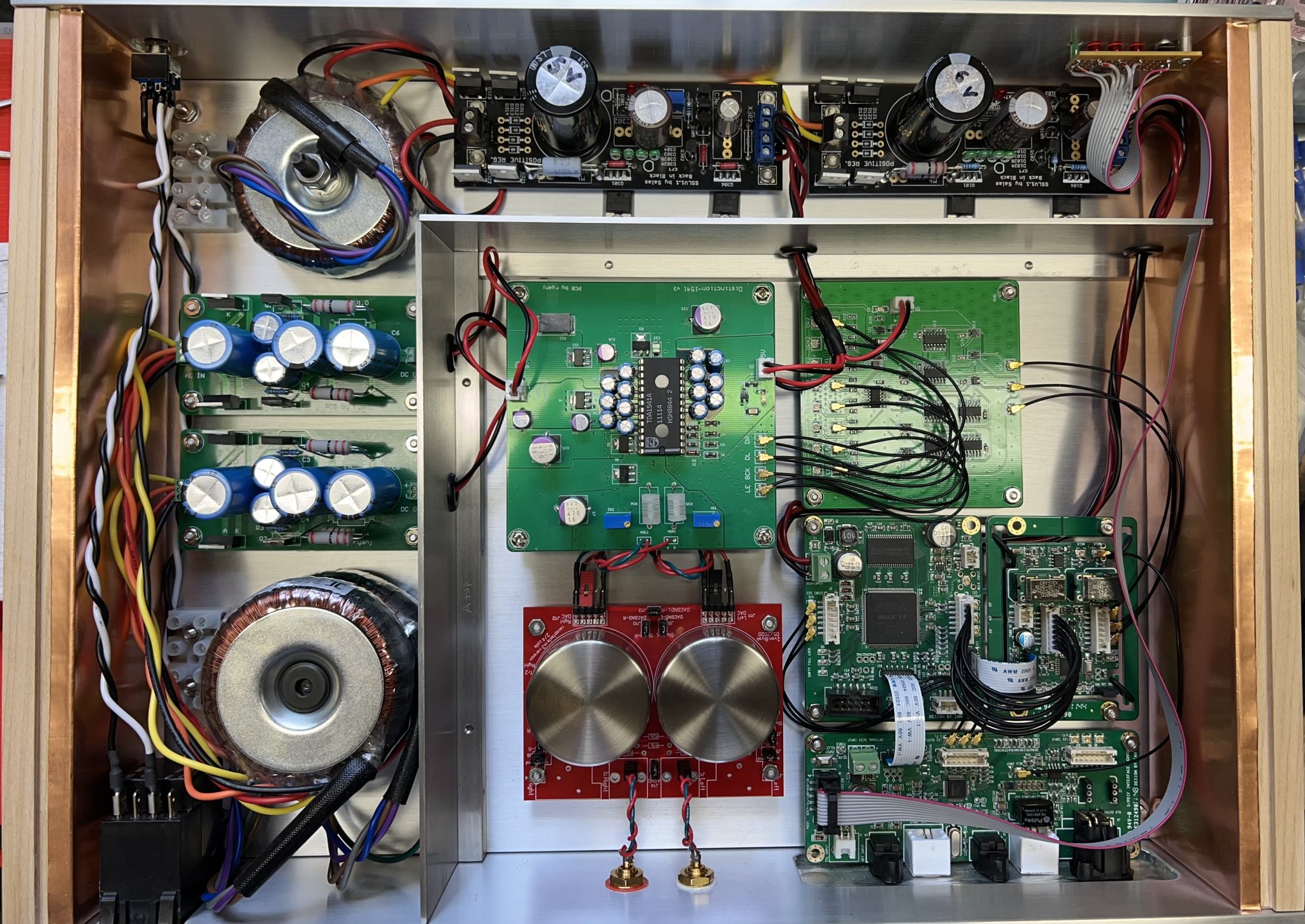

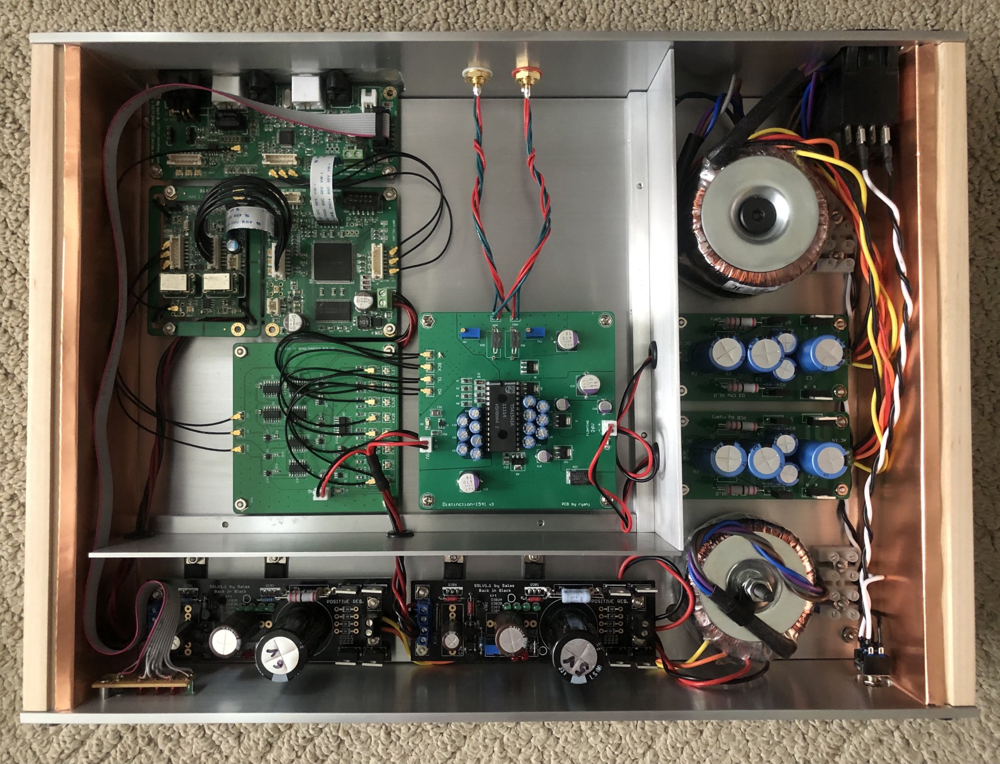

Hi everyone
I’m coming back to this D3 project after getting mine operational towards the end of 2020.
Essentially, I spent a year learning enough and working with Ryan and others to be able to assemble my first DAC Based on his D3 boards.
I’m still using IanCanada’s original S/PDIF Interface board and Asynchronous FIFO with upgraded Crystek clock board I picked up second hand.
I’m feeding the signal on to Ryan’s V2 I2S to Simultaneous board and then to a pair of D3 boards.
I have separate D3 CMx based power supplies for the D3 boards and a couple of Salas SSLV1.1 boards fed by another transformer providing other necessary 5V and 6V supplies needed for the boards.

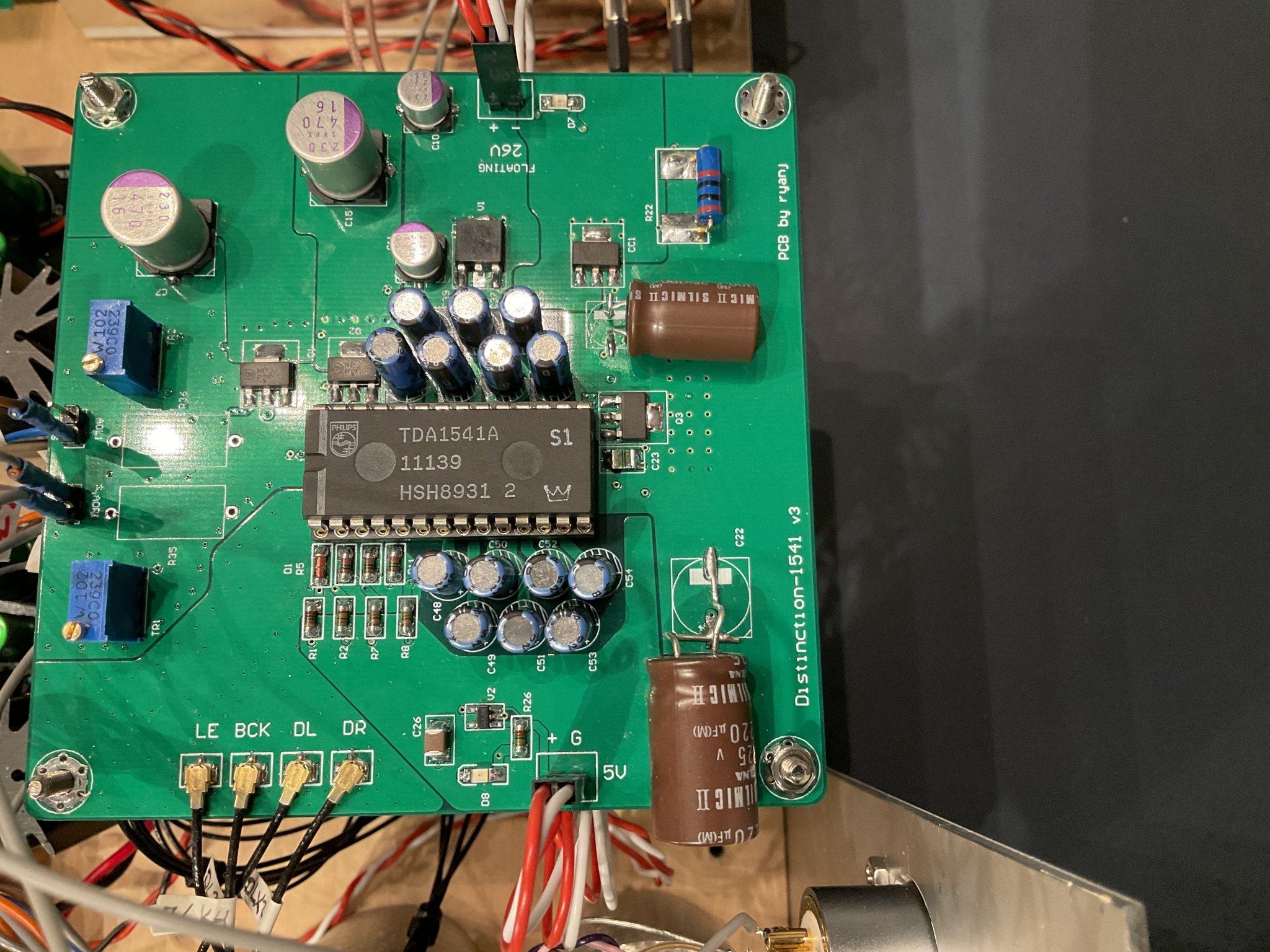

What I can say is that I have re-examined the connections between my V2 I2S to Simultaneous board and my D3 boards.
I am not using any of the inverted signal connections for the “DR” or “DL“ signals running to my D3 boards.
I have the “DL1” and “DL2“ signals connected to “DL” and “DR” respectively on my lower D3 board.
I have the “DR1” and “DR2” signals connected to “DR” and “DL” respectively on my upper D3 board.

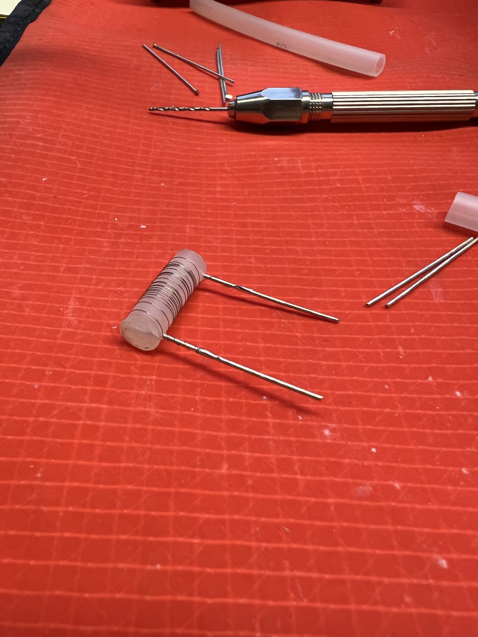

While I try to figure things out with the signal routing and transformers I took a shot at winding my own resistor. I figured I’d shoot for a 50 Ohm resistor.
I’m working with some Constantine wire that is 40AWG and stated to have resistance of just under 30 Ohms per foot.
I did a little math and came up with just over 20 inches of wire.
I built the resistor using some rigid plastic water supply tubing, left over component legs and a hot glue gun.
I managed to come up with a 51.7 Ohm resistor…inside a 5% tolerance.
I’m not sure the exact resistance value matters as much as being able to produce a second resistor for the other channel that matches it as closely as possible.
Done…I figured since I wrote a novel to myself I might as well have a happy ending 😁
Thanks to bisesik and all his patience and feedback in the DAC transformers thread.
I now have a beautiful sounding DAC…with as much gain as I could need…and it sounds much better than my old Rotel RCD855 that started this journey when it gave up the ghost several years ago.
Revisions were:
Rewire I2S to Simultaneous and D3 boards for balanced/differential signal transfer.
Replace iv resistors with hand wound Constantine 25 Ohm resistors.
Pull iv resistors from secondaries on transformer boards.
Rewire D3 output to transformer connections for differential/balanced signal.
Only troubleshooting was with the jumpers at J11 & J12. Had them wrong first time around which caused buzzing (thanks again bisesik!)
Revisions were:
Yes indeed Constantan…pesky auto correct…I ordered some a while back off of fleabay.
After bisesik helped me do some calculations, I decided to lower the value I wound based on what voltage I thought was needed to work with my system.
The 25 Ohm value seems to have gotten me there while helping keep THD in check.
