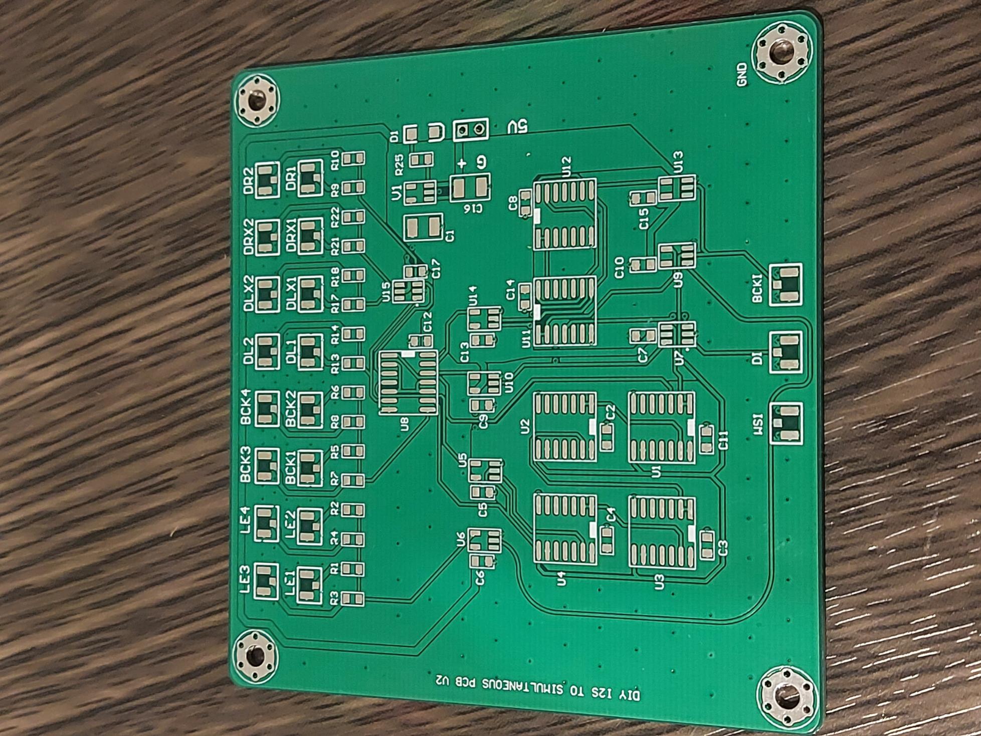

Hi all,

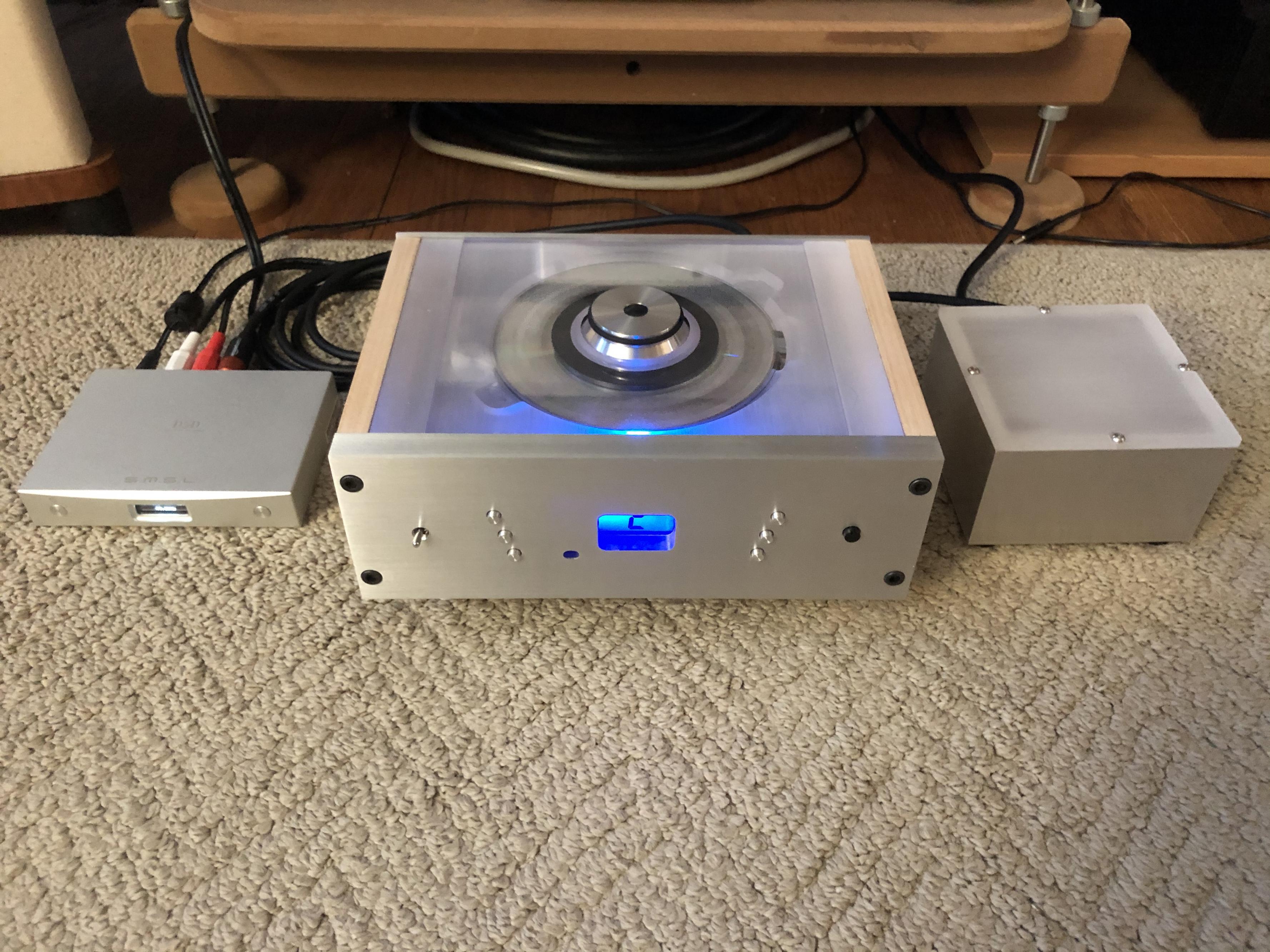

I’m ready to move forward with my D3 after finally sorting out a Shigaclone transport project.
I’m glad to finally have a functioning digital source again after struggling with my failing Rotel 855 for a while. I do still miss it and the sound of its TDA1541A.
This is my first DAC project. I’m temporarily using a SMSL M8 with the transport as a band aid for now.

I ordered the D3, I2S to Sim and Cap Multiplier boards assembled from Ryan this past Xmas. That way I have known tested/working boards.
I won’t be using the I2S to Sim board to start with as I don’t have the extra U.FL coaxial cables to connect it on hand right now.

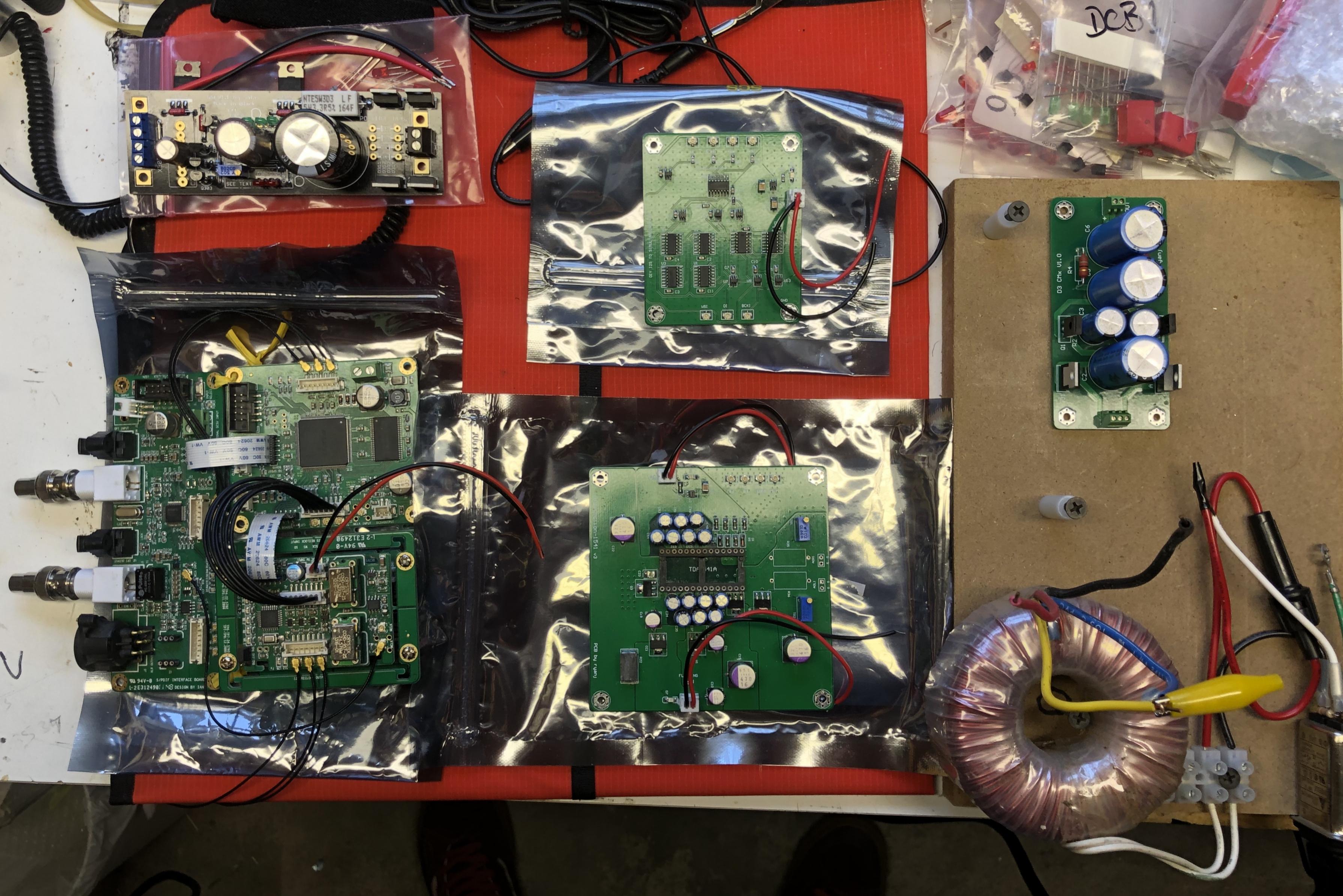

I’m starting with getting the basics of the power supplies sorted.
The main FIFO board requires a 6V supply, whereas the SPDIF and reclock use 5V. However, as far as I can tell, the main FIFO will power the SPDIF and reclock boards with the option of seperate supplies for all three. I will be starting by powering everything from the FIFO so I’ll need one additional 6V supply for that.
While building my Shigaclone I had attempted to utilize a Salas SSLV as a power supply. Unfortunately, the current demands of the transport while executing the TOC read process required me to set the SSLV so that it was producing almost 800ma. It became unrealistic for me to properly sink its transistors and still have a fairly compact supply design. I resorted to a simpler design using a LM7808 equivalent.
So I have one functioning SSLV that I can reset the current on and adjust the voltage to 5V for the D3.

Both SSLVs will be powered by a single Antek AS1212 with dual primaries and secondaries...one for each.

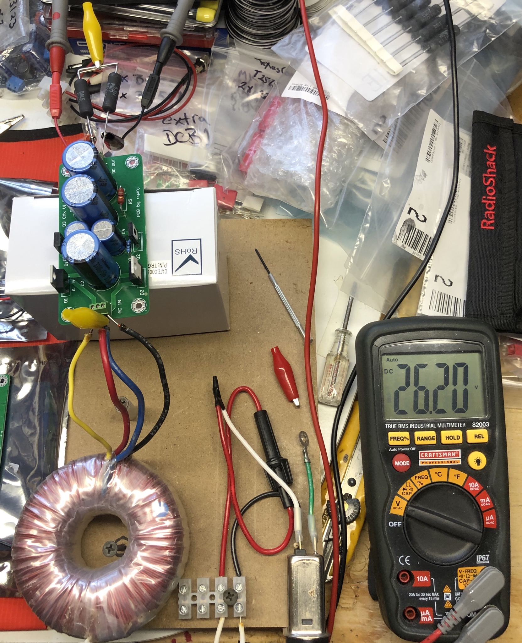

I’m currently trying to set up and test another transformer I have on hand with the hopes of using it for the 26V on the D3. It is a surplus unit I got from ApexJr. It has a single primary and dual secondaries. It produces about 25.5 - 26V AC per secondary unloaded depending on time of day and mains voltage.
Since Ryan designed the cap multiplier board for a 24V center tapped unit I wasn’t positive as to the proper hook up.
A search turned up some discussion earlier in the thread about tranny wiring to the CapMx and voltage testing with a load on the output as well as testing voltages on the D3 before installing the 1541.
Markos4553 posted that he used a Triad Magnetics VPT48-520 on his project and showed a pic of his test bed.
I had recently used some of the Triad transformers for the Shigaclone and a phono amp and recognized the color coding of the wiring. I looked up the data sheet and it appears he wired the secondaries in series and used the connecting point between the two secondaries as the center tap connection.
Other research online points toward this method of using dual secondary transformers in center tap applications like this.
In my application, wiring the secondaries in series would give ~25.5V across each secondary to the center tap point where they are joined and about 50V across both secondaries.
I just want to confirm this is the correct way to wire this transformer to the CapMx.
I realize I will have to also test voltage output with a load and through the D3 and that this transformer may come up a little short.
I am hoping I can reduce the value of R4 and R5 on the CapMx to get the 26V I need.

I had some time this afternoon, and was feeling cocky, so I wired the surplus tranny up to the CapMx with the secondaries in series as I described.
I put two 100 Ohm 5 Watt resistors in series on the DC output of the CapMx and gave it a go.
Voltage stabilized at just over 26V.
Pure dumb luck!

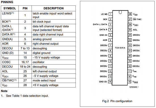

I guess the next step is to set up a SSLV for 5V and then test for correct voltages on pins 15, 26 and 28?
Pure dumb luck!

Hi chromenuts,
I've tested all the voltages and i've had your board playing music with the i2s2sim PCB, dont power it up without a 1541 chip installed or a dummy load. If you want to use I2S first without converting it then you will have to change the jumper setting on the back of the D3 PCB. The SSLV should be a good choice for the 5V supply.
