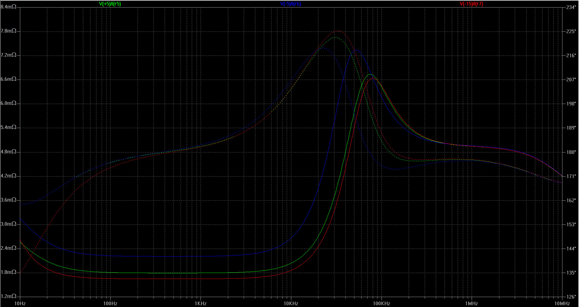

The -5 and -15 supplies are actually a -5 and -10 stacked in series to get the required voltage of -15. I know its kind of odd and unconventional, but it works really well. Its also simulates really well. Basically the whole PSU is working in parallel with the 1541 and providing a very low output impedance in the audio range of around 2mΩ.
Ill attach the simulation.
