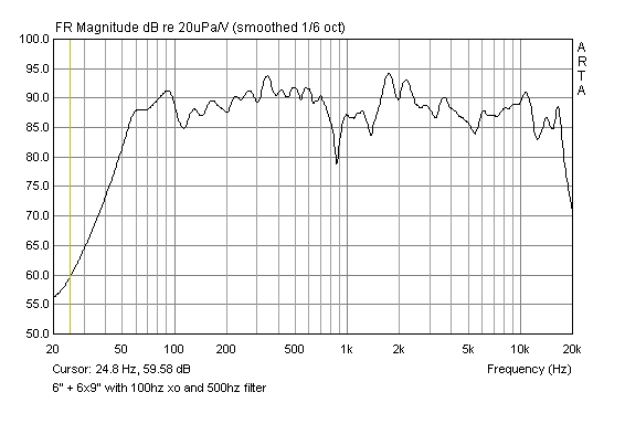

Please don't hold your breath, but I may still have the EA design for the Magnavox 8-30, and 8WR with the 3TC (?) tweeter. The Rola and Maggy 8 inchers should be fine on OB. These drivers should respond well to cone treatment. Consider helper on OB also. I have started on a new OB, with the option of going to a cab for the the bass below 100Hz. The box is not needed. The pic shows the response at present, with no bass compensation on the SPL meter.

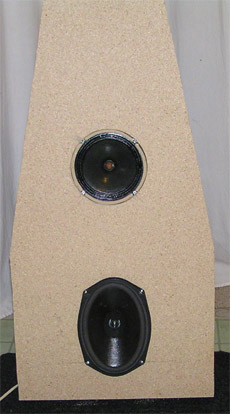

The 6 and 8" Rolas should be fine on OB. I know the 12" dual cone ones are good on a 5 x 3 foot baffle. The main drivers on my current project are Panasonics from the 70's, with cone and surround treatment, and extra magnet. For best top end, a curvilinear cone is better, preferably without a whizzer. I'll post details at a later date.
IIRC, the Rolas have a straight ribbed cone, the Magnavox were curvilinear, as were MSPs.
The Visaton baffle will be fine, however, the B200 is a great driver, don't expect that performance from a Magnavox. Great if you do get it though.
My baffles are 900 mm high. The bass is much better than expected.

When you mention baffle size do you include the side panel dimensions?
And what is that oval bass driver and where did ya get it?

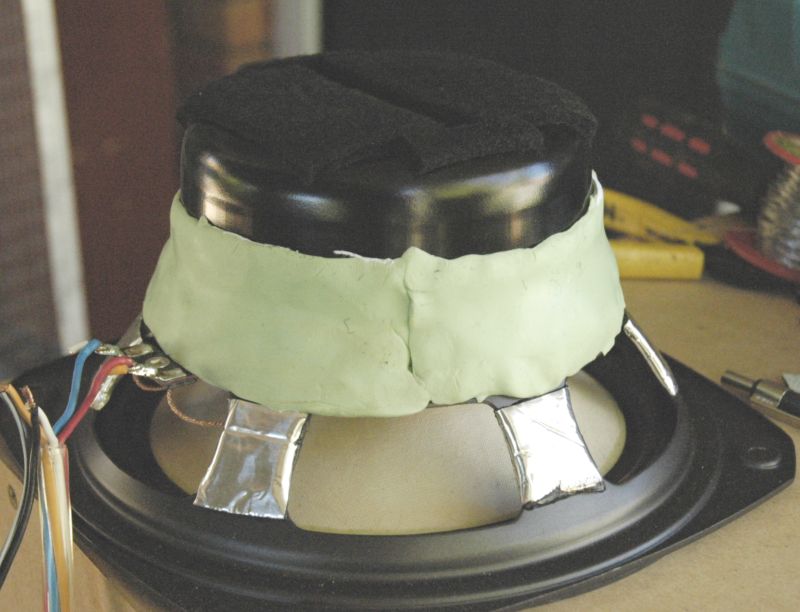

Hi Ozziozzi, most pressed frames will ring when held by the magnet, holding by the frame, the ring is reduced to a metallic thud. No one up here has duct seal, so I'm looking for an alternative.
The old mags are in the packing shed I think. With all this rain, I probably won't get into that before the weekend.
Geoff.
I used 'Power Tack" which comes in a yellow packet, It might be Marbig brand. $1.99 a pack from the supermarket, firmer than blu tack and hard work to knead but you don't need to, just cut it to size with the wife's best dressmaking scissors and stick the flat pieces on. It is packed in a single sheet in the pack instead of 4 or 5 strips. About 2 packs per driver.
Jaycar sells foil backed bitumen sheets, 2 square feet for about $20. it goes a long way. Driver bakets are now duller than test cricket. 🙂
Geoff, you are right about holding speaker by mounting flange. This does naturally dampen the whole basket, but what the heck--damp the basket anyway right? It can't do any harm. One thing that hasn't been mentioned in this thread is to wrap the speaker magnet in felt.
I would careful of "Bluetac" and its mate "Yellowtac". I have found that Bluetac dries out slowly by losing its oily solvent and becomes slightly brittle and then falls off. it takes a while, but it does happen.
There is a another white tacker called Postertac from the same company (Selleys I think) who advertise that it "Does not leave oily residue on valuable posters or artwork--perfect for light coloured walls, does not dry up etc" or words to that effect. I suspect THAT might be better. Of course there is always Plasticene modelling clay (from toyshops) or its modern equivalent which is edible and non-toxic for babys sake ;-)
I bought a paint on body deadener from Supercheap (or Autobarn) called Brush On Sound Deadener. MOTOSPRAY brand. This is a bitumenlike goop loaded with a heavy barium mineral. A litre of it weighs about 2Kg. It dries to a slightly tacky surface that might also be useful for attaching some other treatment. A few coats is supposed to stop car body panels vibrating. Only problem is the solvent needs to evaporate before you seal up the boxes. It smells a bit like turpentine for 24 hours.
One other sound treatment I have used succesfully is rubber computer mousemats. These are made of black closed-cell, high-density foam with a smooth mousing surface on one side and a rough texture on the other. They vary from 2-3mm up to 8mm+ thick. These are usually thrown away because optical mice don't need them. I have cut them up for speaker mounting gaskets, enclosure wall linings and into strips for speaker frame damping.
