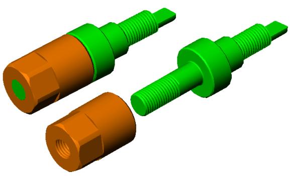

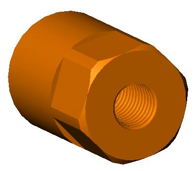

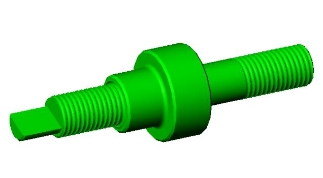

Here are my plans for a DIY speaker binding post. II can see questions being asked as to why DIY such a thing. Especially when a pair of Cardas is available for $25 or so. Yes, but not so in India. You have to import the stuff and pay custom duty etc that will push the cost to stratospheric limits. So here we are, a quality binding post for less than Rs. 100 each (around US$ 2).

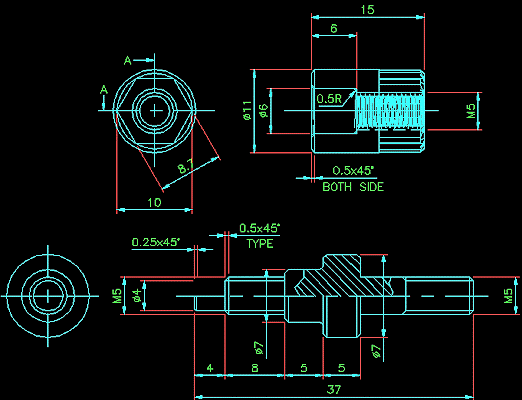

The material will be pure copper bar. I am thinking of either gold or silver plated, but I suspect bare copper will sound better. A pair of them will be mounted in a 2” x 3” insulated acrylic board. All machining will be done in a CNC. I am also attaching the CAD drawing if anybody is inclined to play around.
Comment please

We never bother to model threads as the rendering goes all choppy when you rotate, pan, or zoom.

The Nut will have nurling edge. In the rendering I've missed out the retainer nut for the inside. But I need to know if the basic design is ok. Have never seen a Cardas.

Quick suggestion maybe. On the shaft... i noticed it's completely round. What you might want to do...is make that biggest diameter HEX instead of round so that you can attach a wrench to it when you are securing the shaft from the inside. Otherwise...when wrenching a bolt on from the inside...you won't be able to grab it easily.

Mattyo5 said:.... make that biggest diameter HEX...
Yes that did cross my mind, but I wanted to keep minimum number of operations. Perhaps I can grab the shaft with plier while tightening it.
EEEE...pliers on copper....eee. Um...you'll scratch up beautiful posts. Just get some hex stock. Shouldn't be THAT hard to find. If you get hex stock, just turn the rest down to whatever diameter/threads you need

actually hex sounds better...will implement it...

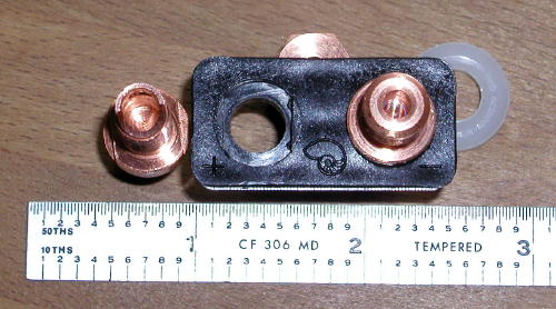

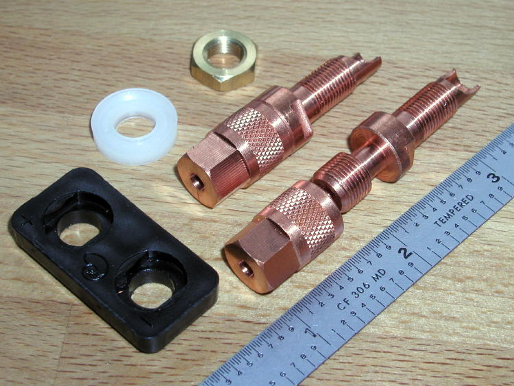

If it helps, here's a closup of Cardas most popular posts. I don't know if plated or bare copper sounds better, but for myself I usually stay with bare copper. As long as you have spade cconnector lamped in a clean post, oxidation sholdn't be a problem in contact area.

Ahhhhhhhhaaaaaaaa.........thanks soooo much..you are my main man Peter. That pic definetly changes many ideas I had. Time for modifications.

I request more help from you.
- From your pic it appears that the length of the shaft (exculding the nut) is 1.5". Can you confirm that?
- Is there a thro hole in shaft?
- What is the dia of the shaft and the stopper?
Thanks for your help.
The length of a shaft is 1.630". In a shaft, on a nut side, the hole is 0.154" and 0.330 deep. When the nut is on, the hole is 0.540 deep, the hole in a nut is 0.160 and the top of the nut is 0.1 thick.
On a mounting side of the shaft (side which is inside a chassiss) there is another hole, 0.193" diameter and 0.65 deep. This helps with soldering a lot. I know because I trimmed some longer posts and it was really hard to solder without that hole.
Dia. of the threaded part of the shaft is 0.373, the neck is 0.240 and the stopper is 0.50 (which is also the dia. of the nut). The mounting nut looks like 5/16 and the thread is finer than 28 (I don't know what's the next standard value)

speaking of hex stock, You could make the nuts out of hex stock,
Turn down the area that contacts the spades to a round shape.
No need to machine the wrench flats

Hex stock is usually 20% more expensive than a Bar. Besides. I live in a small town and at times its is difficult to get correct items.
But then your suggestion is really clever. Eliminates many operations. Wonder why I never thought of this.
