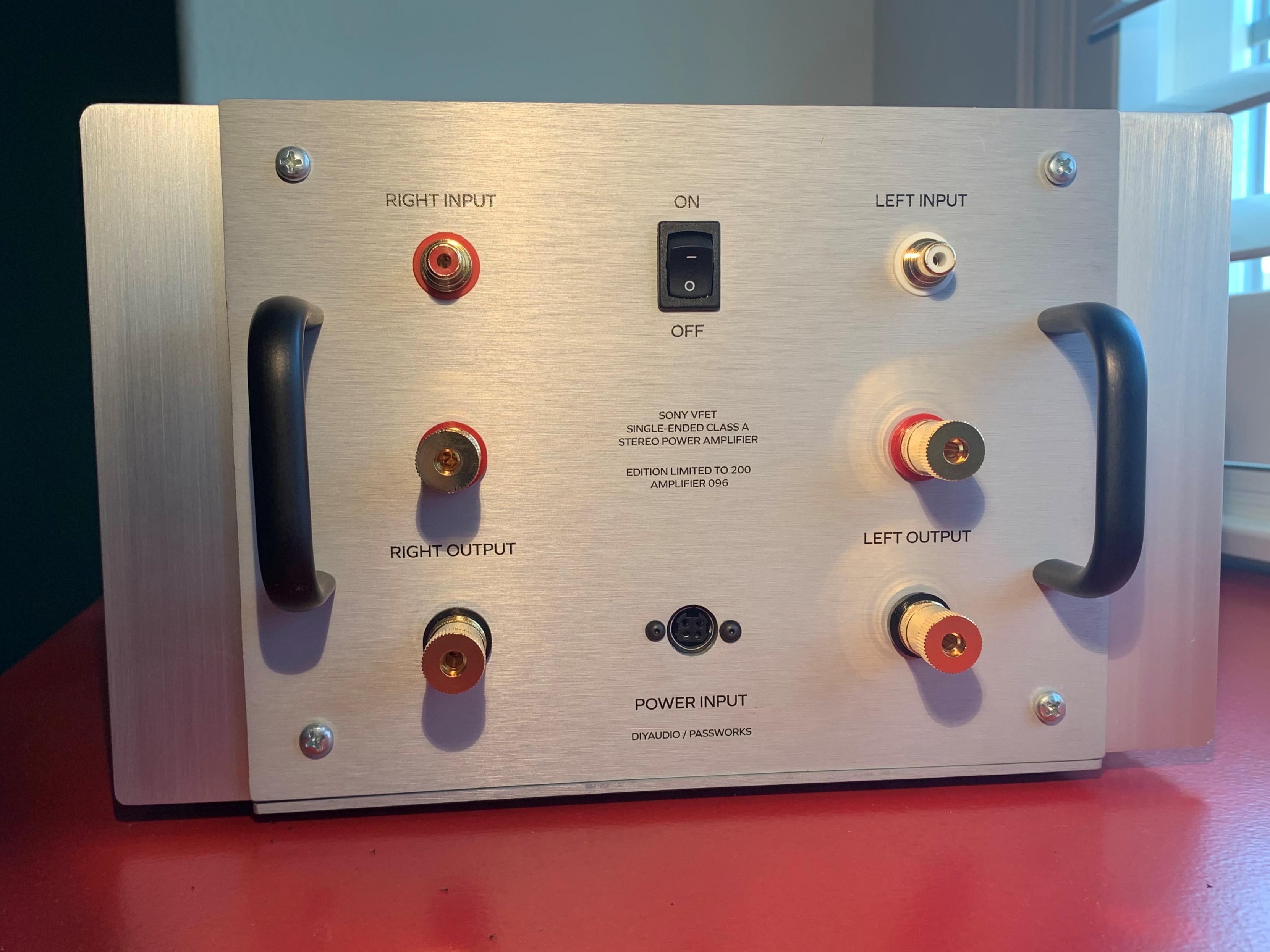

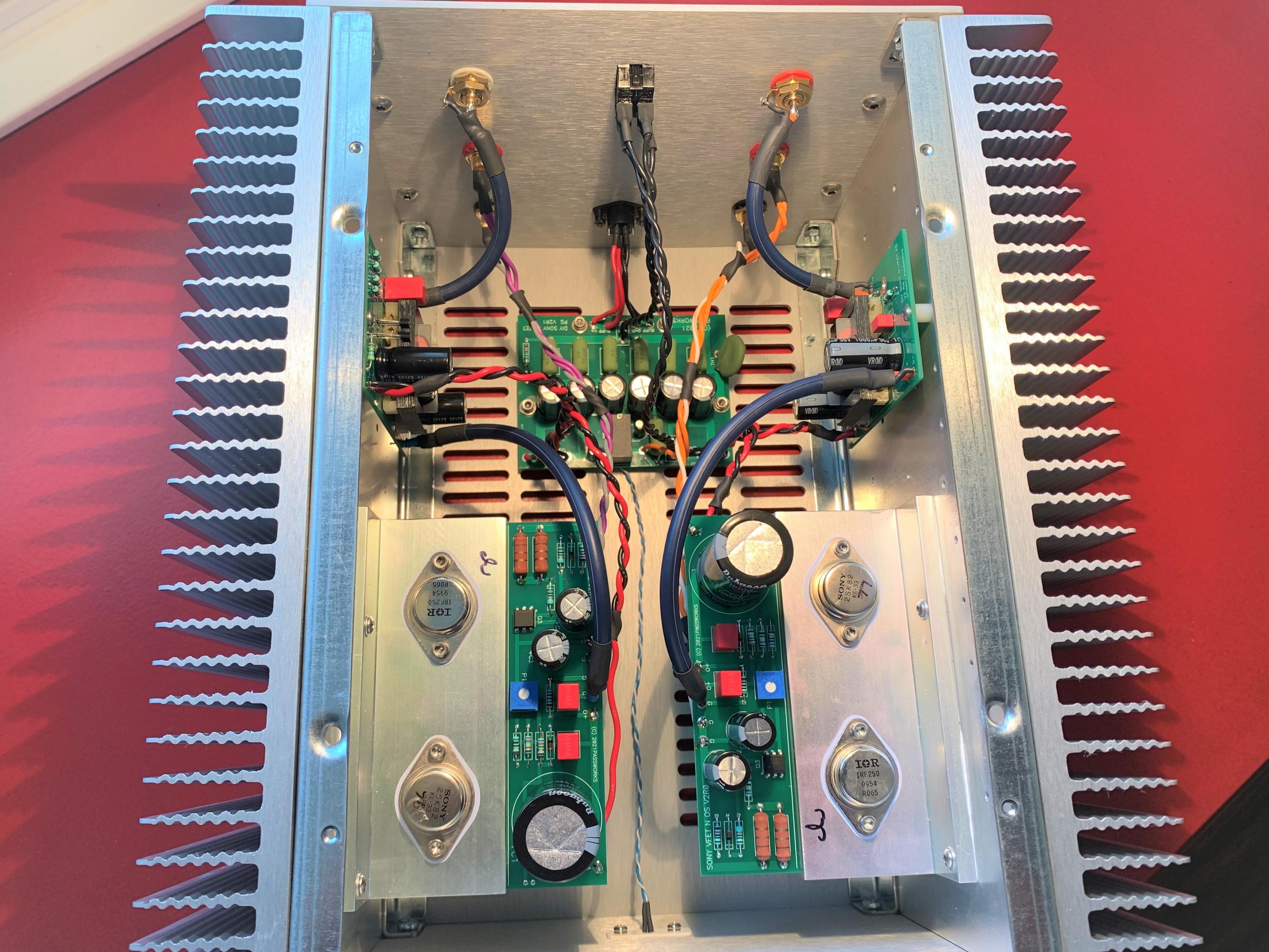

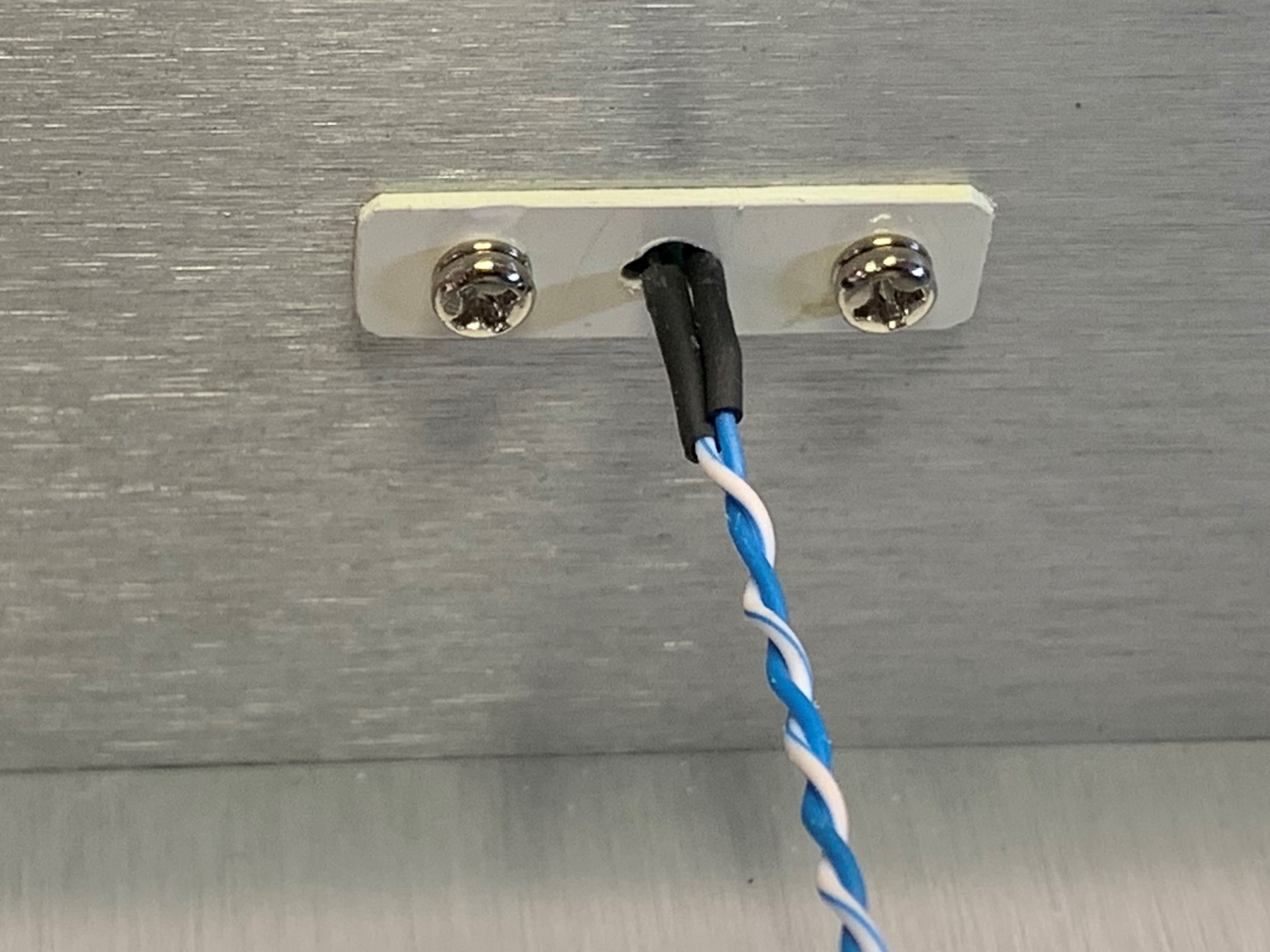

Completed the Sony Vfet Amplifier (chassis 96 of 200). It took me about 16 hours to complete the built including adjustment and lapping the heatsinks for a better fit. All electronics are the stocked items with the exception of the interconnecting and audio signal cables and wires. I also added the black handles at the back for cable and connection protection when pushing the amplifier toward the wall. I also built a simple LED light mounting bracket made from heavy plastic. The only thing left is to install some nice aluminum foots.
No issuers after powering up. Bias voltage was around 12.5 volts per channel. It was adjusted to 14.0 volts after about 40 minutes of warm up time. I connected it to my Tekton Pendragon speakers (rated at 95 db 1W/1M), and the amplifier had no issues driving the speaker at my normal listening level. I’m not good at describing sound but the best analogy that I can said compare to my beloved F5 Turbo, is that the F5 is like drinking whiskey and the Vfet is like drinking wine. They sound very different (at least with my setup and at my music room). The F5 is punchier and faster but the Vfet is smooth and has a very wide sound stage and has a sweet sound to it. It also can handle the bass very well. I enjoy the sound of both of these amplifier with the Tekton Pendragon.
Thanks to Nelson Pass and everyone involved including the DIY community for all the support.

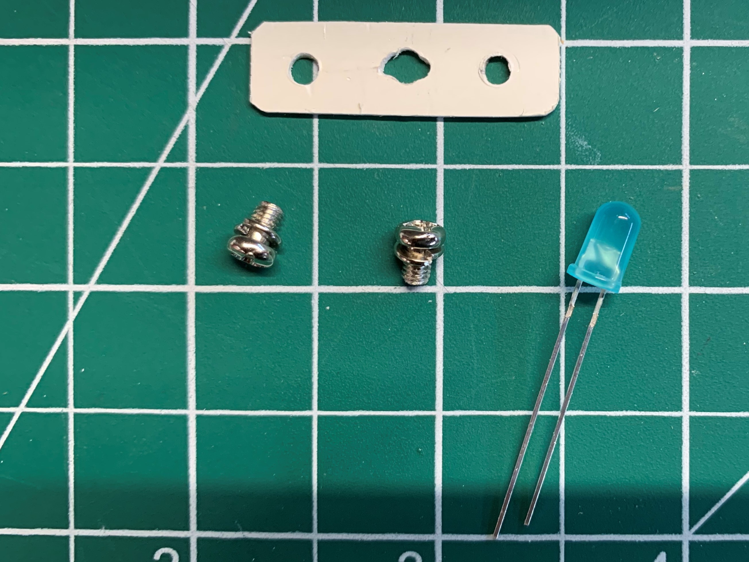

Also how are people securing the LED? There are tapped holes on either side but no hardware.
Same question. I see pics of what appears to be a diamond shaped molded plastic holder. Someone must have a part number for this.😕
jeff
Just a few dabs of hot-melt glue. Chassis hasn't gotten hot enough so far for the glue to re-melt 😀
I find the solution with strip of plastic much more elegant, though.
Regards, Claas
Regards, Claas
jeff
I just built that holding bracket with a piece of scrap of plastic thick plastic that I had.
Thanks. I had the same thing in mind, just wanted to check-in first before I start digging thru the goody box.🙂
jeff

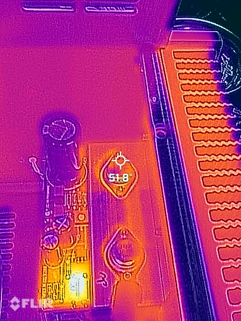

I just finished building #180 and powered it up for the first time today. I smelled something getting hot so took out my thermal imager and found out it was the big resistors on the output board (~124°C) and not the precious VFETs. The resistors on the power filter board were around 80°C, the ambient temperature in my garage was at 25°C.
I sanded my t-rails that the vfets are mounted to because I noticed they were a bit cupped, I didn’t sand my heatsinks like others did. I see about 50-52°C on the heatsinks and the cases of the output devices (after about an hour of warm up time) with the lid on, I removed for the thermal images.
Thermal imaging equipment? Well, I always wondered what FBI agents did on their days off.
Olen
can you show the picture of the thermal imager ? Can you try a small fan inside to see how much the Temperature comes down ?
