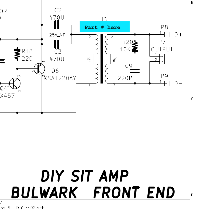

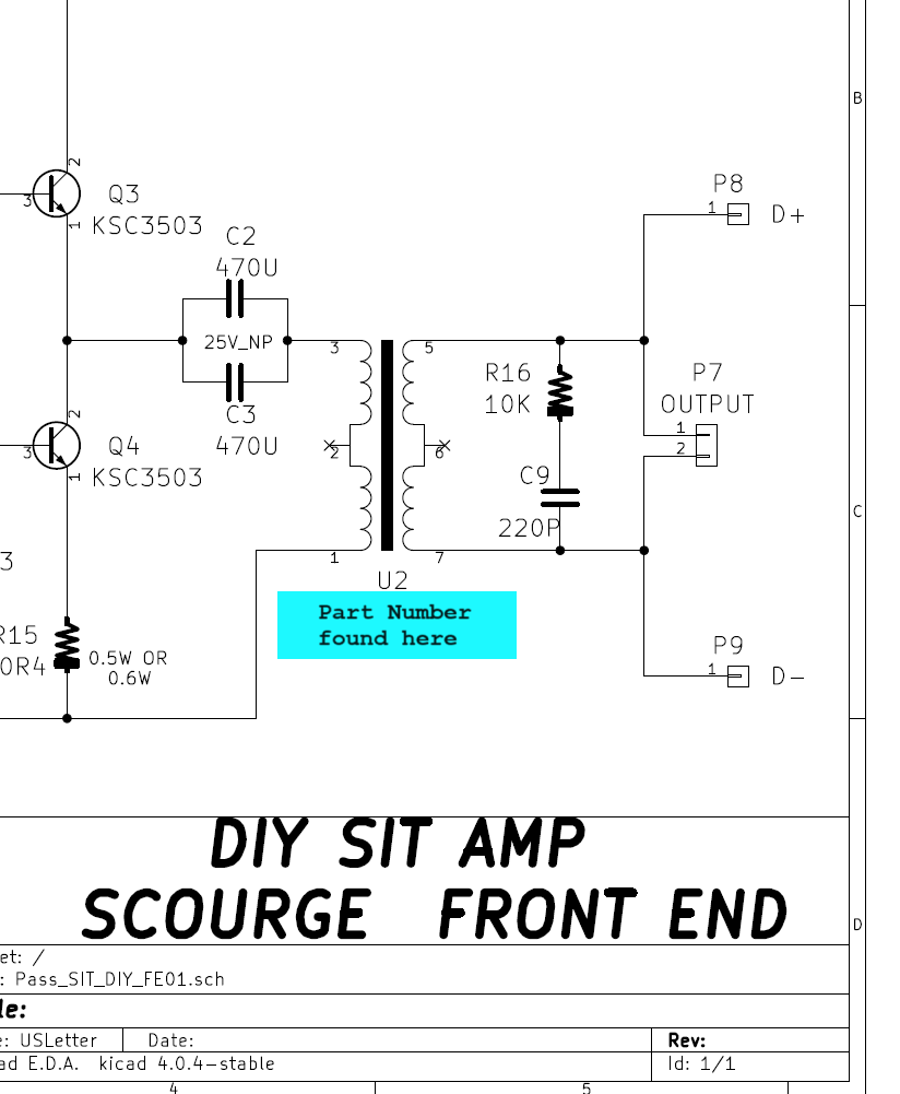

You should be looking at the transformer which is included in the kit-of-all-parts sold by the diyAudio Store.
To find its manufacturer and part number, either check the circuit schematic diagrams designated by the Store (they are attached below) ...
or ...
Check the Detailed Parts Lists linked by the Store. You can answer your own question, two different ways. Have fun!!

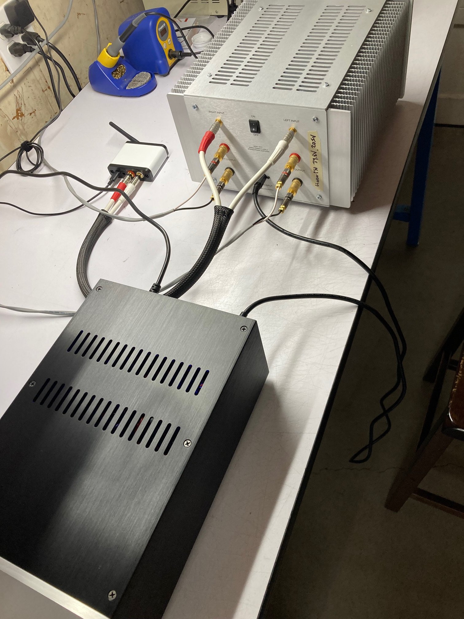

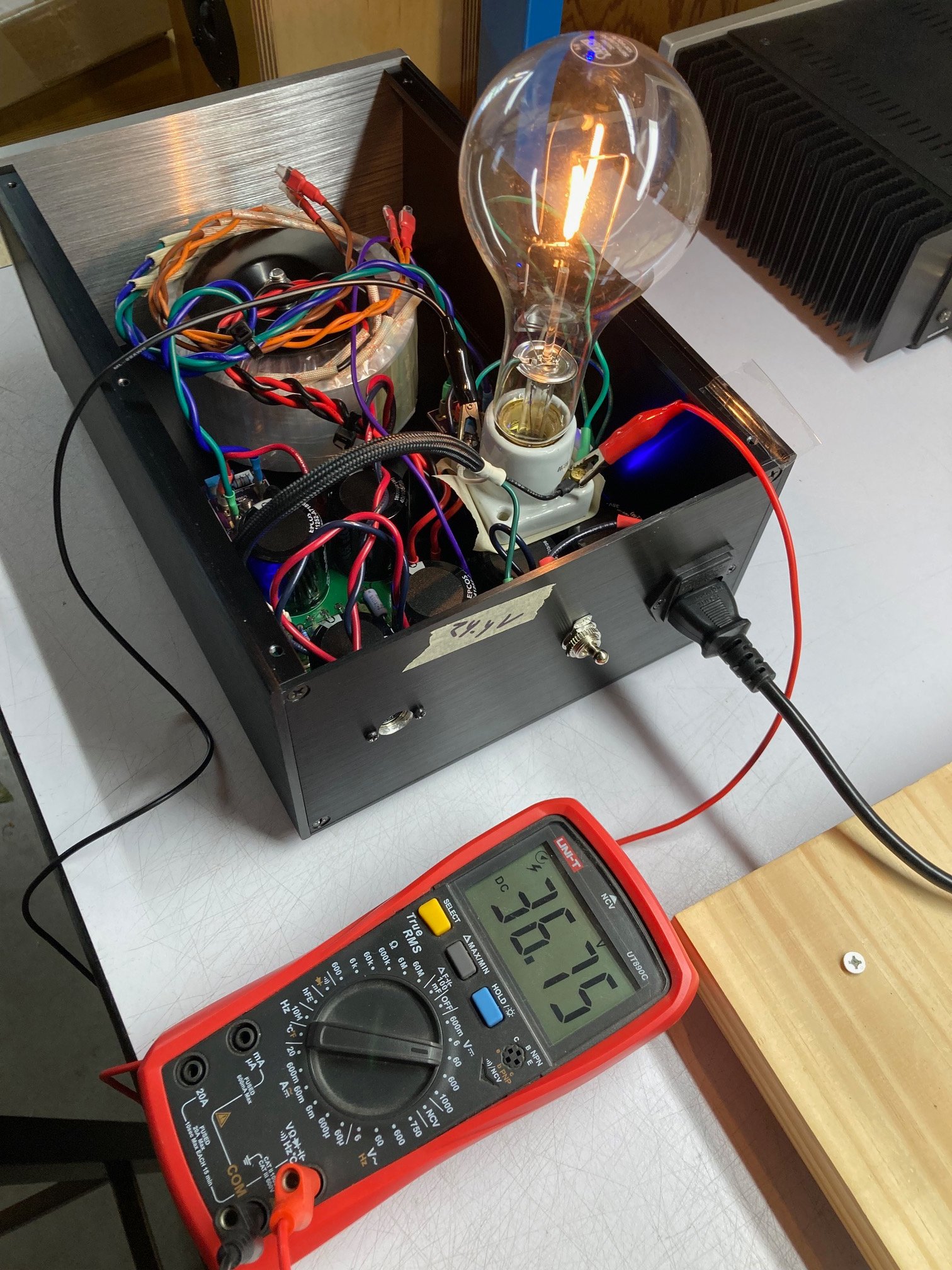

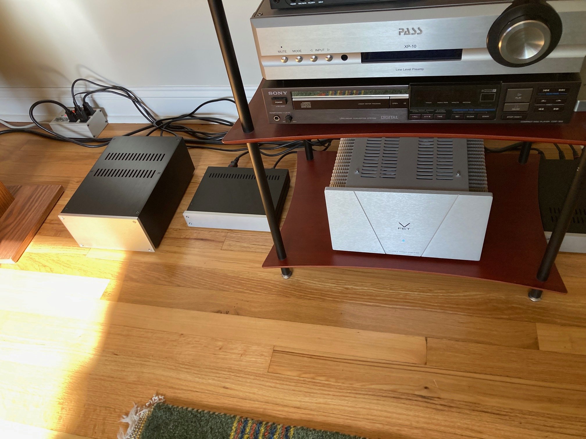

So I went and did this for my P-channel Sony VFET amp today. I adapted a linear power supply I'd made for my ACA by simply swapping out the Antek AS-2218 power transformer I was using for an Antek AS-3428. The latter transformer has a pair of 28V secondaries and another pair of 15V secondaries, unused in this application, on a 300VA core. The 1.3x heuristic predicted 36.4V DC. Since I chose to repurpose a First Watt style single rail PSU with filter capacitors rated for only 35V 😱 I was a little concerned and did some soak testing with a 300W incandescent bulb as load for a while. The voltage drop across the bulb was 36.8V. I watched the capacitors for a half hour or so in the garage without incident until I got itchy to try it with the amp. Note, when I built the linear PSU I went through the trouble of sourcing and using the same style of power connector in the linear PSU that the Meanwell SMPS bricks that were spec'd for this amp use. This is a plug & play replacement for the brick.
With the amp in circuit & playing music I measured 34.8V on the OS boards after the HF hash filter. The bias was 20.5V both channels so I didn't mess with anything. I'm listening to some Jazz Sabbath right now on my main system & it is good. This amp doesn't have the bass or dynamics of an Aleph Jzm or an F5m but I'm imagining there's a bit more of that spooky holographic imaging that VFETs are known for. Cheers.

If you have a CRC power supply filter, the voltage at the capacitors connected directly to the bridge rectifier is probably higher than 35V if the voltage at the amplifier board is 34.8V. You can measure the voltage at the capacitors and decide whether they are acceptable.
