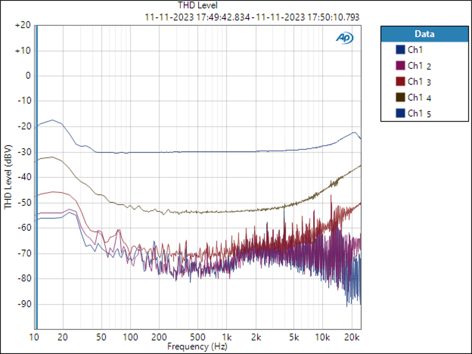

Just a picture of a screenshot of my V-FET 2SJ28, showing high frequency noise from the SMPS, even though I have the 'standard' minichoke and caps for smoothing:
By the way I see nada none keine no harmonics. Just buried in the noise as far as I can see . . more to follow later
(I have an exeptional driver stage with PCC88 and a choke on the same power rail)
334.1mVrms is only 0.014W if into 8 Ohm. Perhaps that is why the harmonics were low and buried in the noise.
What hardware/software was used for the FFT?

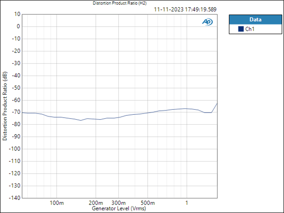

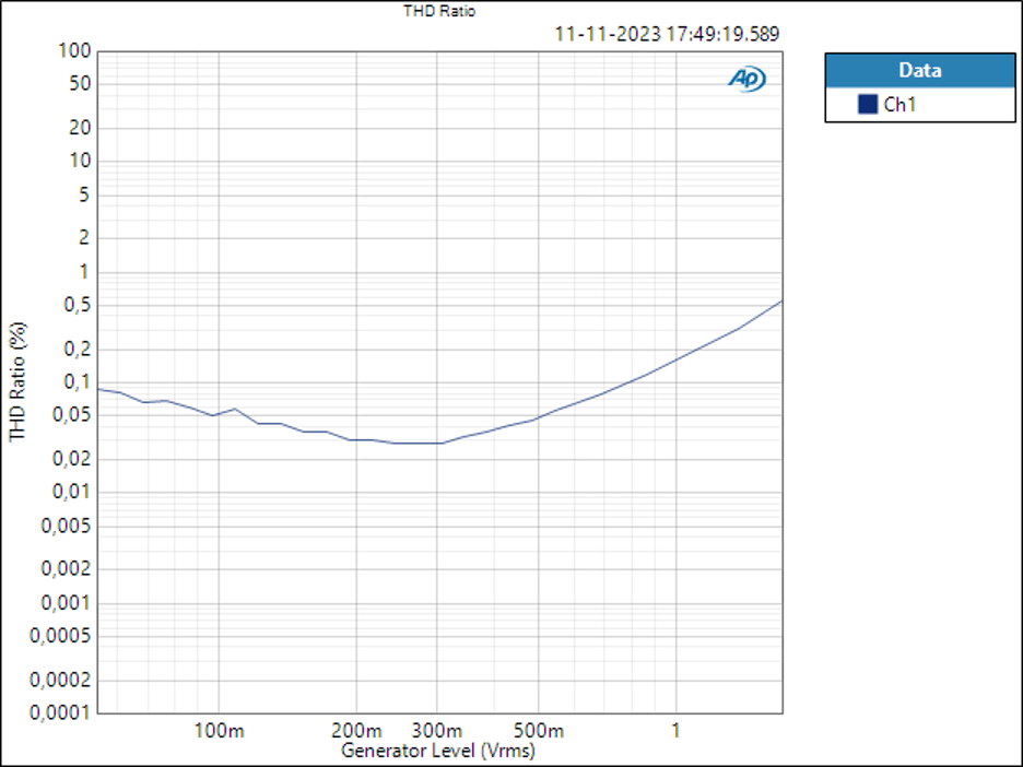

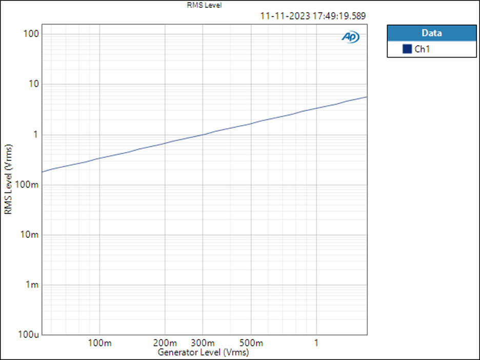

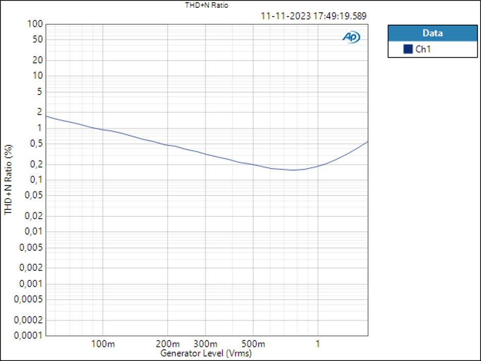

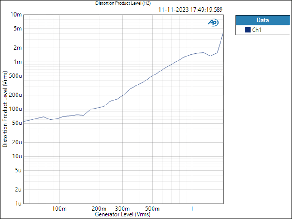

It was Audio Precision. Yes you'r right. Not fiull driven. Here some report pages. V-FET 2SJ28
The VFet amplifies +10,3 dB. And at 2,8Vrms it is 0,16%; peak level
Distortion Product Ratio in dB, - Generator Level Ch1: -0,000 dBrG (@860,2 mVrms)
Sweep volume:
THD Ratio against volume
Distortion Product ratio (H2) is pretty constant
and which power at 1%?:
RMS Level
THD+N Level
THD+N Ratio
In the following I can't really make sense. I see that the mauve line H4 is higher than the others?? But what is then the line at -30 dB? It is not the generator nor the output because those are flat.
Channel | F | H2 | H3 | H4 | H5 | H6 | H7 | H8 | H9 | H10 |
1,000k | 2,000k | 3,000k | 4,000k | 5,000k | 6,000k | 7,000k | 8,000k | 9,000k | 10,00k | |
Ch1 | -0,00 | -67,38 | -59,18 | -88,36 | -95,27 | -102,76 | -108,42 | -120,18 | -113,27 | -110,63 |
Sweep volume:

RMS Level
Ch1 | 5,317 | W |
Ch1 | 65,17 m | Vrms |
Ch1 | 0,999787 | % |
I don't have an AP nor have I ever used one so I can't help you with its use or understanding of the -30dB plot.
I noticed in the first chart that H2 was lower than H3 at 1W. That is not usual for this amplifier.
Also the graph of THD Level vs Generator Level showed decreasing THD as the power increased, until the THD bottomed out and then the THD started increasing. That is also not usual for this amplifier.
The graphs would be easier to understand if the horizontal axis was set to output, whether Vrms or Watt, instead of Generator Level (Vrms). Is the Generator Level (Vrms) representative of the DUT output?
The generator is 10.3 dB lower than the output and very flat within 0.1 dB; in the sense that the amplification is +10 dB and the reference is valid.
