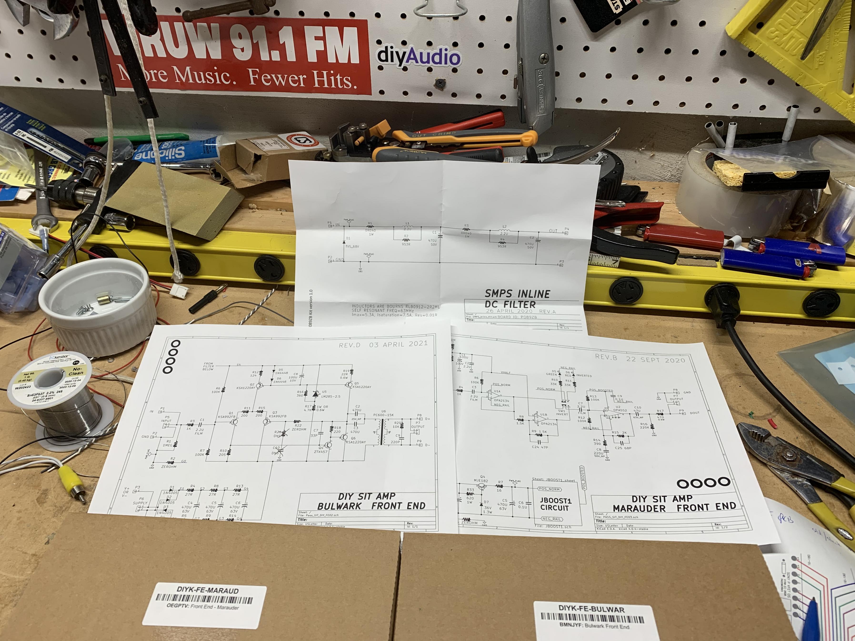

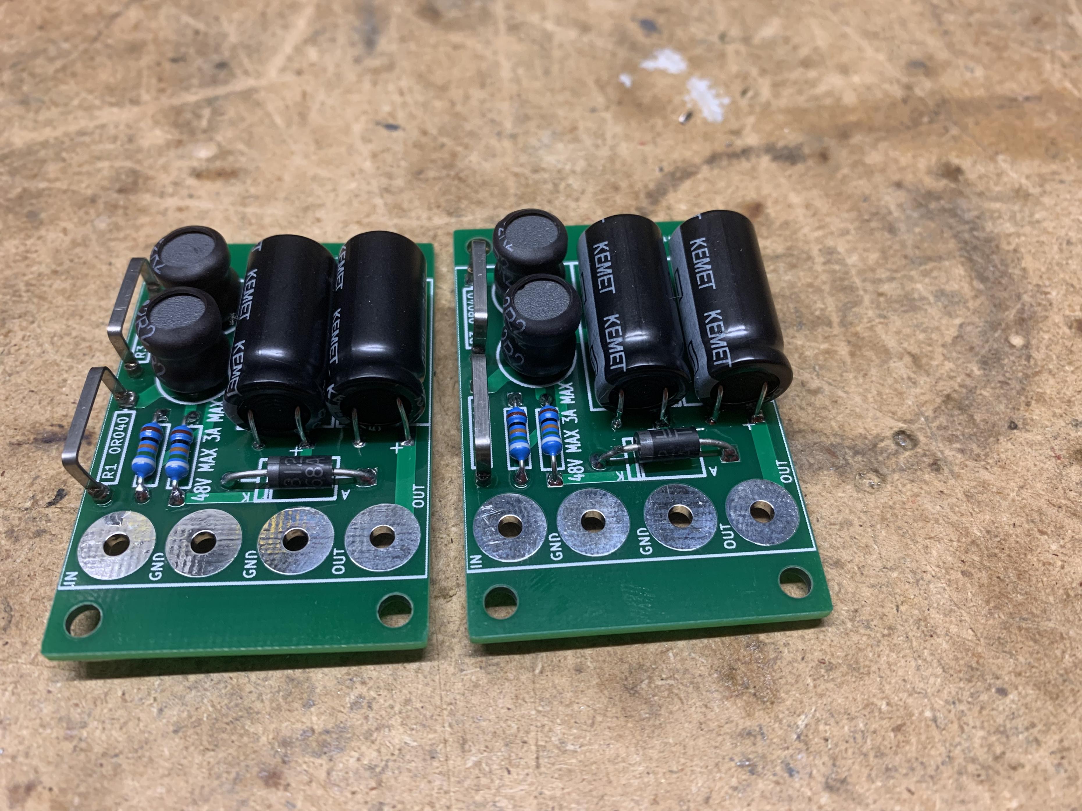

I put these little filter critters in my vfet, one per channel. Seems a bit more 3D and deep in the soundstage. I’m doing a victory lap by cranking a favorite record at proper volume for the style: Tanith - In Another Time LP. Love it. On an SP10 - thanks Jim!
Next up will be some front end boards.

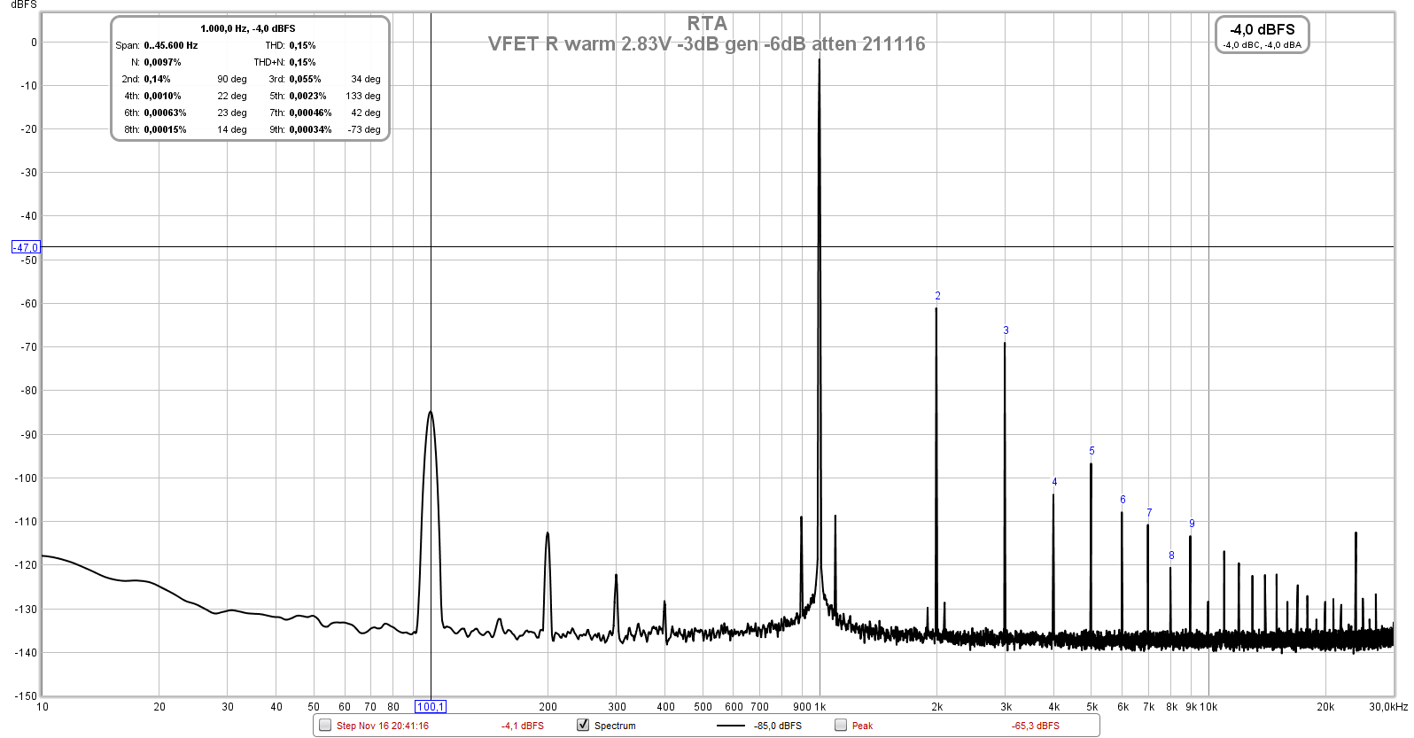

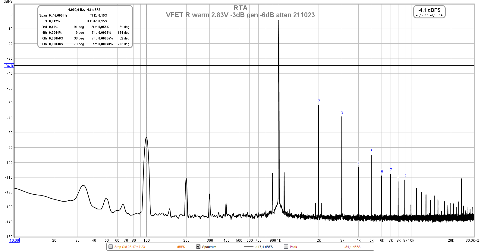

Hi Randy and everybody,
we seem to be on a parallel path here ... I also added the PO89ZB filters to my DIY VFET (N, so 2SK82), one before each output stage.
Music-wise, the main difference I noticed was a bit more transparency in the bass (more info - you can better hear what's going on with all the instruments), and a bit less sibilance in some recordings. Otherwise, I don't have a lot of difference to report. I feel that the little hum that the amp has, has gotten a bit quieter. You have to be very close to my 100 dB/W widebanders to hear it. I took some distortion measurements before and after adding the PO89ZBs, and you can see a slight reduction in the 100 Hz peak. (second picture with later date is with the filter)
I now measure 480 uV AC at the outputs (both channels the same) - unfortunately, haven't measured that before adding the filters.
I guess the about 900 uF of filter capacity the PO89ZB adds helps a bit.
Next step will be some different front-end boards as well. I have a pair of completed and dialed-in Marauder boards sitting on my bench, but want to memorize the sound with the original front-end a bit more before I swap.
I'm really curious if an Edcor-less front-end will change the measured hum (since it's 100 Hz in the first place, and then also the Meanwell PSU is far away, I guess not), but expect much better square-wave response and frequency responce. Let's see ...
Best regards, Claas

It may be interesting to try adding a modest amount of extra capacitance to the power rail on each output stage. The filter board may work to prevent the SMPS from going into a hiccup current limiting mode. Try values from 1000 uF to 10,000 uF.
Judging by the differences you have already mentioned, you can expect better bass instrument articulation, and improved separation.
