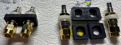

lovely binding posts but they will not fit .... but now! The new ones looks nicer.
