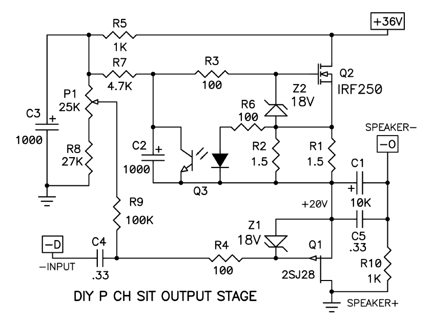

Are you referring to the P channel VFET circuit which was just released?
That is not a mu follower / SEPP - the mosfet is a constant current source.
I don't recall doing a mu follower Sony. I considered it, but the 2SJ28
likes a constant current source with an 8 ohm load, as does the 2SK82,
the next version up.
Ah, my error.
I reasoned falsely
that there was a slight modulation of the source because of the 'tap' of the output on the south side of the R1 resistor. But now I relook at it, indeed, only tapping on the north side or halfway would make it into a MU-stage like the ACA.
By the way, does a source-follower with a SIT specifically match best with a CCS feed - in the sense that this will also be the case with the 2SK180/2SK182 in this same topology?

Depends on load impedance and what harmonic profile and Ids and Vds.
Mu follower multiplies load impedance.
Typical desired impedance for 2sk82 or 2sj28 is about 8 Ohms.
Typical impedance for 2sk182es is more like 16 Ohms
- Typical desired impedance for 2sk82 or 2sj28 is about 8 Ohms.
- Typical impedance for 2sk182es is more like 16 Ohms
Does that imply that a 2SK182 'likes,' or matches good with, a transformer 32/8 ohm?
And that with a mu stage 8 ohms looks like maybe 16 ohms (i.e. easier to drive the lower ohmic valued load)?
Too many variables . . . both I and V, and R, for any conclusions on my side. LTSpice easily gives me output, but that is quite different from the real field experiments.
It implies that when you are playing with the load line of a SIT the gain of a mu follower is one of your tools. A gain of 2 (where current variation of follower is 1/2 the output) makes an 8 ohm load look like 16.

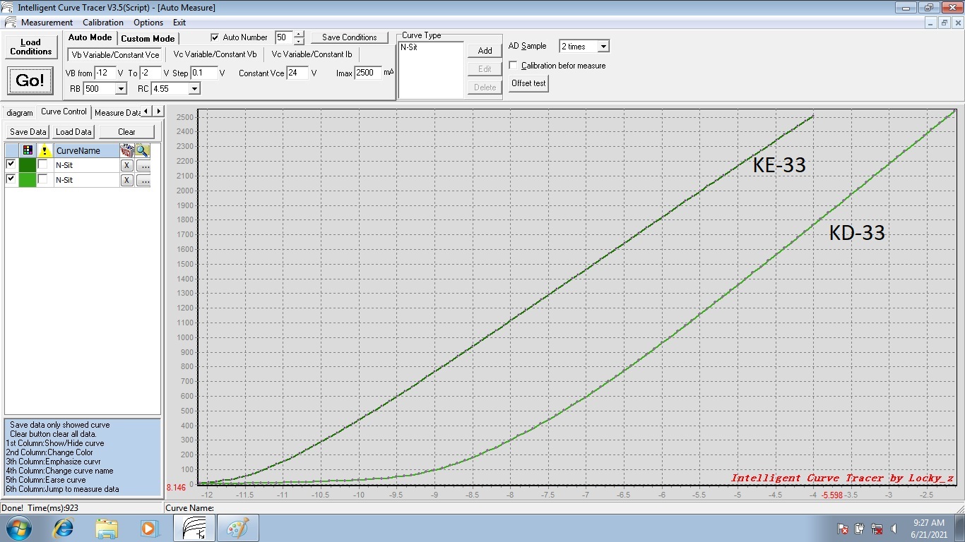

Unmatched 2SK82
Considering chances of me getting the kit from lottery are slim to none, I managed to get two 2SK82 in preparation when VFET-less kits are available for sale.
Both 2SK82 have different production codes (KD-33 and KE-33) and when I tested on LockyZ curve tracer, the result is clearly unmatched V-Fets (curve is attached).
The Vgs difference is approximately 2 volts, but they both showing pretty close linearity.
Looking at the schematic and description in the documentation, I think the Vgs difference can be compensated by adjusting P1.
Would there be any other issues for building this VFET with these unmatched K82s?
I think so too. If you run out of adjustment range on P1, you might be forced to replace R8 (27K) with a resistor half as big, perhaps 12K. I'd suggest soldering R8 in such a way as to make it very easy and low-risk to unsolder & replace it. Leave R8's leads exactly perpendicular to the PCB, etc.

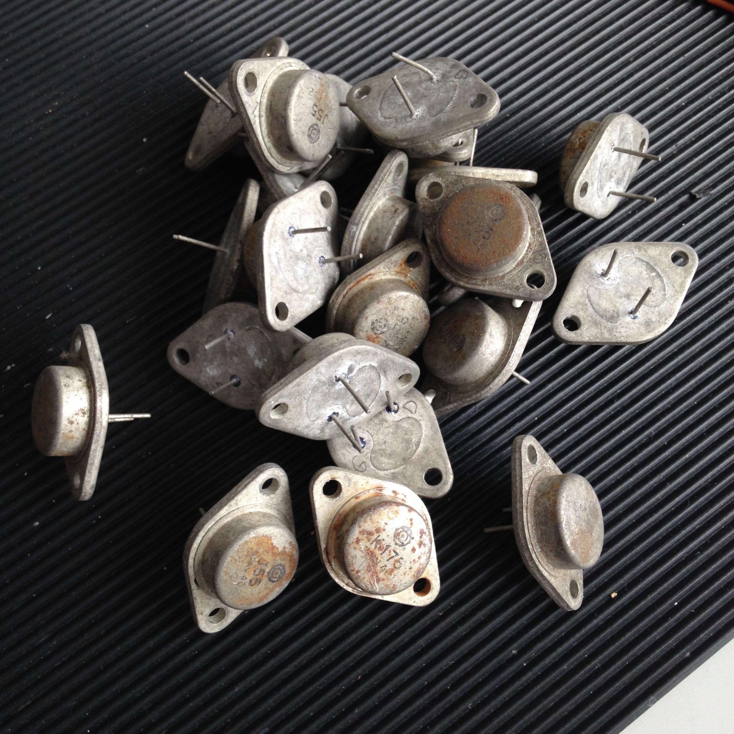

Long obsolete, the 2SK1530/2SJ201 don’t seem to have a reliable source. I have had better luck finding the big SITs than these old lateral Mosfets.
What I do have is a collection of the old lateral Mosfets used in the Hafler amplifiers. Matched even, as I had a hobby of buying the old amps for their parts.
Agreed, Tungsten. I have a small collection of those laterals, too. Would love to see a resurgent design using them.
