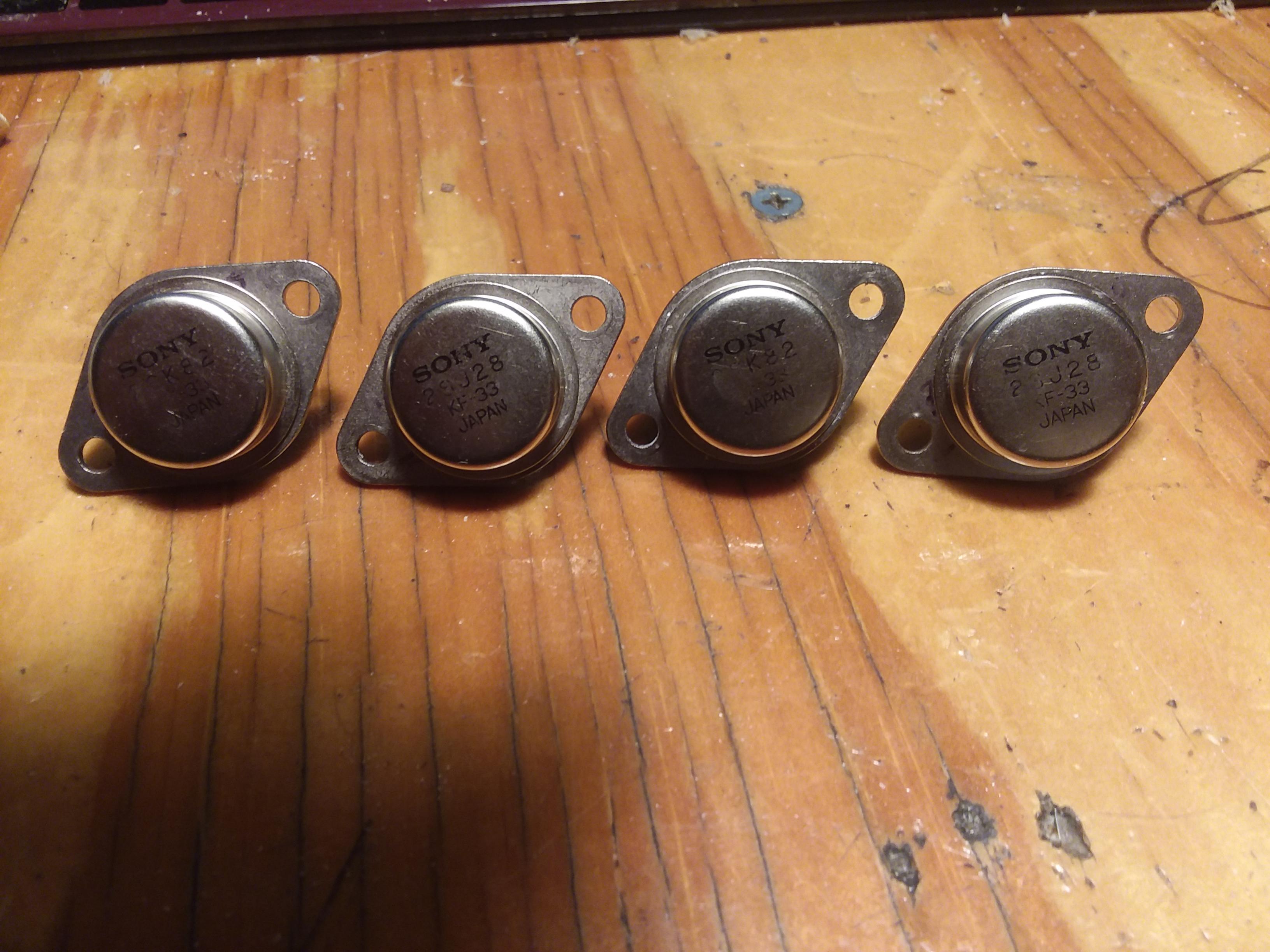

Found these in the mail from an old friend. 🙂 It's good to have friends. 😀 Oh ya, it was my birthday yesterday.
This shows that there ARE a lot of these VFets floating around. I sure hope you will make something of it?

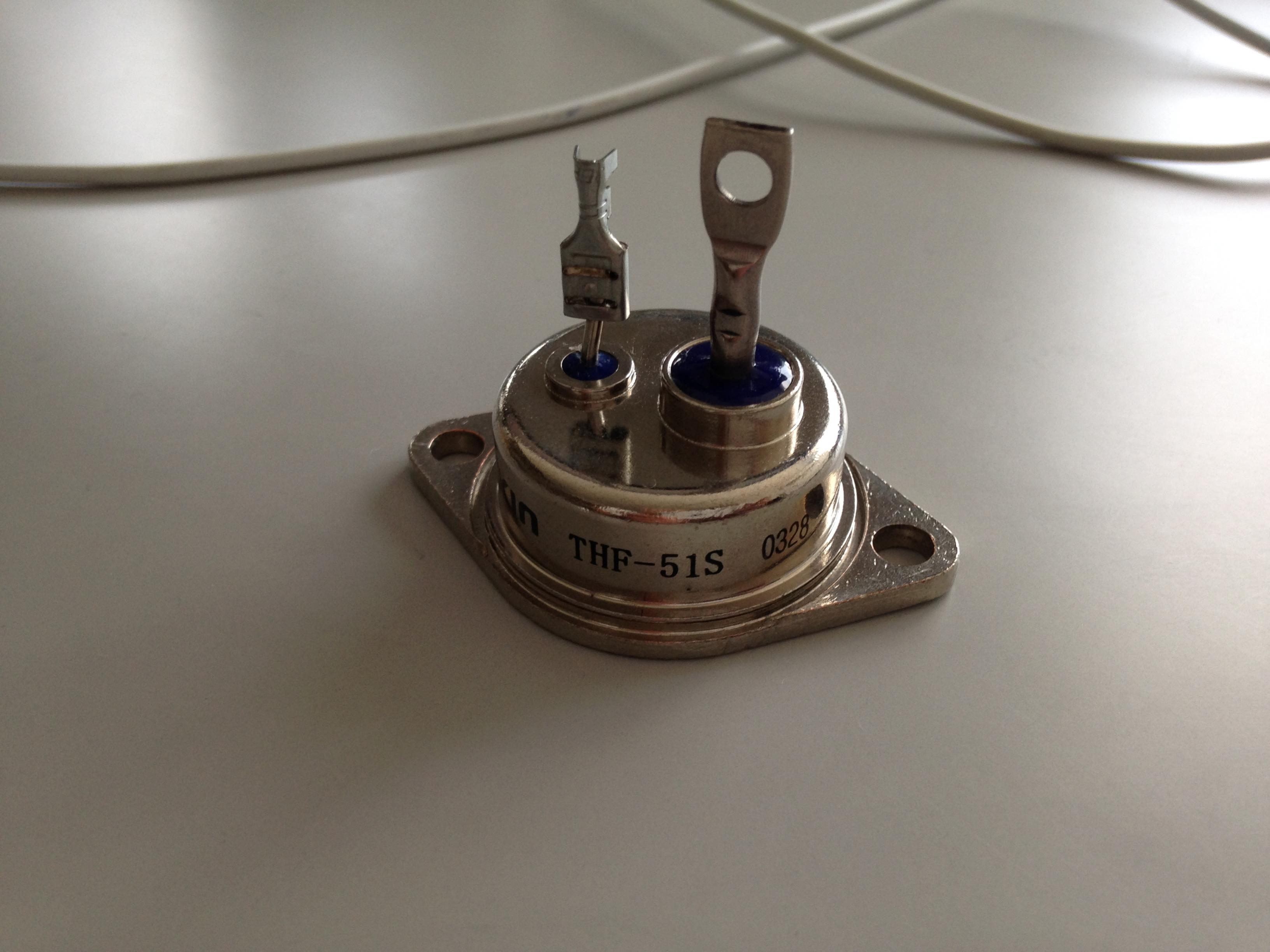

I'm patiently waiting for something BIG to come out of the Tokin SIT THF-51s - like a big 50 watter output with glorious large size heatsinks. Please take me back to the SoZ dayz!!!!! 😀
well, my so-called "Tokin SIT THF-51S" devices, they look good, but they measure like . . .
a BJT-transistor
No measured resistance between D/S or S/D of between 25-60 ohm;
but a junction voltage BE of 0,552 V
You know, look at that grin 😀 of the seller
Come on, it is not even a Germanium one.
a BJT-transistor
I requested a refund. That generally is accepted, in progress
sellr= ZHONG TAI XINAG XIA LING 😀

^ That is very unfortunate, but not unexpected. Ebay has a large number of fradulent sellers that know how to abuse the system.
They rejected my refund request. "It’s the same as the picture, it’s sold a lot and customers say it’s easy to use." 🙁
Where they from AliExpress? There's no shortage of sellers there knocking off fakes:
THF 51 THF 51T THF 51S|Integrated Circuits| - AliExpress
and if you go over to eBay on watanabetomoaki's store (Japan), you will notice ALL of his Tokin SITs have been sold out. It's a no brainer where customers choose to buy the most.
Pras is down to a small qty, and it seems Tomoaki is out. This looks like last call at 2 in the morning.
