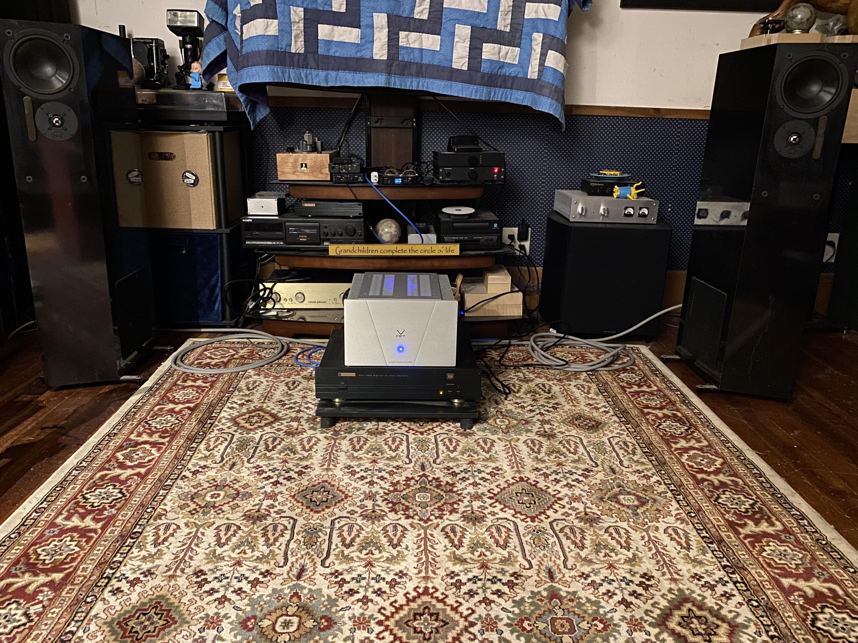

It’s been some time now with my VFET beauty. Not quite sure how to describe it. I don’t have very efficient speakers at 86db (NHT 2.5i) I do plan on bi-amping but not currently though. Even so, I do get enough volume for a very satisfying listing session.
I was using a Korg B1 and a Parasound HCA 1000a. Putting the VFET in place was a revelation that’s for sure. I let it run for a few days while I built an ACP+. Placed the ACP+In there and OMG is all I could say. I can honestly say that I’ve never heard my recording sound like this, never. The level of detail is incredible, voices, strings, bass, oh man the bass. Sorry I’m not much good with descriptive prose. I can tell you I’ve been up late every night going from song to song to song. . .
Thank you again to all involved, I’m so fortunate to be able to have something like this.

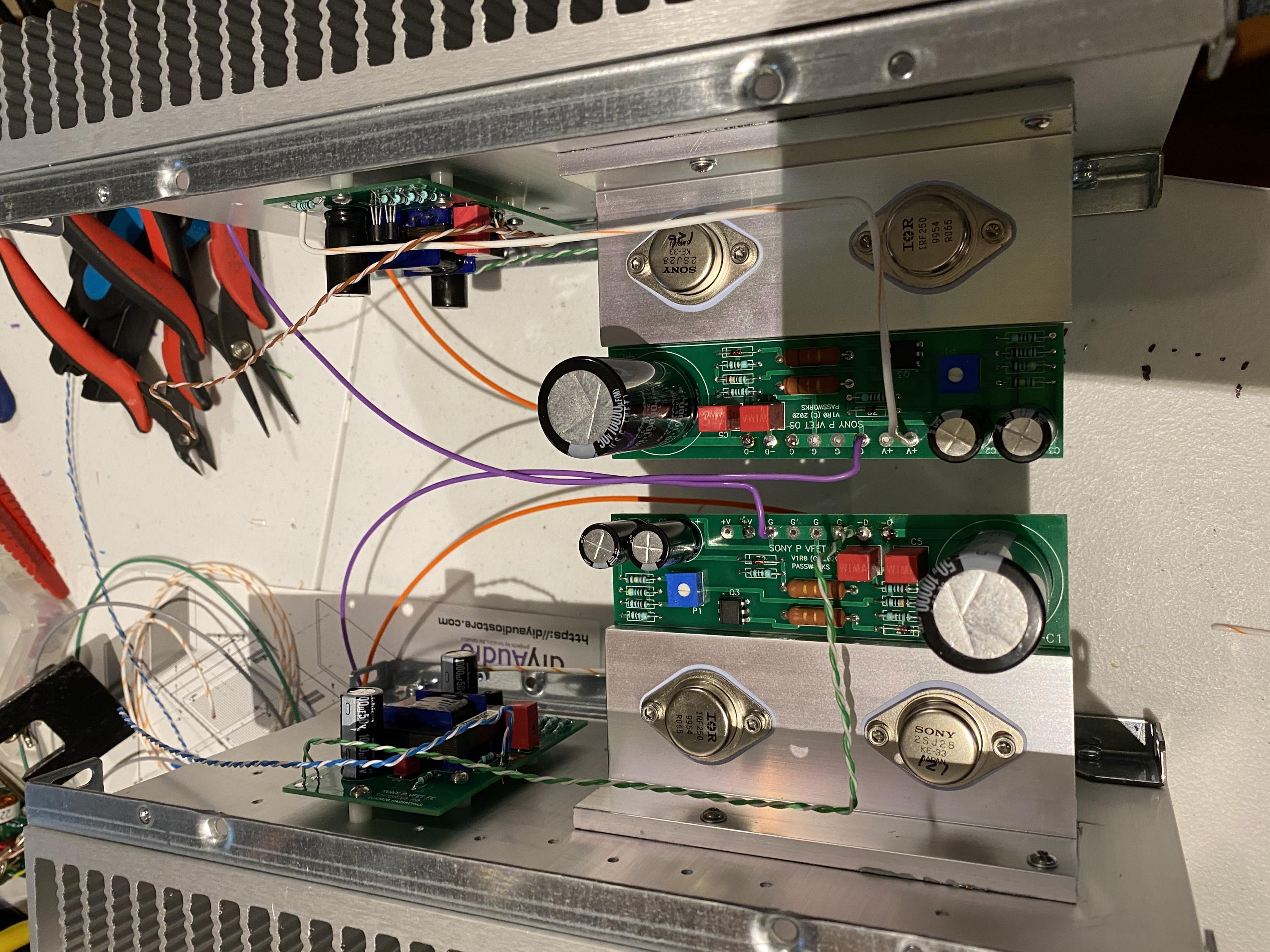

..Do you see any downside doing what I did with the resistor?
On another note, having just soldered the bits today, it seems to me you have very different parts re Zener and other surrounding bits (not the big resistors obviously) - Is it me?
It's just acrobatic for 3W power resistor
For long therm reliability horizontal position is better, less mechanical stress on soldering joint imho.
I think about one easy tip : twist some piece of the copper wires together with two channels zeners leads or 1R5 resistors
so will be temporaly physical extension for voltage adjustement with big crocodiles etc.
After all is OK , put this extension wires out of the circuits..
Oh yes precision matched resistors pairs for FE and OS signal path..it's a hobby pleasure.

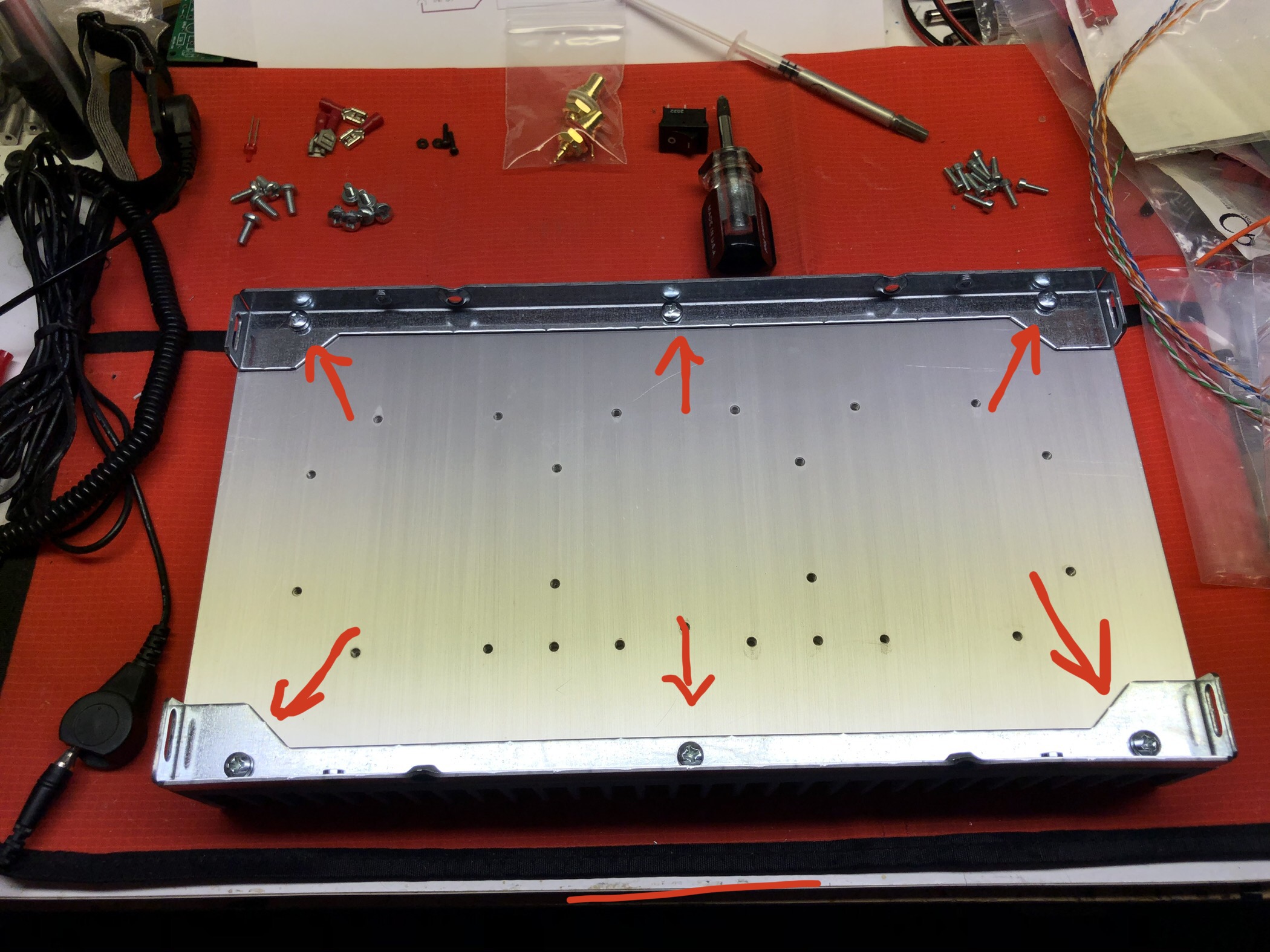

I’m just starting work on mounting the OS brackets to the heatsinks.
Just using the guide to try and sort out hardware...mimicking what I see in the pics.
I saw the brackets were already in place on the heatsinks prior to the OS mounting...so I started the same way.
First thing that popped into my mind was previous posts in the thread regarding rear panel alignment...and also suggestions of “dry fitting” the whole chassis together before actually installing and wiring everything into it.
I’m not sure how necessary preassembly is...honestly, the tolerances are what they are and any misalignment will have to be compensated for by shimmying this or that or adding a washer etc.
However, while pondering assembly I thought to myself “Should I use Loctite on the chassis brackets and hardware holding the faceplate or any other panels?”
The reason being is that there are no lock washers and the constant heat cycling may cause hardware to come loose.
So...anyone using Loctite anywhere?

I've found 1 rail in my build was slightly concave and all end tabs aren't touching to front or back panel. I used a hammer to bang the tabs so they would close up a 2 or 3 mm gap, then screw on.
As ZenMan says, no need for Loctite... things could go fugly later on.
The amp doesn't really get that hot.
I would just say mount those rails even with the back of the heatsink where the thin rear panel will be mounted or it's likely to bow when tightened down. It's not a problem with the front panel because it's so thick, a gap there is ok. I thought about Loctite for a second, but ended up not using it myself.
