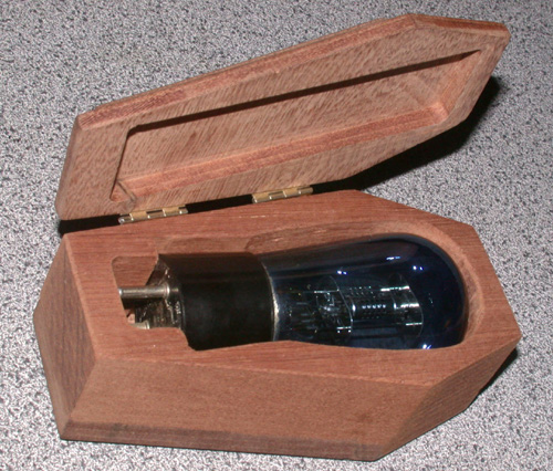

Regarding a "fine box" for a component it reminds me of this. The owner liked this tube very much.....but "Mr. Trimmer" is still alive!

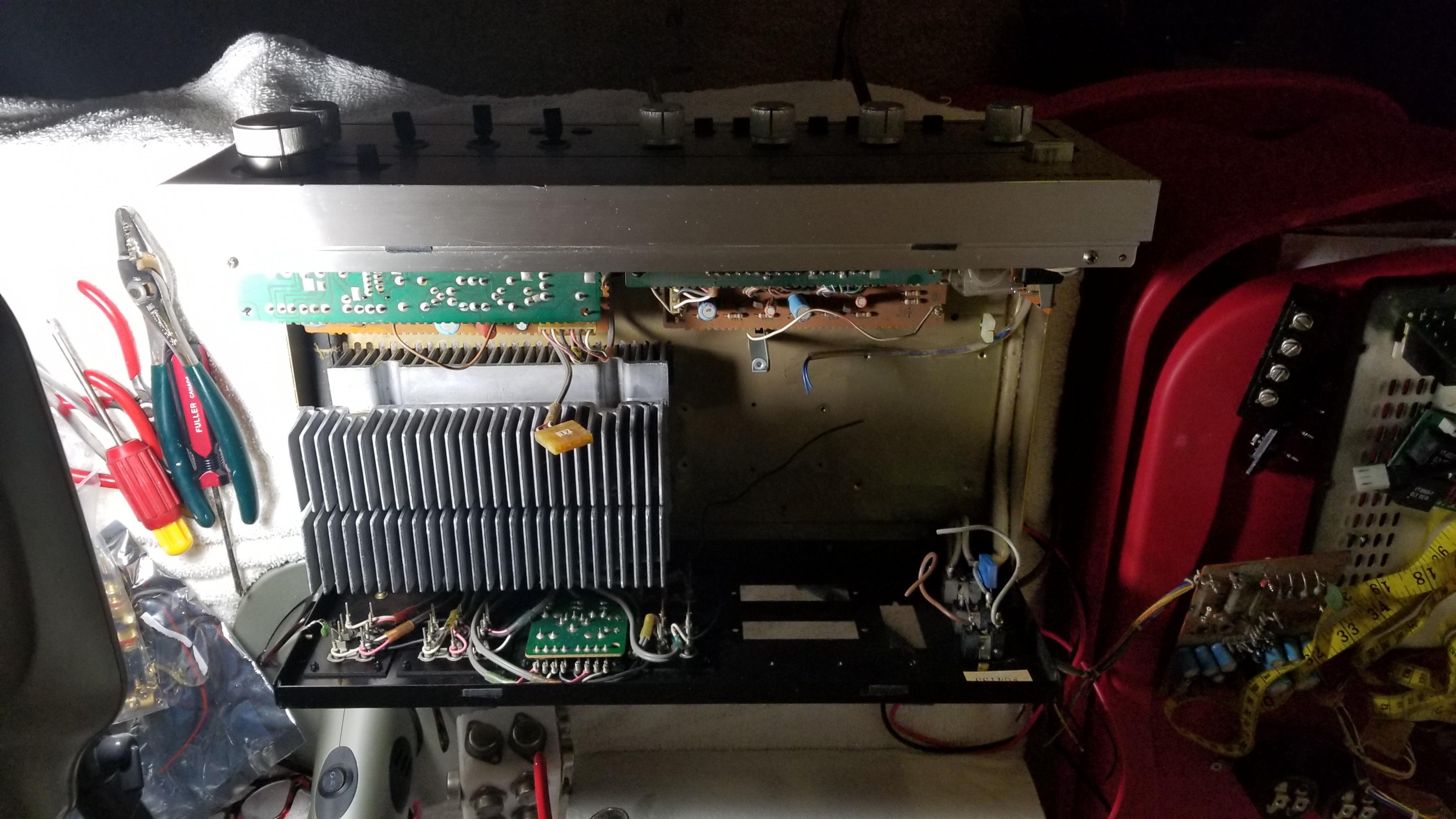

Continuing to spitball Sony TA 4650 chassis. After gutting power supply, looks like plenty of room for Meanwell internal PS @ 36V and various cards, and another 20v power for built in preamp. Putting 20v variable power supply onto preamp leads, preamp sounds great through headphones on preamp output for such an ancient device. It looks like simple two stages of FET cascode. Keeping it alive allows the use of many of the inputs and tone controls, and amp can be accessed independently if desired through power amp input. Heat sink is unknown, but I think the heat sink should work with the 68 (??) watts of dissipation for two channels.
I guess I will enter second auction and see if I have any luck, and, barring that, wait for later card iterations based on types 2SK60 or 2SJ18. These have half the anode power dissipation of the favored 2SJ28 devices, but look like they could still output around 5-10 watts of Class A power.
If I can make one chassis that works, then I could use the second TA 4650 chassis to include an internal B1 Korg card as well.

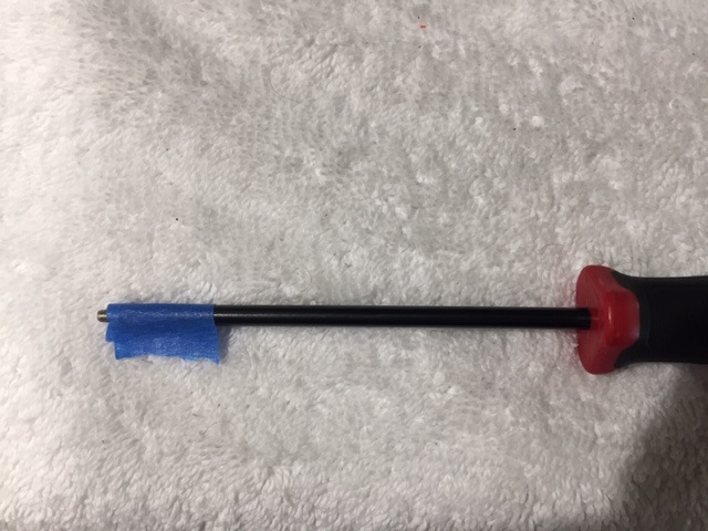

Just a couple of tips for builders:
(1) When bolting the Front End PCBs to the heatsinks + threaded standoffs, I find it helpful to temporarily "attach" the M3 bolt to the screwdriver head. Now I can fit it into tight spaces much smaller than fat fingers allow. And believe me, there are some tight spaces when mounting Marauder and Dreadnought to the heatsink! See attached photo. A bit of masking tape holds the bolt head to the screwdriver shaft. After screwing it in two or three complete rotations, I just pull the screwdriver away and remove the tape. Then finish tightening.
(2) When working in confined spaces with plenty of obstacles, I prefer to use a flexible shaft screwdriver like this one on Amazon. Now I can curve the shaft to put the bit where I want and the handle somewhere else that's roomier. It helps a lot when mounting the front and rear panels to the heatsink rails, for example.

CJ. I'm not sure if everything is in it's final position, but you may find better cooling if you turn the heat sink casting 90 degrees so that the fins/gaps align with the slots/gaps in the casing base. Just as they are in the original setup. You may have to make a couple of brackets I suppose, but I think that it would pay dividends on cooling performance like that.
Regards.
R
Yeah, those are just in there for scale. I will try the original configuration first. If Temperature of heat sink with VFETS turned on is too high, then I can consider second heat sink or other options. There is time to play with it. Some aluminum heat chimneys might be in order, too. It appears from the use of one heatsink with six vfets in the TAN 8550 that each heatsink is designed for 100 watts or more of dissipation, but I will watch and see. There is plenty of room in there.
Thank you for your input.
That sounds like a good plan. I would say the 100w figure is based on class AB output. Your earlier statement of 5 to 10 W seems right to me. If one looks at the latest NP Vfet kit, (size, number and position of heat sinks and output power) that is probably a good indicator. Would it be possible to use a variable speed fan and thermocouple on startup, altering bias and winding the fan down eventually if the temp is ok? I have a dead TA-4560 and look at your design with interest. Thanks.
