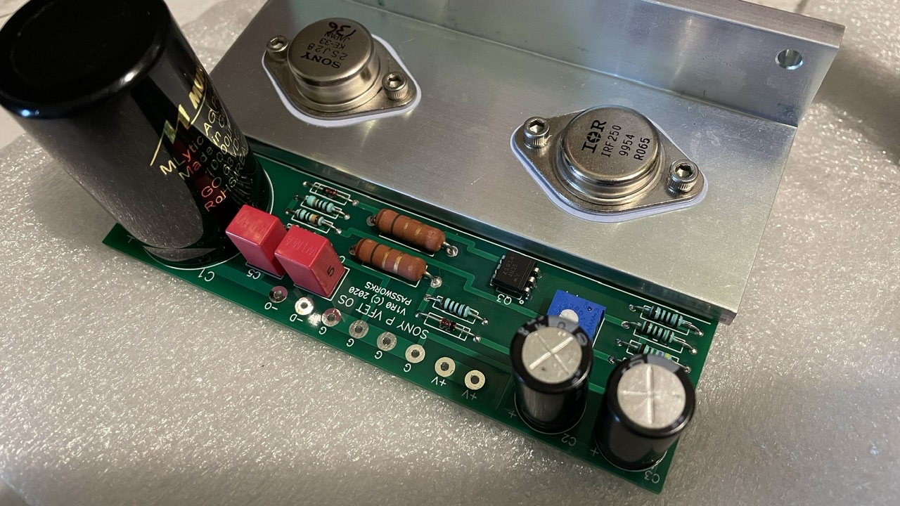

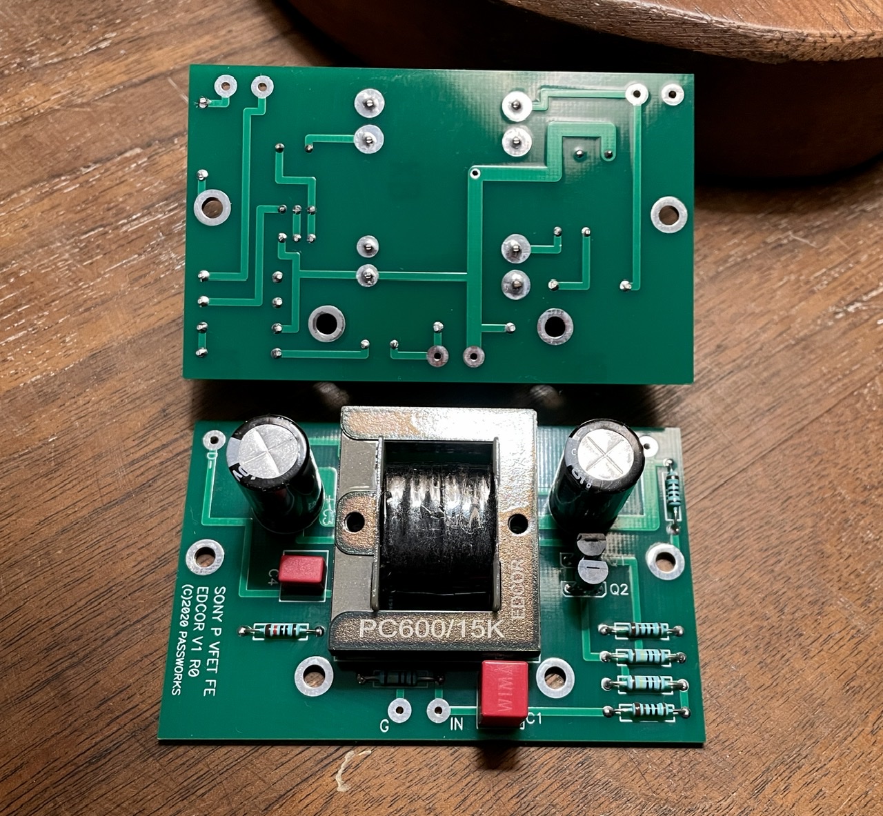

Pix of the chassis posted in the main thread

Ha, I’ve only had time to squeeze in the OS boards, then my family came home. Won’t be able to get back to it until later this weekend 🙂
