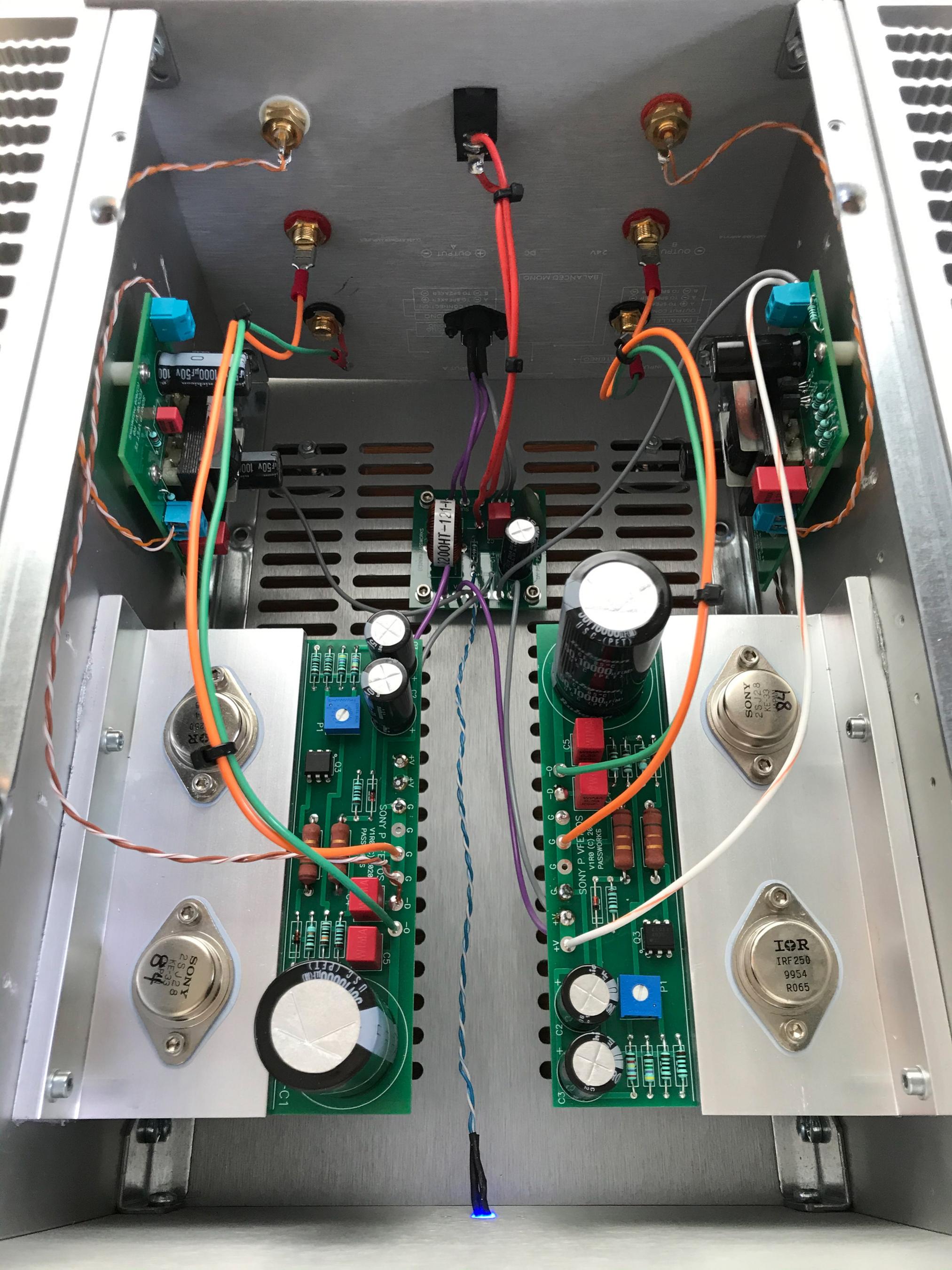

Finally got everything wired up. Minor mishap w/ the tab on the binding post snapping off while trying to push the spade connector on. I jerry rigged it for now and ordered another. Otherwise...easy peasy. Although I will say that this is a tight squeeze for your hands (as everyone is saying). Mine aren't that large and it was a bit tricky at times.
Pots set halfway were at like 19.5 or so volts, so just a minor turn and I was at 20.00 on both channels. Seemed to hold steady.
As for the "screws too long for mounting the output boards", I just swapped some of the M3 screws that came with the chassis in place of the other ones and they worked a treat!
Only had a chance to listen briefly, but it's fantastic. Same family as it's big brother (the M2 that I use as my main amp), but maybe a bit more detailed? We'll see over time.

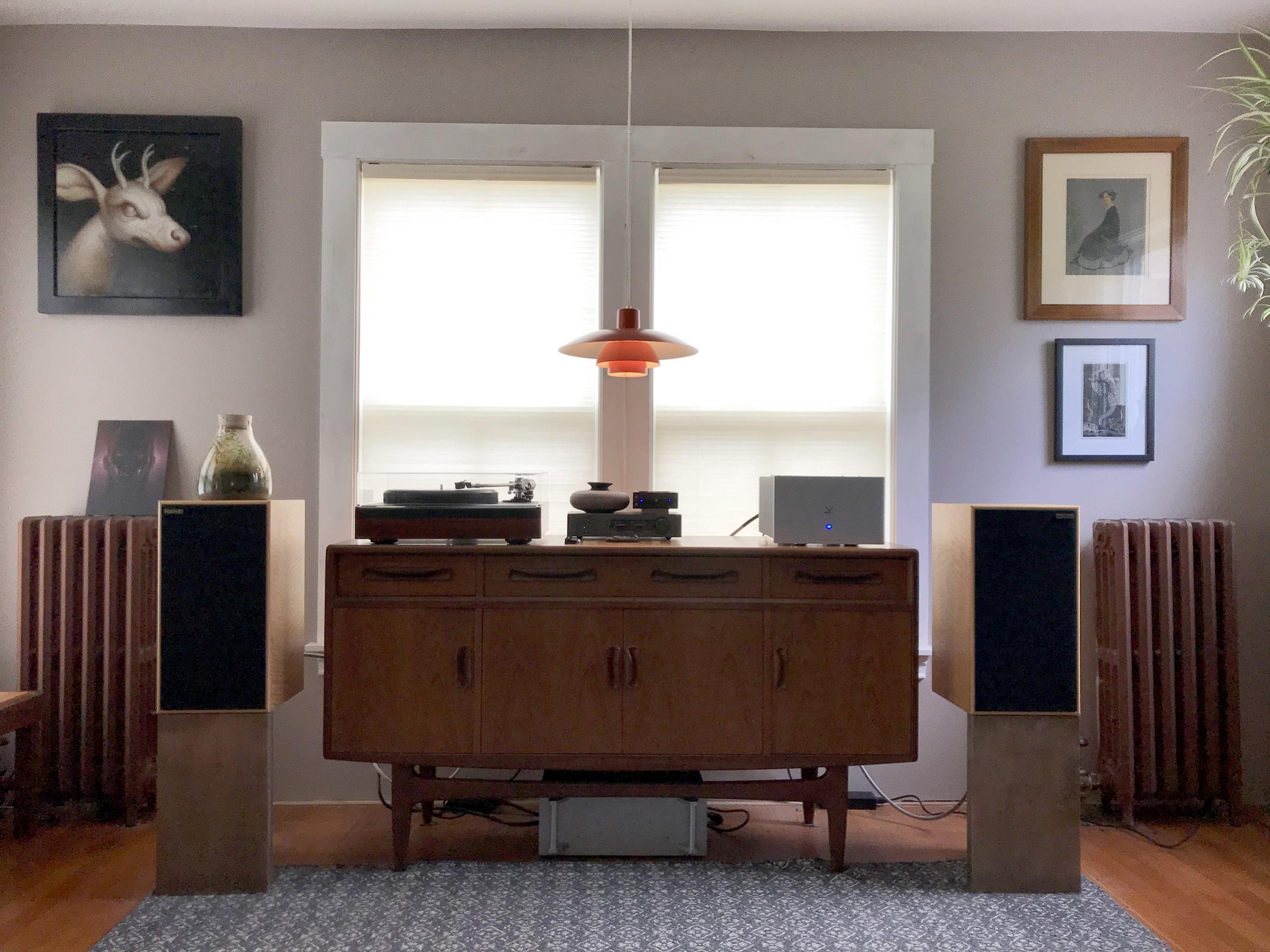

The best part is that it's plenty of juice for my Harbeths in the living room. They're 6ohm (but pretty benign) and only 86db. As loud as I would ever generally listen the volume was most of the way up (maybe 90-95%). But that's with a Quad 34 that only puts out 1.6V. So with a proper preamp (in my situation), you could probably boogie a bit with this thing too.
Another fantastic project. Thanks Nelson for the design and devices and DiyAudio for the kit!
PS. The left rear panel is now properly aligned and flush. Didn't realize until after viewing this pic 😀
BTW, the devices are pretty hot (can barely touch them for a second or two). The brackets are warm but I can keep my finger on it for a while. The heatsinks are just a bit warm. My temp probe broke, so I can't get numbers for now. Seems like this is how things are supposed to be though...

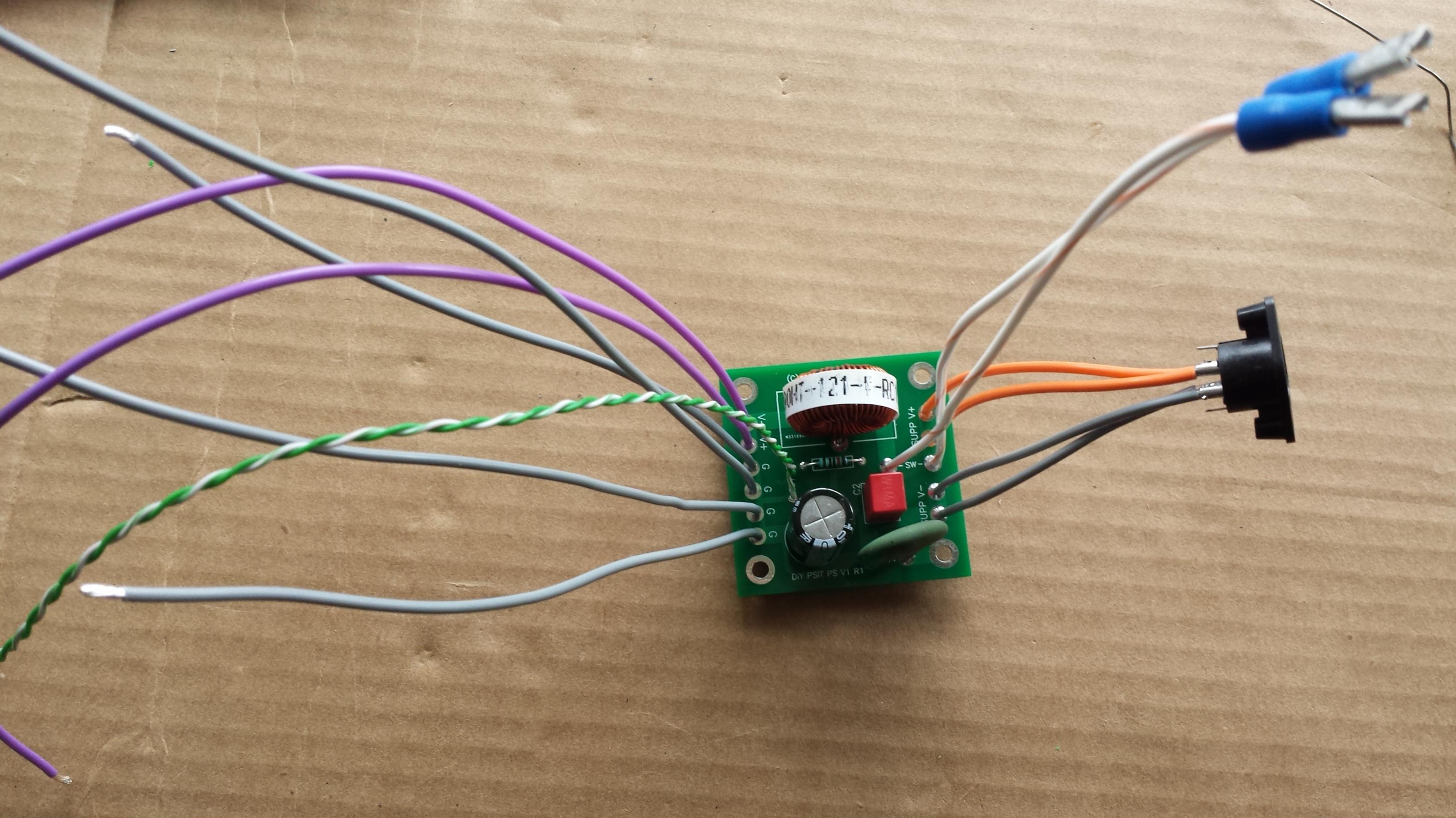

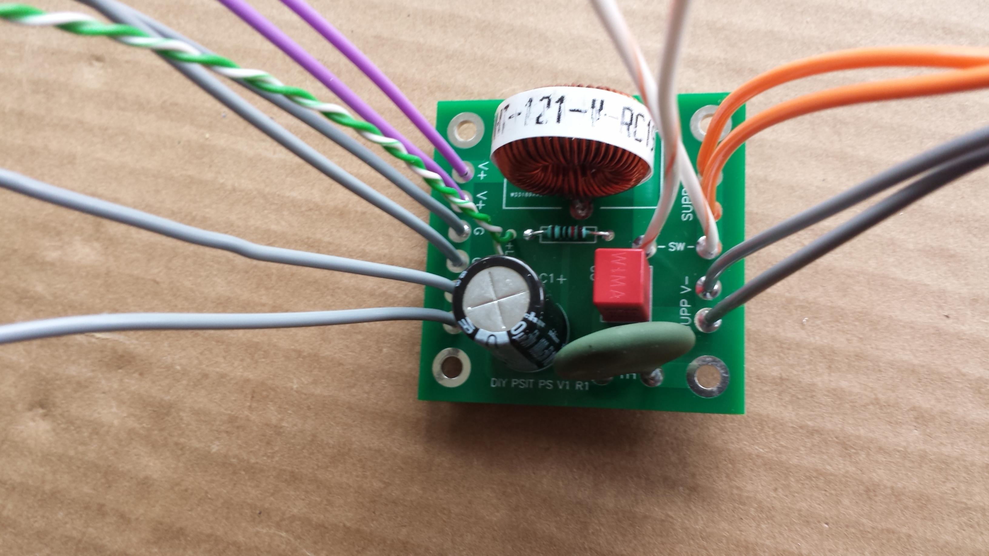

one can do majority of wiring with heatsinks still laying aside
some cardboard pieces as scratching protection and that's it

The Harbeths are C7ES2. If you can find a pair used...much cheaper than the current ones. I tried some series 3 and they were too bright for me. I have some large horn speakers that I built, but they have not been hauled out yet to demo with. They might not come out given how well this works w/ the lower efficiency speakers!
