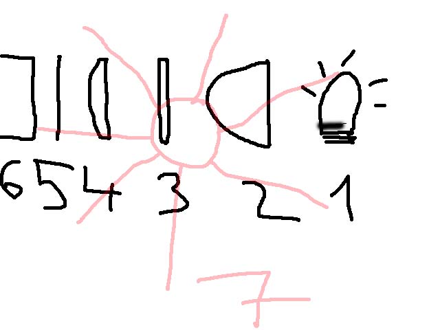

Hello
First of all, thanks for your answers.
The model of my slide projector is NOVAMAT 130 AF:
- Halogen lamp 24V / 150W
- Turbo cooling Fan, overheating protection.
- Autofocus (I would call it Manual Focus)
- MultiCoated projection lens Color Paxon 2,8/85 mm MC
I don´t know whether it is heat protected or not, where can I find protection glasses? I don´t think that I coul use a mirror for that, I would like better to use a glass, it seems to be easier to use.
I have no portable TV, I was planning buying the LCD panel you spoke about 10 posts ago or some other that I could find here in Spain what seems to be hard 🙂.

You need to open the cover by removing the screws. Then look inside and describe the path the light goes from light bulb to screen. Somewhere here, there is maybe a mirror!?
But, I don't think this projector is problem for you. I think your panel would be okay to install without extra cooling. I don't think yours is too hot. But, exactly I don't know. This bulb is 150W and mine is 300W. So, I think yours is safe. No extra cooling required. But, always a gamble!~?

Describe inside SP light path!
I opened it
That's what I found in (I hope you could see the image)
1) halogen bulb
2) really thick lens (the size is not exaggerated, it seems like a big water drop)
3) Just a glass (Could it be a heat insulator?)
4) Another lens (this time usual size)
5) Slide (Here is where I want to put the display)
6) Projection lens
7) Thats´s how the cooler is

Casty,
Yes, maybe, #3 is UV/Ir filter or maybe it is light collimator/shaper.
I think you will be okay with your projector. No change necessary.
You will have to monitor the picture, while you watch, to be safe.
You can also measure the temperature at the #5 area. It should not be more than ~60 degrees Celcius. That seems to be the typical operating temperature for these panels.
Is #3 lens any color? Or, is it clear?
Yes, #0 is to collect the light and focus back to front.

the #3 lens has a light green tone looking across it, the borders are completly green. It's not lens, just a glass, it doesn´t distort the image crosing it in any way.

The #3 lens I think is there to collimate the beam, shape it, into #4 face.
Casty, I don't actually know what a UV/Ir glass filter would look like. My projector uses a mirror that only reflects visible spectrum light through and absorbs the UV/Ir. I know that a Ir filter that passes ONLY Ir is very dark red in color. I don't know what color it would be to absorb Ir. Maybe not a visible color.
Anyone help us with this? Xblocker, what was the color of the Ir filter you had?
