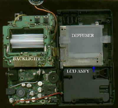

Pics of Mini-TV LCD Disassembled:

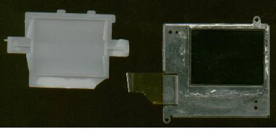

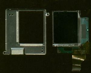

Here are the pics of the disassembled tv I first used. The panel's fried. Nonetheless, you can sorta see what you're getting into. If you haven't already. Not much to it, really. Just be careful.

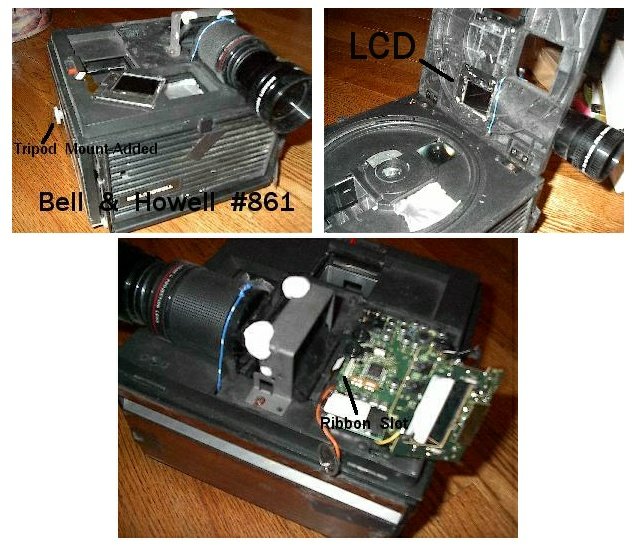

This one had to be mounted on a non-conventional slide projector because of the ribbon cable being too short and connected along the vertical side. Hopefully, yours won't be like that!
Be careful, as you have all that bare conducting metal there. I put some duct tape across the whole surface of the circuit board (both sides) and anything that might be exposed to anything.
The display light may be detached on some models without problems. But, I seem to recall this one not driving the lcd, if it didn't have the light connected. Some sorta safety perhaps? I don't exactly recall. It was over 8 years ago. Anyway, you can reattach it.
Ideally, you can get it outta there to clear up some of the clutter.
If you have an overhead at your office you can power up and put the panel on there for a quick view of what you have, picture-wise.

This projector is of the tray variety. Uncommon, now (pawn shop dust collector's though, < $$). The carousel version (if your lcd's ribbon orientation allows it) is easier and let's me say 'plop, and shoot!'.
I thought this might illuminate (ha-ha) the idea for browsing folk's. And, quench my ego (beautiful wood floors!) and free time. For those here already AND the World!...Headlines-" SMALL LCD BRINGS PEACE TO WORLD!"
Nothing to it, really. Biggest thing IS you're really surprised how easy it is. I'm curious to see how another person approaches this.
Also, I want others to see they can have a large projected video image, from such an effortless project. Have to wait for actual screen pics unfortunately. But, they're viewable, distinct, albeit slightly pixellated pictures! And, with a slight softening of the focus, helps relieve that. That's for the Radio Shack model, shown here. The hi-res unipac's and primeviews, I used, are definitely more palatable, though.
Basically, there is an ELH (300W) lamp inside and that's shot up through the beam collector lens. Then, through the lcd and off the front surface mirror at 45 deg and out the focus/zoom lens onto the screen. No "space mod-u-la-tor"'s required, ha-ha.
