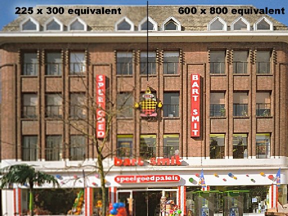

Lokost, looks like I will be eating my hat tonight. Ran across a link on the "wearables" org for a side-by-side demonstration of the difference between the Glasstron 700 and the 500. The way they state it is, that the resolution WAS divided by three to give the ~300x234, or thereabouts, you presented! A visual for us to see here. This shows the perceptual difference of the two. Lokost! I/we weren't alone on this! And, my hat is very chewy!
These folks seem to know what they're talking about. Hardcore VR'ers! The Sony 700 Glasstron and the Canon Eyetrek 700 with "OSR" (another 800x600 panel, coupled with another panel/device, put in, before the lcd, that makes the picture appear as a 720k pixel panel would! Using approximation circuitry and tiny controlled RGB diffuser's) are the only resources for hi-res, color, transmissive, one-panel lcd's, readily. A search on Ebay for the Eyetrek 700 shows: ~$1000 for two panels, though. But, only one driver.
This and the Sony VR glasses BEING produced implies that they made these panels in "numbers" (cheaper?). And, they are available thru the headset's on-street, or they are in little plastic bags somewhere, OEM-wise. However, post production is dodgey. But, for now, this may work. "Hi! I broke my glasses, can you tell me the cost to replace a panel and driver?" $$$$$$$, WHAT!!!
The big Butt being, 'is it "depressed-cost", available!' ? Answer, 'usually-not'. So, rip 'em from Ebay, etc.,....but, it's do-able for the DIY-savvy, portable, seeker.
Here's the comparison picture->

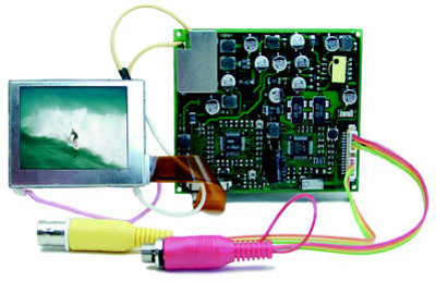

Taking your advice and looking for a smaller one...what do you think of this one?
Marshall LCD
Later

been following the diy video projector thread for a while now. I've been looking to go the small panel route mainly for size and portability.
http://www.mars-cam.com/osd/lcd/panels/vlcd18p.html
the size is good. but not sure about the resolution. It's the best I've found so far though.

Yep, that is the same panel I just posted about, it looks promising.
That'll work too!
Same panel as 6 posts up^.
Both say "Marshalls" on there. 528x234 sounds good and should look "on-screen" as, somewhere between the two resolutions in the post up above.
Should be fine for DVD movies too. And wide-screen is nice on these, although you waste some of your vertical pix. SVHS connector on board as well!
Let's see if either have them in stock, though.
I smell success coming!
Here's the pic (below), off the sites, of the panel and driver board. $159. Would be better if it was about $100 though, or even free! ha
If these are available, then next thing to work on is keeping the panel cool. Extra fans, UV/IR blocking/retarding, mirrors/filters, and maybe even peltier chips mounted to the panel.
Lighting can be explored too! Oh my gosh! Aleksey, "Dude! You gotta get a 'Volksprojektor'!" ho-ho-ho!
I will try to mount the device into the carousel tray. As the Kopin inventor patented back in '88. He has a zillion patents and manufactures the ultra-small lcd's as well for head-ware.
Anyhow, that would allow us to simply carry the carousel around and throw it on your buddies projector, or use it as a frisbee!

The little LCD looks pretty nice, but I'm looking for something I could switch into a car mp3 system if the projector doesnt work out. Where could I get a large enough projection lense for a 5" LCD. Also, would a condensor help focus light from a flourescent bulb(low heat) at the lcd screen?
Small panels
SushiMasterX
Just wanted to point out one more detail, that 1.8" LCD needs a power supply (not included). But it is only $15.99, so not too bad, here is the link to that, it is the top one listed.
