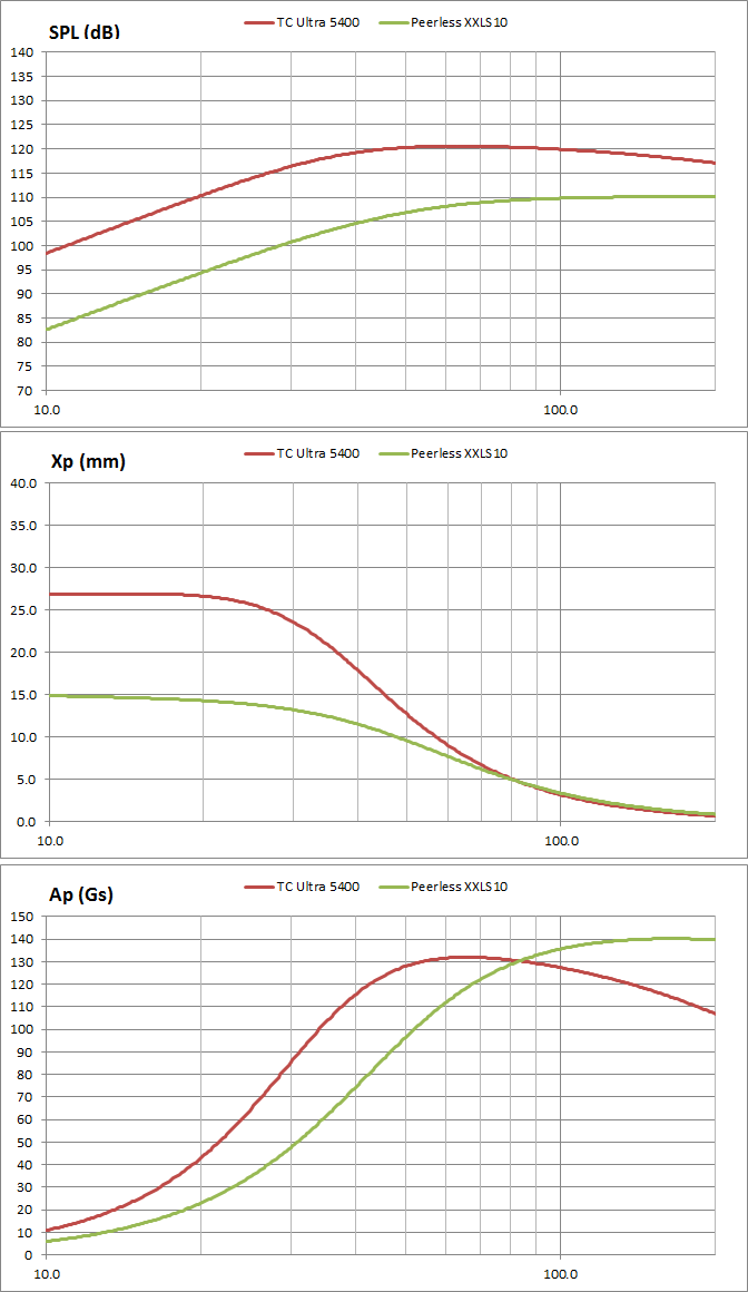

I´ve got some samples of the +-70g types also, which are more suited to most drivers. +-250g is rather the range for one of those extreme longthrow beasts like TC Sounds Ultra5400.
Since peak acceleration is proportional to Xp(peak excursion) x (frequency)^2, the largest accelerations generally occur at the top end of the bass range (80hz – 100Hz), not at the lower frequencies even though Xp is much larger there. When using smaller diameter, shorter stroke woofers, Xp can be just as high as for a large long throw woofer like the Ultra5400 in this range. Example plot compares SPL, Xp, and Gs for the Ultra5400 and the more pedestrian XXLS10. (Ultra 5400 driven with 1500W, the XXLS10 200W) Both would need an accelerometer capable of handling ~150Gs.
… ADXL chips are rather too noisy due to all the electronics involved ..
Thanks for the heads-up on the potential for high noise floor, did not recall that comment. What I had remembered was a comment about a 400hz LP filter built in to some of the sensors, but these particular chips do not have such a filter.

I did those g-calaculations too ... but restricted to <200Hz iIrc so that the figures wouldn´t grow too much .... it´s about subwoofers anyway so one can assume a working range <<100Hz.
As one increases the bandwidth the required g-range increases also, which on the other hand may then result in issues with the resolution of the sensor, resp. noise.
What imho seems passed unnoticed is that the quality of the sensor, its dynamic range, linearity, resolution and noise performance dictates the limits of the fed-back system in first place.
Accelerations sensors can have noise figures in the low µg/sqr(Hz) range down to a few Hz (similar to the 1/f noise curve of OPAmps) while the ADXL sensors specify noise in the mg/sqr(Hz) range .... almost a factor of 10³ higher!
Besides it seems that these sensors are obsolete parts already ... single-axis accelerometers with analog outputs are getting rare. :mad:
