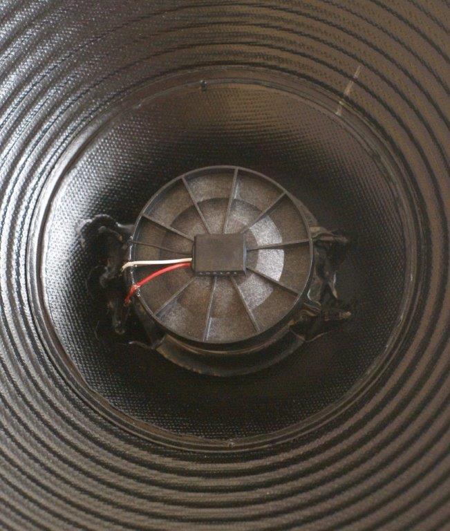

This seems exceptionally well conceived. Big feedback factor yet, I guess, doesn't blow up. Thanks for link.Wrt housekeeping, have a look at the link I gave in post #23, uses off the shelf components.
Interesting that he shows bandpassed tone bursts for comparison rather than the unfiltered ones you usually see. Not a lot different but a good move. The bandpassed tone bursts are closer to what it is fair for a real woofer to produce.
Ah, but there is an interesting falsehood in the data, one you see a lot. He/she shows very big distortion reduction (which goes along with big feedback). But what we are looking at is testimony of the accelerometer (ACH01-03). Not legitimate! That's the sensor! We need to see testimony of a mic.
Of course the results of the accelerometer will be looking good with feedback applied. Duh. That would be true even if the accelerometer were terribly distorted itself (and I am not convinced about ACH01's quite yet).
It's practical to do R&D while eyeballing the accelerometer. Bit performance should be based on a mic.
