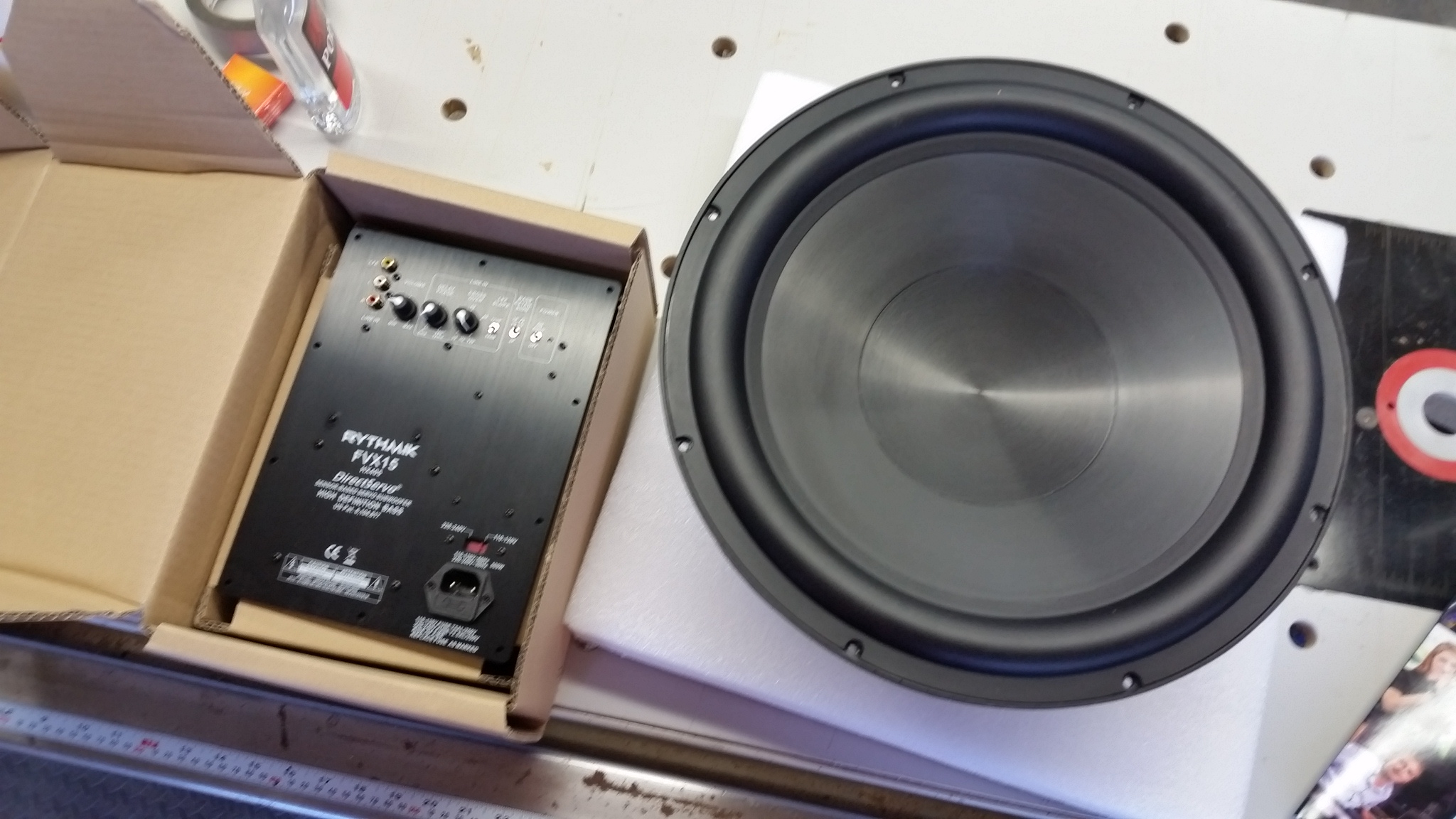

As with other threads on servo/MF, we have another who says it may not be worth it to pursue, that's fine. Everyone has to calculate/balance their time and money, and decide how much they can spend either of them.
As for me, at this point, I have a bit more money than time to spend, so I chose the route I did... Will the results be worth it? We'll see. If not, I'll need to do a ton more research, and that means a lot more time..😱
There is only one build thread that I know of using Rythmik's ported design on all of the interwebz. Interestingly enough, he transferred from sealed to ported for more SPL from one enclosure utilizing the same kit.
He also states that he gave up little to no sound quality in doing so, even though he was worried that ported would sound inferior.
Google translate does a decent enough job that I can follow along with the build and measurements, with the exception of a few words, particularly the word "cash", I sure wish I knew enough norwegian to understand..lol..
Oh, and the pics do help out quite a bit as well..🙂
Thread is here: DIY Rythmik FV15. Ferdig!

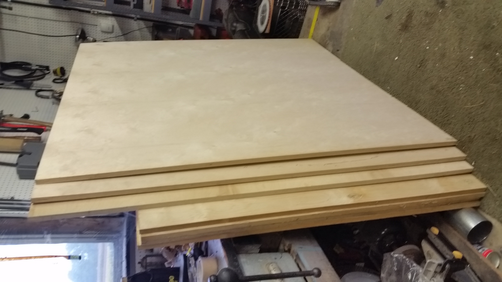

Fortunately, also helping in the money column, I just aquired all this BB. 3 sheets of finish-grade 5'x5', and 4 sheets regular 4'x4' (pic)

As Data-Bass says, he didn't think MF was for ported boxes*, but what the heck.As with other threads on servo/MF, we have another who says it may not be worth it to pursue, that's fine
Likely you still have no small amount of DIY fun ahead as your project evolves. Not likely to be just plug-and-play.
Ben
*except for mic sensors and insanely complicated DSP EQ, that's theory; the sound output from vented boxes in the region most important for MF around resonance does not correspond to the cone motion. Anybody think otherwise?

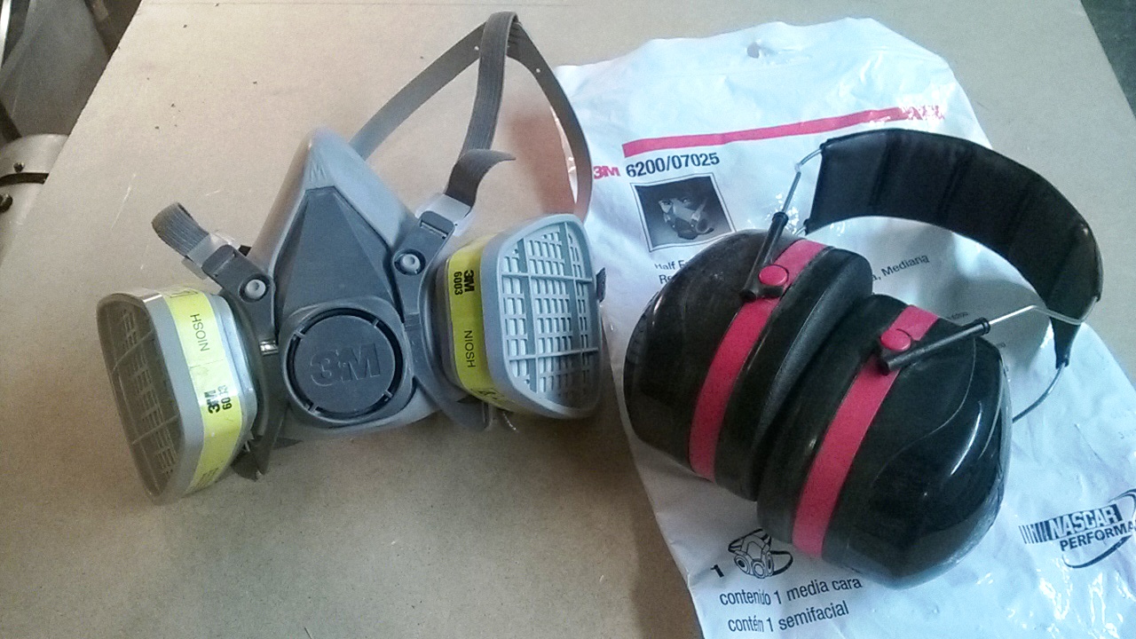

Hi wreckingball,
Good to see your progress.
Here are two tools you hopefully already have in your tool inventory: a decent gas mask and ear muffs. You probably know that the dust and noise from modern woodworking tools doesn't help one's health. I consider the 6200-3M half face respirator w/ the 6003 organic vapor gas cartridge a very good starting point, and at least 30dB hearing protection is a must.

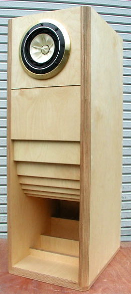

Hi wreckingball,
Nice thread you are linking to in Post #49. From the pictures it looks like there may be some problems with the bracing? The interior is divided into three chambers, w/ the woofer in chamber #1, and the port entry in chamber #3, I think there should be more holes in the dividers/braces? Did you get the sealed or the vented subwoofer kit from Rythmik, or can they be used both ways?
Well, the thread if from 2011, and at that time the sealed (F15) kit was interchangeable into vented. I hear they make a small change between the two now.Hi wreckingball,
That thread is just a rough guideline, as he changed both dia. and L of the ports, and as you said, the bracing.
I have that FV15HP kit's 'little brother' (His= 600w&15xx driver, mine 400w amp&1501 driver).
I agree with you about more holes in bracing, I think he did his that way because only using 12mm thickness for them.
Mine are going to be primarily 1.25" doweling, of which I have a ton leftover from my old job.
Would you be interested in bouncing some construction notes around (no pressure, respond when you like) via this thread or PM?
Reason I ask is I am not following the general shape of the FVX15 box, and those are the plans Rythmik sent me that correspond with my kit(s).
Cheers
I'd allow for the possibility of sealing the ports or aperiodic (resistive vent) or leaky box (which is close to MF assumptions).
Then, you'd get some percussion music such as Paul Lansky's Threads (performed by So Percussion)*. Great music and should show how much "group delay" remains lurking with vent-MF and if you can tolerate it. That will help clarify whether you want vents or sealed. Likely you can record speaker playing clicks and audition them in close time comparison.
+1 about tb46 safety ideas. I saw outdoors.
Ben
*percussion transients are spectacular with electrostats
Ben

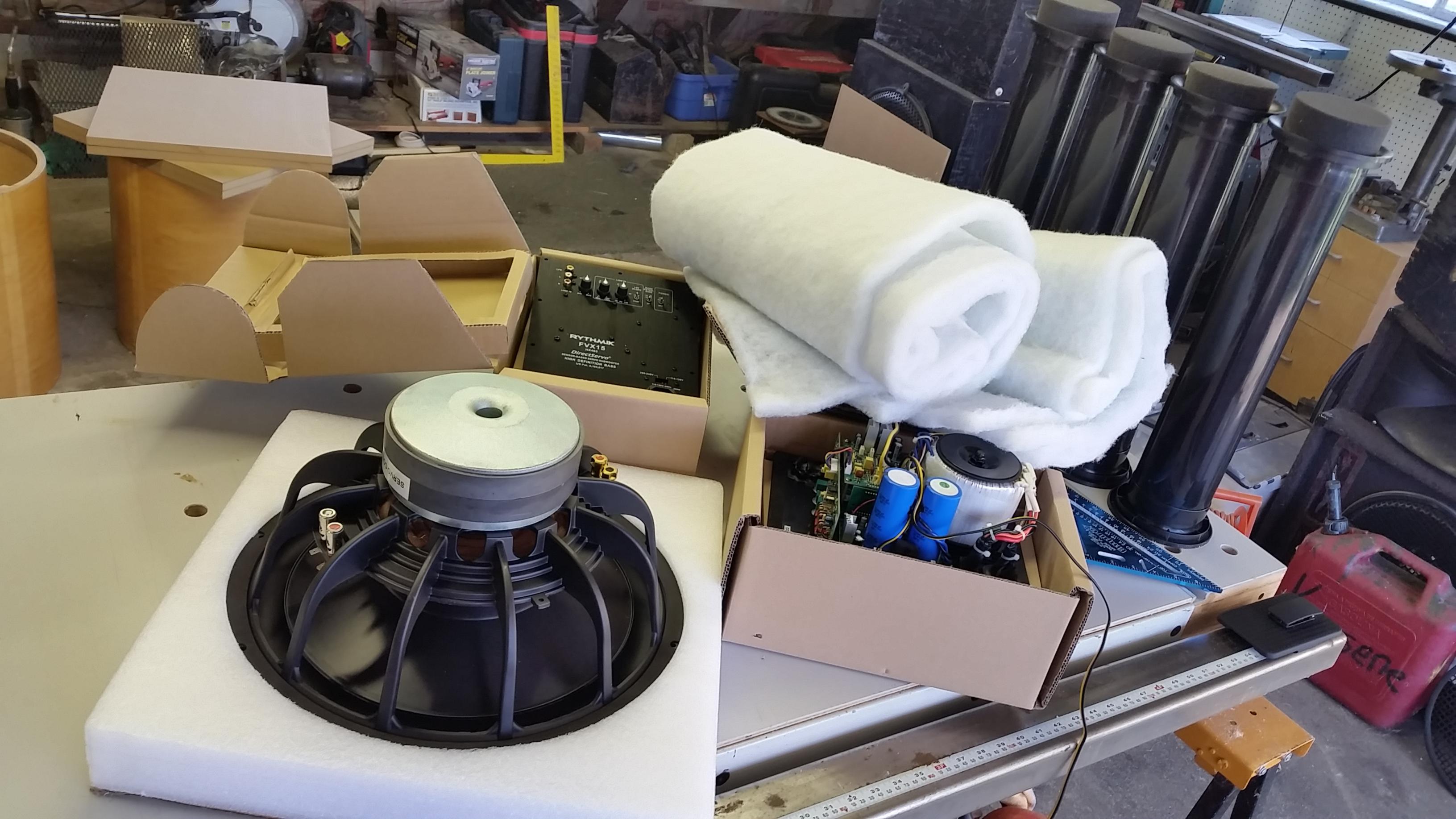

@ Ben
Already part of the plan, and they included tight-fitting foam plugs that go about 5" into the ports.
But since you bring it up, let me run this by you and everyone.
On the site they say using the plugs on both ports results in aperiodic loading/response.
But what if I used something that could completely seal the ports? Would it then act just like a sealed box, or would results be undesirable?
A simple pluming product like this, (hey, if it holds water ...then ?)
The ID of the ports are 3.5" this says max of 3.75", and min of 3.23".
Could hide nicely under the grill or be painted I suppose:
https://www.grainger.com/product/CH...g-1VNG2?opr=APPD&pbi=3EJN8&analytics=altItems
I'd just have to be careful not to over-tighten..😱

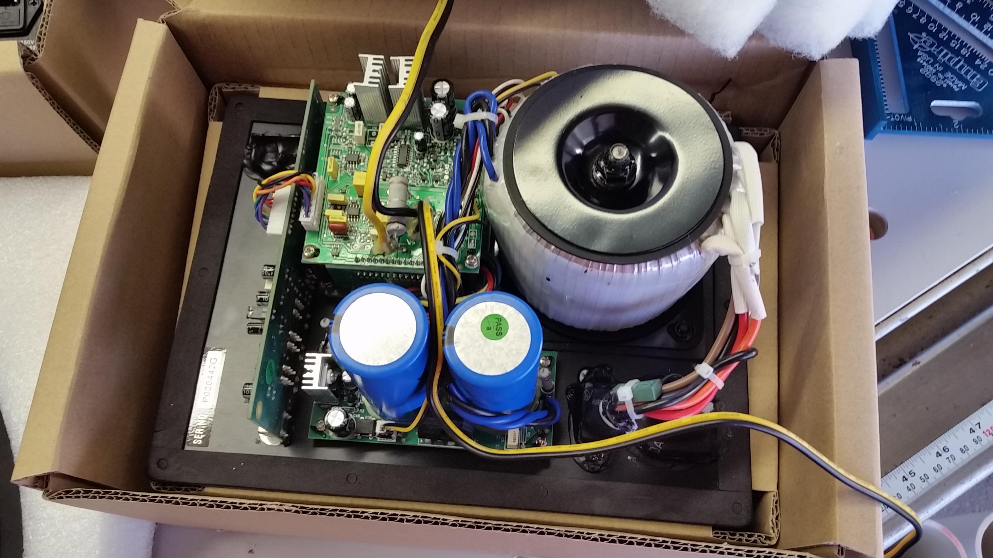

@ Oliver
OK, great..🙂
Yes, I know that the boards in the amps have differences now, I seem to remember Brian letting someone know what needed to change to go from sealed to vented.
I wear glasses as well, and because they're required for work they are safety glass.
First construction question: I've always used veneer or several coats of primer/paint on my subs, so butt joints, screws etc. were always used.
These however, are going to be all finish-grade Baltic Birch, with the exception of the dowel braces.
Do you think that mitered corners is a good idea? Difficulty level?
I have a TS with a t-square fence system, so the actual cutting should be relatively straight forward, but what about (one-man) assembly?
I have a biscuit machine and biscuits, but what about voids due to tolerances? Difficulty using on mitered box?
Also because I'd like the 4 sides to be one continuous piece of BB from top to bottom, I was thinking of placing the back/baffle inside of them, do you foresee any problems?
Linking to a site if you don't feel like typing all that is fine too.
OK, great..🙂

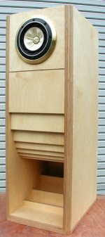

Thanks Oliver, for the links and all of your notes, much appreciated.
I got to thinking about roundovers applied to the void-free birch I'm using..
I think I am going to go the rabbet route, then roundover 3/8" (half thickness) for a nice looking edge to the boxes, should not be hard with the equipment I have..
Unfortunately, I do not have a working compressor for my nail-gun, but I think if I cut the back, braces, and double baffle first, then glue them up sequentially, I'll be OK.
A pic of what I have in mind is on the lower center of this picture, minus the modifications up top:
The table saw and related, fire up tomorrow!
