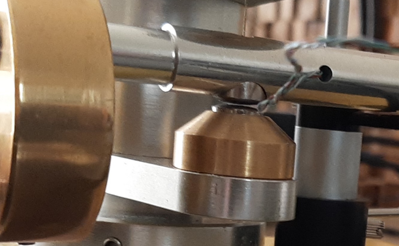

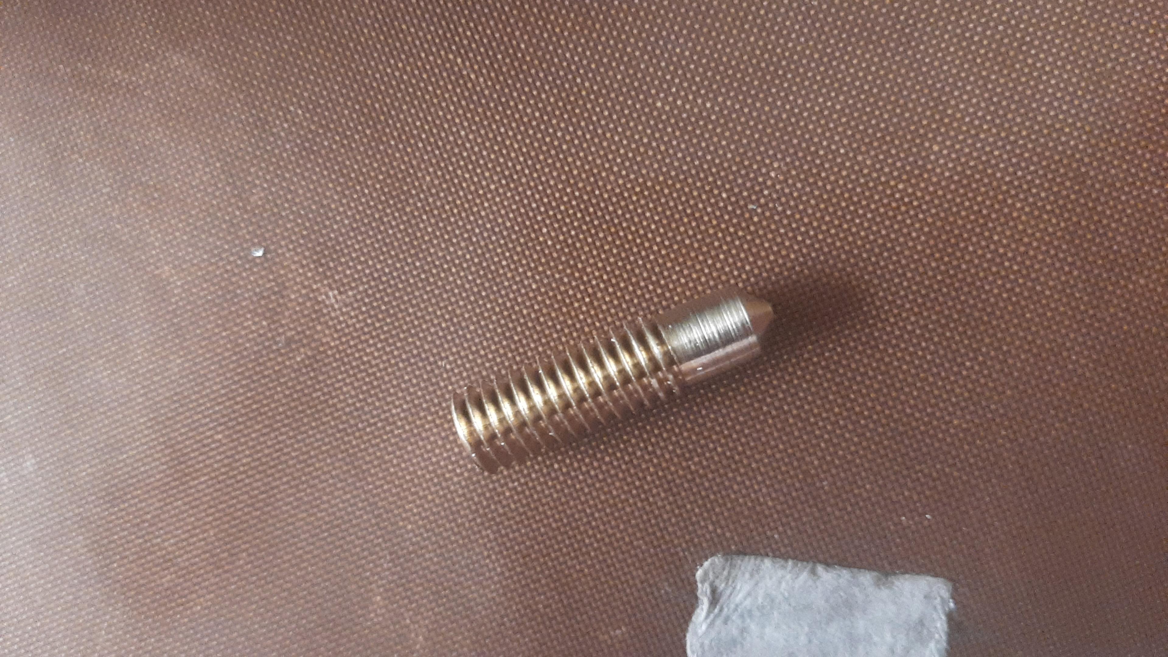

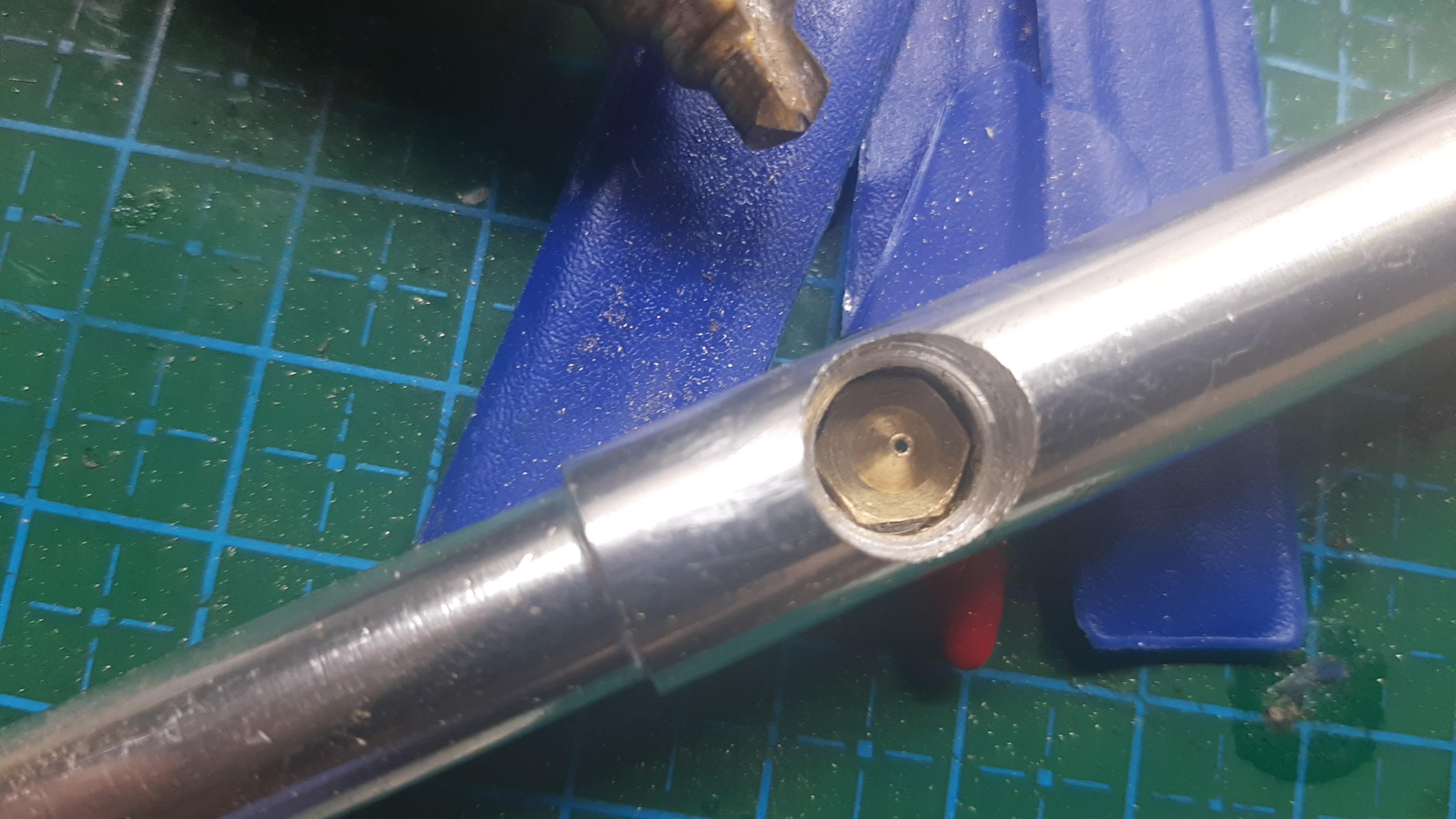

very good thank you I think I solved all problems and finally comfortable with all the compromises. very confident it will work very well.
the 3d printer nozzle works great. I use 0.8mm for 0.5mm fishing line. so can do final adjustment to adjust the gap of the magnet.
I bought a machine drill press but alas very poor accuracy. so this is what I could do best. tried drilling magnet but I got the wrong kind of drillbit. I think I need diamond.
all road lead to Rome once a smart man said.
thinking of remachining new parts waiting for the dreaded covid lock down before I can go to my friend.

I'm sure with enough patience and proper tooling it can be done.
Execution my problem here since I'm using a Chinese cheap drill. it's already wobbling.
so I have plan a b c.. and I pick one what works best in my situation. luckily 3d printing nozzle is there. it's centerd and perfect hole alignment. I inverted the nozzle and so the pivot pt is 1 to 2 mm above the magnet. best I could hope for.
I think I can just adjust the magnet gap and play some with counterweight . to get it right all left to be done.
the sound and tracking is already alright before revision. vtf is all over the place however. I'm very optimist this revision to get the center pivot solid perpendicular and better magnet shape will make it Alot better. lastly a more precise armboard . all will be working in a month or two.
my dream is to get a soundsmith cart next for this. delicious yes?

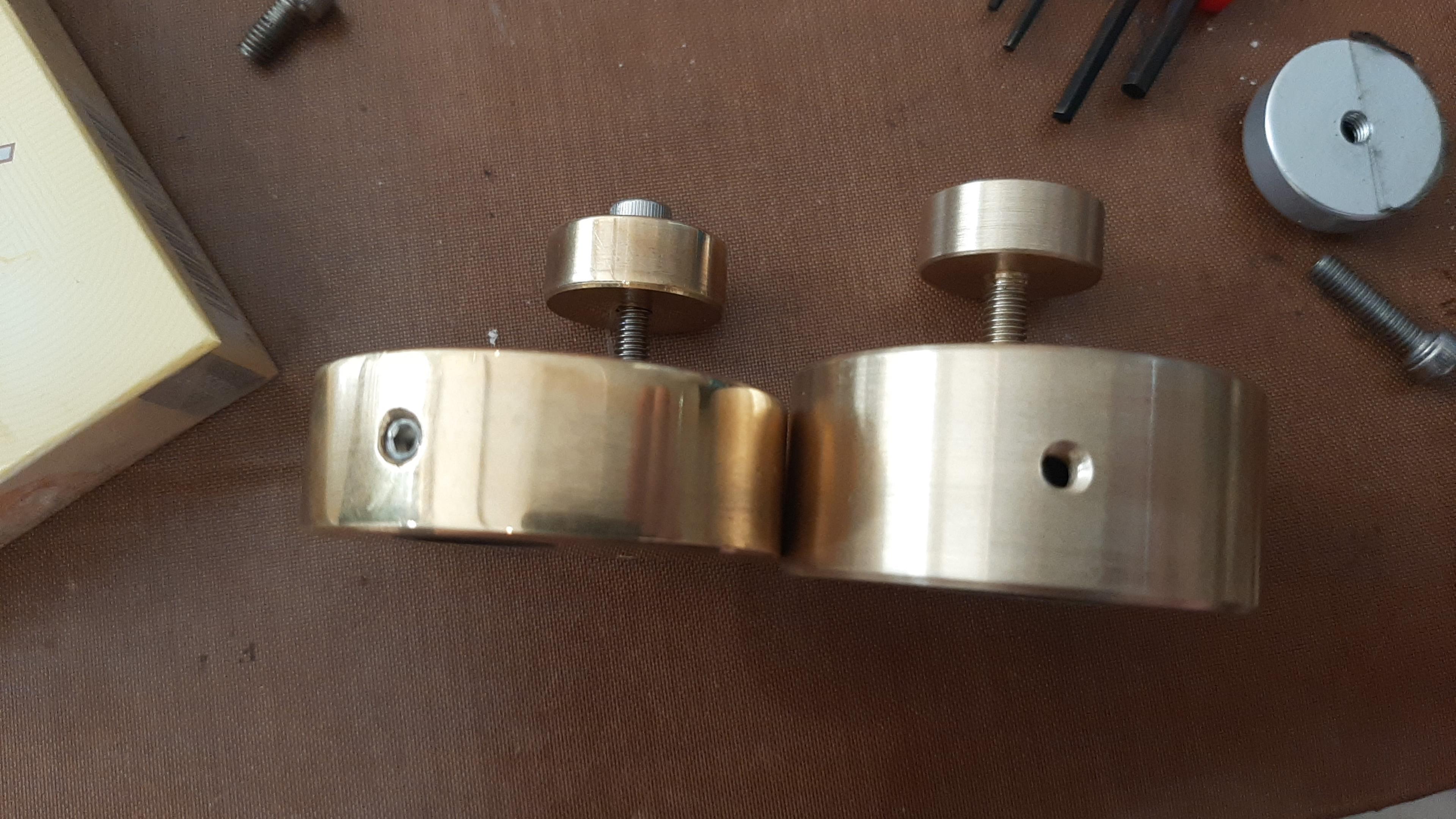

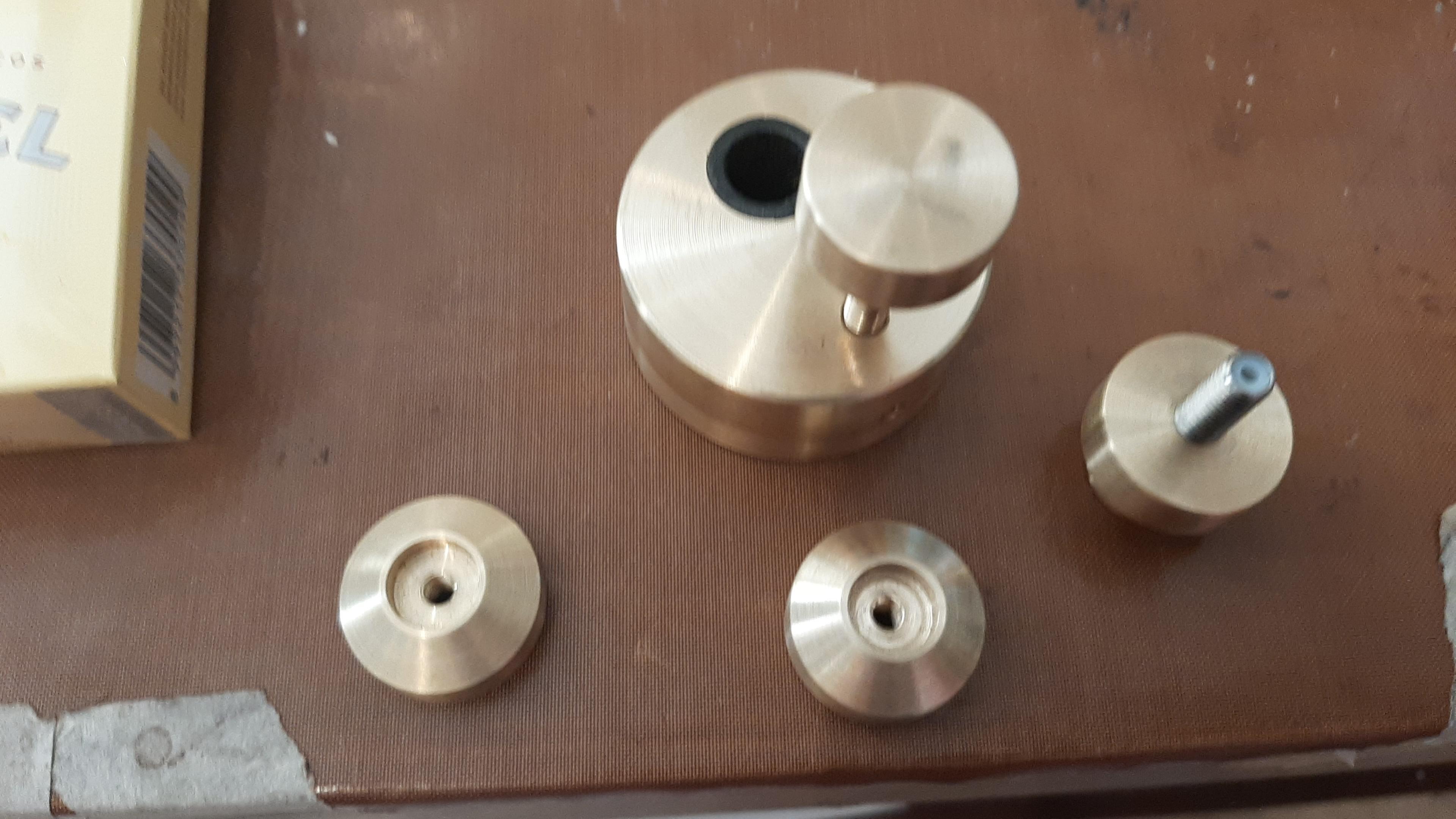

almost done
happy with the result of re machining parts.
also buy a dozen magnet all fits differently find the one that can correct fit to the hole for magnet.
i had tough time tying the string took me 3 hours it's very very short that's why. eventually I used a modified knuckle using 2 strings to get the knot as close as need to be.
burning in cable and in few weeks I'm done

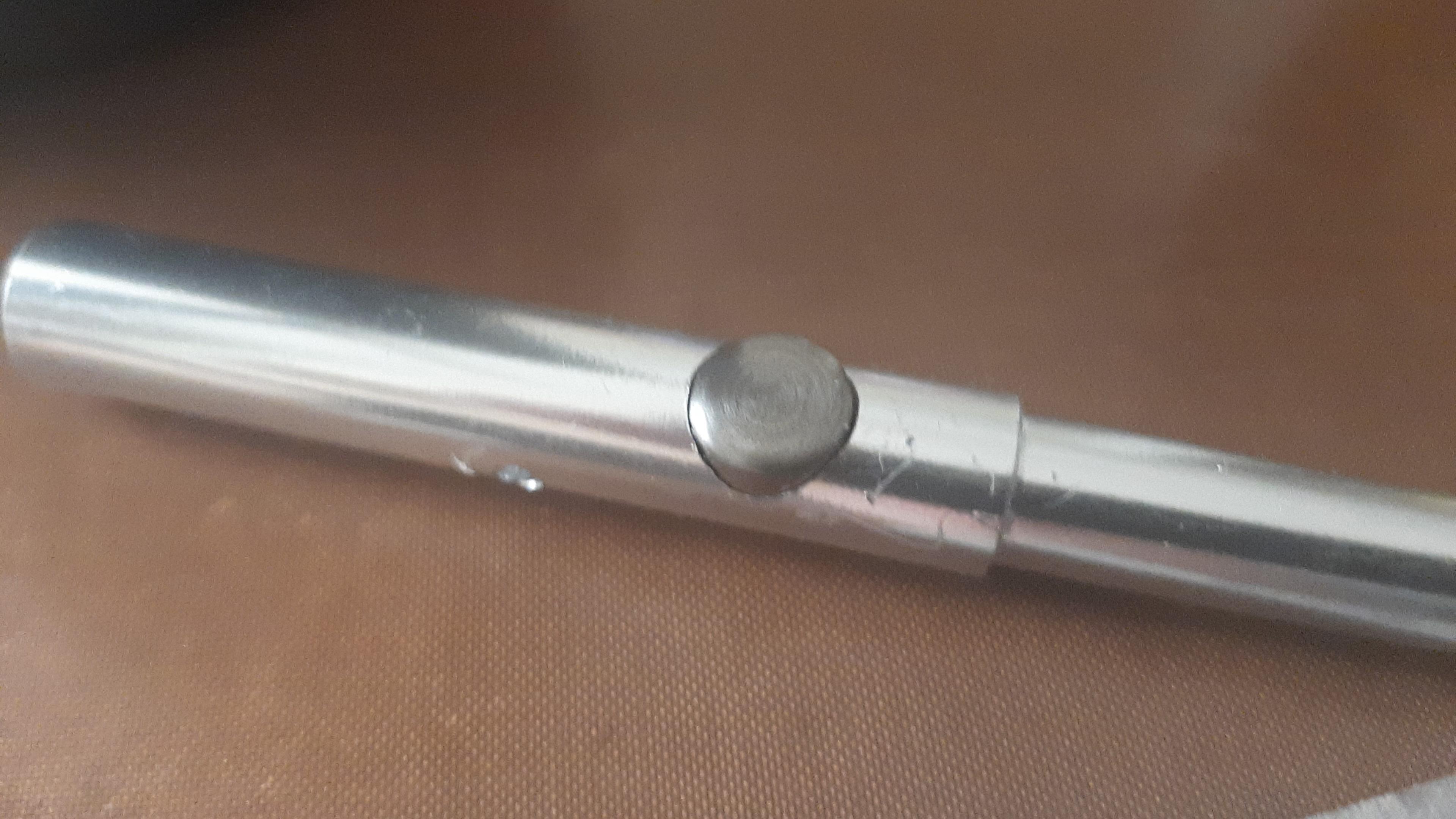

drilling such a small hole to have a center perpendicular axis is difficult let alone tying a stop knot that is so short. the 3d nozzle is great for this. the top side can be modified so can adjust the magnet height with turn of the screw.
even the top and bottom inserts it's made precisely I ordered more pieces and luckily got one that fits the fitting more perfectly. magnet sits more parallel. this is the tough one
I bought a bunch of magnets and found the perfect fit for each hole and grinded the top one more so it's thinner. also making the pivot as close to the magnet
the counter also bored slightly more center than before and heavier. aiming for either 10 to 10.5 inch tonearm.
teflon itube inserts is added to tonearm so the hole is now 2mm
closest to ideal within my capability. and appreciation for the ideas brought forth by Mr Frank. and support from Adelmo
devil is in the detail.. now I appreciate how much time and care is required to do this arm and why a simple design cost asmuch.. makes it cheap. not a simple make and assemble. can't get rich doing this. it's a love of the art, science and music.
with the total cost I could buy 2 2nd hand good condition tonearm but this is great fun, priceless. thank you everyone here for clarifications.

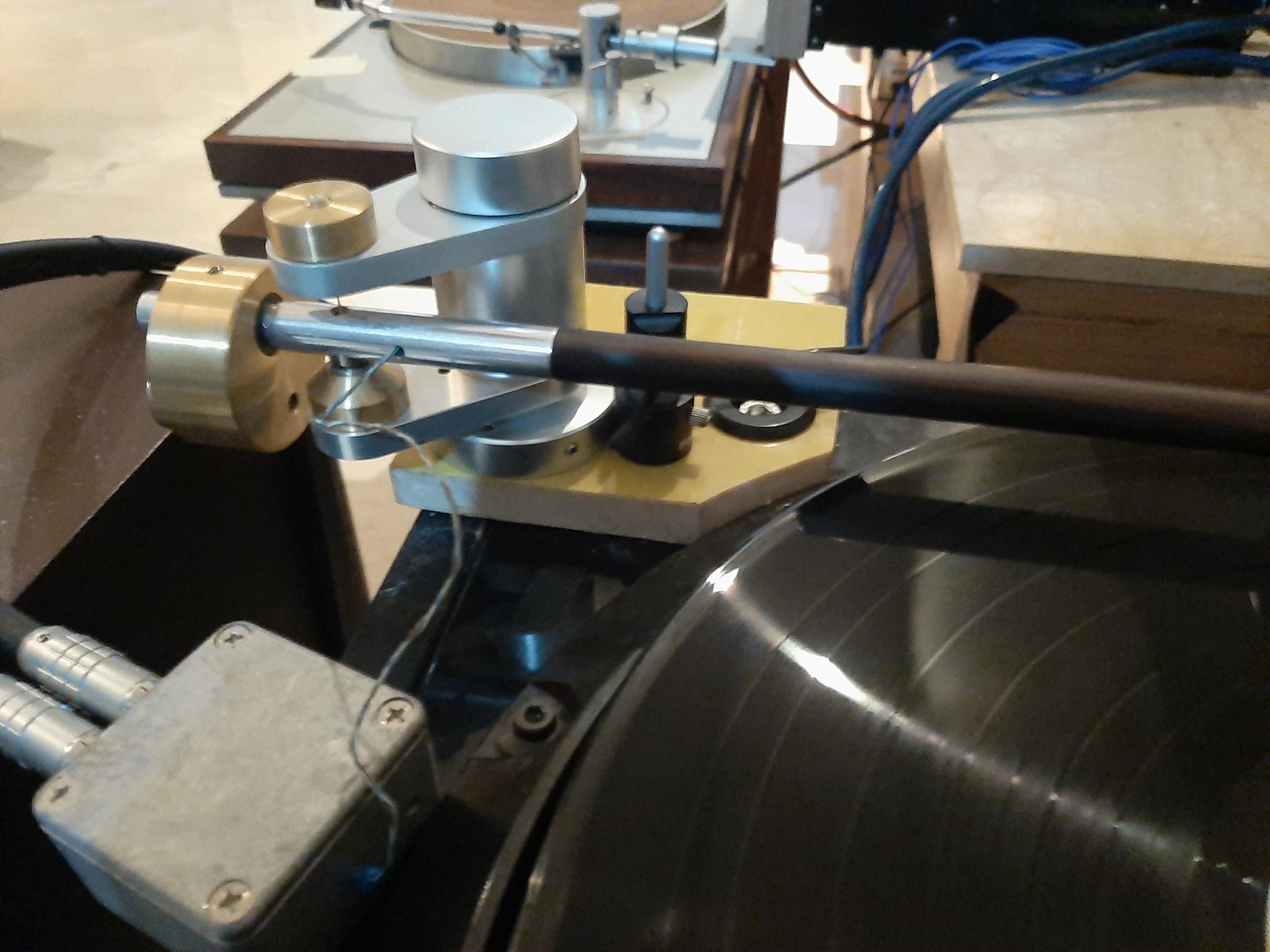

I found a fundamental mistake. the tonearm should be mounted closer to the turntable but maintaining the pivot to spindle. so the counter weight can move closer to the pivot without getting stuck.
It's difficult since I need a tightly placed arm lifter and I'm forced to stay at it is. my design flaw.
this tonearm is indeed worth its effort. listening for a week. it's almost like listening to a very low jitter system. the bearing free frictionless makes the cartridge a dream tracker.
it also behaves like some of the great tonearms. it's like the tonearm isn't there.. transparent. less coloration but more music. I could listen to it whole day long.

diy Frank schroeder. re mounting - YouTube
remounted so I could replace it with a even heavier and more center counter weight without getting stuck . apparently this is the way to mount it. the more centered counter weight have less vtf variance with diff thickness.
clearly better match of compliance. I think it's safe to say this beats my favorite tweaked out sic bearing Epa100 technics. and what I think is superb. FR24.
the image is now huger, taller and wider. fuller bass. even better energy than before.
amazing amazing tonearm. Thank You Frank! for providing so much help. without the explanation I don't think it will be a success.
