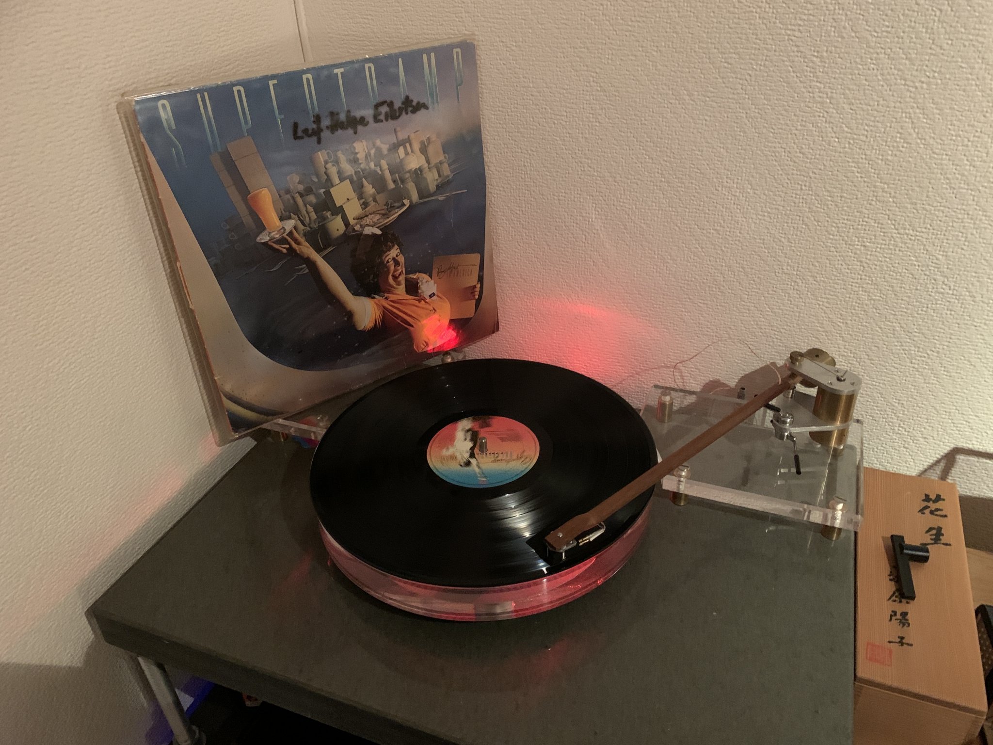

Long time since I was active here on diyAudio, but here is my Schröder clone:
Finished just a couple of days ago, almost 15 years after it's beginning.

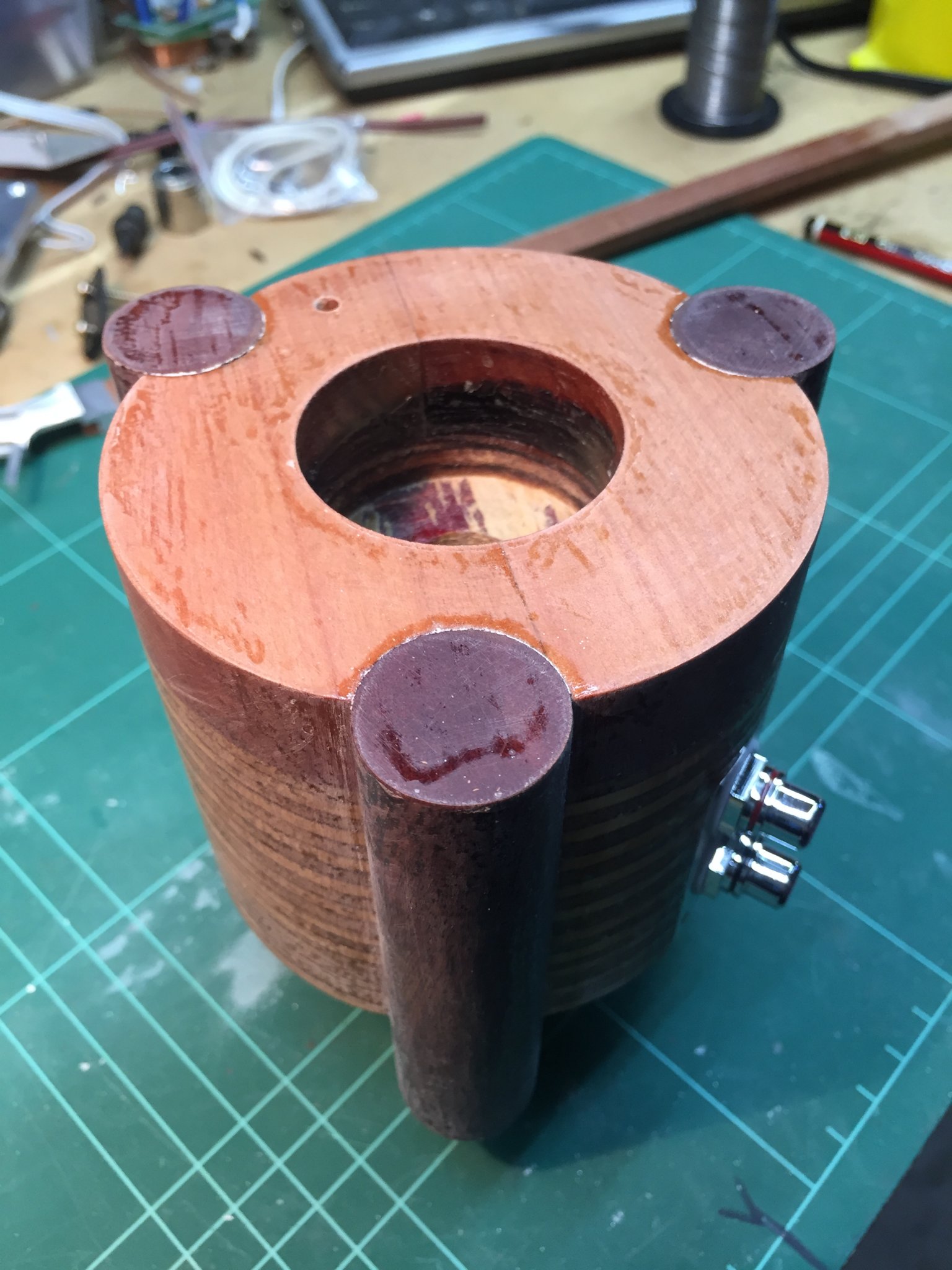

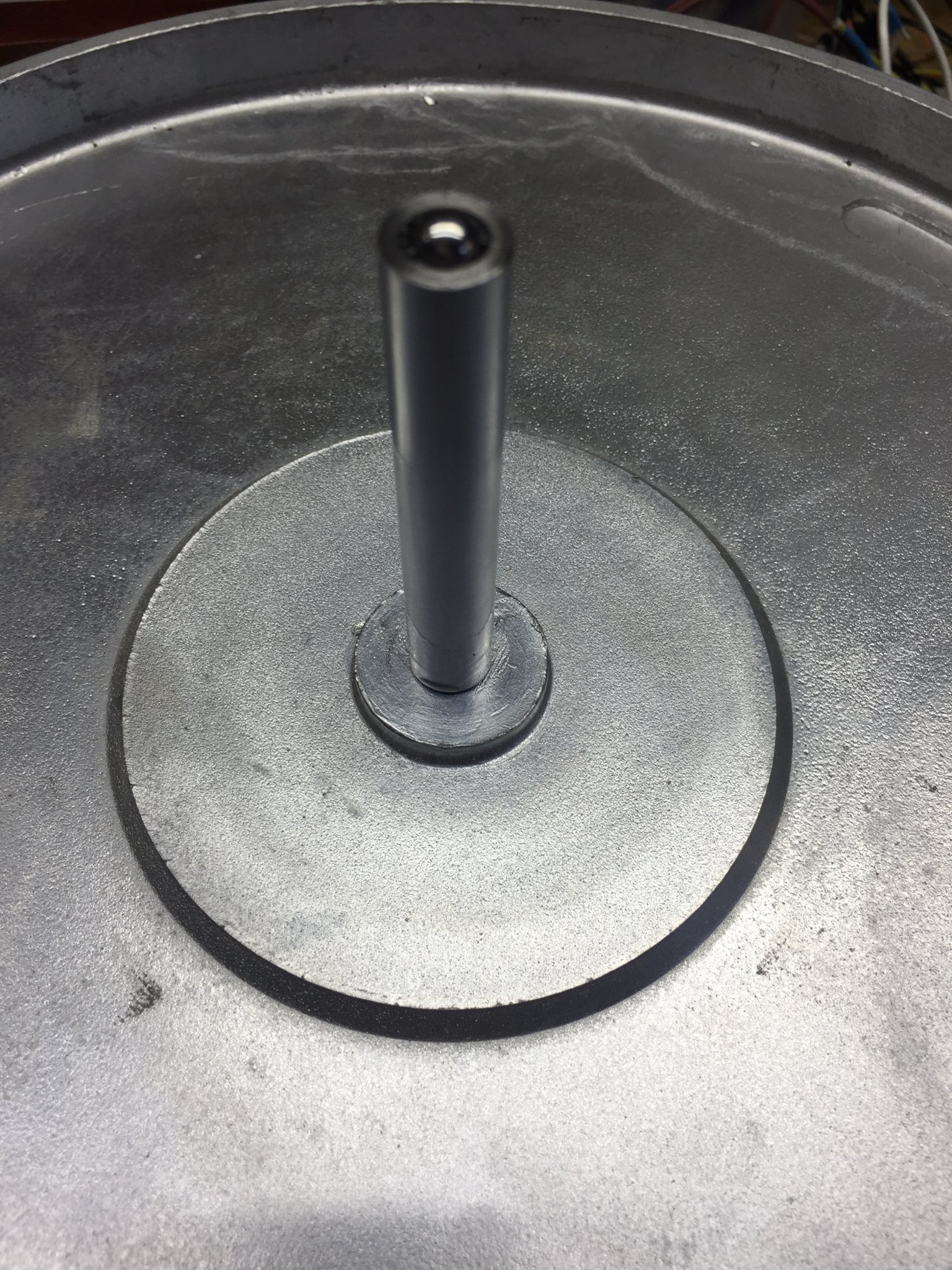

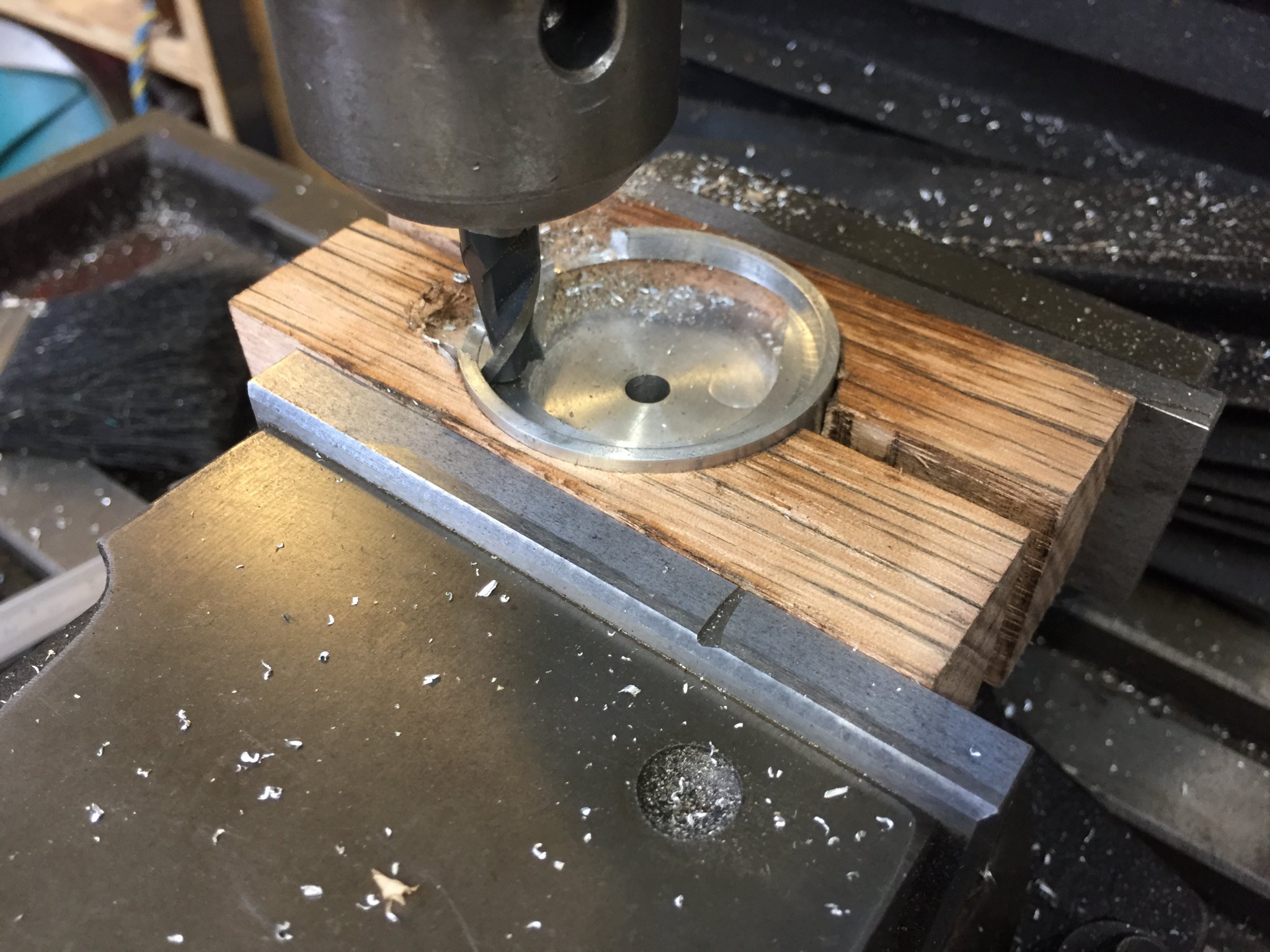

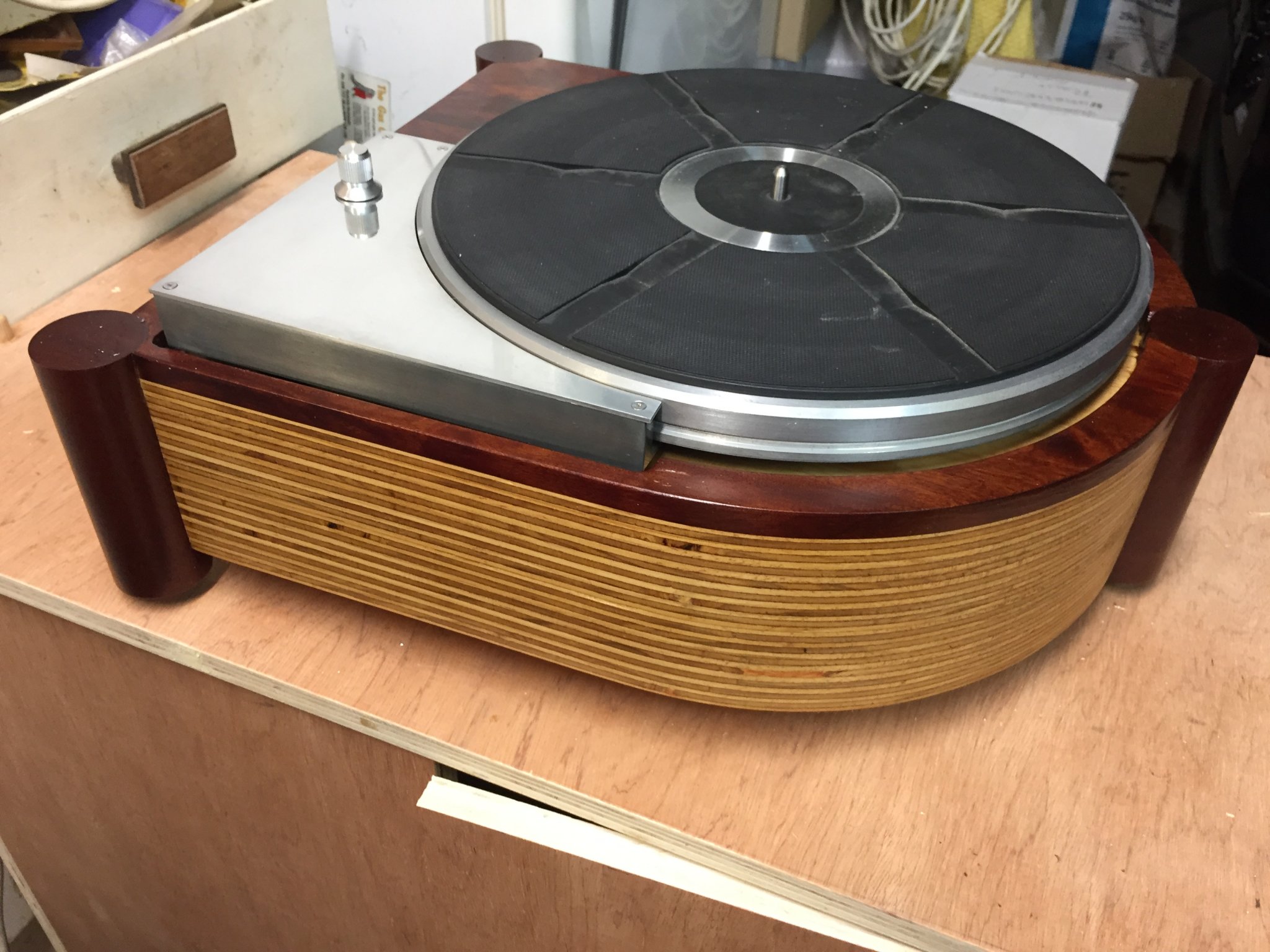

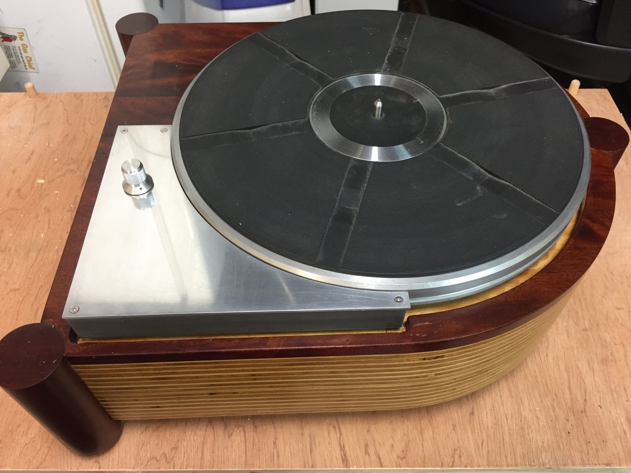

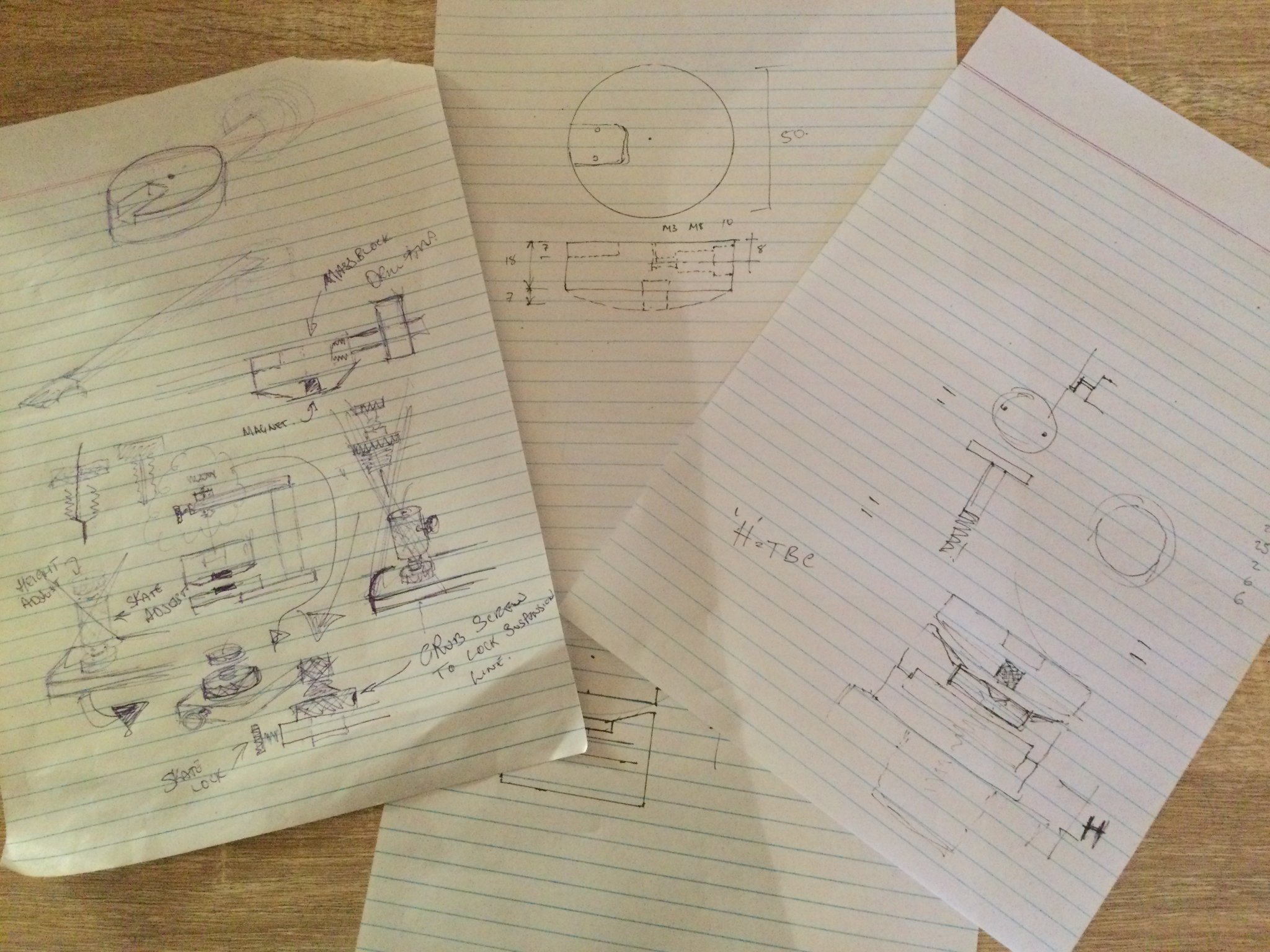

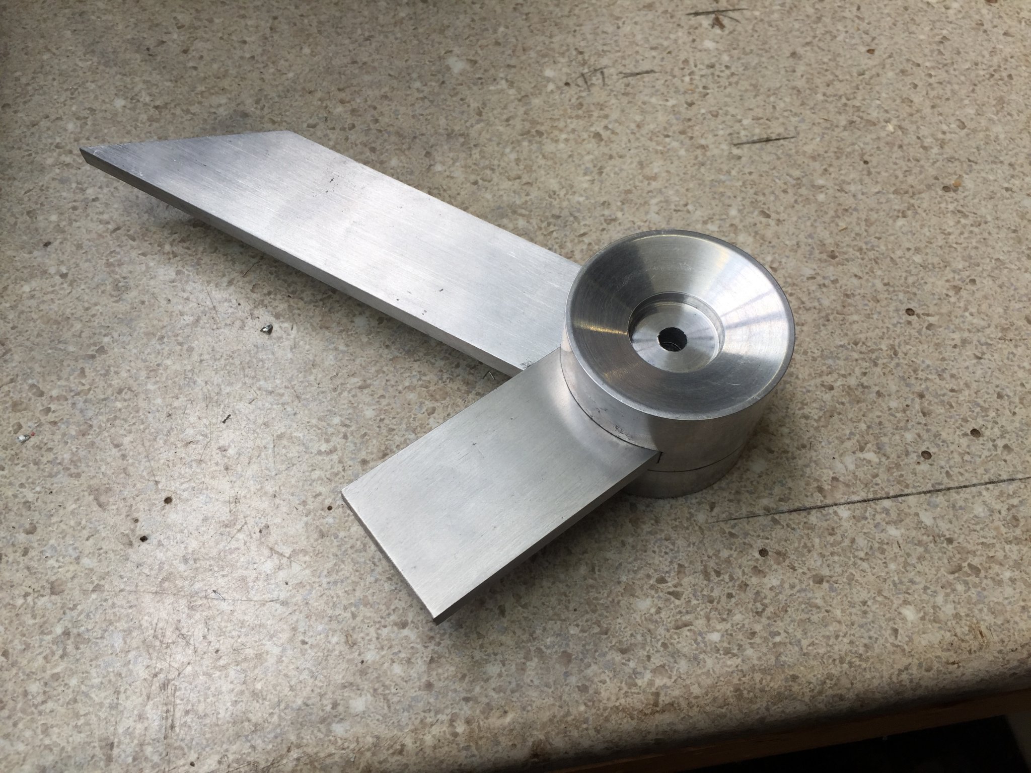

After a hiatus of quite a few years, I’m back posting on the forum. I would like to share my turntable and Schroeder tonearm build with you.
I don’t want to dwell on the turntable too much, but I’ll give you a brief overview. Its an old Silcron / JH Reproducers turntable that I have built a new plywood / hardwood plinth for, I have made a new main bearing assembly and three point spring suspension.
The proposed tonearm will sit on a separate mount which is almost complete. It’s early days for the tonearm, so far I have a Myrtle wooden arm and an aluminium head shell that I milled out of 6mm thick ally. I have some aluminium bar that I plan to make the body of the arm.
I’ll post pics as the build progresses.

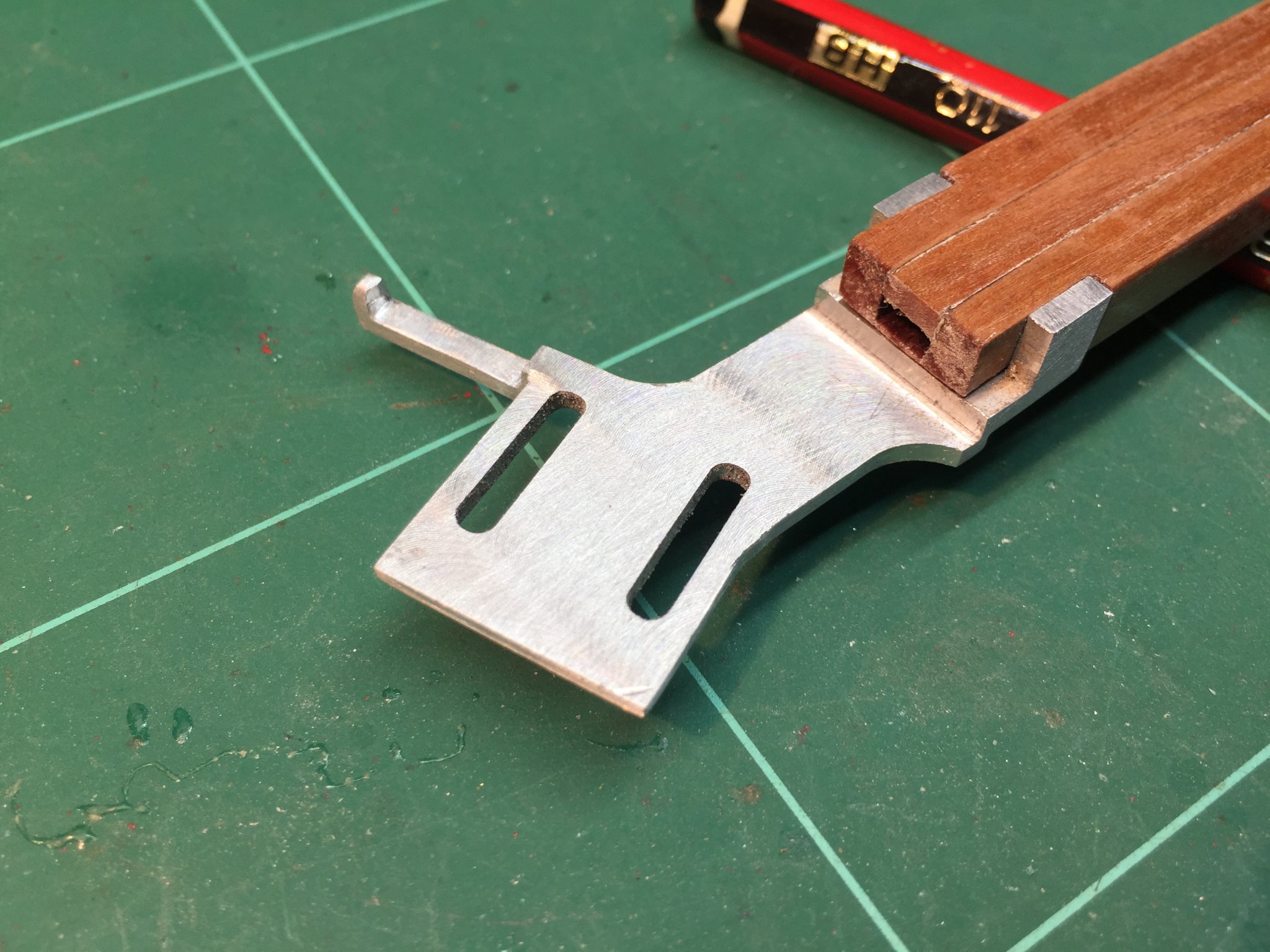

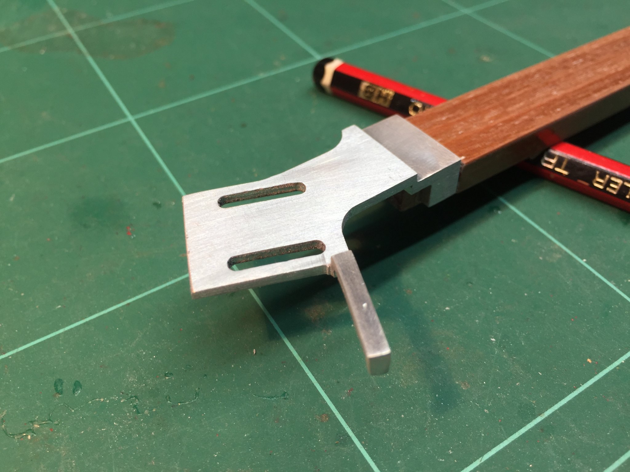

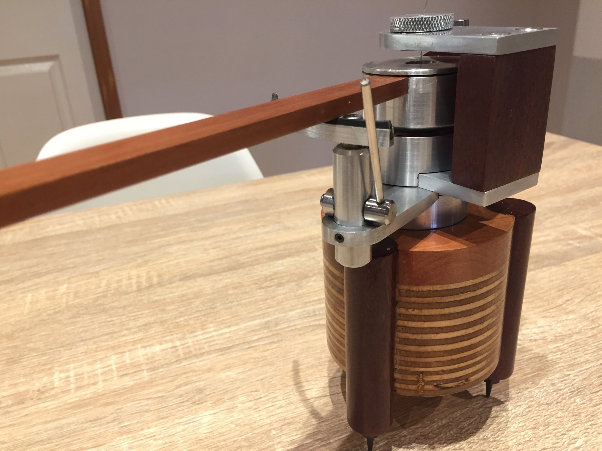

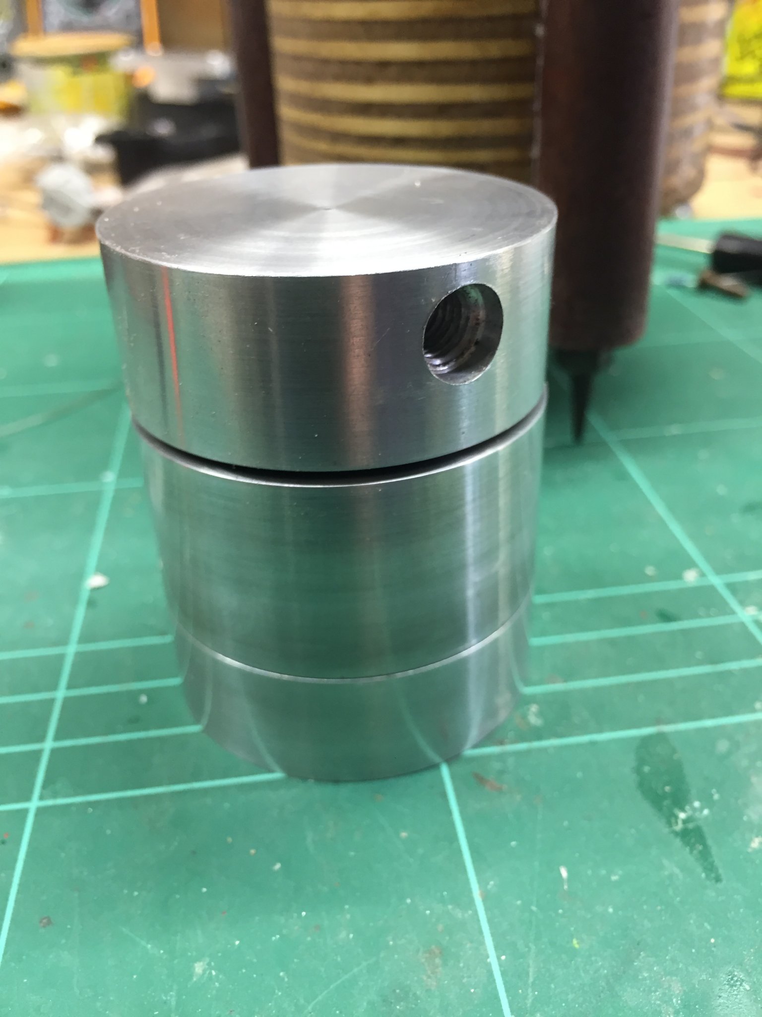

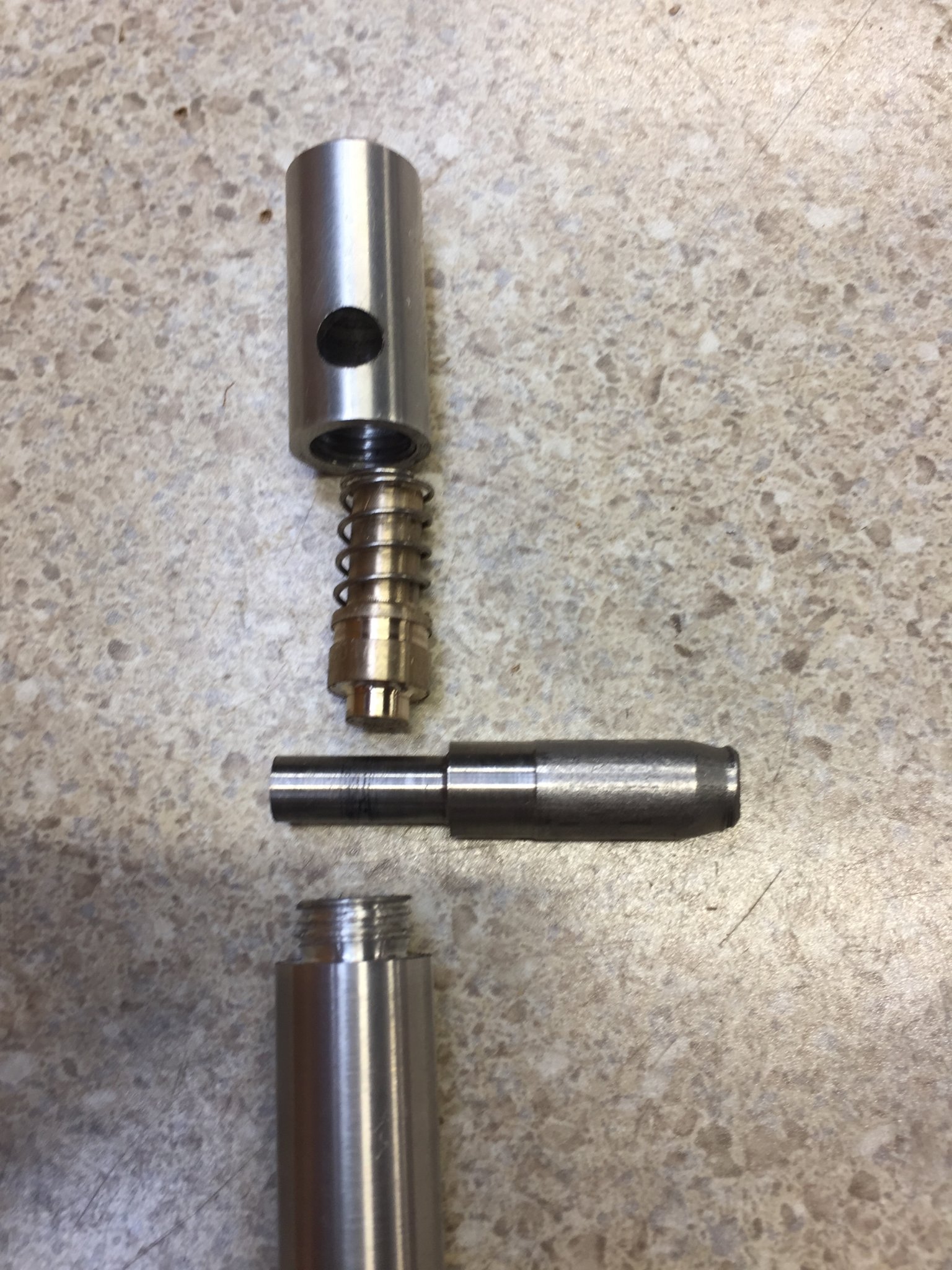

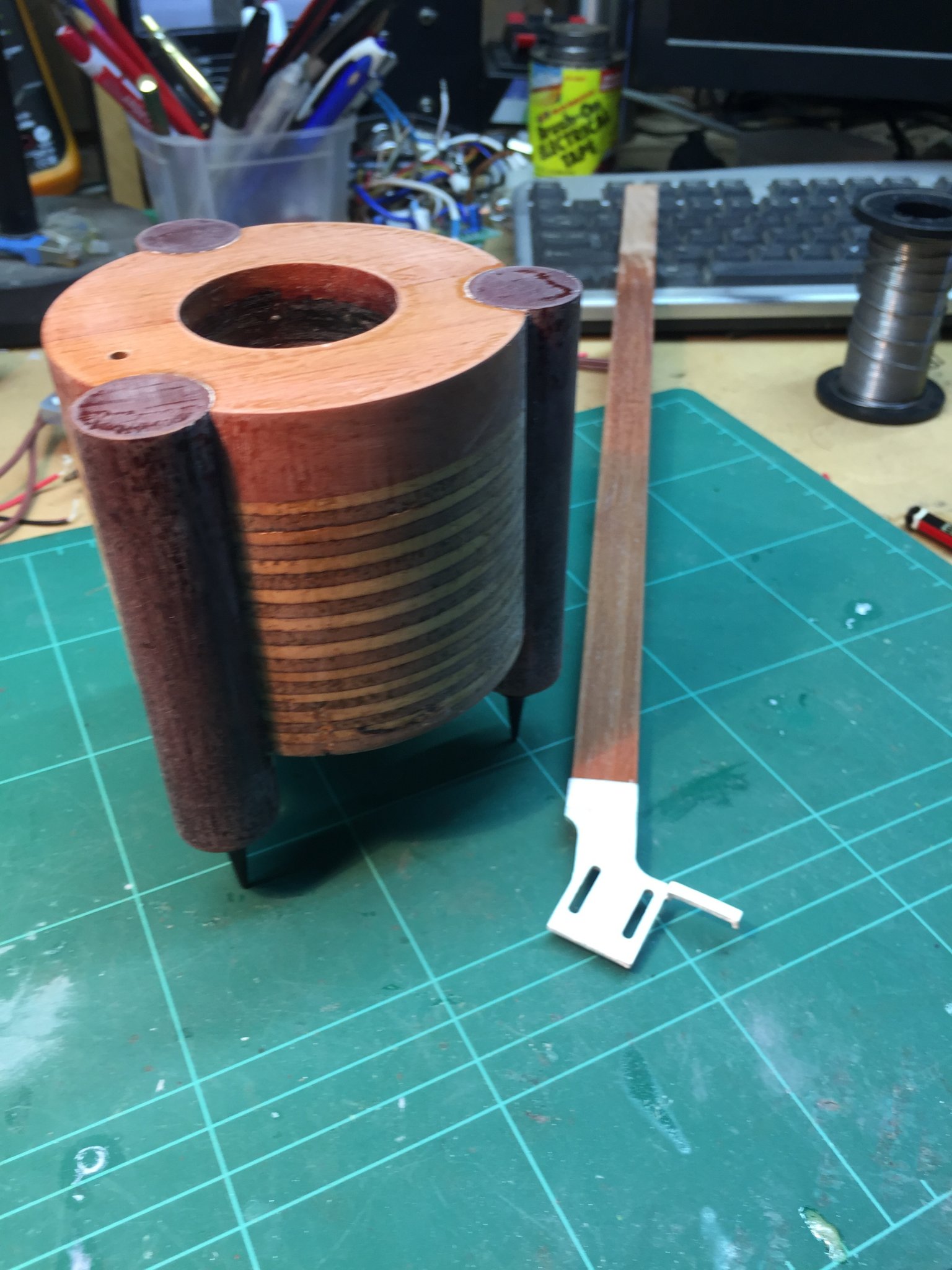

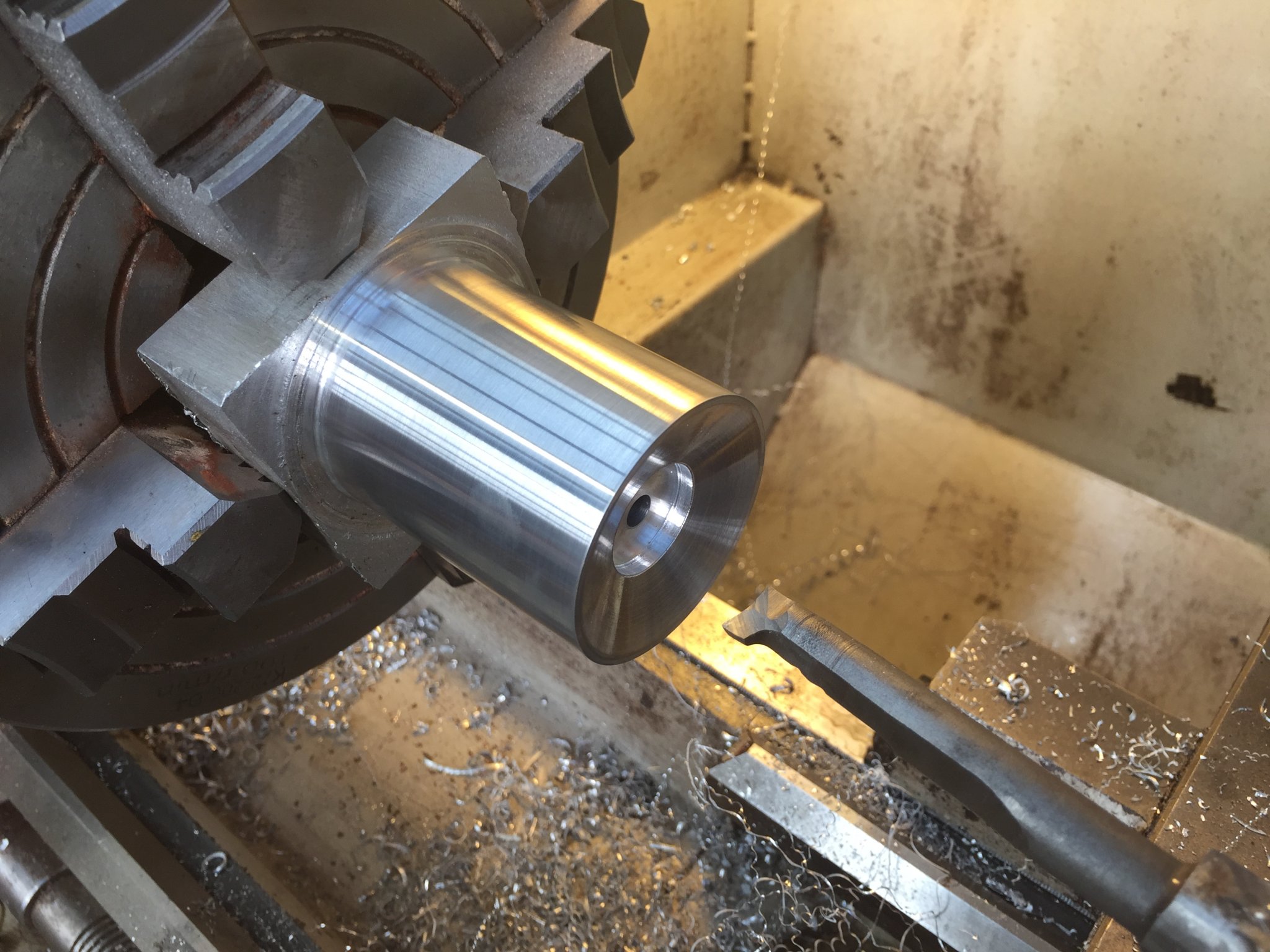

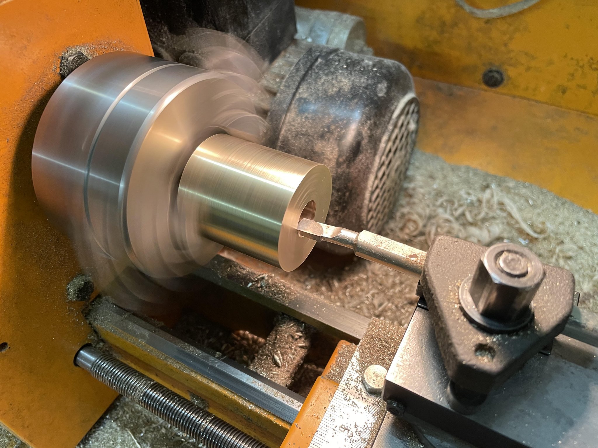

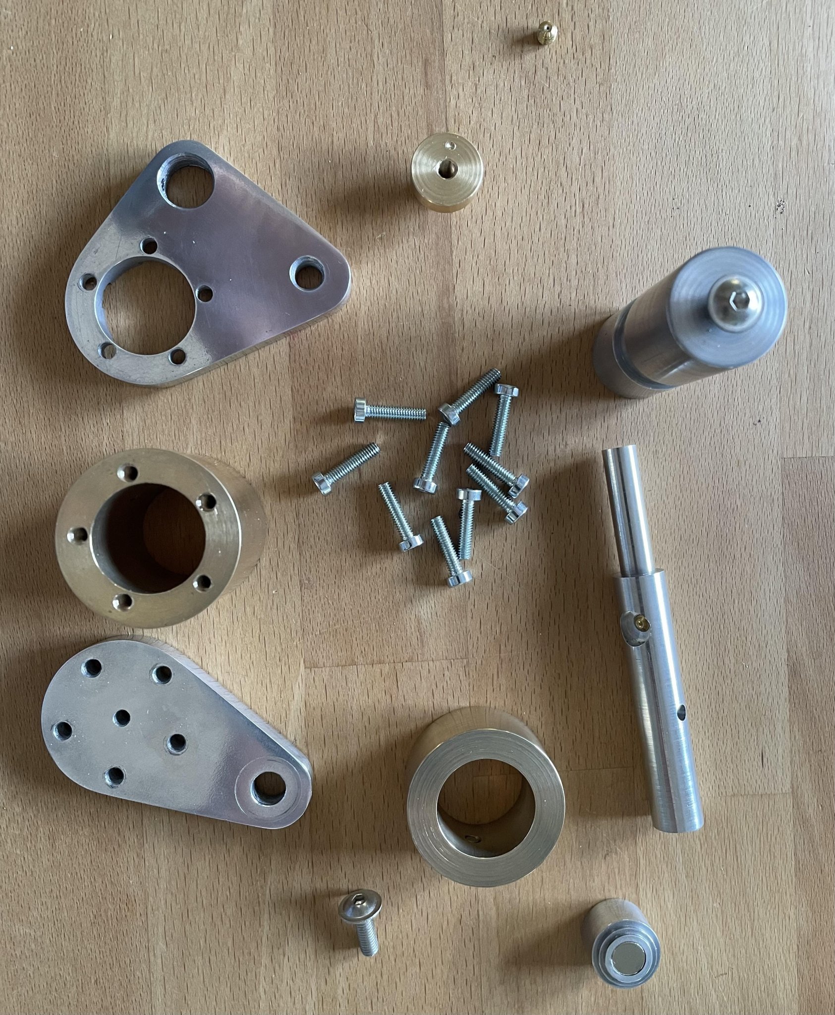

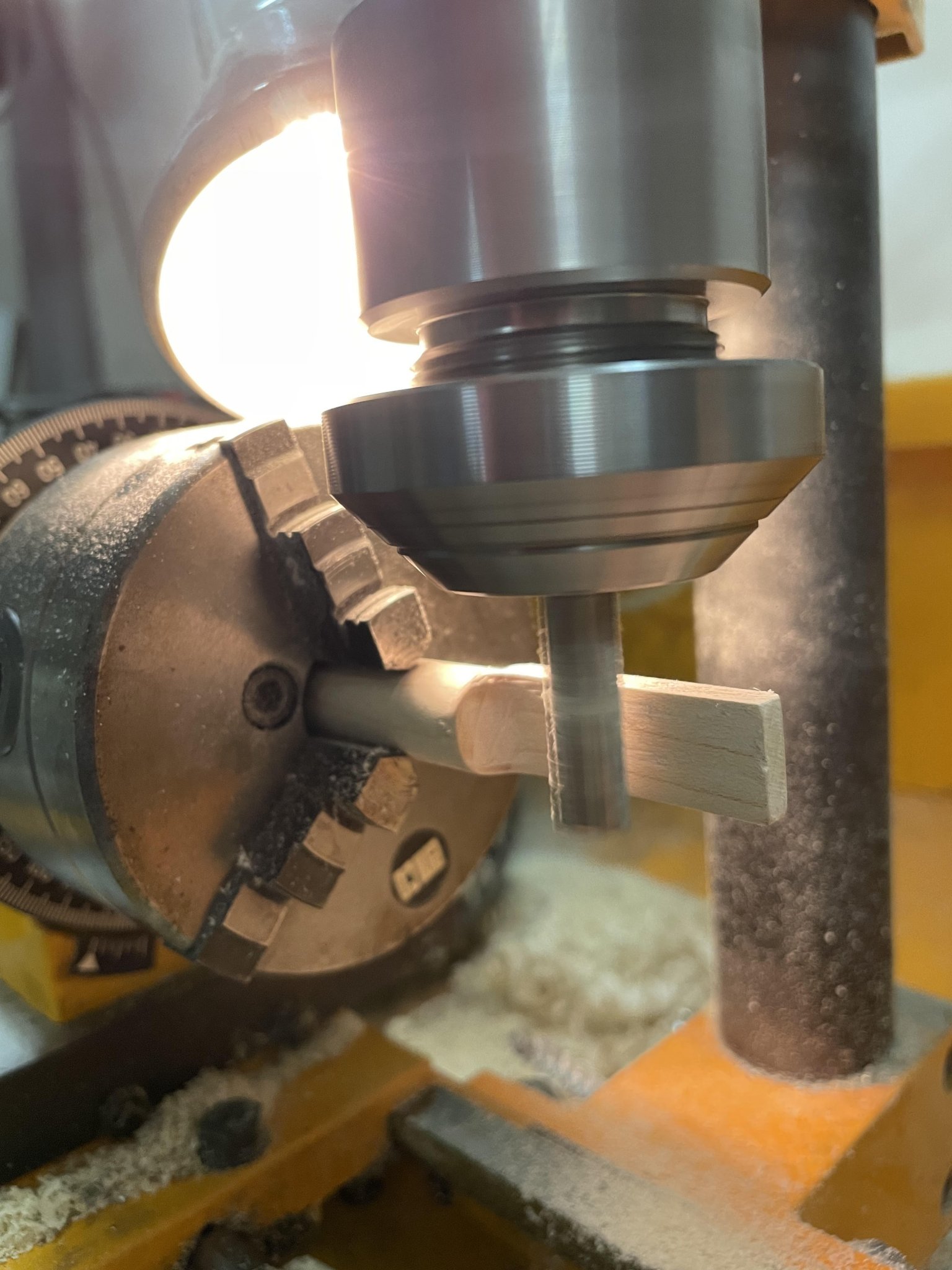

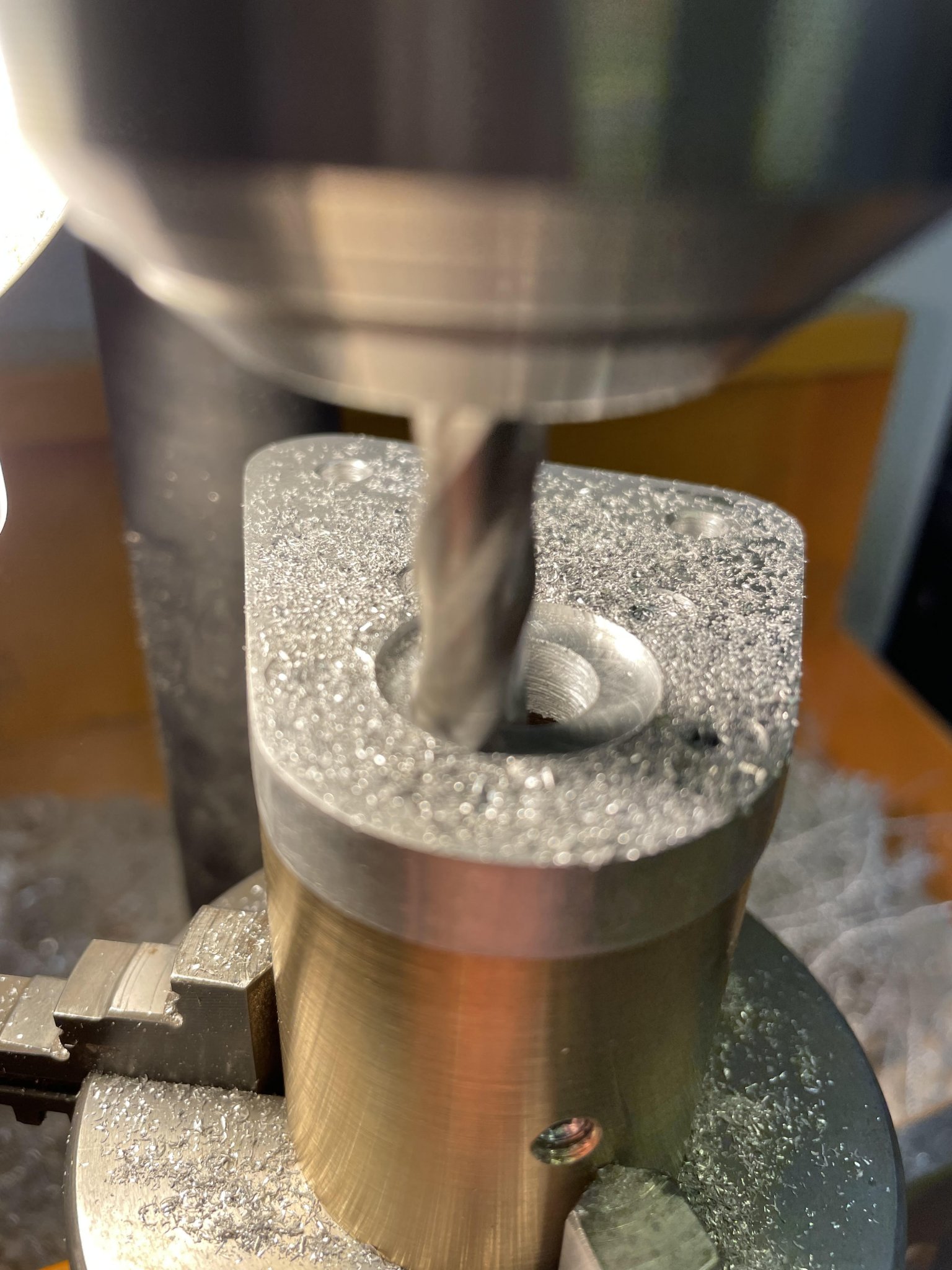

In between a full range speaker build, some progress has been made on the tonearm. And beginnings of a lift mechanism.

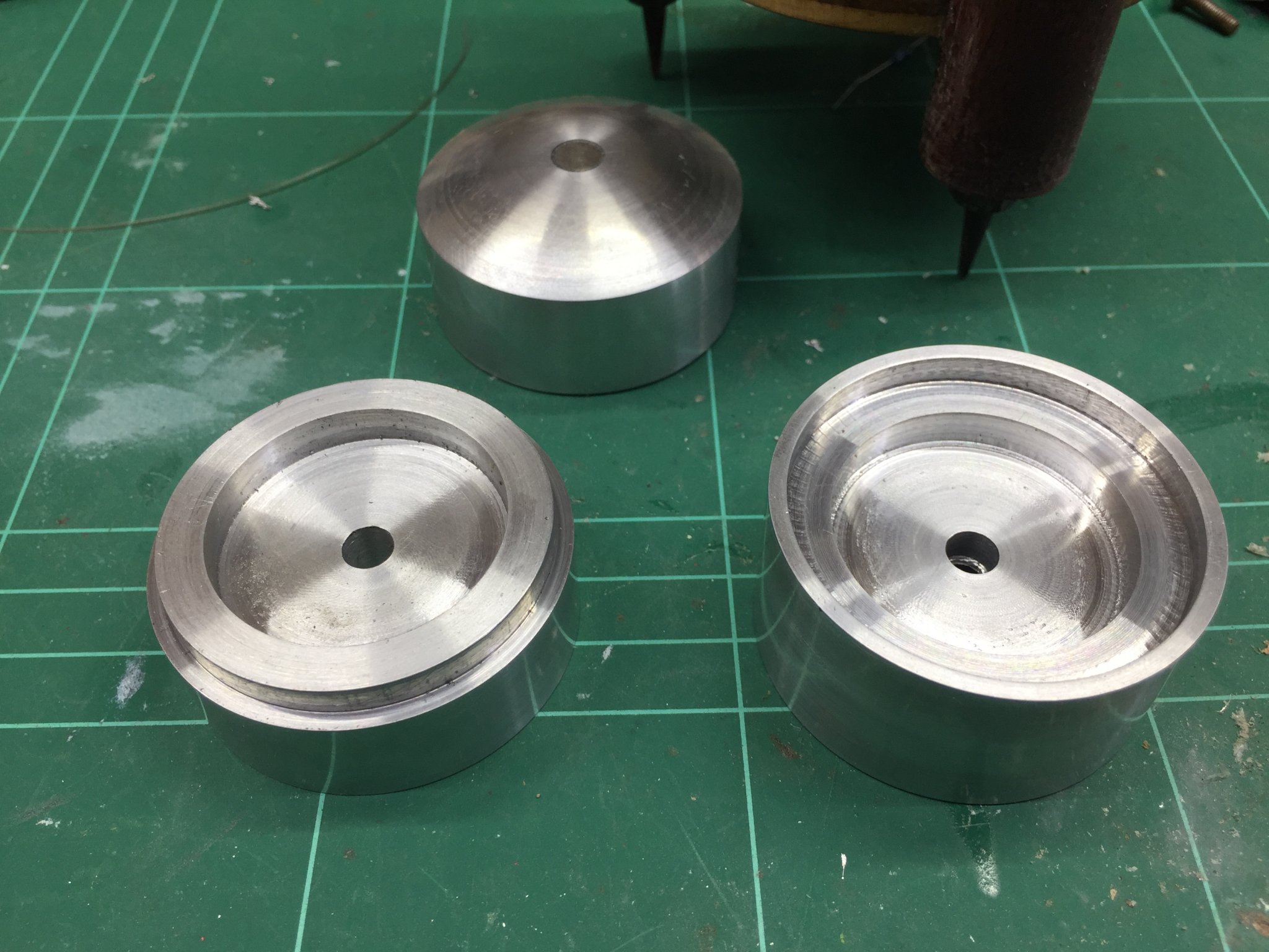

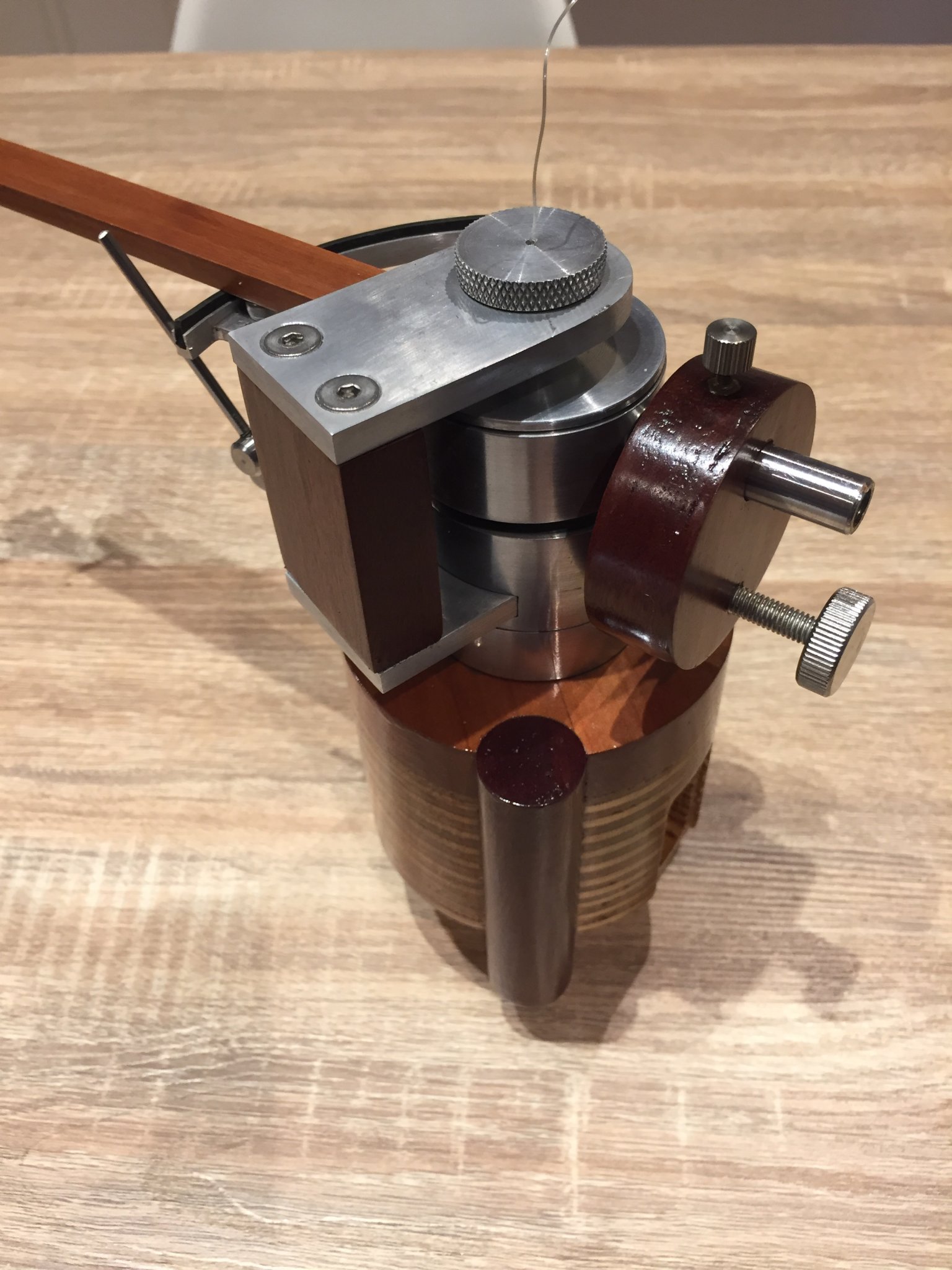

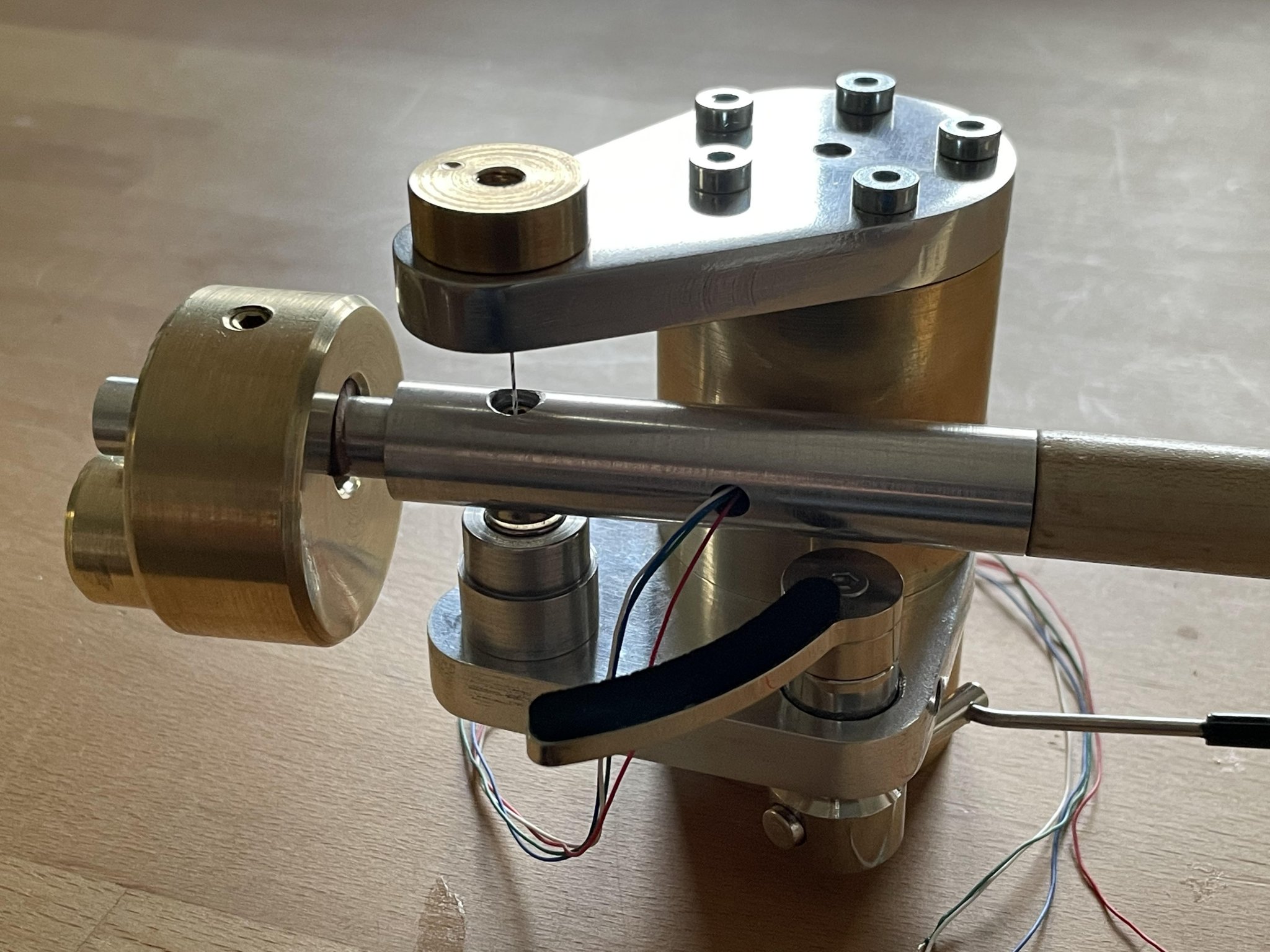

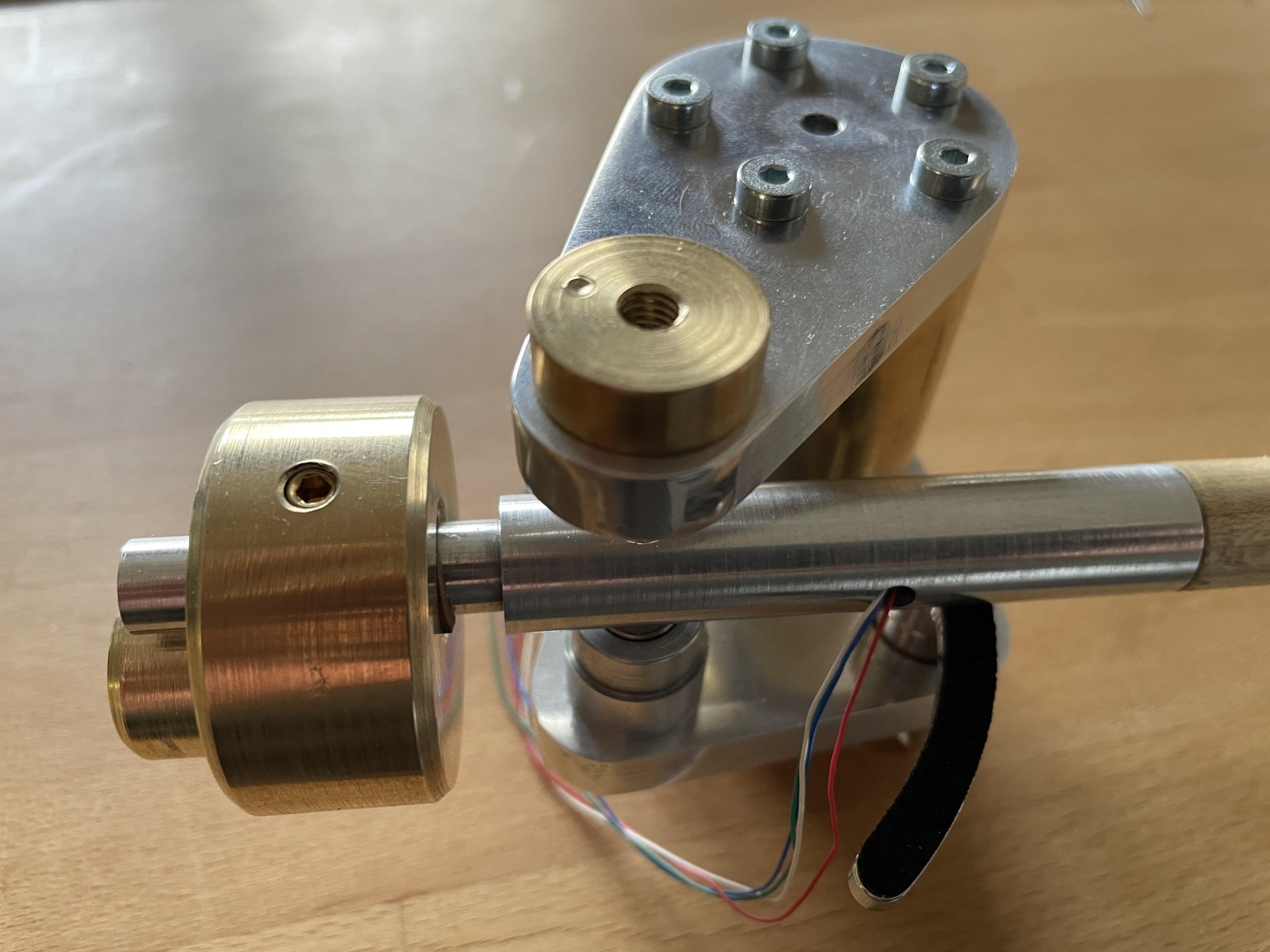

I just finished assembling my arm, a few things need tidying up and the cartridge wiring still to do. Nearly there!

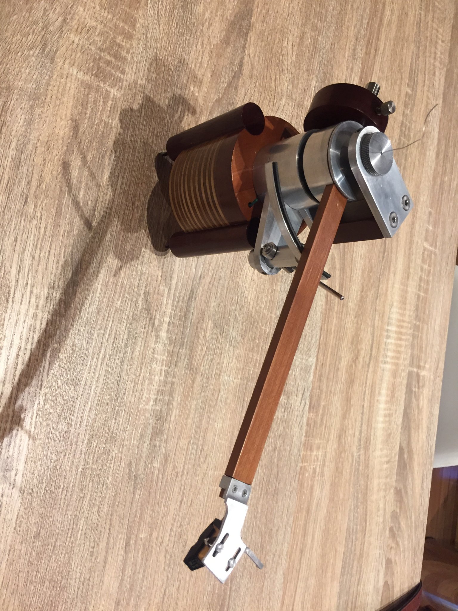

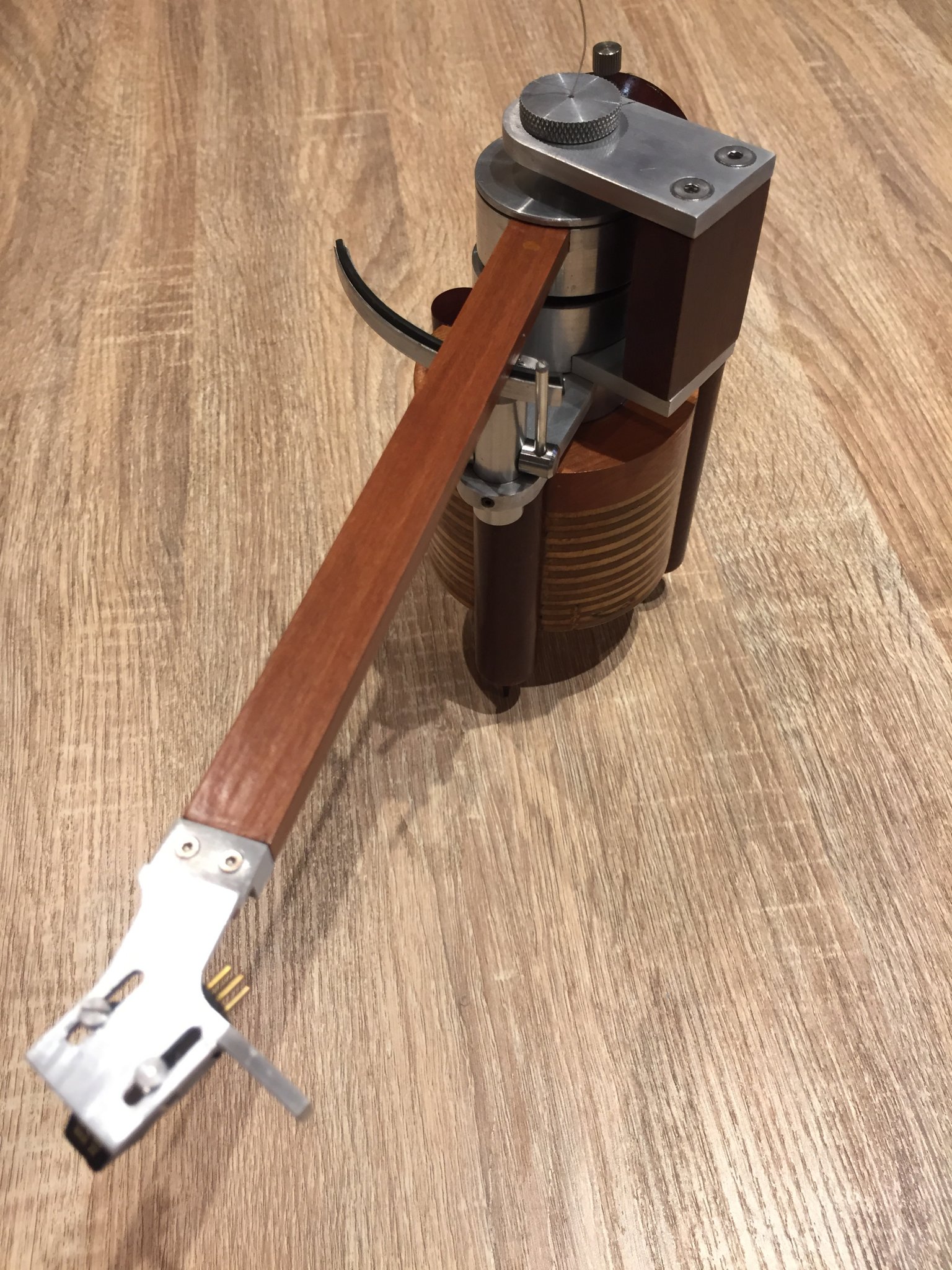

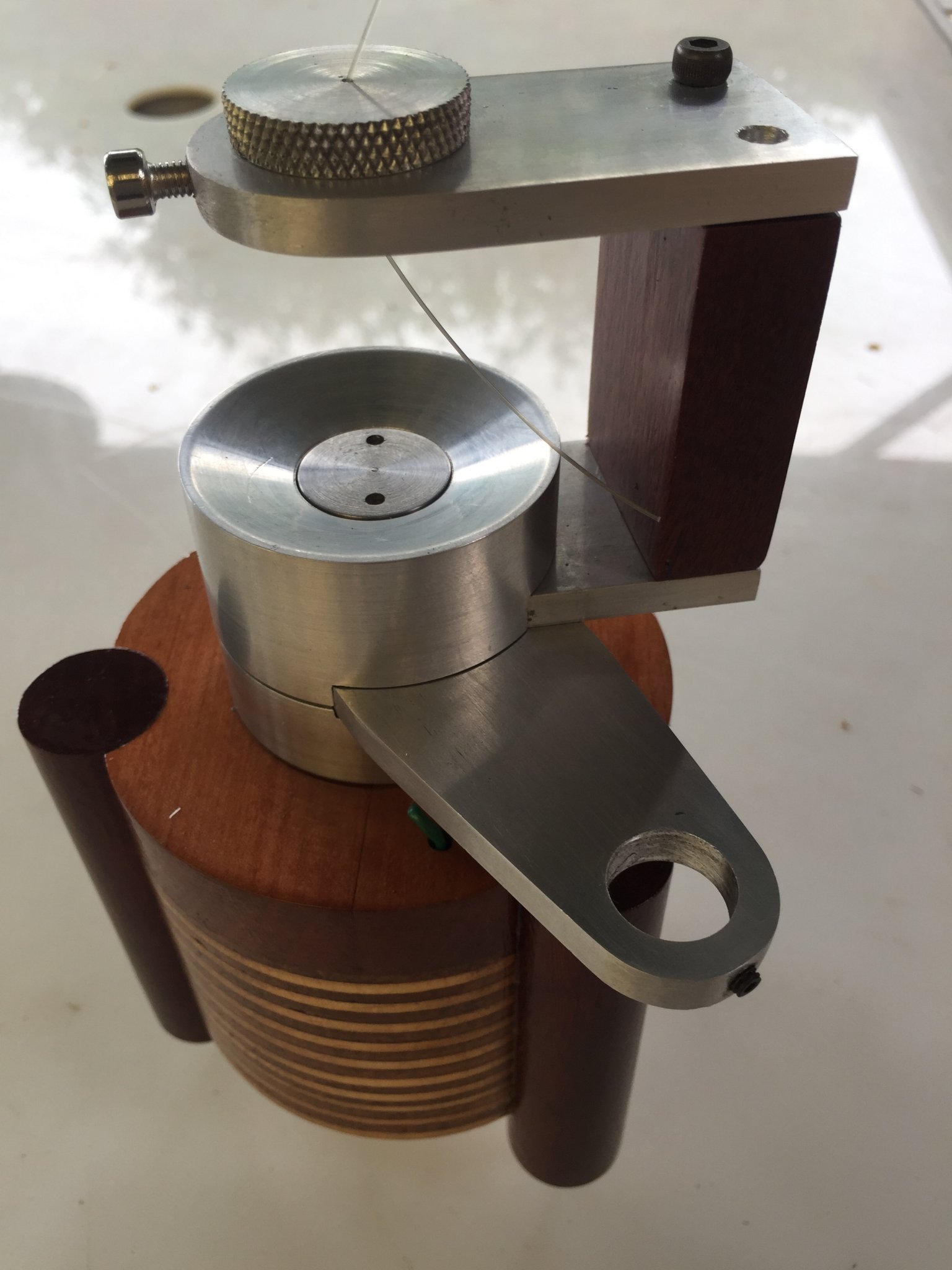

Gentlemen,
this is my interpretation of Frank's masterpiece.
After months of reading this and every other thread I could get my hands on I finally started building it.
It took aproximately 20 bottles of read wine, an endless chain of curses (luckily the workshop isn't close to the living room so nobody could hear me) and all my skills to build it.
The more I got into it, the more I realized how brilliant the thoughts behind this tonearm are. And how difficult it is to build.
Many thanks to all of you who contributed whith their thoughts and ideas in this thread.
And last not least let me thank Frank for his generousity to share some of his thoughts with us.
I beleive that this is the beginning of a journey - and not the end as I am sure that I will rebuild parts of the tonearm in order to improve and do better.
Stephan
