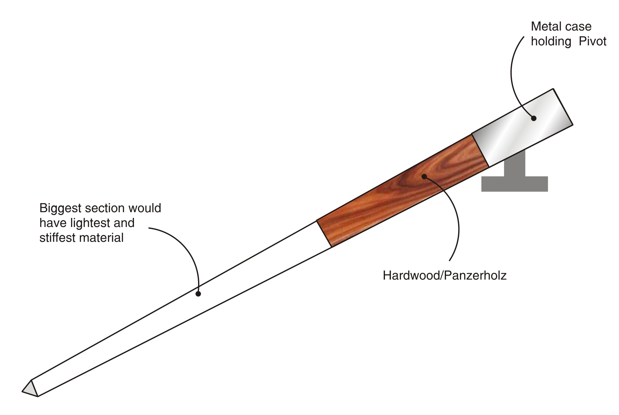

16 inch Schroder toneram :
Since we are incerasing length, to decrease total mass we can use three different stiff material of varying density, to make it comparatively lighter. Triangle being stronger shape we can taper the whole assembly from pivot to headshell. This will reduce mass, give damping at various frequency levels and tapering would stabilize the longer tonearm. Three intersection of tonearm can be varied to suit the cartridge compliance and sound preference. A rough illustration attached.

Hiten I love that idea. I am trying to think of easy geometry for getting the headshell angle right. Some A4 paper and trig tables seems one way. My tables 1878. Have a screw in long finger lift to see the angle. That is replaced by a short one for use. The Schroeder fixing is the logical solution to simplify the task. Hiten, I bet Rose Wood is a local product and other beautiful woods?

If effective length and pivot to spindle distance is fixed we can make fixed offset angle marking on the headshell itself which would give tentative cartridge alignment position.I am trying to think of easy geometry for getting the headshell angle right.
Yes sir. Teak, Sheesham and rosewood are popular here. In that order. Cheaper woods are Babul, Sal and Deodar. Don't know properties of cheaper wood. We had used Sal wood for small shutters and they bend during changing weather.Hiten, I bet Rose Wood is a local product and other beautiful woods?
