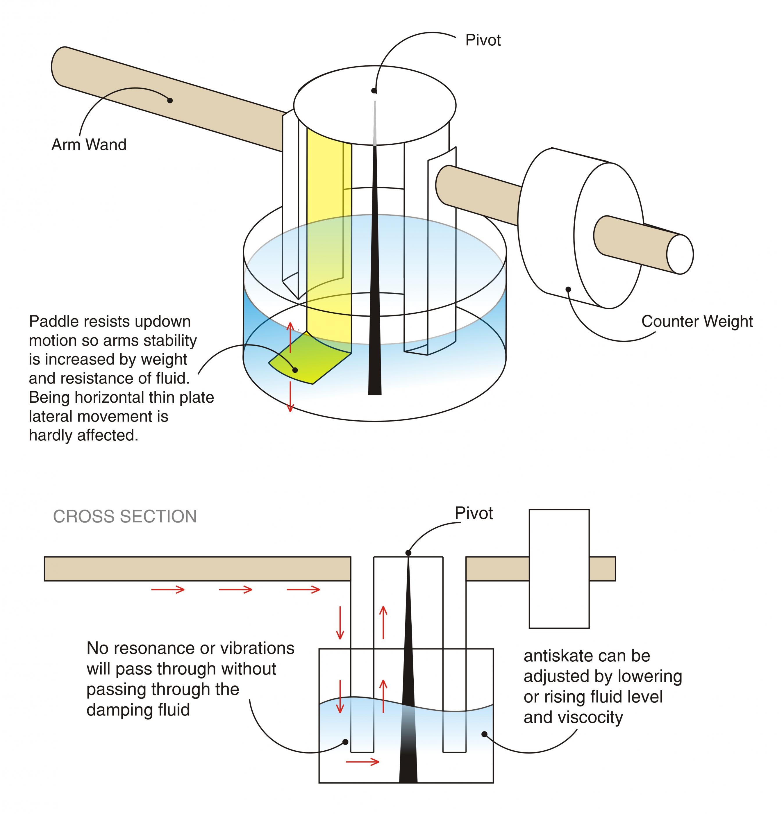

I guessed it wrong that drawing of new tonearm would be easy. It turned out little lengthy. An hours and half's work. Hope the drawing explains the idea. Three basic highlights are any vibrations or resonance will not get through unless it passes through the fluid. And horizontal paddle makes tonearm tortionally stable if we think about changing azimuth point of view. But will not affect the lateral movement. Antiskate can be adjusted by fluid level and viscocity. Hope this is worth exploring.

Why can we just do 4 points as Kuzma's? It is simple and effect.
I myself like carbon fiber. To my ear, it is the most natural sounding material. Wood may colorize the sound. The expensive and wonderful sounding AT arm is another proof. If you really want to use wood, African blackwood may be your best choice. Anyway, the material you chose depends on the construction of your arm, too.
