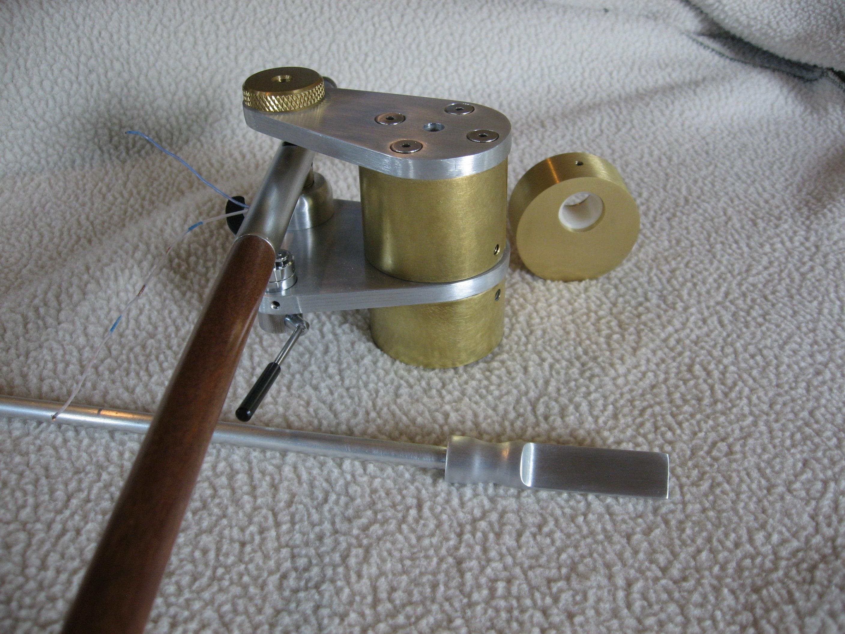

I'm past the planning and drafting finally. ..............seems like 2 years now. Finally have some Brass and Aluminum shaving on my garage floor. I'll post some pics this weekend. Without a lathe it is difficult at best. I'll make 3 parts, throw 2 away. Takes much longer with only a drill press and belt sander............😱 Never give up! Never surrender!

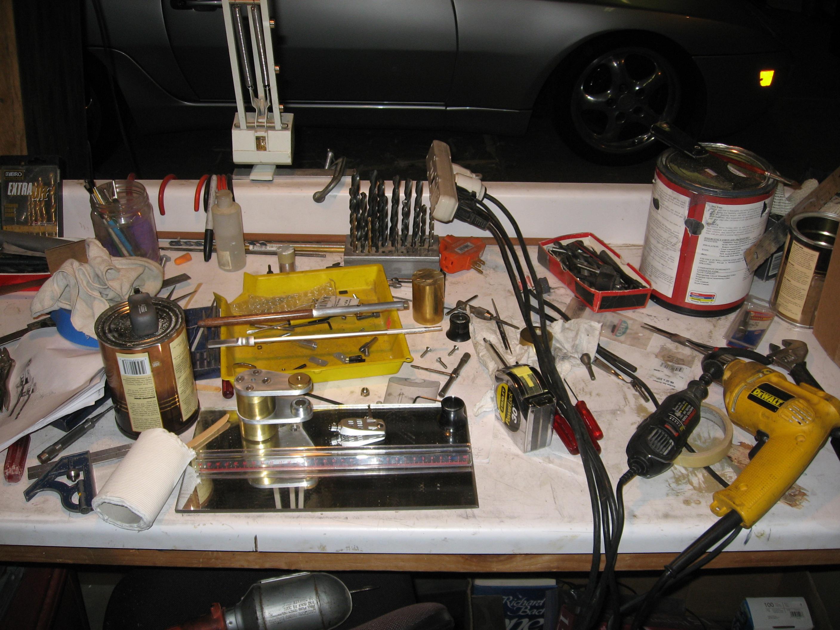

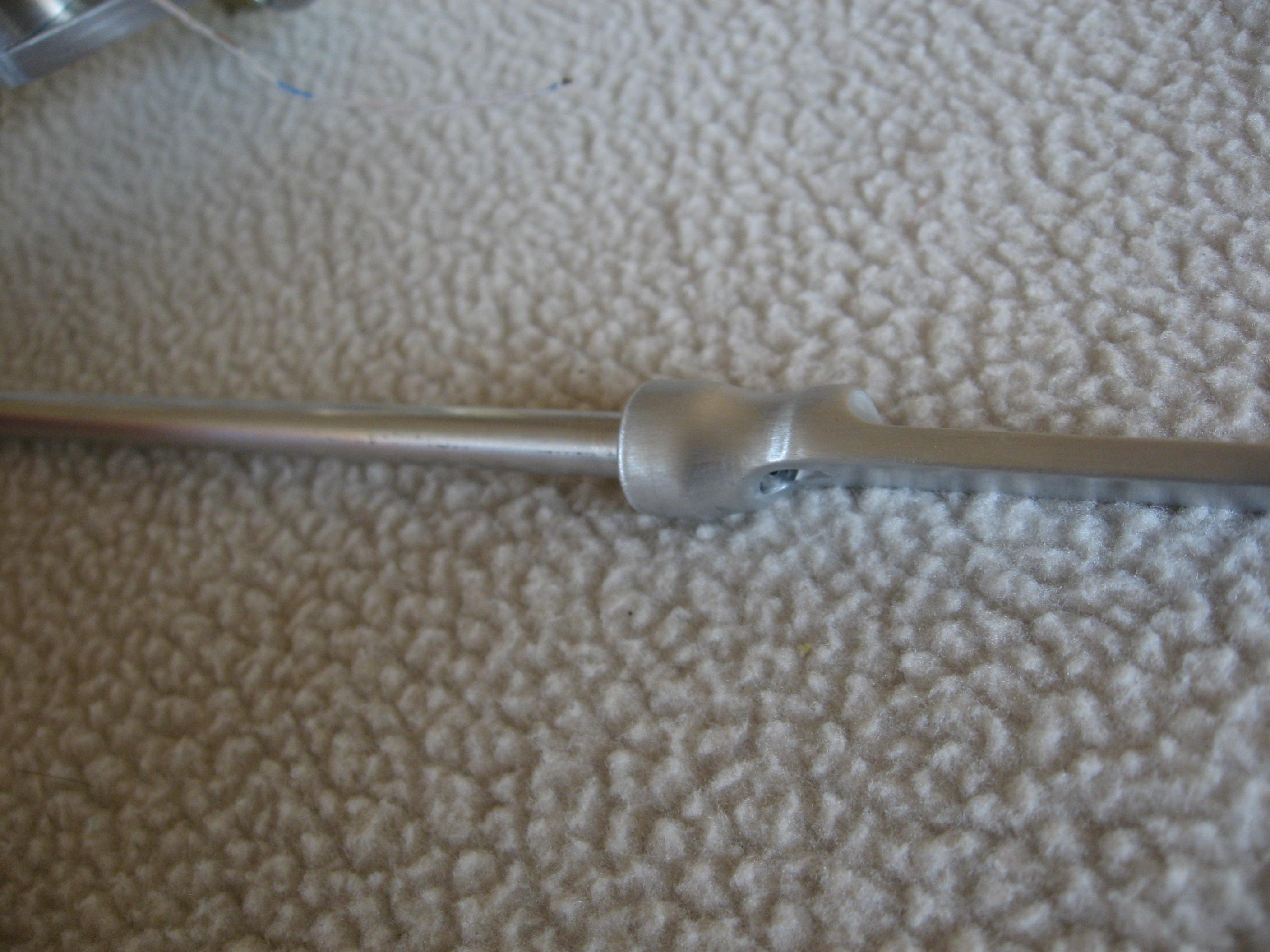

As promised, 'cause we all like pictures. Here's some of my modest attempt at this wonderful design by Mr. Schroeder.
Does anybody else's workbench end up looking like this when they are working on a project.....? Be honest now.
It does get cleaned up from time to time. 😉
