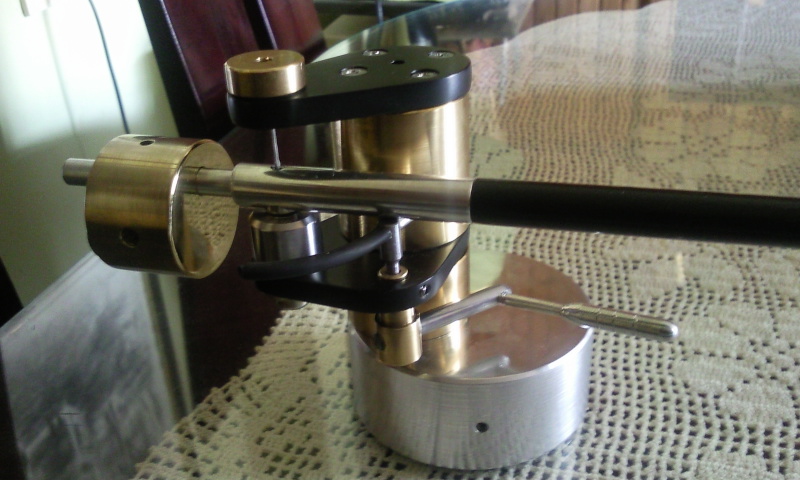

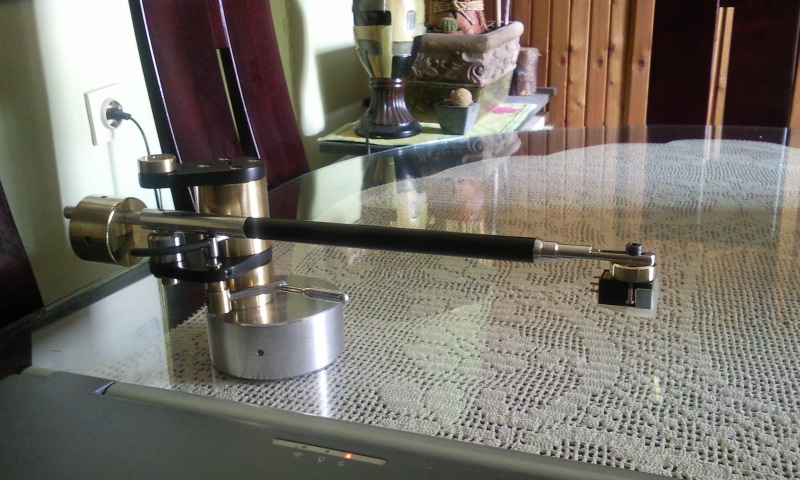

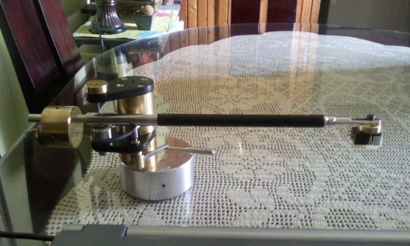

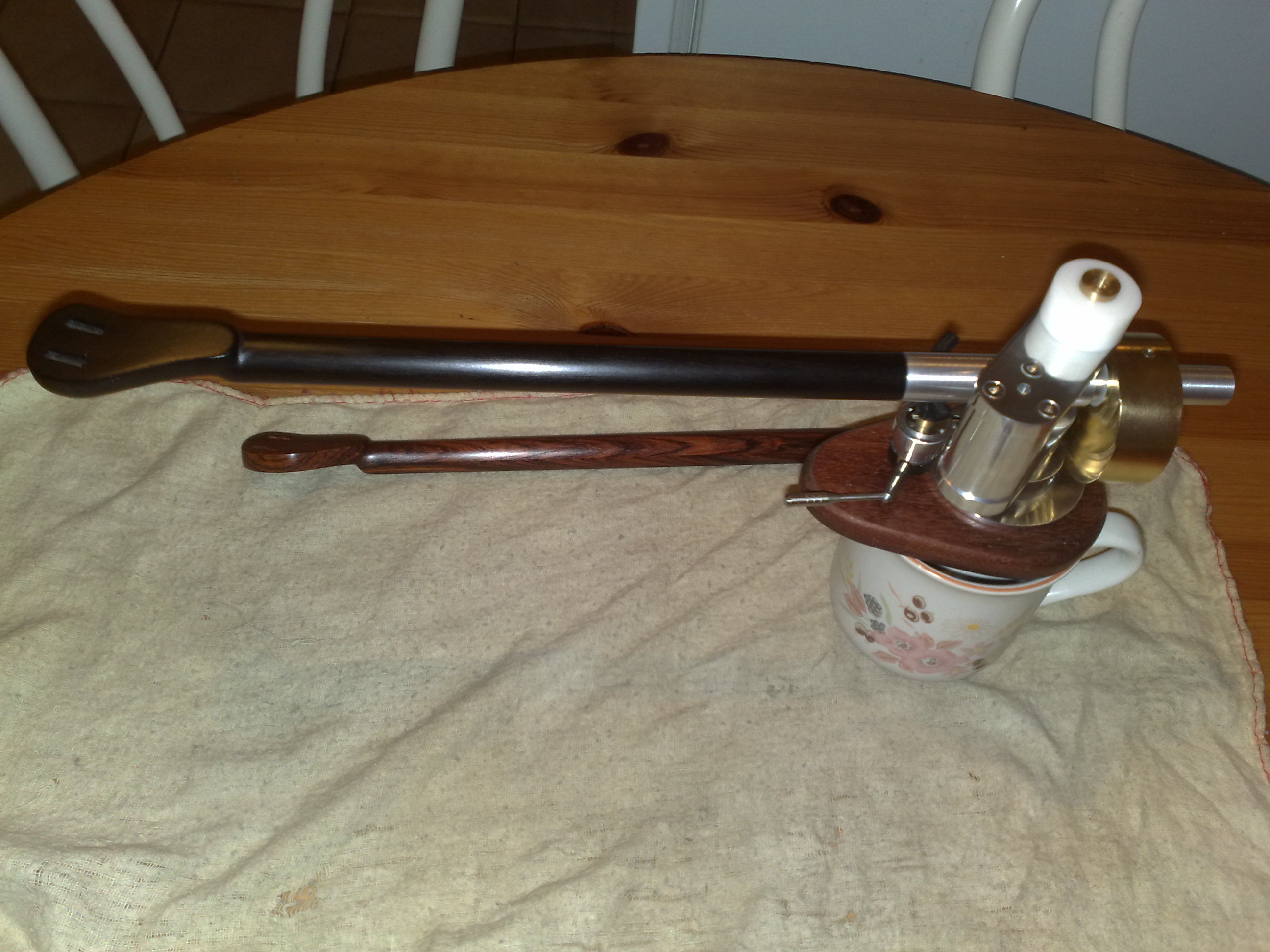

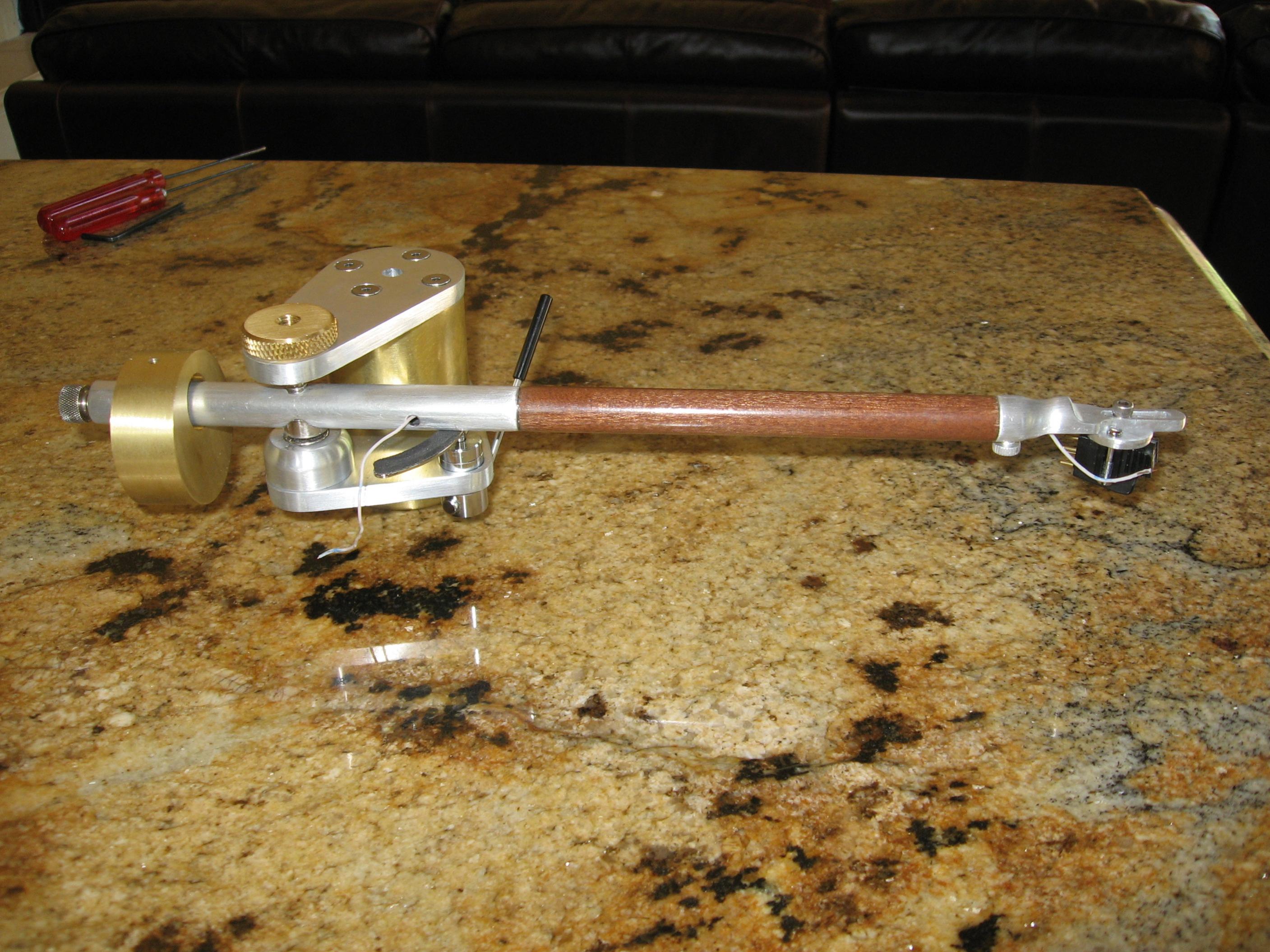

ebony tonearm tube (African black ebony) treated with many oil for damping special varnish at the end ( for violin)
rest is aluminium, brass, bronze and stainless steel
neodium magnets N52
only to put Nordost wire and it will complete
VTF is 100% same at the end and the beginning of the record
regards Nikola
neodium magnets N52
regards Nikola
Hello Nikola.
VTF is prone to vary with VTA, rather than the start or end of record, especially with very large magnets. So make shure you set VTF at record level.
Cheers Steve.
Cheers Steve.
that is ok, but I mean if the magnets not perfect level each other you have problem with different VTF at the beginning and at the end of record, this is the most complex to achieve in making this tonearm

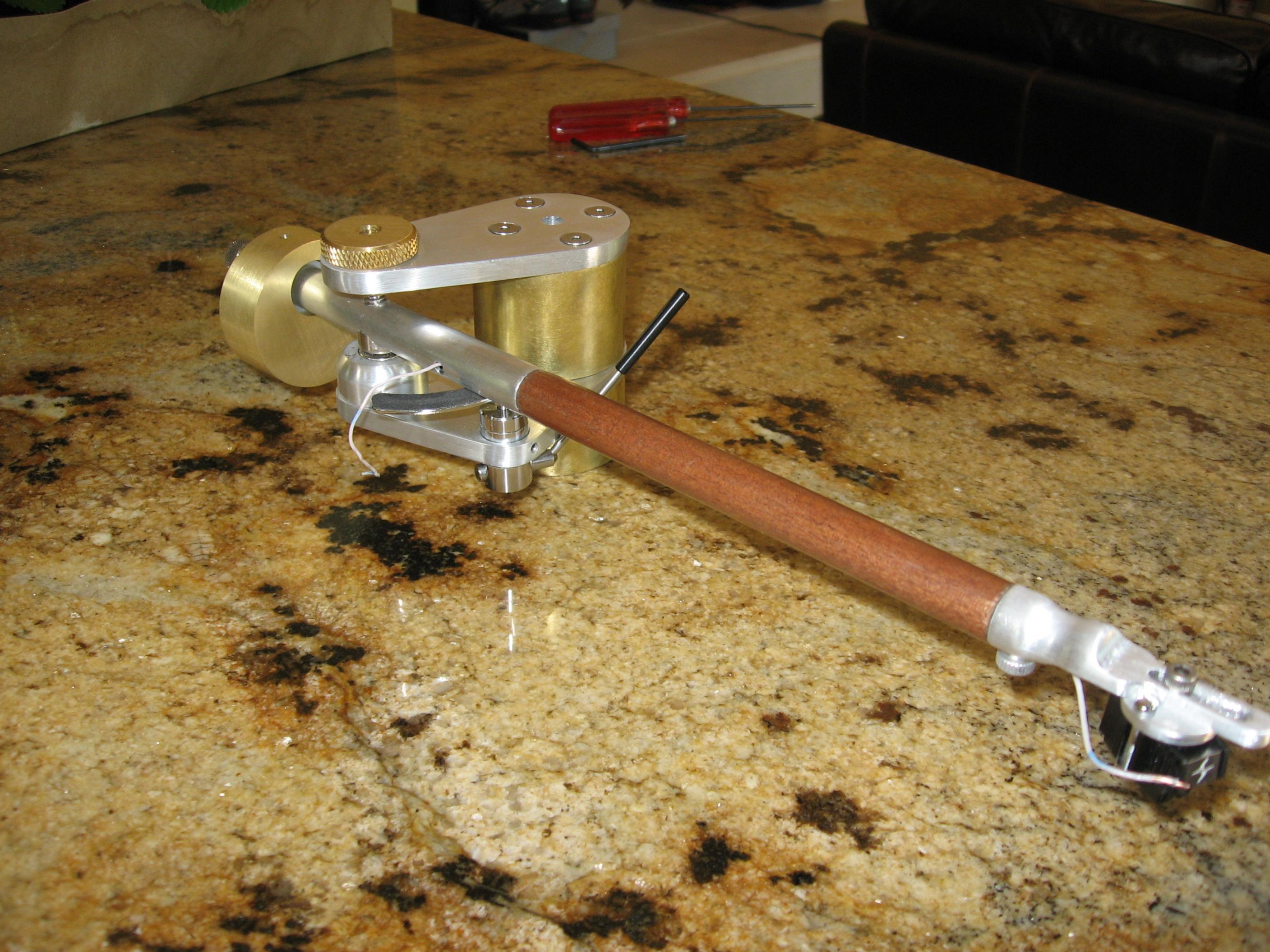

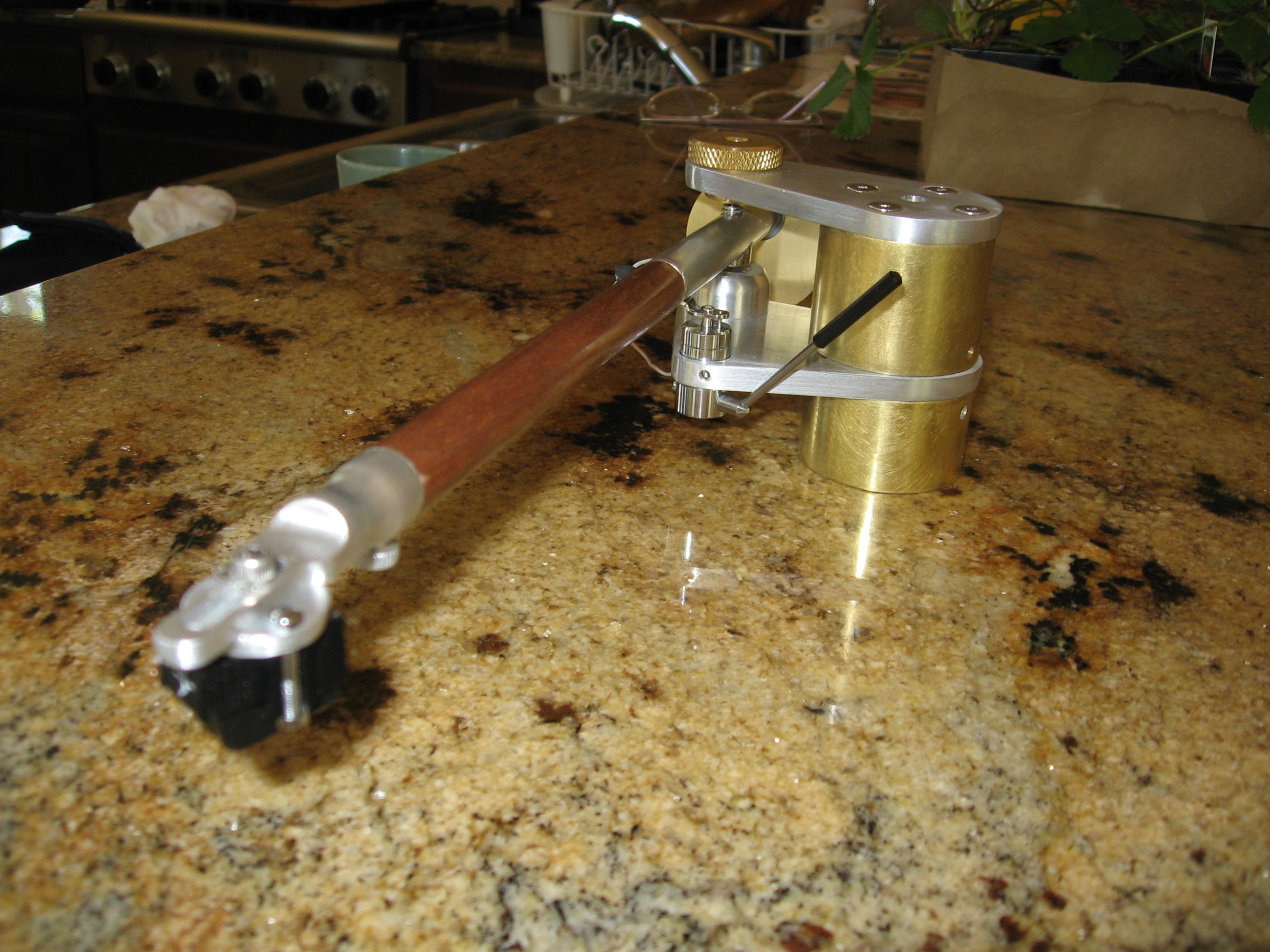

A few pics of the progress so far. Long ways to go yet!
Splendid craftmanship fran !!!
