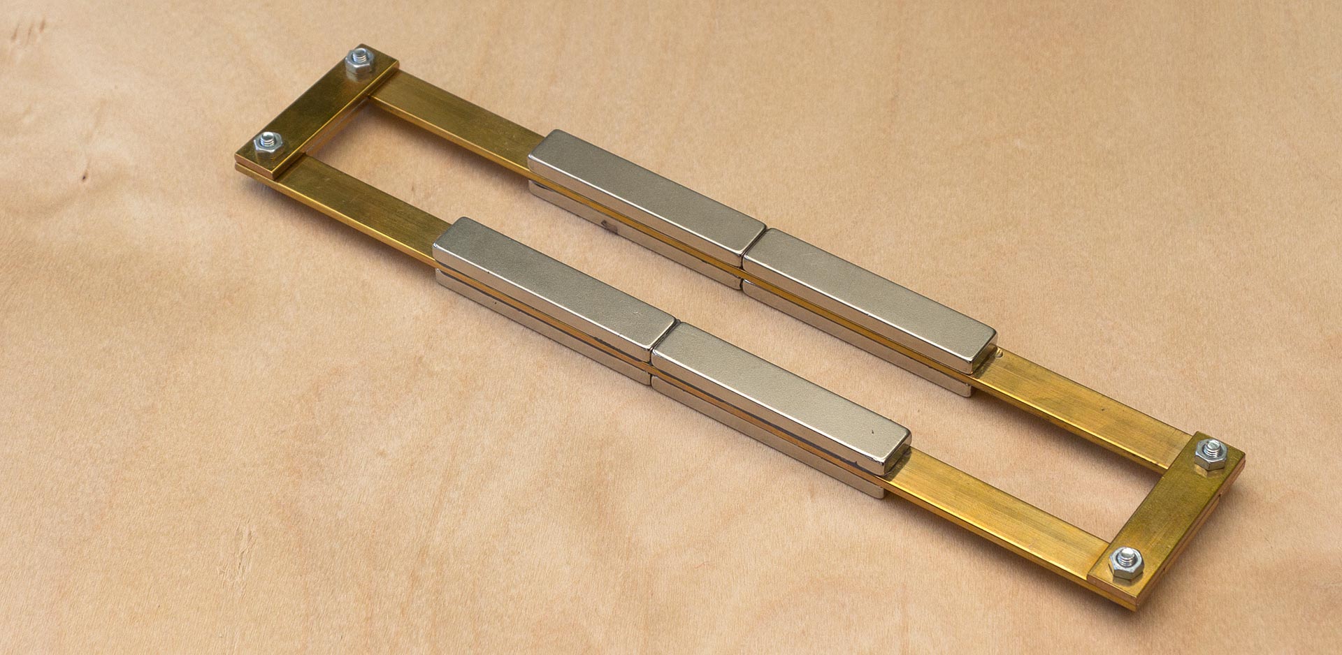

A picture of the brass test frame:
Two magnets in stead of three. The idea is to make the ribbon 12cm long so as to move the mounting point out of the gap and provide some flexibility.

Did yo play the brass version? How did you mount the membrane on these? Outcome - findings?

Sorry, no progress as of yet. I've other things on my mind right now.

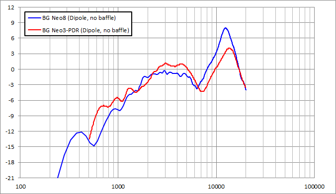

Attached plot shows my build-up for modeling the Neo-8.
Actually, now that I look at it, since the green line rolls off a bit more than the purple starting at 1kHz, I was probably included the mass of the slugs of air in the holes thru the steel plates as well.

Hi Bolserst,
Your modeling of the Neo8 has piqued my interest. I've been playing with very simple models of ribbons and magnetic planars lately. It looks like you've had a lot of success modeling the resonance of the holes in the magnet/perforated steel structure holding the Neo8 together. I'm wondering why the Neo3's don't display a similar resonance. I measured the size of the holes on the Neo3's and Neo8's I have and was surprised to find that the holes are slightly larger and deeper on the Neo3's even though they are a tweeter.
Dan
p.s. sorry for sending this O.T. but I didn't think this questioned deserved it's own topic, at least not yet.
Just to be clear, the ~13kHz peak in the Neo8 response results (to a first approximation) from the mass of the (diaphragm + conductors) resonating with the compliance of the air trapped between the diaphragm and the perforated steel plates. The holes in the steel plates do add a lumped mass on the other side of the air space compliance, but their effect is small in the case of the Neo8 (and Neo3) because the diaphragm mass dominates. See post #196 for more details. BTW, the Q and magnitude of the peak is partly determined by the % open area of the plates.… It looks like you've had a lot of success modeling the resonance of the holes in the magnet/perforated steel structure holding the Neo8 together.
My recollection of measuring a borrowed Neo3 was that it had almost exactly the same peak in the response as the Neo8, just slightly higher ~14kHz. Since it didn’t provide a substantial improvement in HF extension compared to the Neo8, I never acquired any of them. So, unfortunately, I don’t have any of my own measurements, but you can see some measurements of a Neo3PDR in dipole mode here:I'm wondering why the Neo3's don't display a similar resonance.
http://www.diyaudio.com/forums/mult...le-dipole-beyma-tpl-150-a-38.html#post1990640
The PDR version has some additional acoustic damping from a thicker layer of felt between the diaphragm and steel plates on the outer third of the diaphragm.
Find attached on overlay of the 1/3 octave smoothed on-axis measurement from the link above, and my measurement of a Neo8.
Note that since the width and length of the Neo3 are nearly the same, the dipole notch and boost are a little more pronounced than for the Neo8. Other than that, the responses are remarkably similar.
Thanks for the reply Bolserst. Your model is most helpful. I don't have Beranek, but I think I can derive most of the required values. I hadn't seen the data you plotted before, it makes sense that the Neo3 should have a similar peak to the Neo8. I had seen Zaph's measurements and BG's published measurements which seemed close to each other and neither showed such a peak for the Neo3. Both did show a smaller peak above 20 kHz on axis. After measuring some dimensions on my Neo3 I calculate the peak should be around 13-14 kHz as your plot shows (I used a simple air spring calculation).
Zaph's measurements were with the rear cup in place, I'm guessing it was the small one. I wouldn't have thought it would have an effect on a peak at higher frequency though. I haven't measured mine yet, but now I'm curious to see if it exhibits expected behavior you showed. Mine have rear cups, but much deeper than I had seen in pics on the web. They're about 2.5" deep and have almost a teardrop shape.

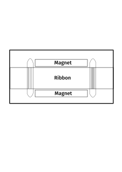

What do you think about a stripe ribbon obtained making many cuts on it?
( the two terminal ends can be not cut according to the scheme in picture)
By this way every stripe moves according to the magnetic field without forcing the ribbon part at its sides that are moved by different forces
Those different forces are the ones that make necessary to corrugate the ribbon or to tension it
A laser cut, after the ribbon has been mounted on the frame, would not stress the ribbon; more are the cuts and more each strip is free to move according to its force.

I don't see how this would improve performance as you introduce several degrees of freedom for the ribbon to move, but of course you could try. I certainly won't because it will make replacing the ribbon very complicated and expensive. Because the ribbon is so fragile it should be easy to replace it.

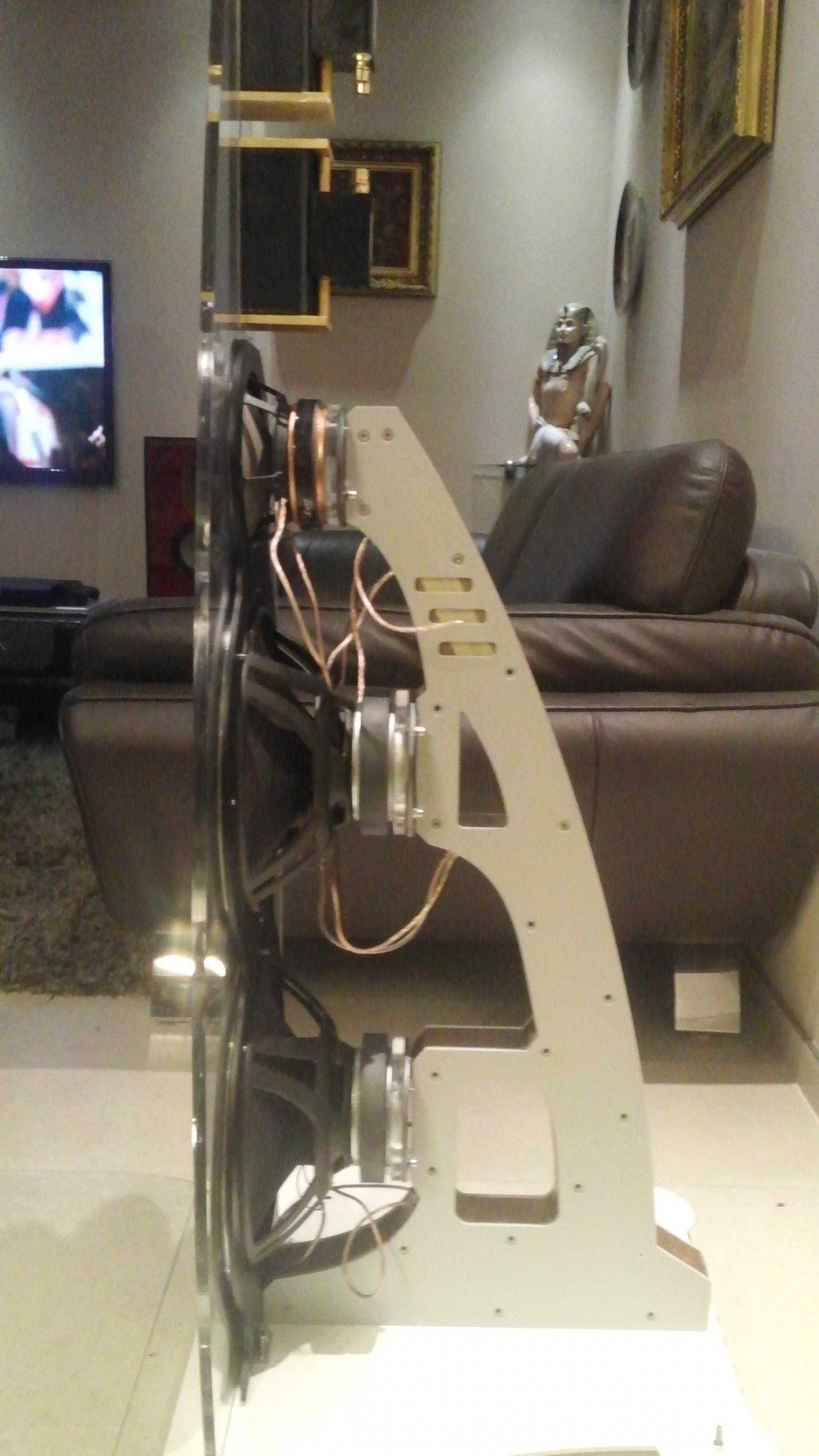

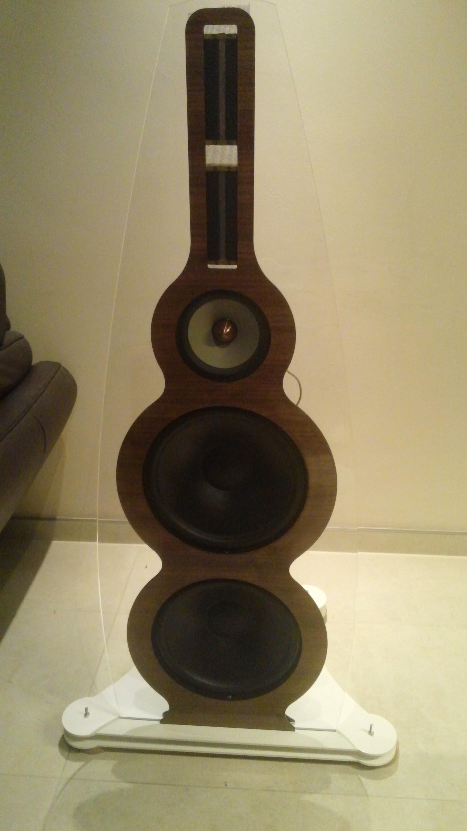

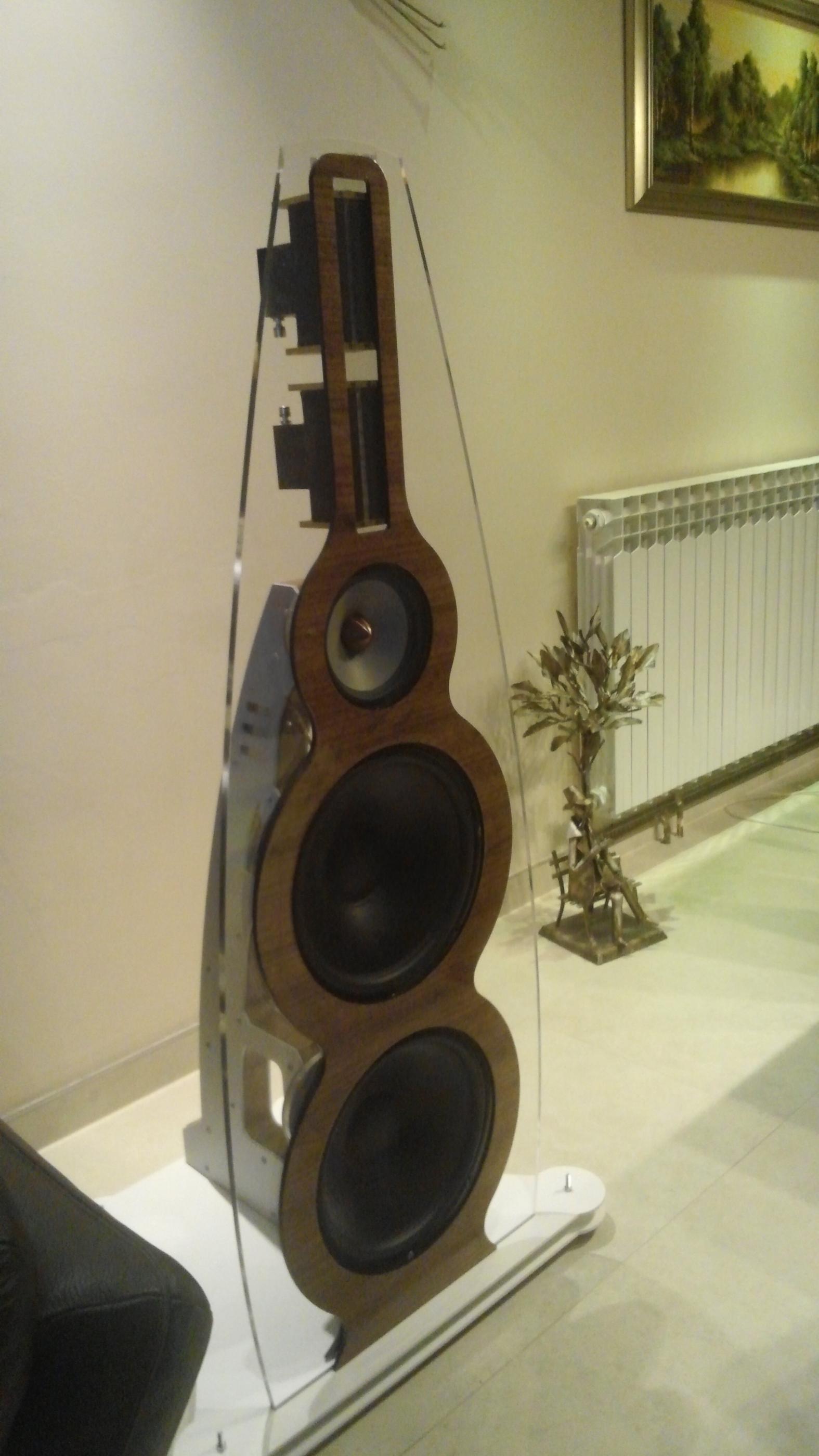

Just to show you my last project with unfinished 30cm long ribbon. Ribbon is still under production. Instead temporary mounted 2 Raven's.
What's the reason for making the ribbon 30cm long? what is the intended crossover?
regards,
Gerrit

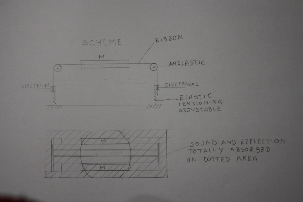

Gerrit,
I see you have the key of the door.
It seem me you make happen what you want:
Good - no good
Right - not right
Helpful - not helpful
Without readind or understandig, it seems like if world must stop.
No more interest to go on, I think the door will not be opened.
Good by to every one - ciao!
p.s.
the attached is one of the schemes for solving the problems of a excited ribbon: tensioning, reducing ribbon weight ( corrugating increases weight very much ),dampening ribbon structural modes, control of emitted sound.
Cheer up, Middle, I've tried your scheme with splitting the membrane, and it did not lower the distortion.
In fact, the sound was pretty bad. A better way is to increase the membrane thickness in the middle third of the width of the membrane, increasing the flow of current where it's needed.
But the best sounding membrane I've produced is an ordinary 5 uM one with Gerrits cable corrugator.
A peculiar fact I've found in my experiments, is that a 10 uM membrane sounds almost as good as a 5 uM membrane if you're using a Metglas transformer, and that 5 uM membrane have a tendency to get tiresome in the highest octave when Metglas driven!

The only ANELASTIC theatment of ribbon movement at is ends and near its ends would require a lot of experimentation.
Rigid piston means move toghether all the surface or extinguish the faster possible the movement of the ribbon structure.
Less weigth for ribbon, more weigth for dampening ribbon structural modes .
Someone tryed by mylar or so but I think there is a lot to do, starting from the funcional separation of the surface that give sound from the one that supports that.

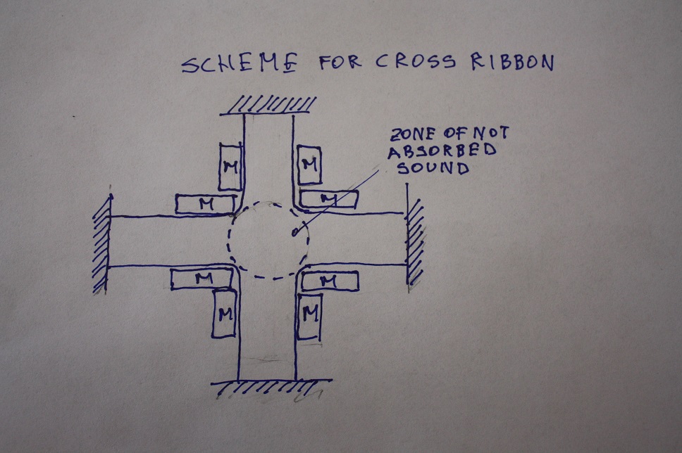

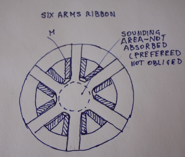

What do you think about a scheme of cross ribbon?
