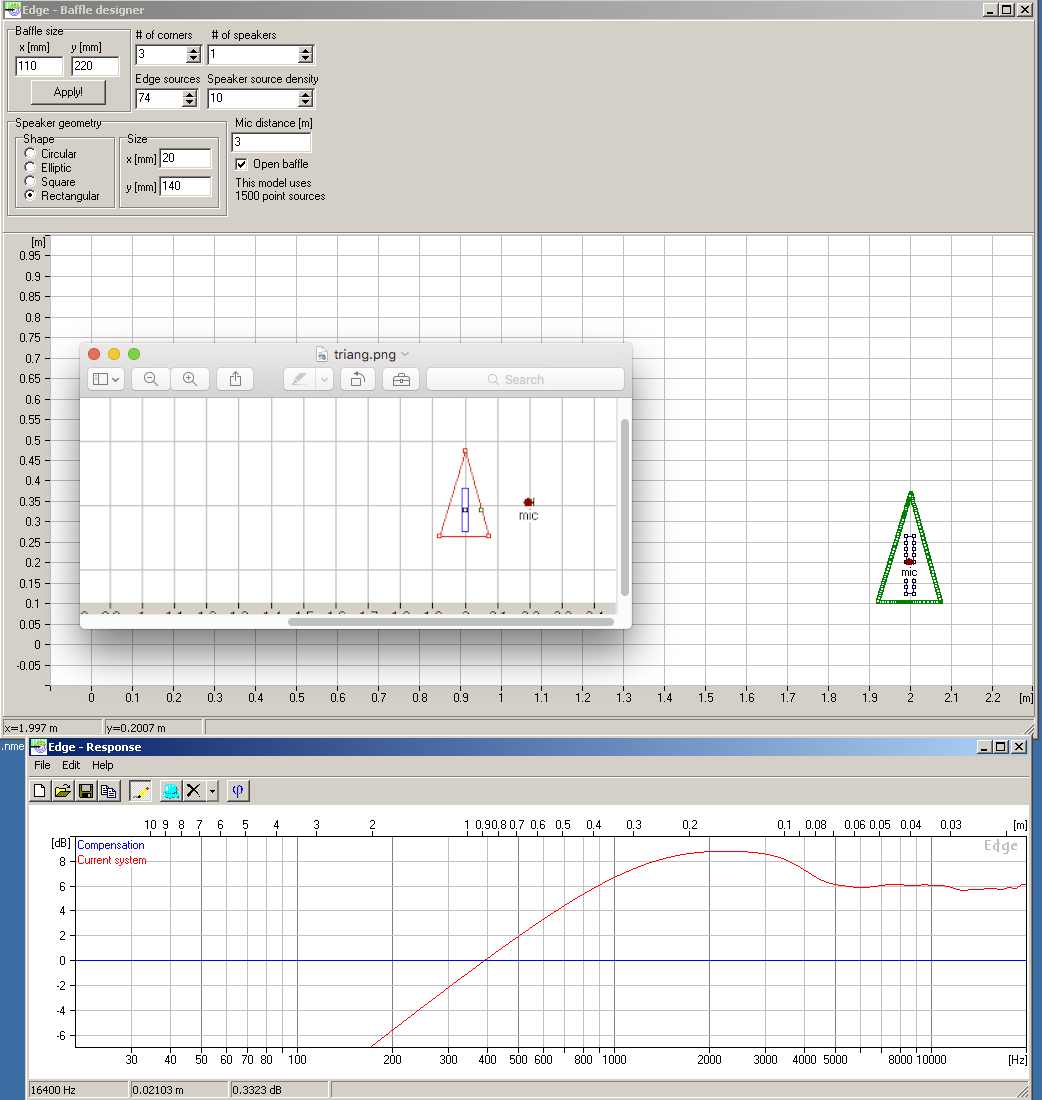

Made some efforts in Edge to see how the shape of a baffle interact with a ribbon. Whit such a light transducer I also wonder how a different impedance effects the membrane. Where the baffle is wider it will see a greater load than where its narrower. Does this create an imbalance that causes distorsion? I found the triangle to give the most smooth response if one want vertical symmetry which I think I do.
What about the directivity? I don't see how this is an advantage over the minimal ribbon. A steel triangle will also lead to an uneven flux in the gap because of the difference in magnetic return path.
It is not my intention to further improve the steel frame, I will concentrate on the minimal ribbon. The minimal ribbon has a bulge in the directivity at 10kHz, the steel frame ribbon has a bigger bulge at 7kHz. The lower the frequency the more it will affect the stereo imaging, so I'd rather have it as high as possible.
regards,
Gerrit
OK! The triangular baffle need not to be made of steel. The directivity bulge is a concern. Maybe a very small and thin triangle. But I will build a minimal and test with different extra appendixes.
What do you want to achieve with the baffle? Do you want to avoid the dipole loss?
regards,
Gerrit
Yes, some sustain in the lower region + get away from symmetrical distances. This is to spread out the resonances. It's a trade against directivity.

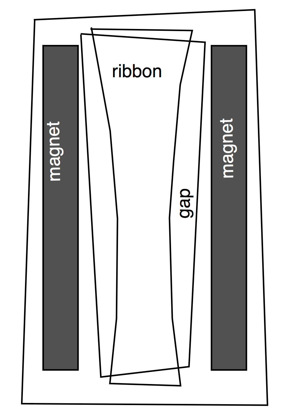

When cutting sails, the sailmaker always makes an undercut (concave) side as otherwise it will flap in the wind. This might be something to consider when forming a ribbon... it shall maybe be a tiiiiny wee smaller in the waist? I will try this.
Also the terminating sides should not be parallell. I will try this.
Maybe even the long sides in the gap should not be physically parallel (magnets should most probably!). I will try this.
I belive removing parallell symmetries could pay off in a less resonant system. Maybe the sum of resonances are equal but the none parallell system will have less distinct ones.

It could prove very difficult to cut the ribbon in such a shape and I don't see how this would help without introducing other problems. Looking at the way Raal does it I was thinking of making the ribbon longer so that about 1cm on each side will not radiate sound and will act as a 'suspension'.

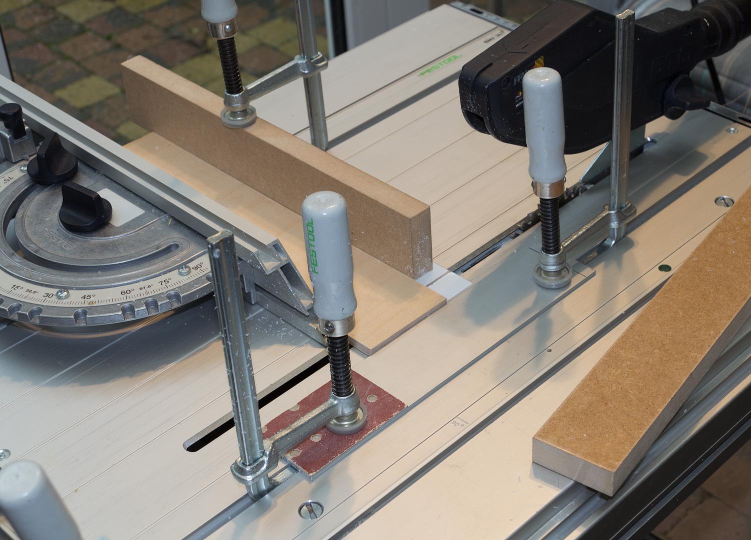

The little plastic parts I did with my table saw:
It's a matter of clamping the material, using the right blade and pulling the saw through the material so your fingers are nowhere near the saw.

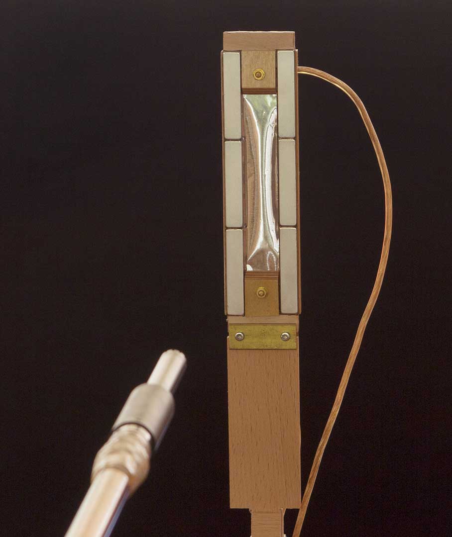

I think this picture is really interesting. Now, if we should substitute the ribbon by say 10pc of 2mm ribbons close side by side we would see an opposite view where the ribbons on the sides would make the greatest excursion (twice that of the center due to double flux?) rather than what can be seem here. Is there sometime to be gained by a different suspension...? How can it behave like this - one would think that the ribbon is tensioned equally hard but still the centre can bulge. What is giving away?
I used to make the strips wider where the field was stronger:I think this picture is really interesting. Now, if we should substitute the ribbon by say 10pc of 2mm ribbons close side by side we would see an opposite view where the ribbons on the sides would make the greatest excursion (twice that of the center due to double flux?) rather than what can be seem here.
Perhaps:
- The ribbon used is not rigid enough, corrugate it?
- Resonance.
- The ribbon is so tightly mounted that only the middle can move, being some distance from the suspension.
HMm i was thinking is the sides not where the biggest flux is ? hence this is not a forward motion but a backward and the middle is lagging behind ? hence the bulge?
or could you see if the wave responsible was positive ? keeping in mind all is connected correctly in phase of course. i mean the edged are near the magnets almost touching it.
Yeah, we must know what the applied signal looks like.HMm i was thinking is the sides not where the biggest flux is ? hence this is not a forward motion but a backward and the middle is lagging behind ? hence the bulge?
Also, it could be good to see this from the side or from above.

Ok knowing the flux I should really have interpreted the picture as the center being "still" and the sides moving. Duh!
You´re probably right.Ok knowing the flux I should really have interpreted the picture as the center being "still" and the sides moving. Duh!
Do you have a link to where you found the picture?
Solhaga it's from this thread. And we do know about corrugation. You probably need to read the threat to discuss properly in context ;-)
Well what i mentioned was just a option, Gerrit could shine a light on the picture, he took it 🙂
nowadays with iphones i think they can even record slowmotion. if frequency signal not chosen to high it should be visible 🙂

Actually, I've been thinking of building a synchronized and stroboscopic thingumajig.Well what i mentioned was just a option, Gerrit could shine a light on the picture, he took it 🙂
Problem is to get it in sync with the audio signal applied.
But just any modern camera or video camera will probably do as the recorder as you suggests Wrinex.
The video camera I have have (Sanyo HD2000) is capable of 600 fps. So you should be able to look at a 150 Hz input signal with 4 frames per cycle.
If you are patient though, you should be able to for example catch the ribbon at its excursion limit.
And perhaps that is what Gerrit did.
The picture was taken with a high level sine wave signal of about 1-2kHz. I took this picture to show what happens if there is no corrugation or any other method of stiffening. The field is not constant across the gap and this will cause the ribbon to flex, the center lags behind the edges. With a sine wave sweep you can actually see it happening if the frequency is low and the level high. The minimal ribbon frame has no way to really tension the ribbon, hence the testframe that I'm working on which allows me to tension the ribbon in a more controlled fashion.
