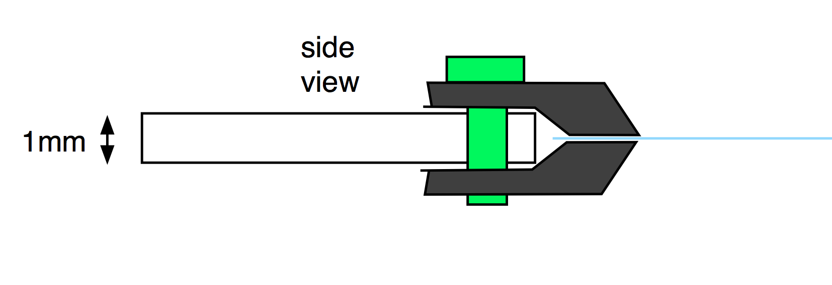

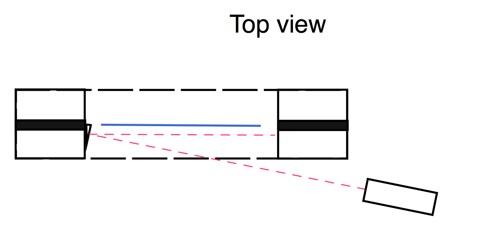

I thought of using a laser and let the beam reflect of the ribbon. One of those lasers they use for projecting a line on a wall should work.
Cool!
So if the laser i set to a certain excursion you would start to see it shine red if they meet - kind of a overload indicator. If not it would just be a red dot on the side wall. How do you get the laser within the frame?
My idea was to let the beam reflect of the middle of the ribbon onto the wall or a screen, but it's just an idea to somehow make use of the fact that the ribbon has a reflective surface.

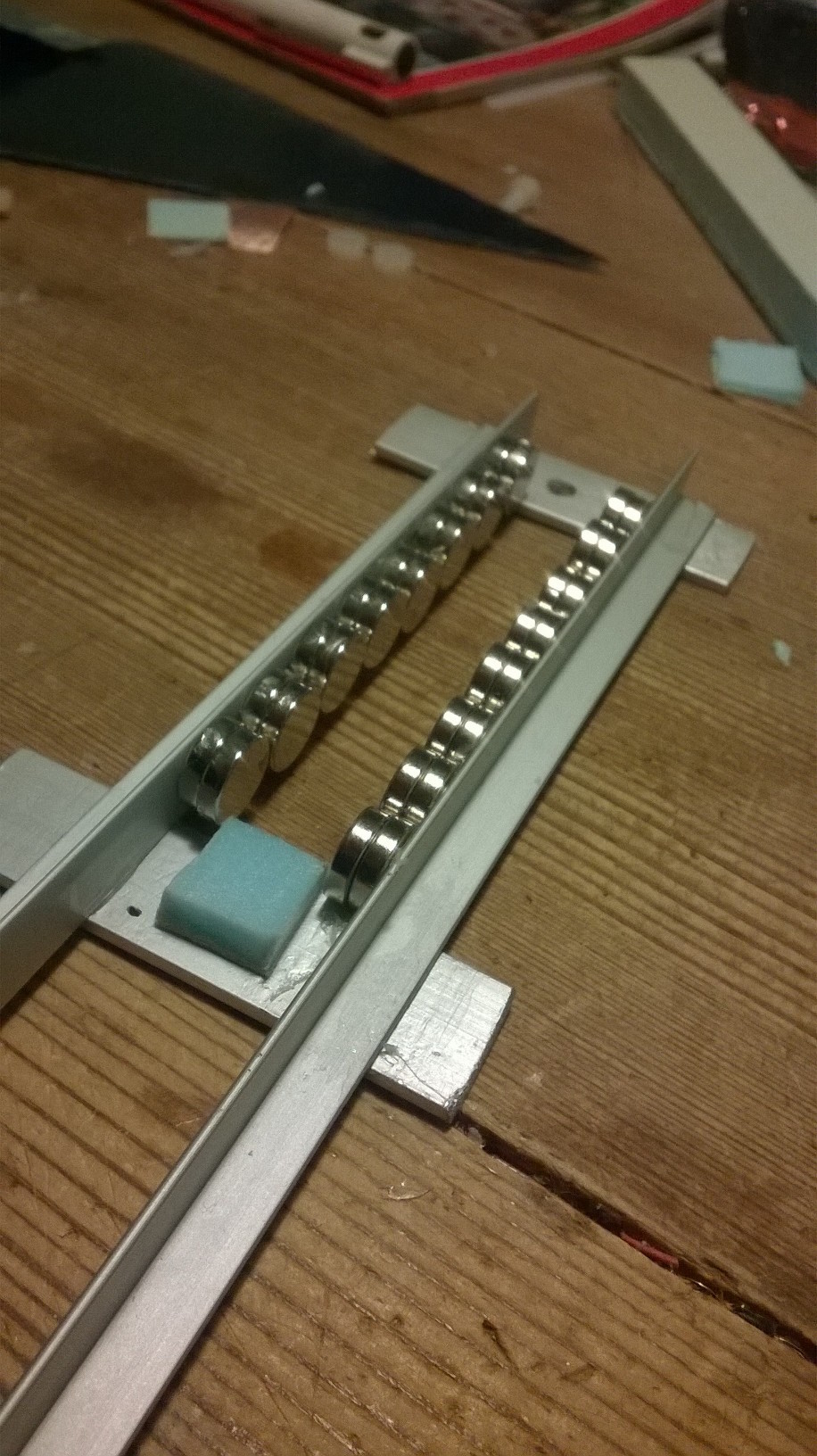

As for your other remarks. It seems like a good idea to build a test frame to investigate different mounting schemes for the ribbon.

Yes, based on simulations in FEMM I decided to use 10cm out of 15cm. The goal was to get a constant flux in the part where the ribbon is placed. As the ribbon moves the easiest in the middle it may not be necessary to have a constant flux, it could even prove to be counter productive.
For the test frame I want to use 2 magnets for a 10cm gap. I want to minimise the hight in order to decrease the center to center distance to whatever driver is above or below it.

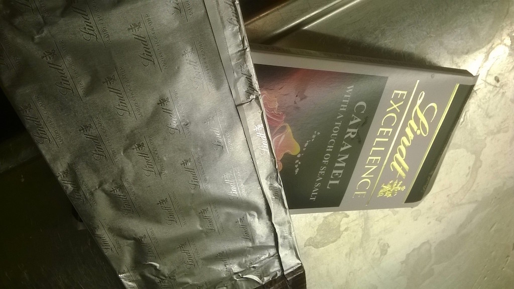

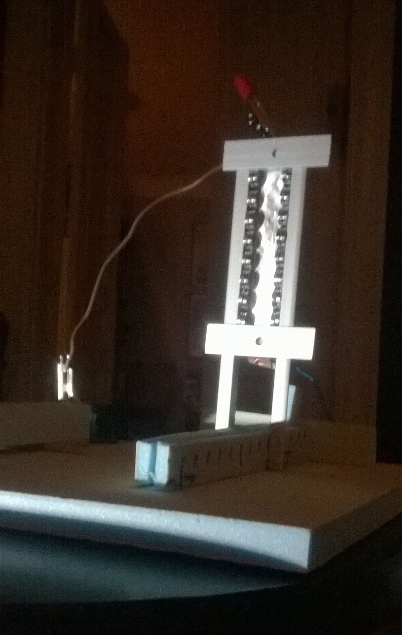

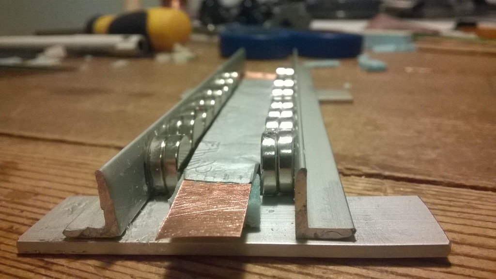

Okey so I could not wait for my magnets so I went along and did a zero prototype just to get a feeling what I'm up to. Was a good excerise. Did al the errors. Got a metal file to crash the magnet structure - just to start again (used quick glue) 🙂 Realized that soldering the terminations is not so easy as the one might loose the other side due to copper heat conductivity. But it plays. Not very load - use a 2,6 ohm resistor. I don't have a crossover so I produced a number of files HP:ed at 3K. Its not very load but I think I can hear "it" ....
I recalled chocolate to have thin inner sleeving of aluminum foil. Used that. Had some nice side effects also 🙂
And so it begins... 🙂

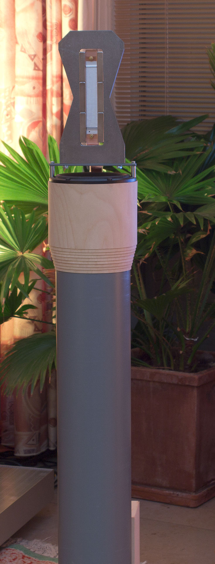

In the meantime I've mounted the steel frame drivers on their base:

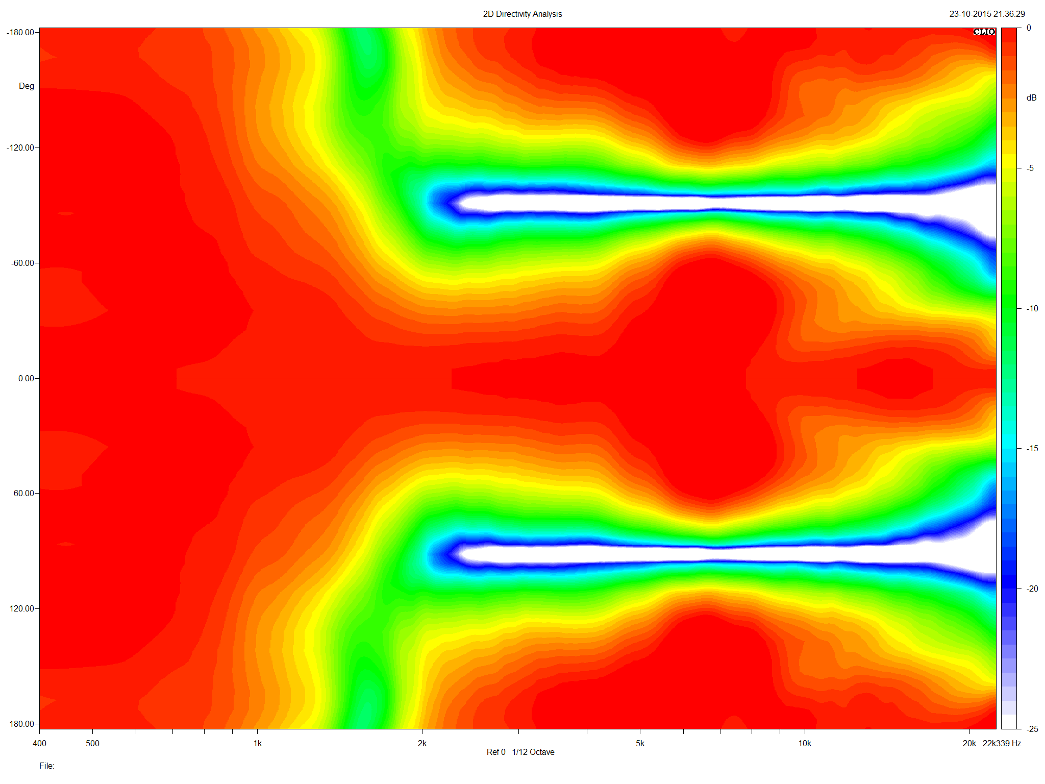

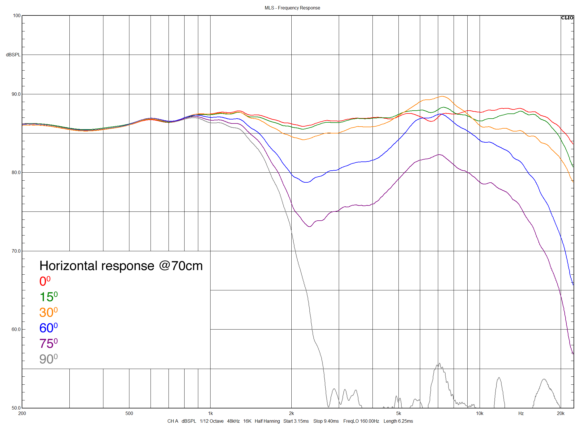

Essentially a Linkwitz Pluto clone. The crossover is at 1500Hz 24dB/oct LR.
The response for several angles:
The steel frame acting as a baffle is responsible for the peak off-axis around 7kHz.

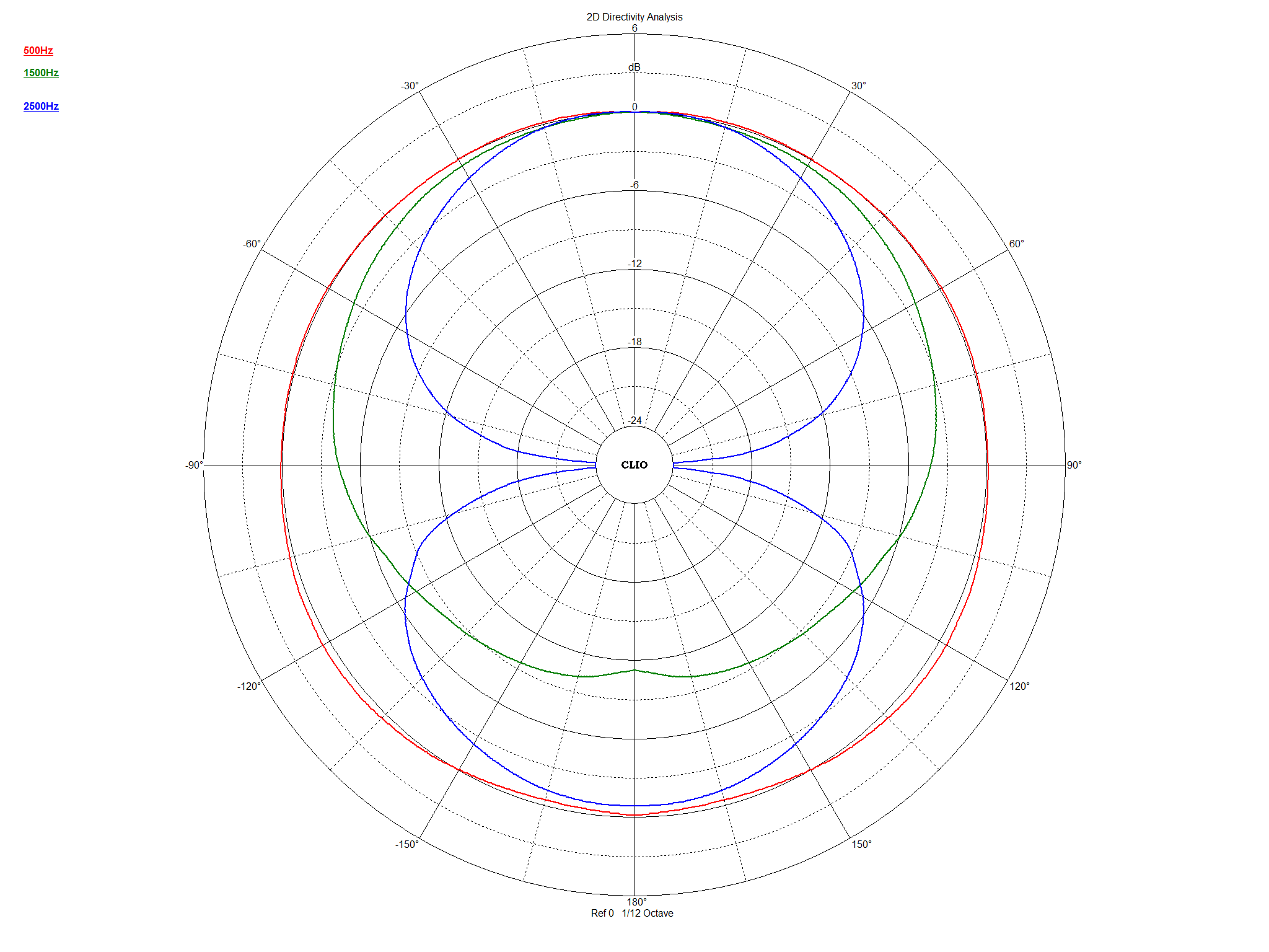

At the crossover between omnipole and dipole the system becomes a cardioid. At 180 degrees the dipole is out of phase and the resulting null creates the cardioid pattern. This can be seen in the (normalised) polar diagram:
The null is not sharp enough yet as I'm still tuning the filter. The full 360 degree directivity diagram:
Ideally the narrow white areas should continue and follow the green areas around the corner so to speak.
Alas, the plate amps broke down for reasons unknown to me so I haven't been able to listen to the system. They're on their way to Hypex and I expect them to be back soon.
