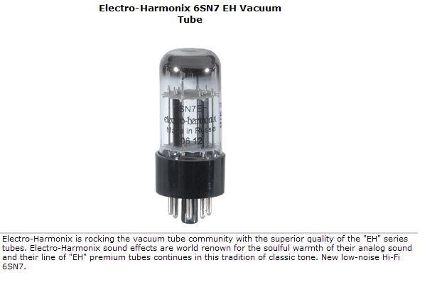

carpenter said:This seems like an interesting tube. I like the sturdy base!
you need mu of 33 to accomplish some SUSY with darn toobz ;
6SN7 is good for another things , but not this
go to my www , find "various" page - download my bookmarks.rar and look for few educational links ........ regarding toobz
6SN7 isn't exactly a high gain tube... If you want to put in a 2V source, loose 6db in the volume control and get 25-50W out, your going to need overall voltage gain upwards of 25 or more...
How so?
Grey
GRollins said:
How so?
Grey
make LTP with them
use CCS + mirror as anode loads
use CCS as tail ;
what's OLG and what amount of feedback is left for SUSY , if you need gain of - say- 7 .
I didn't say that's impossible , just that 88 is better candidate for this stage .
SN7 is certainly better candidate for plain vannila grounded cathode stage ........ with or without all SS gizmo included
