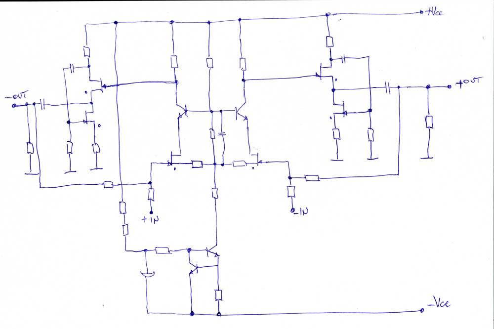

Question for Papa
I know that you made it all ........
so - question is :
for moderate gain settings - say 5 times , what's better sounding for you:
- Pumpkin like stage ( SUSY core, with outputs with gain) or
- Pumpkin like core (SUSY 😉 ) with buffer outputs (unity gain) ..... say as Papa Borbely -like buffers ........
so - what's better singing for you ......
as always - TIA .

All of my line stages are gains of 1 to 4 (that is to say between
0 and 12 dB) including the X1 I listen to day-to-day.
I don't have any hard favorites here, except to note that these
days they are all JFET based, at least on the input.
Partly it depends on whether I want balanced or not, and how
much voltage swing, and what kind of load.
Currently I am evaluating several single-ended circuits for use
in an upcoming FW line stage, but the results are not in yet.
