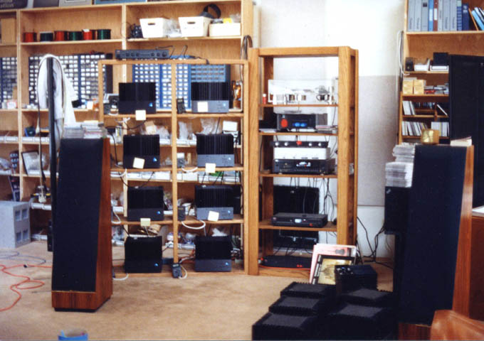

I've got several rooms that resemble that "Pass Labs starting out" photo and I'm not even making any money at this. I've got a selection of those 60 drawer plastic parts bins, but am slowly shifting over to some larger metal framed Mallory drawer sets that I picked up when my favorite local parts place folded last summer.

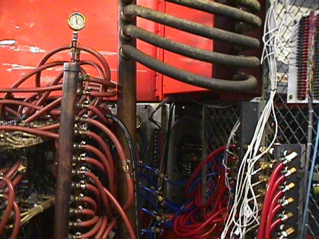

The cooling picture looks strangely familiar...still only the two pairs of Aleph 2s are water cooled here, but I keep threatening to do something rather more aggressive. I have ideas that I'd like to try out on a larger scale, but they'll have to wait until I have more time.
