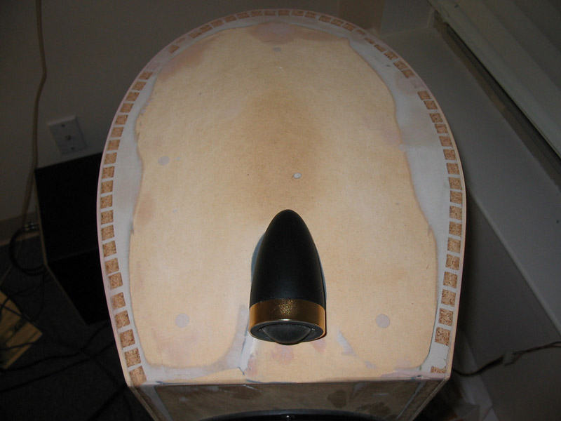

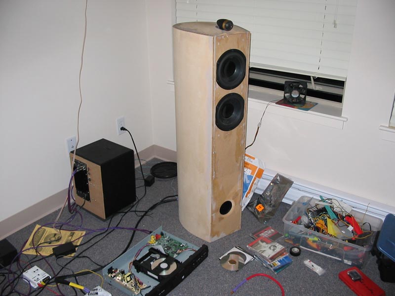

Joined 2002
They Sound awesome. I Love em. there 2.5 way speakers. a cap on the tweeter a coil on the bottom driver and the middle one is full range. They need new binding post's on the back so i can bi-amp them with a amp per each speaker so 6 channel's with a active x-over i'm thinking about using my pen-zen's a i have 4 boars just need to get them here also and finnish them but also to build chassis for my aleph and see how they sound also. I'm thinking about some ideas for a finnish. It's hard because i want it done right the first time and want to be happy with what i choose. Id like to change a few things put a base on them and change the internal stuffing and wire to some nice hi grade stuff.
Any way chris did a fantastic job im happy that i was able to buy them.
Here is a shot of the top..
