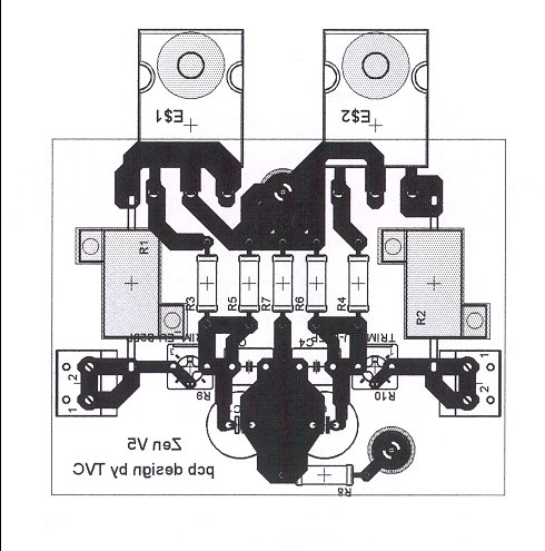

So, i´ve started putting a Zen V5 together, designed a board as i find it easier to locate my errors that way and also nicer to keep tweaking with. Using the verry good Arcol HS resistors for R1 and R2, stable, tight tc, and easy to keep cool.
There is no mentioning of fuses in the rails, if one of the pots should go open the energy in half a farad would escape through
the mosfets right? Using a good Bourns cermet makes this risk minimal but... should there be fuses? I´m a trial and error believer
and often ventute into error territory, but my wife dislikes flames from boxes in the livingroom.
