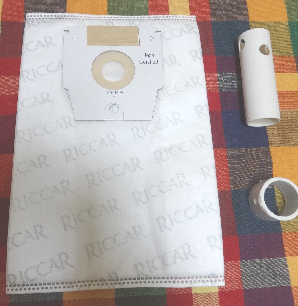

Thanks! With "social distancing" I'm pretty sure my filter bag wont take a direct hit like that.

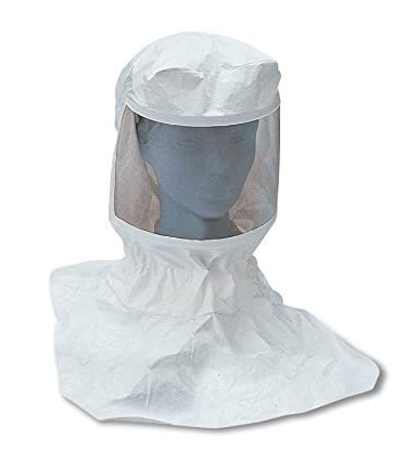

I've been looking at other purchasable equipment to improve the apparatus. I bought 4 of the following; Allegro Hood Assembly, Tyvek(R) 9910-10 | Zoro.com for $100. Stepping beyond that which I happen to have in the house...
The hood looks like it's gonna do it. For that price, I didnt get the hose connection, so that's going to be the first challenge in order to use them.

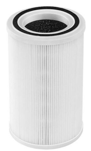

I've been thinking of filters I could buy. Looking strongly at Okaysou AirSlim6C Air Purifier True HEPA Active Carbon Replacement Filter 1 Pack | eBay
as it's also HEPA rated and as a room purifier filter, looks like it'll do the trick as well as the vacuum bags.

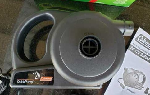

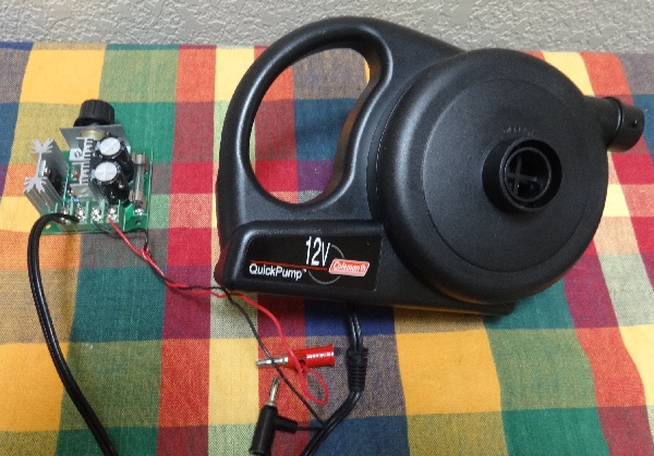

Since my 12L flow rate is sadly low (have one datapoint saying adequate for sedentary) I need a better pump. All I happen to have on hand is this coleman 12V inflator, which really takes off on 12V, pulling better than 7A. Definitely will need a PWM controller to reduce power and therefore, current for long term steady state flow usage. I bought two unbranded Chinese versions for <$20 on ebay.

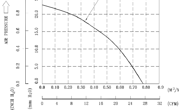

I purchased a couple of Delta BFB1012M-A, which is also a centrifugal cage fan, whos spec says it can deliver the 100+ L/min at 0.8" pressure. As I have no idea what the pressure will be to drive air into a loosely vented under jacket hood, so these fans are a <$20 gamble. They take 0.85A current at 12V
Bought a pair of the Okaysou AirSlim6C filters, to use with the above, also <$20.

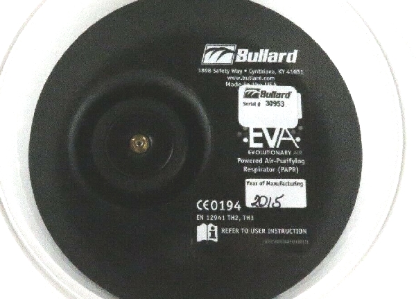

Finally, I'd like to call attention to BULLARD POWERED AIR-PURIFYING RESPIRATOR PAPR EVA BLOWER UNIT | eBay which is a professional PAPR flow pump. The seller has over 100 of these at a very reasonable price. Whether they can be adapted to just any battery (noticed battery connector has 4 terminals, so maybe refuses to energize without OEM battery pack (not included), nor does it come with a filter) or filter remains to be seen. I notice it does use a similar centrifugal type fan to the units I purchased, though who know what the model / specs are w/o a teardown. Seems quite a bargain, as a whole system is in the kilobuck range.
I'm hoping something effective and actually nice to use can be assembled for <$100 per person -

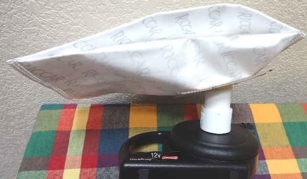

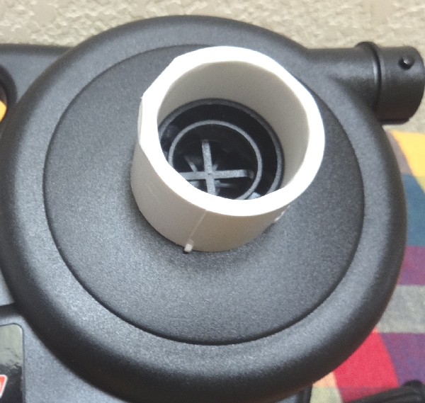

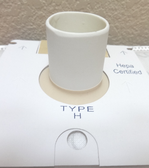

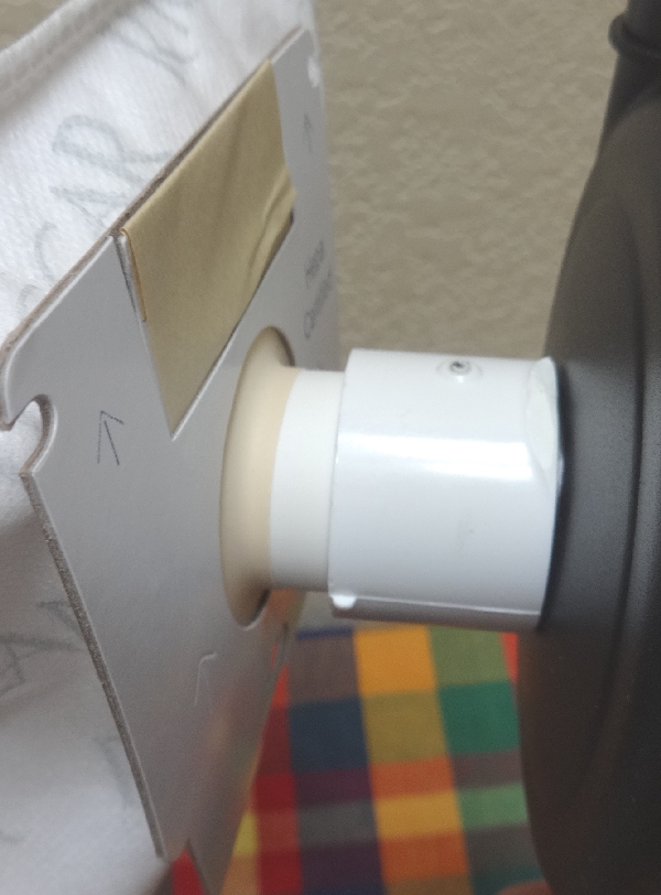

Hey, I got some professional white tyvek PAPR hoods with nice, smooth clear viewing window on the way. 10X the price of round bottom 4 mil poly pail liners, which would be just a bit harder to see through, but could do in a pinch.
The coleman fun-tube inflation pump is actually a contender, as it is something people just might have kicking around. When used with the ebay PWM controller 12V-40V 10A Pulse Width Modulation PWM DC Motor Speed Control Switch Controller | eBay I can get better than the diaphram pump flow at < 1A current from a 12V supply.
I'll have to setup an RC filter at the motor terminals to see what the equivalent DC voltage to run it this slow - maybe it's a value like "3".
It's very, very noisy, even at low RPMs. I assume the thin, ringy, plastic impeller cant be removed from the motor shaft, to perhaps coat the backside with some damping material. 4 screws hold the impeller body clamshell together and I did put 4 rubber washers at the butt ends of the screw receiving plastic pillars which did quiet it down some. Wish I had some of that "black hole" speaker interior cabinet resonance reducing paint on hand...
Hopefully next trip out will be with this air pump and the real hood. I ordered a set of Samsung 18650 batteries 4 SAMSUNG 26J M 18650 ICR 5200mA DISCHARGE 3.7V RECHARGEABLE BATTERY 717356043703 | eBay for <$20.
Progress
I'll use a cheap DMM to measure motor voltage in-use (via 10K / 10uF filter) to find best DC voltage, current, air-flow.
