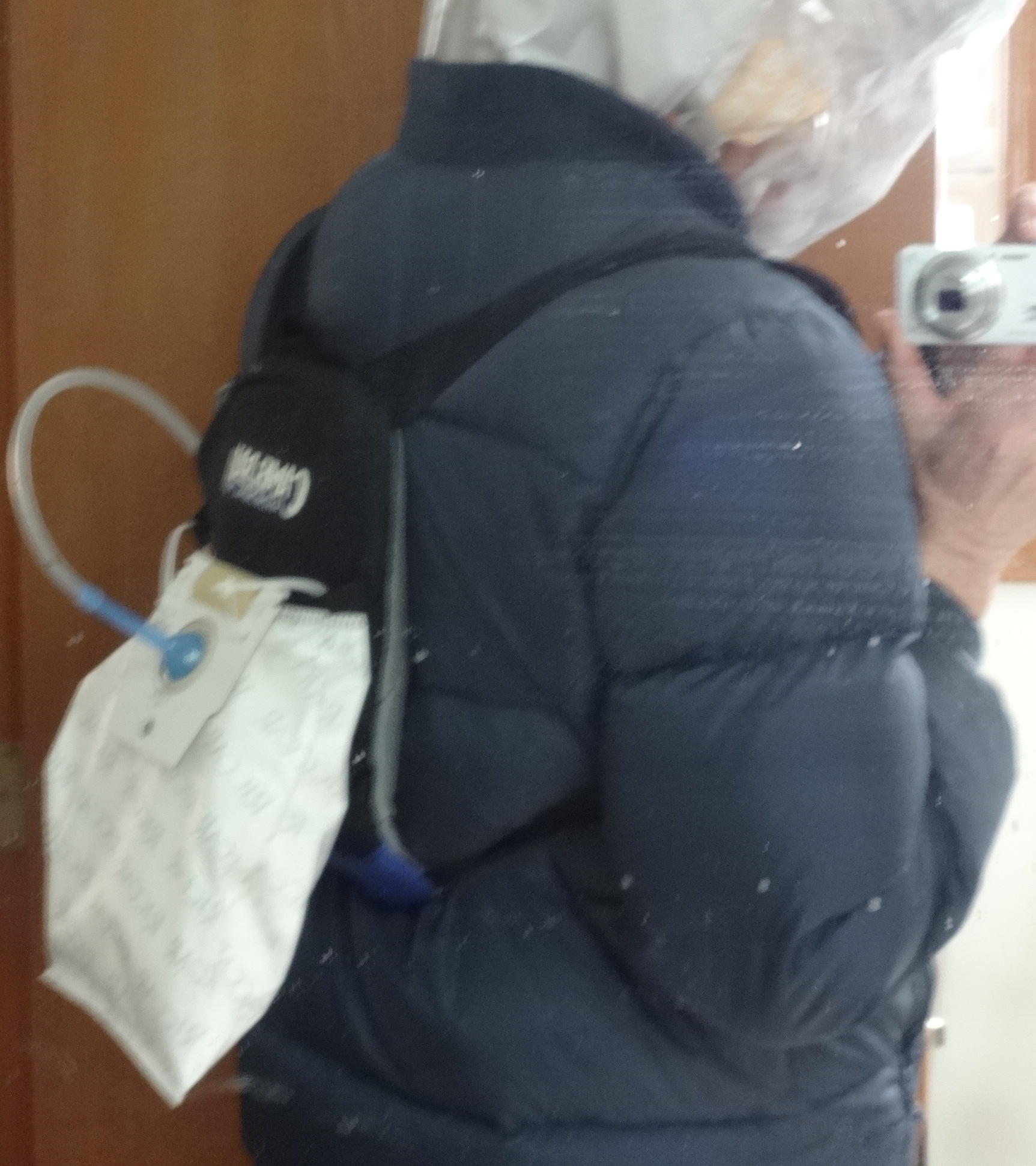

Thanks! With "social distancing" I'm pretty sure my filter bag wont take a direct hit like that.

If you search ebay for "DC 12V 12L/min Diaphragm Pump" a few examples of the pump I have (the round white one) will come up.

For anyone still following, I've verified the 1.5A motor current for the 12L/min pump. That should give an operating time of maybe 1.5 hours to 2.8, depending on the 18650 cell capacity.

I've been thinking of filters I could buy. Looking strongly at Okaysou AirSlim6C Air Purifier True HEPA Active Carbon Replacement Filter 1 Pack | eBay
as it's also HEPA rated and as a room purifier filter, looks like it'll do the trick as well as the vacuum bags.

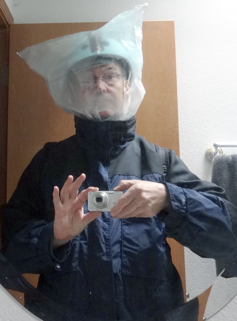

These are not particularly expensive component investments for something you can use to protect yourself when doing business in closed quarters that involves other people and takes time. I think filtering your own breathing air, on the spot and in real time is a good way to go - to lessen the chance of accumulating a viral load from the airborne aerosol vectors.
The hoods also prevent accidental face touching - and frankly I'd rather have some standing near me sneeze in one of these hoods than out into a room full of people. I think it would effectively block the projection velocity allowing people to clear the area in time.
