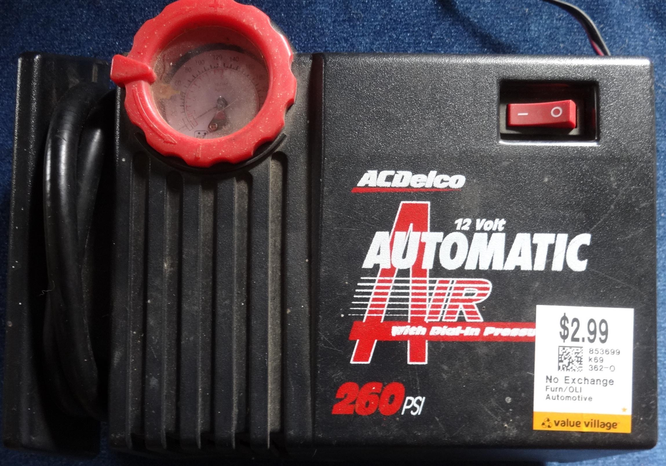

I was in a thrift store a couple weeks ago. There was an oxygen mask, brand new in a sealed bag, amongst the crutches and diapers. I had it right in my hand, but it didnt occur to me to buy it. If only I'd have the sense to take advantage of the opportunities I've been "given" by recognizing them as such...
These are common - I bet someone could hack together a similar outfit from this as an air pump -

CONGRATULATIONS. INCREDIBLE CREATIITY AND SKILL And clearly it attacked the technical problem the right way. Thanks for providing full component details so others can try to clone it.
Thanks! One detail I left out - the vacuum bag is filled with "corn starch peanuts" the bio-alternate to styro-peanuts for shipping cushioning. To keep it from collapsing, as there is a slight vacuum in there. I hope it's OK to breathe air that has flown over / around those things. I'm still alive today, I seem to be OK after an hour in it yesterday.

Does it vent into your jacket?
An oxygen pump or tank (too much O2 when enclosed?) or scuba gear could be helpful for those who have it.

Yes it does vent out under the jacket. Hopefully, at ~10-12 liters/minute, most of the atmosphere inside the bag will ultimately be filtered air.

I would be concerned about insufficient air flow. Try it at home for an extended period of time and be prepared to rip it off quickly if you start suffering CO2 overload.
Test a set of fully charged batteries for run time.

The bag will pop off in an instant - nothing holding it in place save the gather around my neck, provided by the jacket collar.
I tested it with a fully charged battery set. After an hour run time, the batteries still measured 12V. I believe the batteries are 3.5 AH, while the pump draws 1.5A (spec, I havent measured it). So it makes sense I wouldnt deplete them fully.
I wouldnt do strenuous activity in this thing, like go dancing. But just pushing a shopping cart around should be light work. (I wish I had one of those pulse oxymeters to see how my O2 changes when wearing it in time) Certainly a very temporary measure! Hopefully effective and safe enough, considering.

It's somewhat more than a walk in the park to wear this thing. I can definitely sense some measure of stress on my cardiovascular, but no where near where I'm actually getting dizzy or like after jogging a mile. My wife wanted to dally, go look at the flowers in the garden section, pick one to buy - while I wanted to hurry. I just kept my mouth shut and went with it, figuring it's a test of this system. The cooler air outside was refreshing.
Definitely need to wipe out the inside of the bag between stores and of course I brought along nothing to do so. So the second trip had moisture buildup a little more dense than the 1st; I was still able to navigate about, operate the self checkout kiosk, looking up vegetables and typing in codes that didnt scan. Mounting the exhaust tube on a headband such that it blows at the plastic bag in front of your eyes in one way to keep that area fog free.
I measured the battery pack (under pump motor load) after we arrived home and got everything unpacked. Better that 14V. Unsure if lithium batteries "bounce back" in voltage level after current load disconnect; if not, the 3.5AH battery pack seems to be adequate for such a trip. Maybe I should have measured this at the car -
Most people in the stores were carrying on as usual, maybe a small percentage were wearing masks. There was a surprising number present for a Saturday morning, however the checkouts were line free. A Winko worker at the checkout remarked to me it's way more crowded just after the 1st of the month.
I may look into doubling the flow rate by adding a second pump operating in parallel. Pump noise is nothing, relative to background noise level in the stores.

Do you have a vent hole in the bag large enough to exhaust but small enough to maintain inflation?Maiden voyage today; we went to Wally and Winko - two stores, about 45 minutes in Wally, 1/2 hour in Winko.

If possible what brand/ model is your pump. I would like to make something similar for painting/welding with very toxic materials that I could bring fresh outside air into. Maybe need several pumps there!

The bag really isnt pressurized - it just leaks out under the jacket I'm wearing. The idea is that eventually, ultimately the bag is filled with "filtered" air - and there's enough volume that my inhale wont suck in anything that's not filtered - from underneath my jacket.
