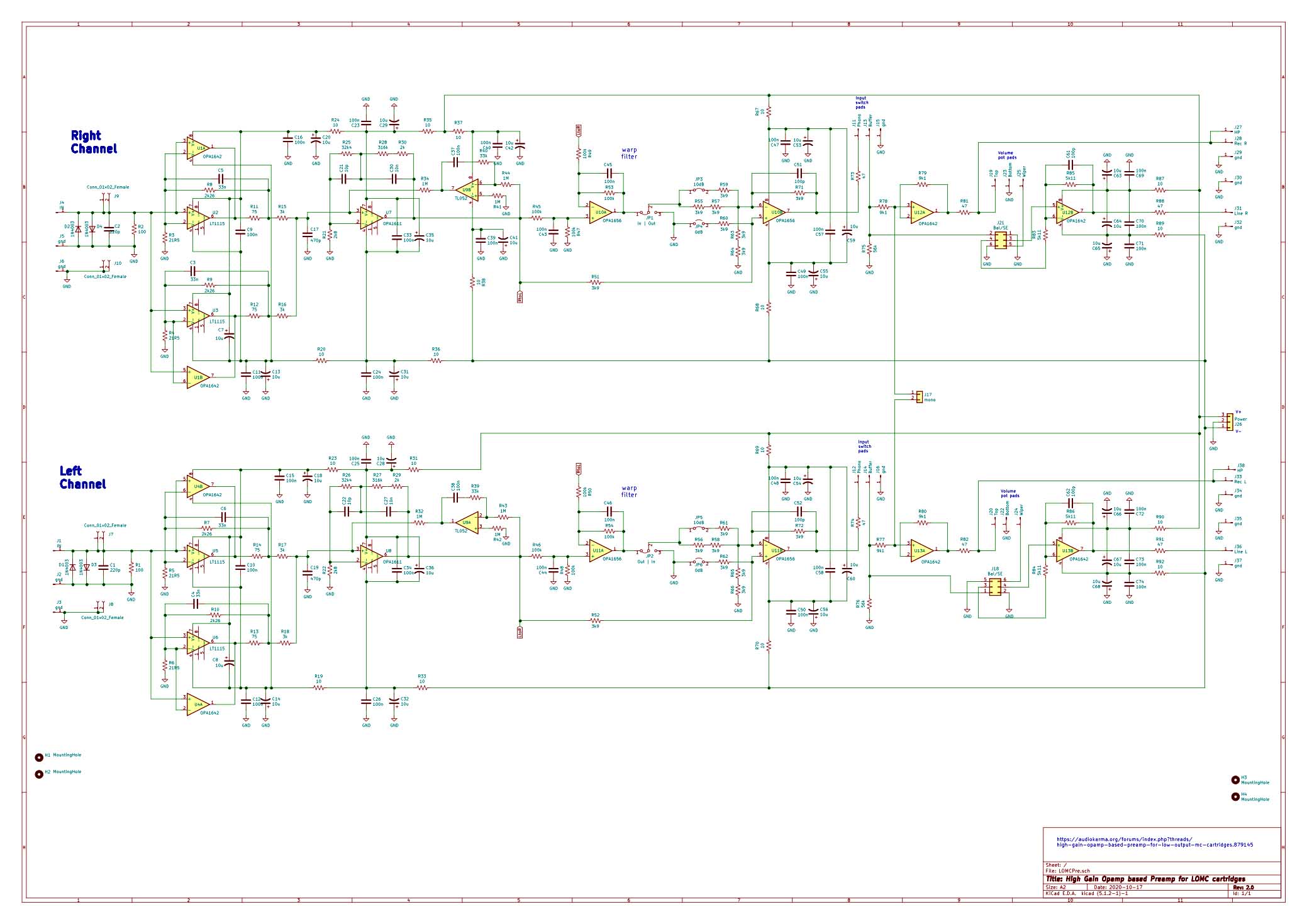

Below is a link to a drop box with the info of an earlier version. The salient schematic is included.Hi. Is it possible for you to post the schematic?

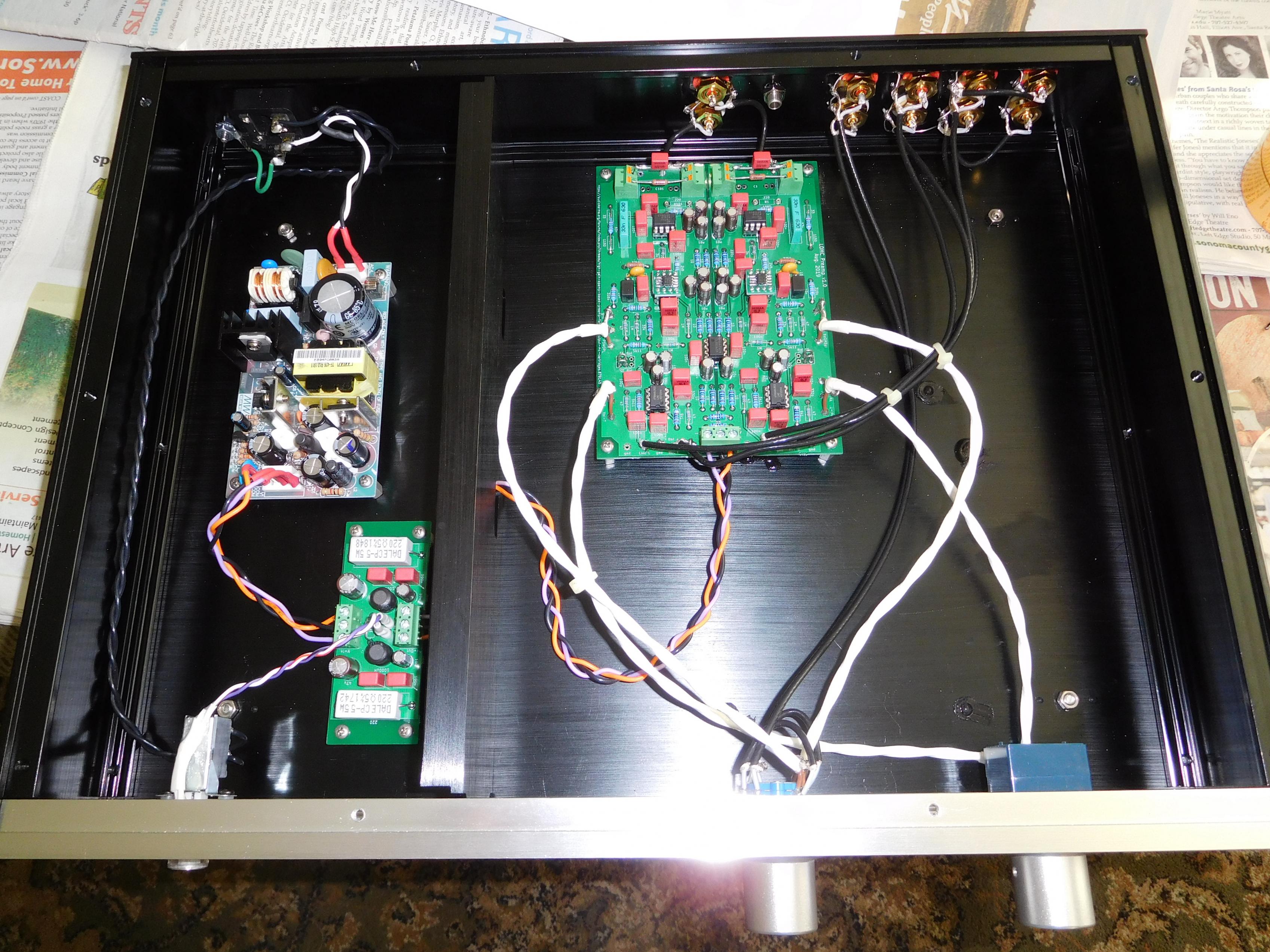

You're using an SMPSU, they always are common-mode noise generators. Call it ultrasonic leakage current if you prefer - that current has to go somewhere. I take it you're taking signal ground to safety earth at some point?
There is no DC short between safety (mains) ground and the SMPS ground. There is an optional capacitive connection to the chassis (safety ground) at the input and output section grounds of the SMPS. The amplifier is isolated from chassis and relies on the grounds of the driven amp to provide signal ground.
There is a ground post available on the chassis.
Noise etc. measurements are made with the preamp in circuit, driving the output power amps using an RME ADI-2 PRO FS and REW.
There is also an additional local ground referenced LC filter added at the output of the SMPS to reduce HF switching noise.

So effectively your implementation is class 2 (i.e. double insulated) ? In which case noise currents divide between the (optional) capacitor to safety ground and the downstream component (which may or may not have a DC connection to safety ground) via the ICs.

Schematic of preamp and layout.Hi. Is it possible for you to post the schematic?

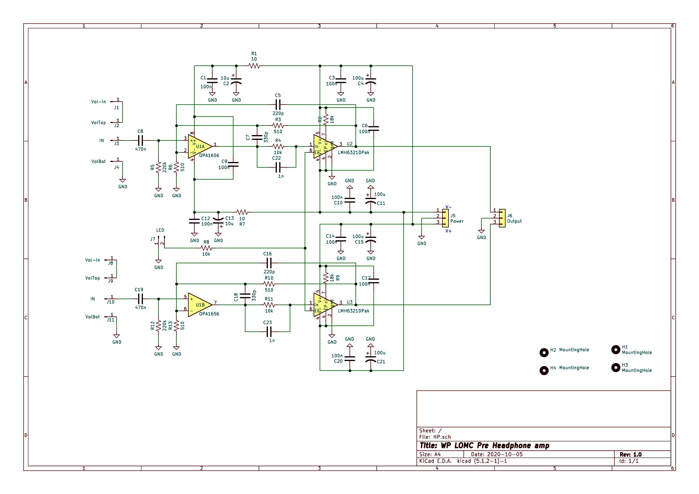

Headphone amp is separate.

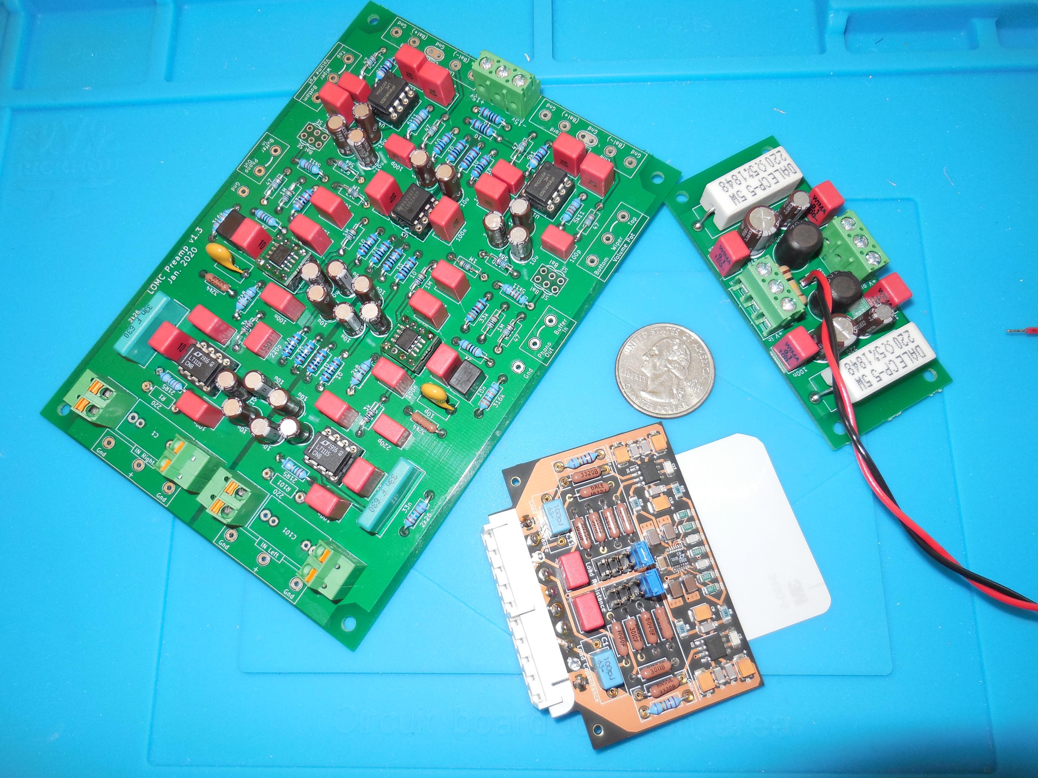

Here is another photo of the preamp board and the filter board for the SMPS. This my second build, which will include the headphone and warp filter circuits, as well as more line inputs, record out, and MC input. The smaller board is not associated with Wyn's preamp - it is an MC board for Apt Holman preamps.
