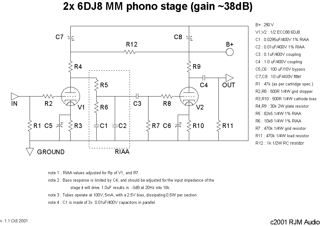

Does it specifically have to be a kit? I have a 6dj8 based phono preamp that I built on perf board that sounds fantastic.
I built the power supply into a separate enclosure and put the pre into a shielded box. I shielded it with copper foil tape and then grounded that. All dc heaters and HV is regulated with an lr8/pass transistor so it is completely silent. I've attached the schematic for you if you are interested.

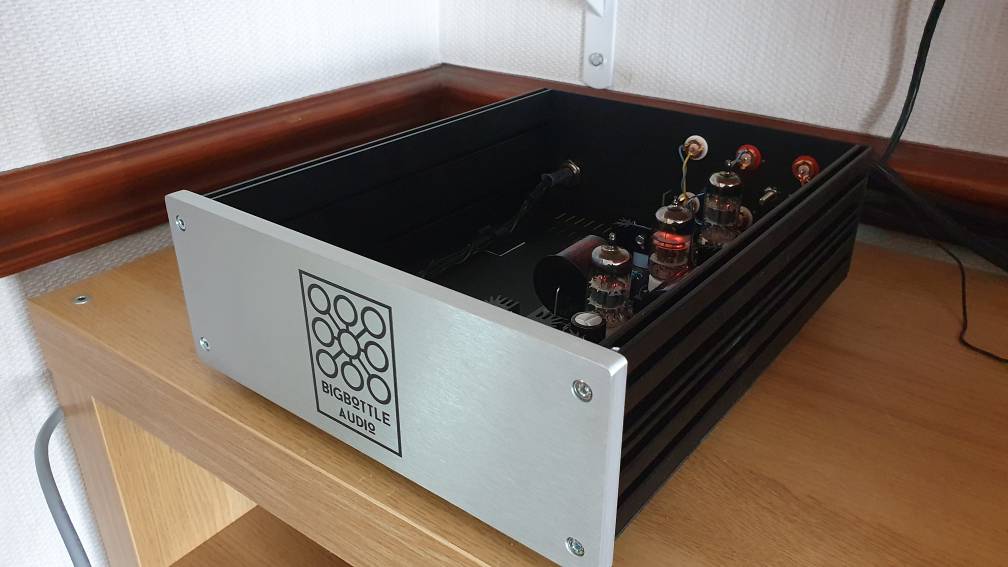

Difference between valve and solid state is night and day. Valve gives you much better dynamics and soundstage with the increased dynamic range and overload capability. Be careful with the EAR ... too warm in my opinion. The modified RCA is a great circuit but as mentioned too much capacitive load. If you want a kit, you can't go wrong with Bottlehead. I have heard MANY phono stages and the BigBottle sold here on this site is hard to beat!
I'm sure Oliver will mention them, if you order the BigBottle board, be sure to get the multi-fet boards with it. They're not expensive and reduce noise by around 3db. I'm waiting for some parts from Mouser then I can start building mine.
It's a nice board and printed on both sides so you have a choice on having the valves showing nor not.
Ask any questions of the Bigbottle you would like to.
Happy to help although the bare PCB is no longer available. I only sell the fully populated ones now. All 0.1% tolerance parts, including signal caps.
