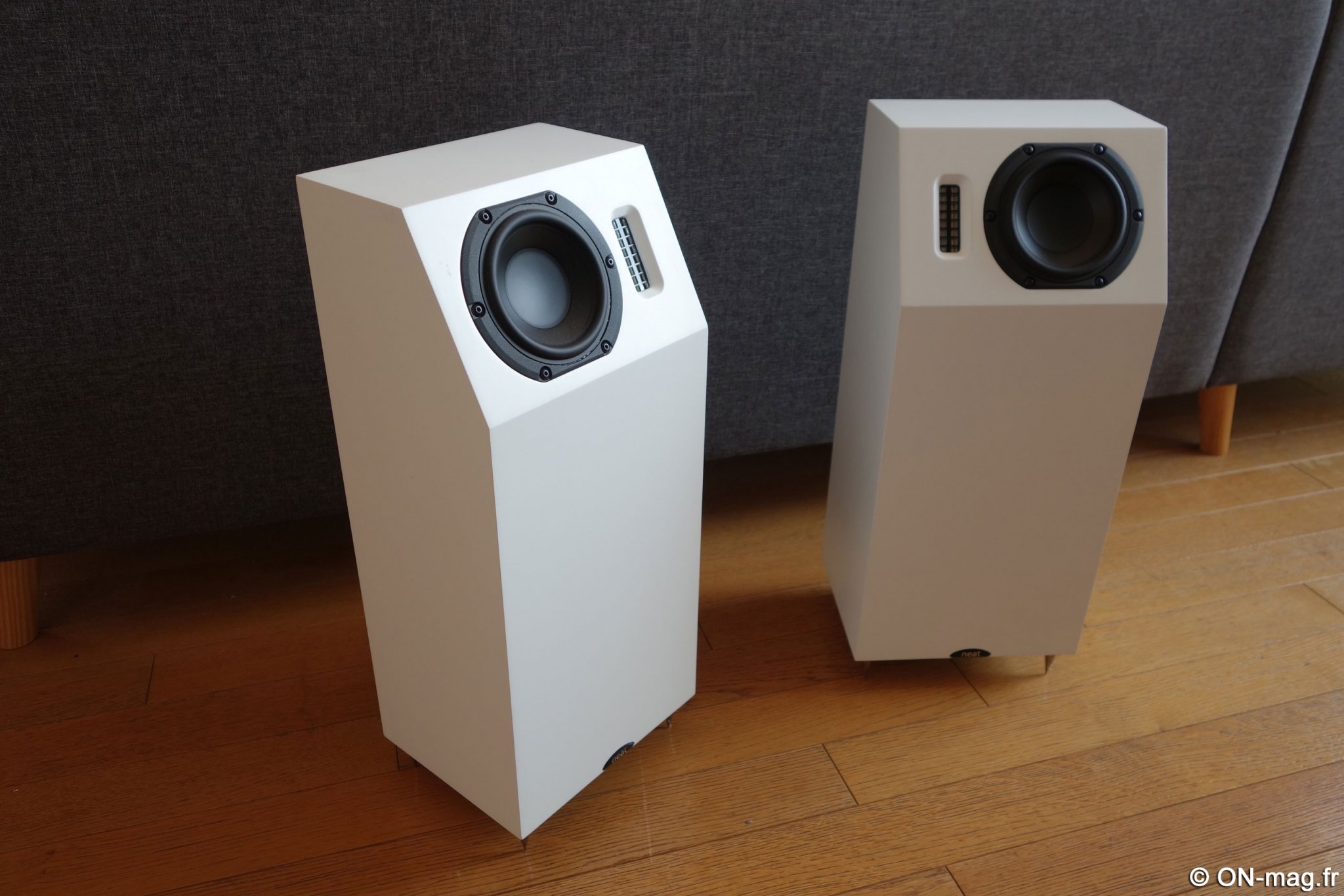

Hi, Im a pretty new to DIY speakers. I have just done a couple of kits before.
Now I want to make a "copy" of the Neat Iota Alpha speakers, I like the look of them and I read a lot of good reviews for such a small speaker.
I have been digging around on the net and found some info. I have the dimensions and the name of the woofer and mid drivers.
But Im struggling with the tweeters.

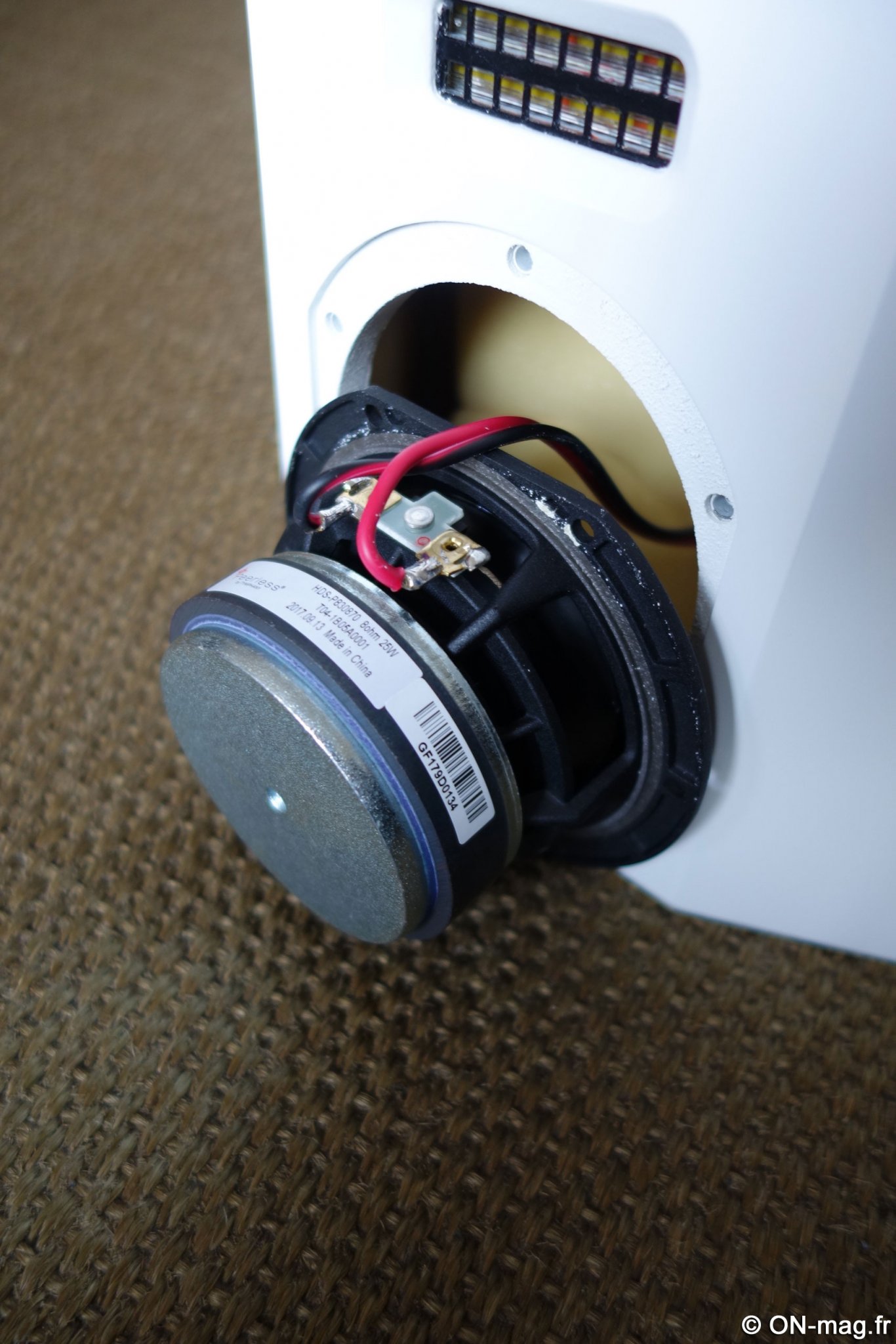

They use Peerless SDS-P830656 woofers and Peerless HDS-P830870 mid drivers.
The tweeter they use are listed as 50mm EMIT Planar Magnetic, but I cant find them on the internet.
These are very cheap drivers and I find it a bit strange that the price of the speakers from Neat are over 2000 $ here in Norway!
So, do anybody know where I can buy the tweeters they use, or can anybody give me some good advice when it comes to pairing the Peerless drivers with a matching (
ribbon) tweeter?
The Neat speakers are 2.5 way speakers and I will add some pixs here.
I will prob need some help if possible with the X-over, but I did read that they are crossed over at 4k and 80 hz
Hope somebody can help me out here.

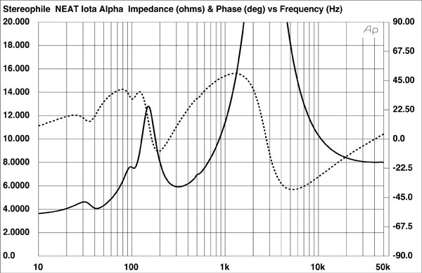

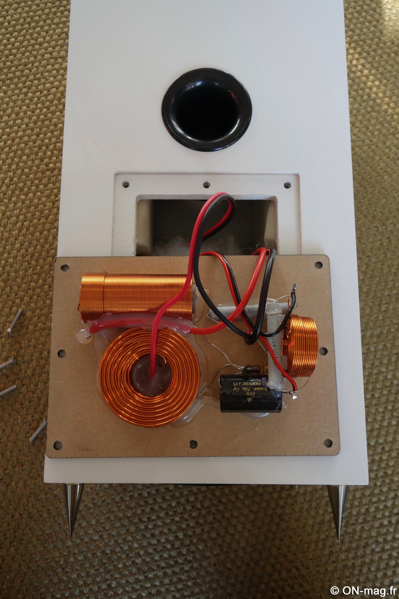

If I can add to what Ugg10 has previously indicated:
It's a simple enough parallel 2.5 way crossover with a large value inductor in series with the woofer and a smaller value inductor in series with the midrange.
The HF section consists of a series capacitor, parallel inductor 2nd order electrical circuit. A two resistor L pad follows for tweeter attenuation.
The difficulty lies in determining the values of these components and that's where someone with crossover design software might offer help.

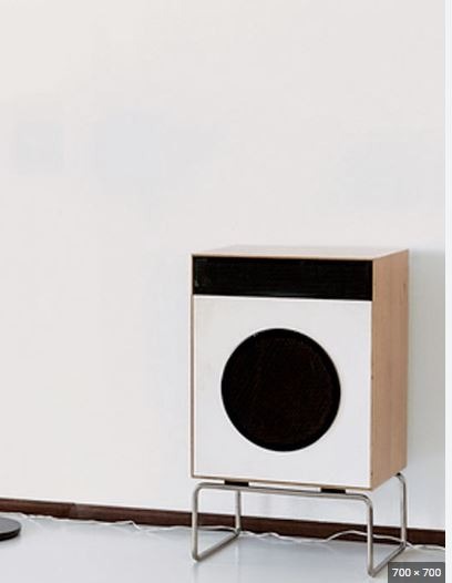

I really like these M&K audio speakers , but they are very hard to find any info about. Also it looks like a 2 way with a 8 or 10" woofer, and its tricky to find those for a 2 way system.
I also LOVE the design of the Braun L2 speakers (from 1958!), and I can find some info on them but they are much harder to build, at least the tubing stands.
