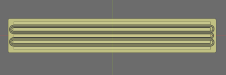

If we take a traditionally corrugated membrane with outside fill for stiffness:
The traces are only 3 mm wide which makes the fill take up most of the weight. But we can counterract that by using much heavier foil for the traces vs the fill. I have for example used 14 um alu for the fill, and 30 um alu for the traces.
But the above membrane has some wiggly distortion patterns that seem to go away if I use a heavier alu for the fill, 20 um. Or if I, instead of having gaps around the traces & 20 um foil, use a solid fill of 14 um foil.
And it just so happens to be that the 20 um fill with gaps for the traces, and the 14 um solid fill weigh pretty much the same within a few %. It is also nice that the filled variant has no aligntment needed, since there are no features to align, simplifying the design.
But still it is not as efficient as my gapped traced membrane with 20 um fill + 20 um traces on both sides. That is why I want to buy 50 um aluminum tape, such that a single side of that thick tape will be equivalent to dual sides of 20 um.

And about the thickness, keep in mind that the trace width is only 3 mm, where the magnet to magnet ctc is 10 mm. My first foils had 6 mm wide traces, like this, and 20 um thickness was a good compromise on weight and performance:
They are pretty efficient and can be cut from one sheet of aluminum since by area, 42 % of the foil is driven which is pretty good. And distoriton is pretty good also, as long as I don't push the xmax so I can't cross too low.
If I reduce the traces width from 6 mm -> 3 mm, then the magnetic field is far more linear so the distortion when pushed is way way lower. It is not even close, all the tall order distortion just goes away. But, like you say, the efficiency goes to hell which is no good to me. Or at least it does, if I use the same trace alu foil thickness.
But if I keep the alu fill at 20 um, but slightly more than double the thickness for the traces, then even though I'm using say 50 um foil for the traces, the actual weight of the membrane stays pretty much the same. It is still slightly heavier because fill area is larger, but only in the order of 15-20 % so not that significant.
