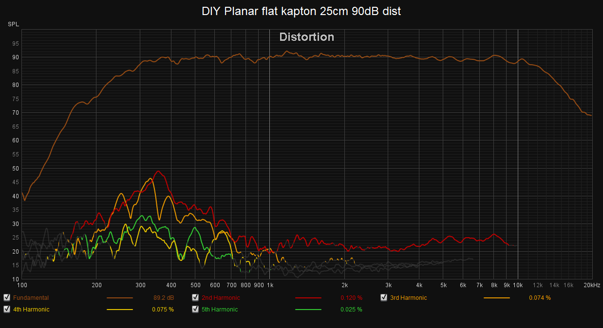

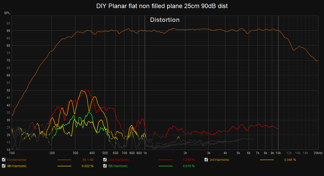

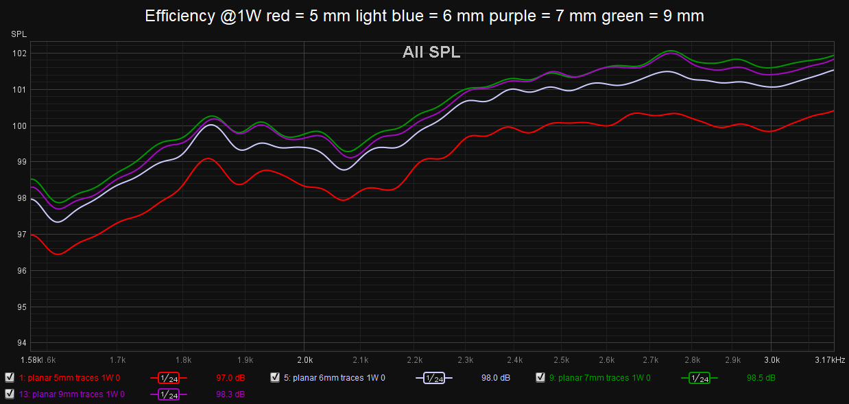

I did test that, here is efficiency of 5-9 mm wide traces:
So in terms of effiicency, there is minimal difference between 6 mm wide traces with undriven areas, and 9 mm wide traces with no undriven areas since the magnetic field is stronger in the middle of the magnet gap.
But as I wrote before while the efficiency great, and the distortion is great also as long as I don't push the xmax. When I push the xmax it does not perform well at all since the magnetic field is not that linear, thus tall order harmonic distortion skyrockets and it sounds bad. Technically I could just accept this and cross higher such that I use less xmax, but I want to build a midrange + tweeter capable capable planar so I want to be able to cross as low as possible.
Solhaga did great simulations in this post, and my measurements confirm his simulations:
This simulation especially which plots the difference in magnetic field strength, across +- 0.5 mm xmax, with different trace widths. The orange line, which hugs the 0 line so closely, is the 3 mm trace width. And it performs great in practice.
So as long as I have a trace / coil width of 3 mm, then there is minimal distortion due to differences in the magnetic field throughout the stroke length. But then I have to get creative since I still want good efficiency.

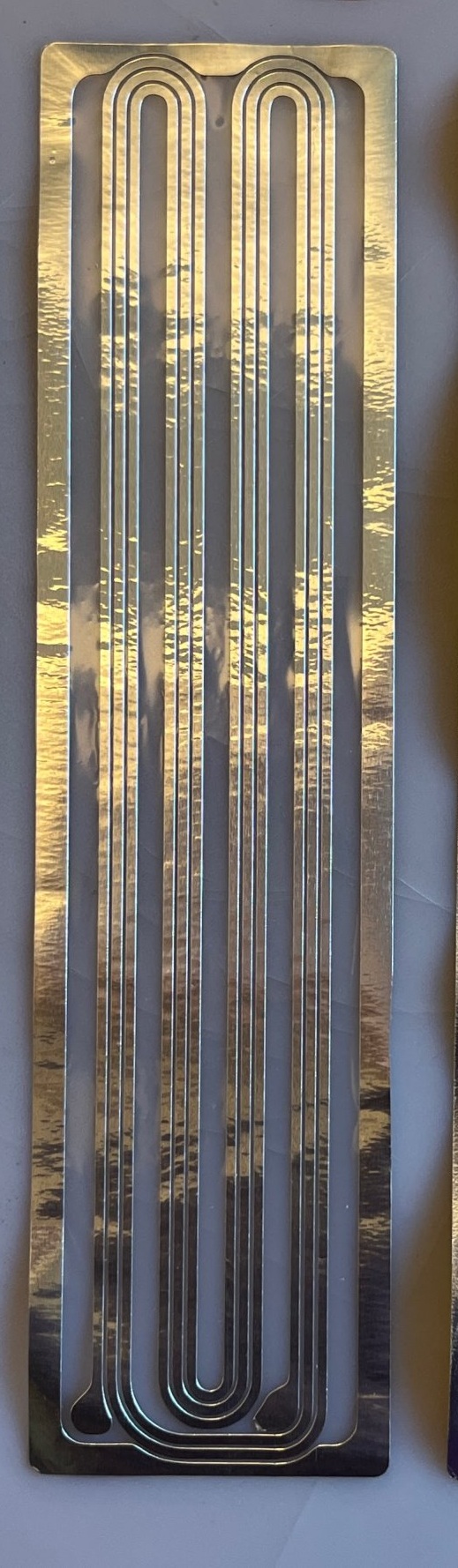

I looked back in my measurement folder and found distortion curves of 6 mm wide traces, one with kapton + undriven areas and one with mylar but empty mylar between the magnets, and only a small border to make it stiff at the suspension.
Here is a photo of the membrane with the empty mylar areas + border:
I'll have to backtrack on my saying distortion was way worse, in fact it was comparable. Where the undriven and exposed mylar membrane fell apart was in the high frequency response.
Sadly I can't find the measurements, looks like I didn't save them 😢 but the problem was that the 0-90 polar response was in no way smooth, above 5 khz. In fact, it was all over the place and very inconsistent. You can see part of the notch on the top end but the polar responses were way way worse than just that little notch. And since part of my requirement is that it also has to be a good tweeter, I discarded that idea.

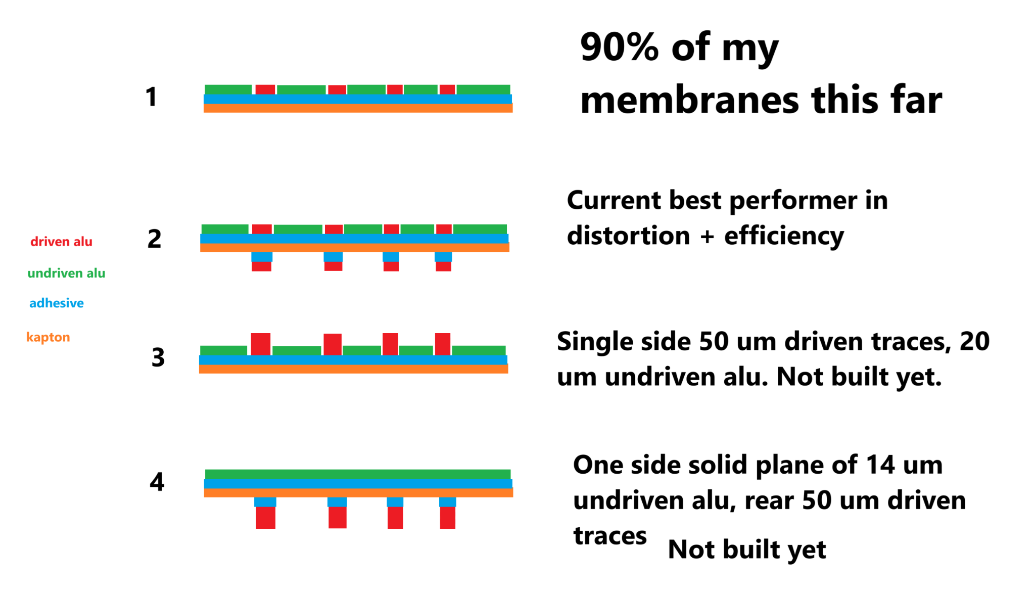

Up until pretty recently, all my membranes were of type 1, which by convention is the default. I copied this from your excellent videos when you did corrugated membranes so everything cut form a single sheet of aluminum, glued to the mylar / kapton and then done.
2. was a test to see if I can have 3 mm wide traces without murdering efficiency. My solution was to run double coils which in practice is twice the driven alu thickness relative to the outer filled areas. The currently best performing of this type has 20 um driven traces on both sides, and 20 um undriven alu fill. All glued with the 3M 77 spray.
3. is when I got the thought, hey, double sides are complicated, what if I just double the trace thickness on one side? I believe this will measure pretty much the same as 2. The main benefit would be easier manifacturing since there is less to align and with only 1 side I can piggy back on the kapton pre applied adhesive.
And 4. is the idea bounced by me and solhaga where what if we dont cut any gaps for the traces in the undriven aluminum foil but rather just place it on the other side? Not having the gaps makes the foil a lot stiffer which reduces distortion. And with no cuts on the thinner (and easier to rip) aluminum foil for the undriven areas, the manifacturing will be greatly simplified. This would probably be a bigger benefit for solhaga than me since he uses crazy thin aluminum that will rip if you breathe on it 😆. But even jokes aside this one will have nothing to align either, since one side is just a completely filled plane, so no risk of shorting the traces to the fill if I apply the traces slightly too much in the wrong direction.

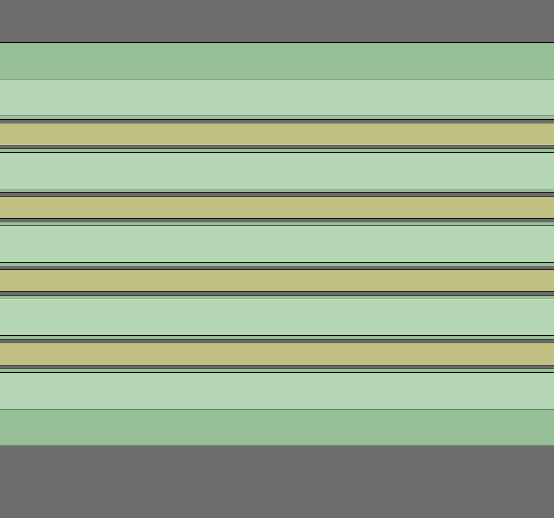

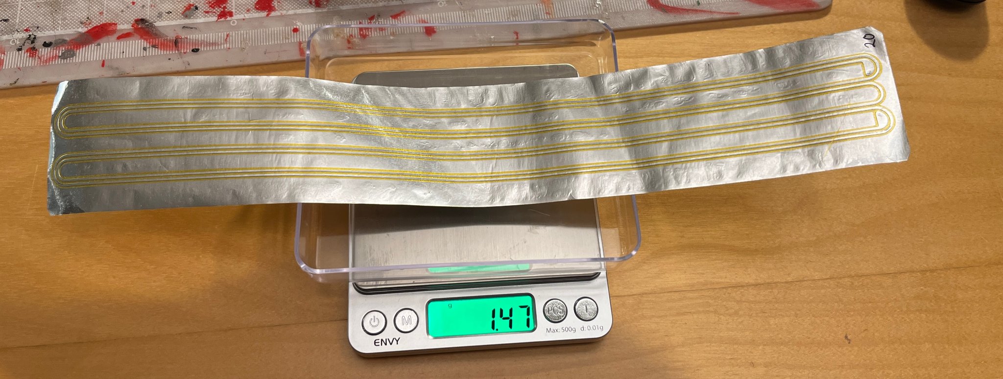

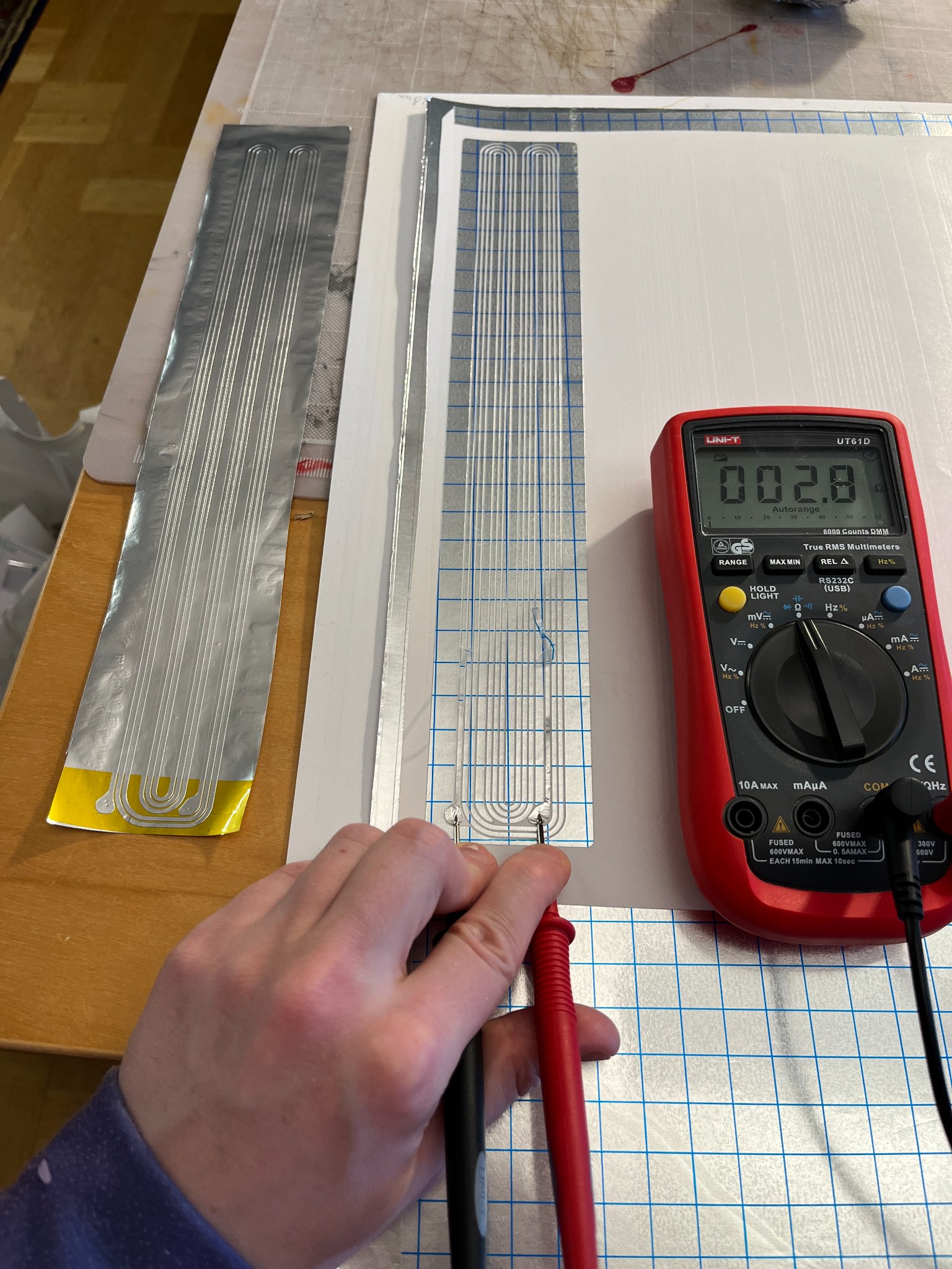

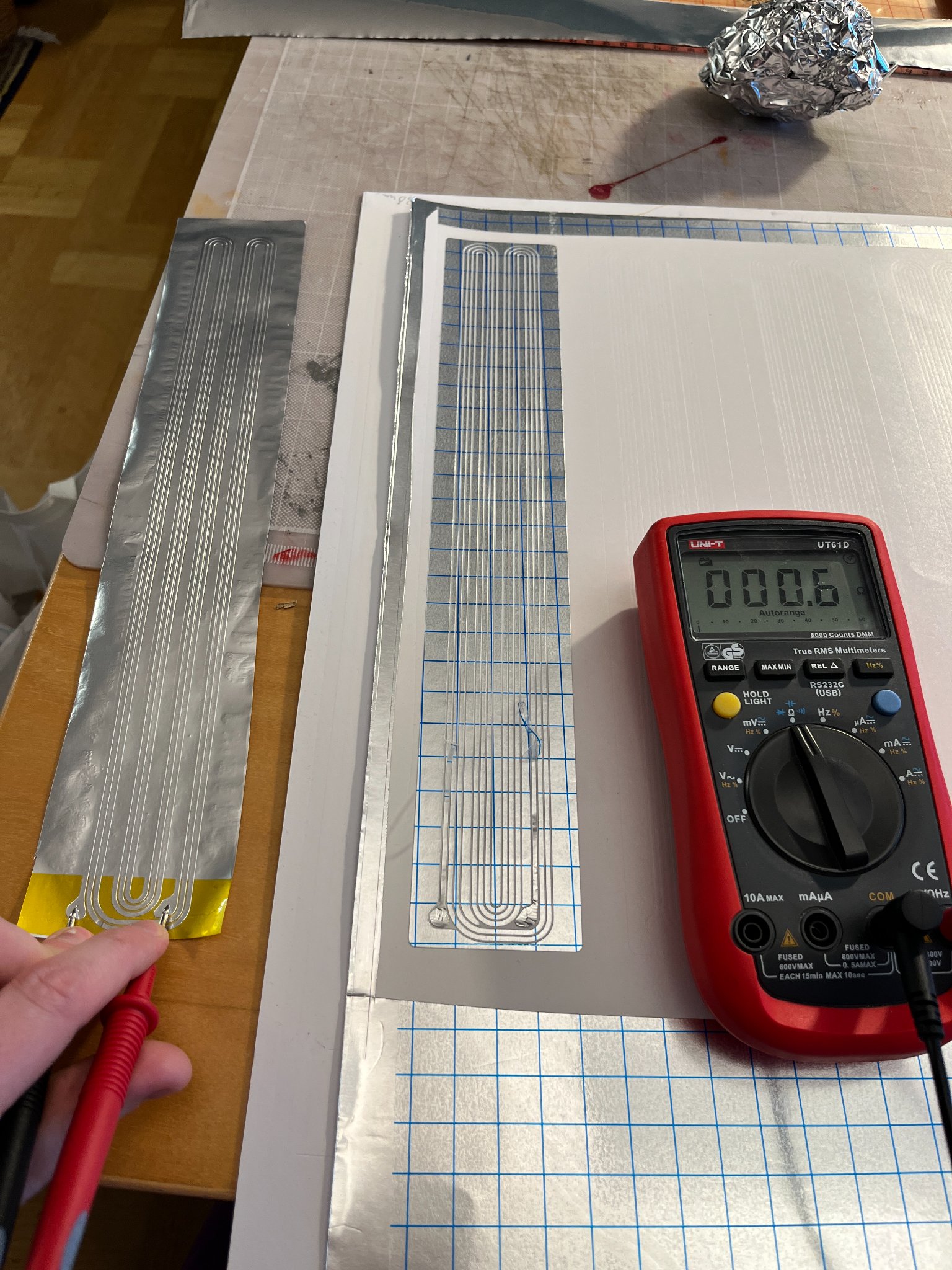

Since I have to wait for my next roll of tape with actual 50 um aluminum foil thickness, I have time on my hands. And I believe that I can use 30 um aluminum foil as as a substitute for a set of tests.
What I want know is how should I layout the kapton and the undriven alu?
A is the conventional setup where the driven traces are in between the undriven fill, with some small gaps.
B is the idea of having undriven fill over the whole plane, and placing the driven traces on the bottom.
C is same as B, but with the unconventional thought that hey, what if we only use the kapton as an electrical insulator and remove it elsewhere to save weight?
D was my even crazier idea that maybe the acrylic adhesive is enough insulation to not short the driven traces to the fill. And I tried it and no, it doesn't work. It most definently does short to the fill. The following membranes would have the same resistance if it didn't short, but in the pure aluminum membrane on the left the resistance is way too low.
My plan is to build A, B, C in 2 versions each, 14 um undriven alu and 14 um undriven alu, all with identical self adhesive 30 um alu driven traces.
I will then take the best performing variant and reproduce it with the 50 um self adhesive aluminum tape and compare that one to my previously best performing membrane which is a dual sided coils of 20 um alu, 20 um undriven alu with gaps around the coils on one side.

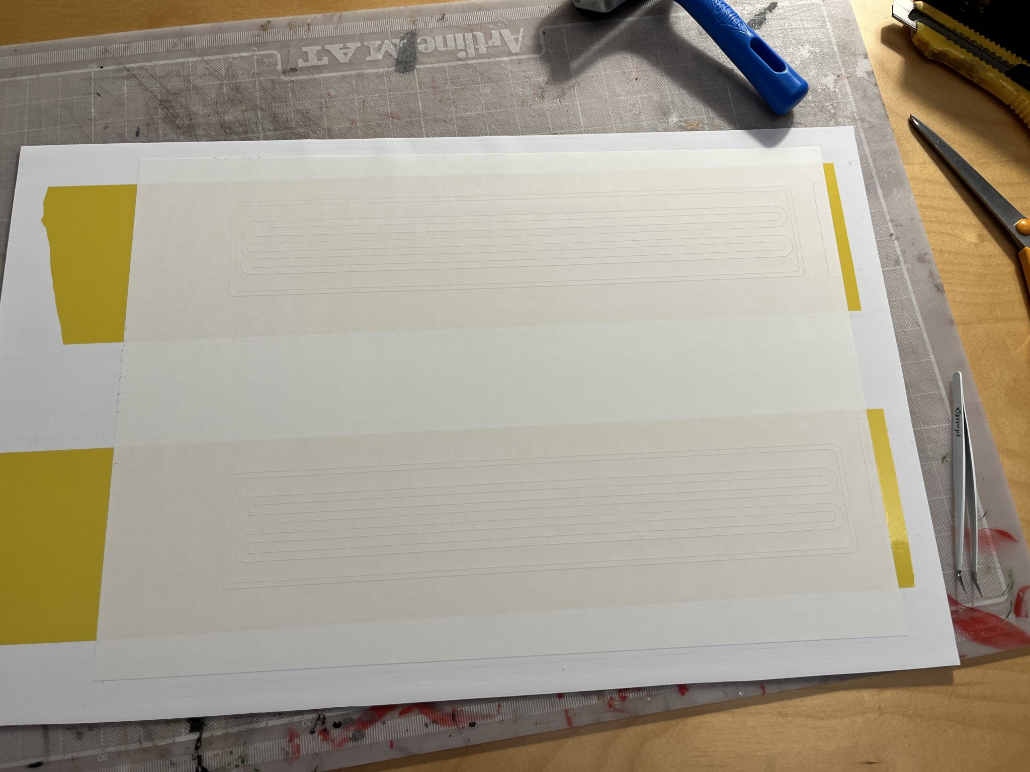

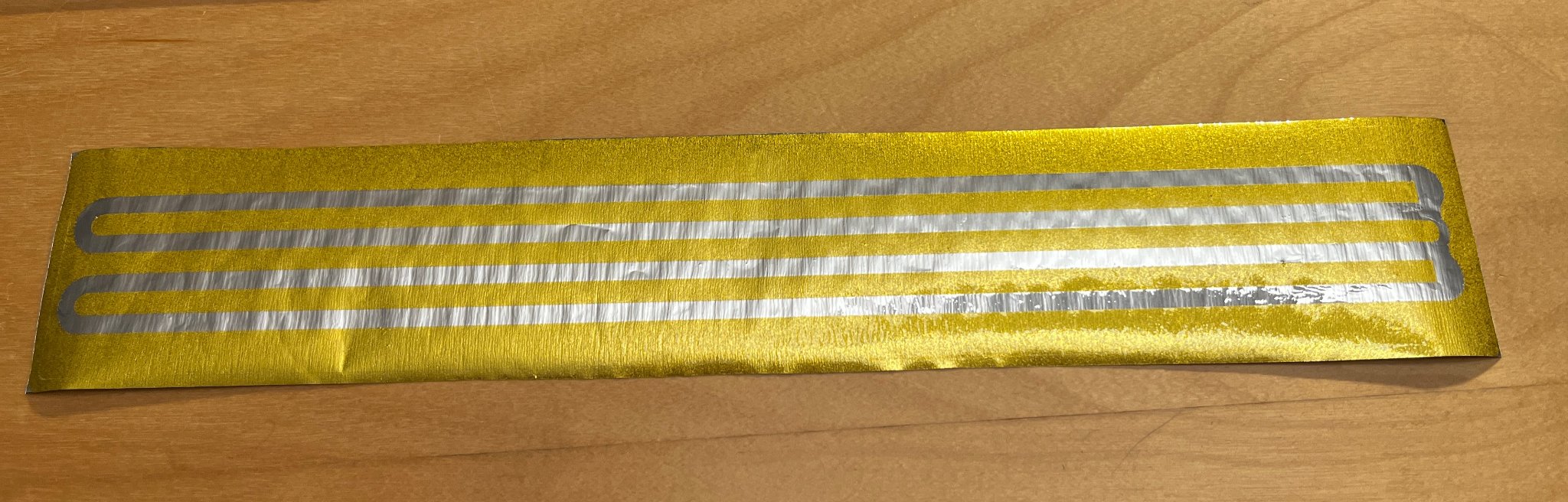

I tried to cut some kapton for variant C, it is quite fragile but it does cut. It was a nightmare to weed though
But I succeeded! Or at least I would have if I didn't weed the wrong parts 😆
I decided to call it a day after that...
I don't expect to make any progress tomorrow since I have to work but I plan to continue on tuesday and re cut some kapton. Although to be honest I hope that B turns out the best because it is the easiest to manifacture. Cutting and weeding the kapton needed for C is very time consuming and it is extremely fragile. To make C feasible to manifacture in large membranes I'd probably have to buy kapton with pre applied adhesive and a release liner, but that is even more expensive than plan tape or non adhesive kapton.

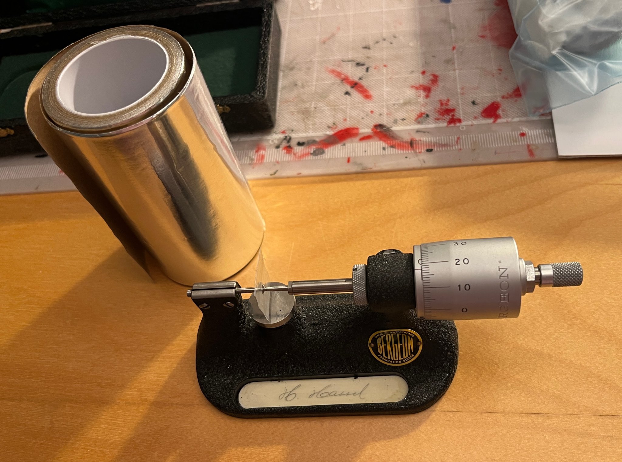

So i received my tape... finally, if i measure it with adhesive its 48 micron. quite thick., i tried removing the adhesive and it was around 15 micron aluminium. not the 13 but still as light as one can find an alu tape. (halve the thickness i had before in larger rolls) its 30 cm wide so you can make more interesting foils. ill measure some 30 mic alu later this week. to see what the weight difference is. there is a point the glue is more heavy then the foil... i had a roll with the same thickness that i liked for tweeters but was only 40 mm wide. so a 300 mm wide roll will make new things possible.
then again super77 is thinner. but less reliable as well as more easy to peel; off. (and does not take heat as well) lets see what we can make with it. and if you need any let me know. it aint cheap though 🙁

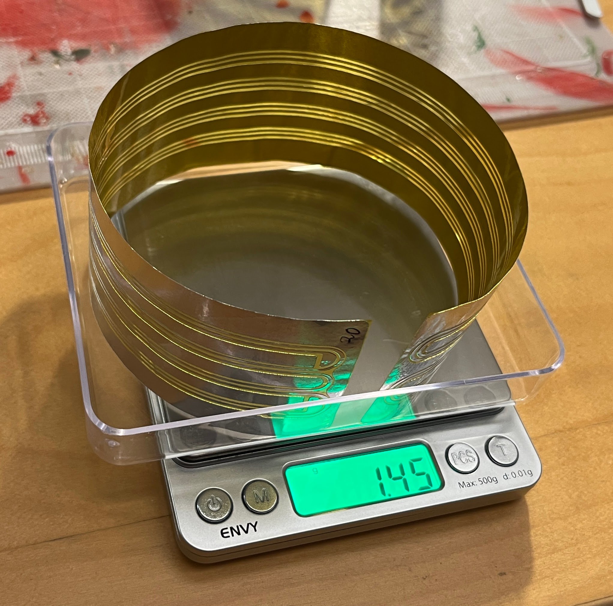

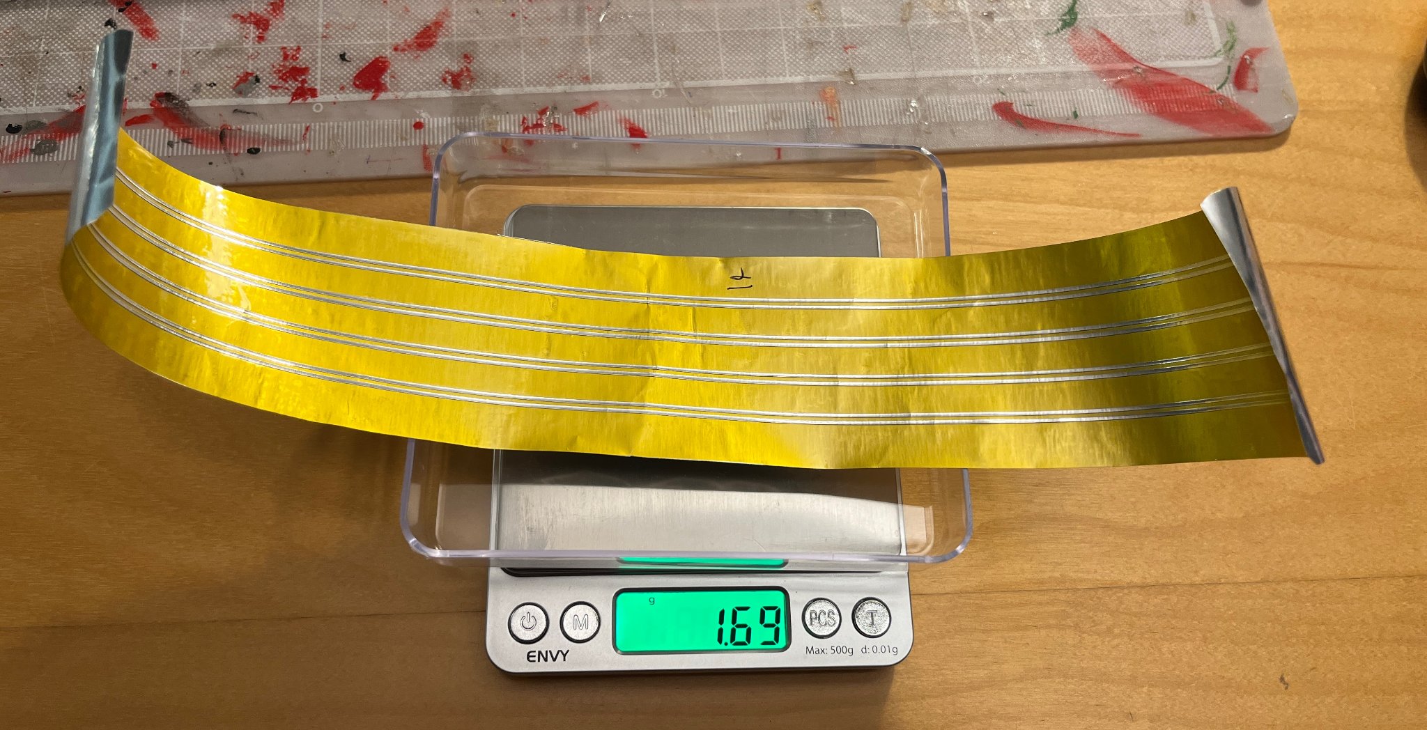

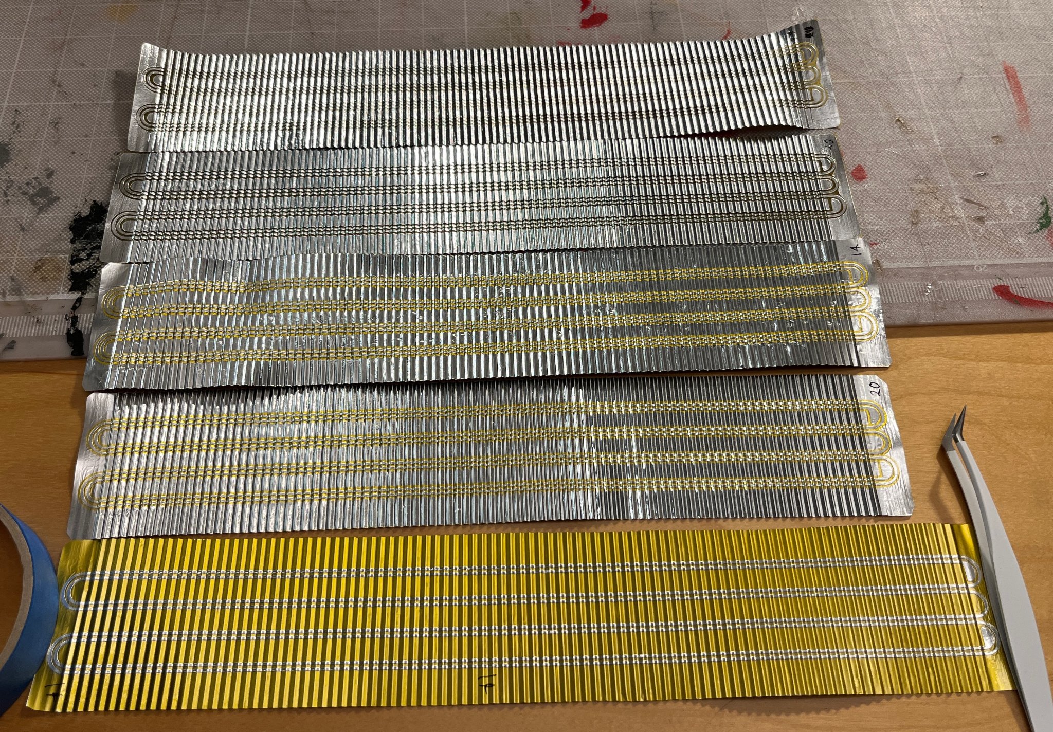

I have prepared some membranes from https://www.diyaudio.com/community/...o-be-used-in-a-dipole-cbt.412132/post-7885587, I will test them also during next weekend. All of the following membranes use 30 um self adhesive aluminum driven traces.
First conventional membrane with 14 um outer fill and gaps
Next conventional membrane with 20 um outer fill and gaps
Solid 14 um fill with driven traces on the rear. Heaviest of the bunch
Now the unconventional membranes. Solid 14 um aluminum fill but only kapton under the traces
And in 20 um alu
An interesting detail here is that the solid fill solid kapton does not corrugate as easily, they were all the same length before corrugating.

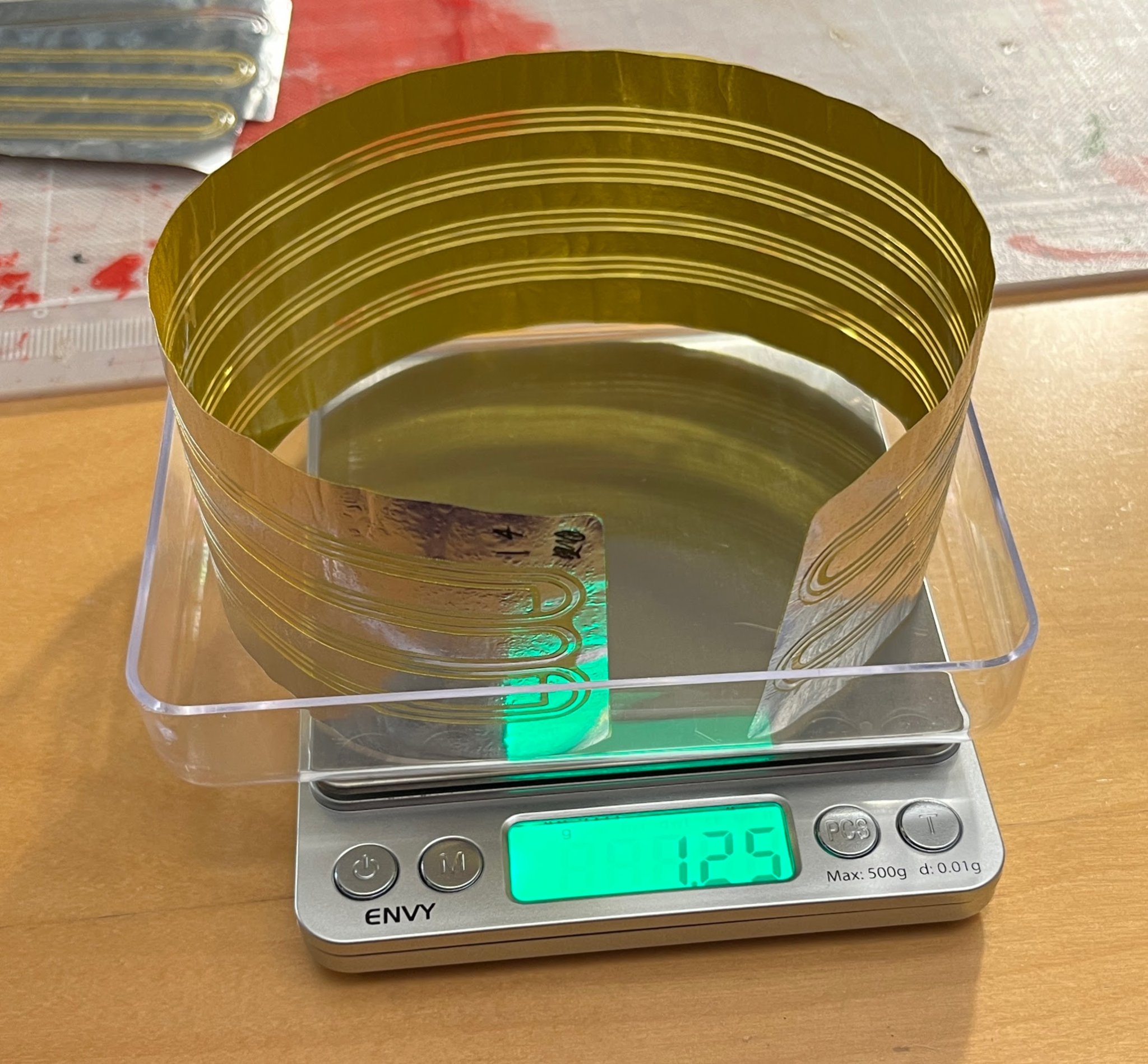

The new tape has the correct thickness! 51 um foil + 33 um adhesive times two = 168 um, which is within the margin of error of my measurement.
I might as well cut some membranes with it too such that when I measure, I can measure them all.

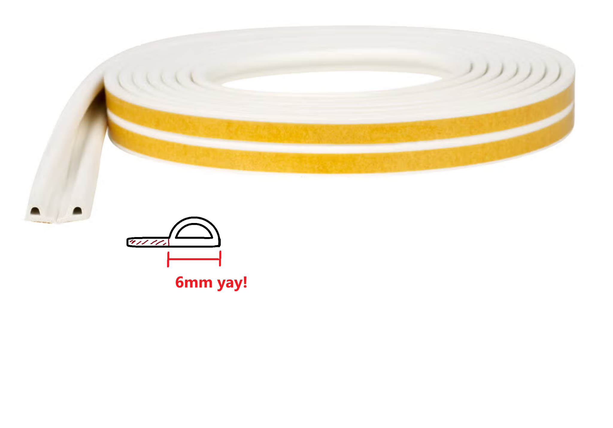

I also bougt some EPDM P shaped sealing profiles of the same type that @solhaga used. It is 9 mm wide with a P profile. When I cut away the flat part such that only the D is left, turns out the D is pretty much exactly 6 mm wide which is awesome because it is exactly the width I want, and it is very easy to cut consistently.
If this EPDM suspension turns out as good as solhaga found it to do, amazing! But even if it is comparable then the ease of manifacturing would be benefits enough for me to use it. Even better is that the adhesive does not cover all the way to the edge, so I think it would be very easy to apply with the adhesive without having to worry about catching the magnets with the adhesive and making it not lie flat, which was a problem with the foam strip suspension.
And since then I would not need the plastic edge parts to hold the suspension in place, I could simplify the design and not split it top and bottom but print in a solid piece.
That would also let me be clever and help solve a small problem: When I mount the membrane it doesn't always want to lie exactly in the middle, where I want it but is slightly biased to either side. With a solid edge I could add small cylindrical holes, just large enough to let me push in small T shaped profiles to help push the membrane to the middle and keep it there when tightening the screws. And then when all the screws are tightened then I just pull them out since they are not needed anymore.
