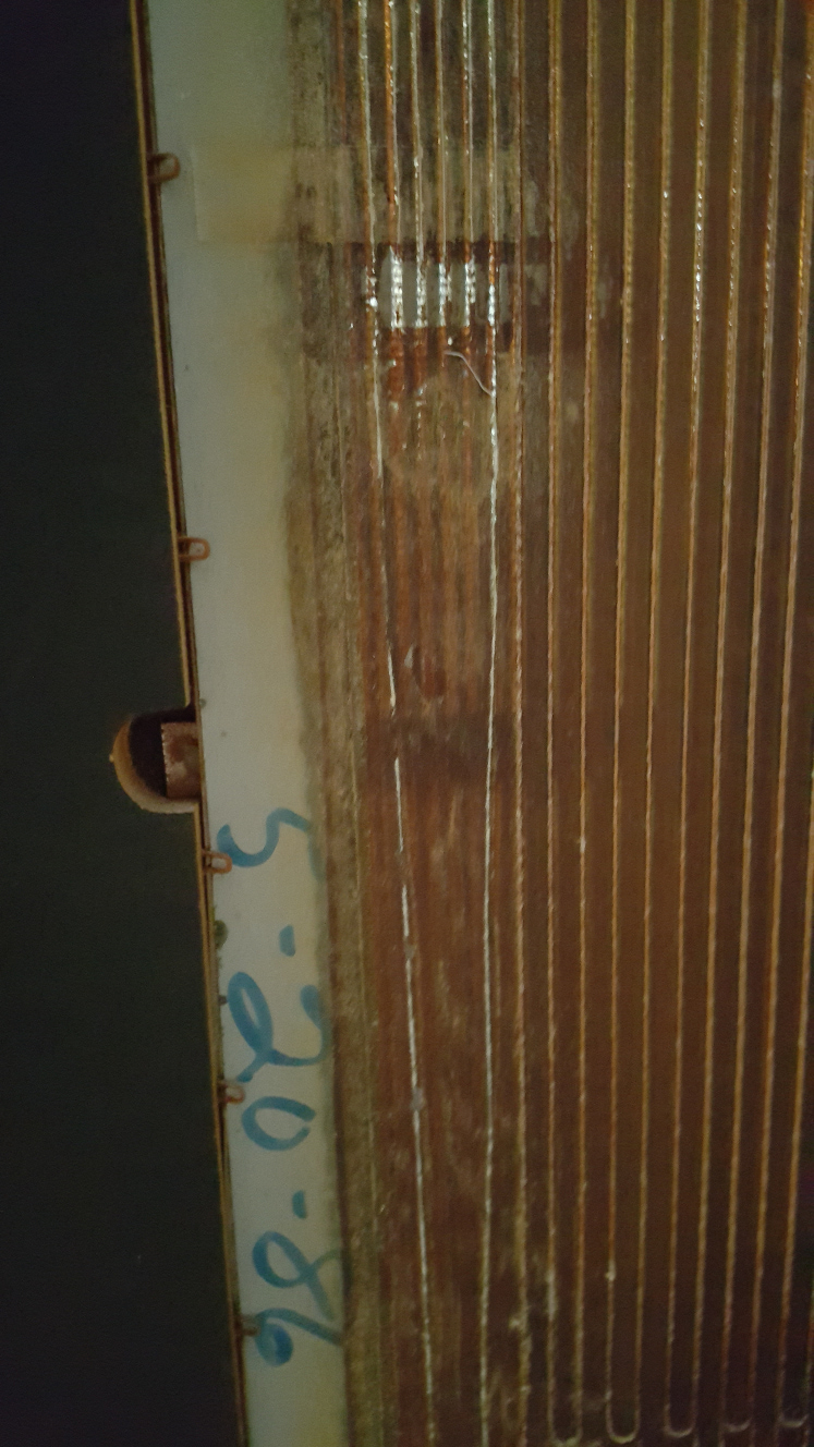

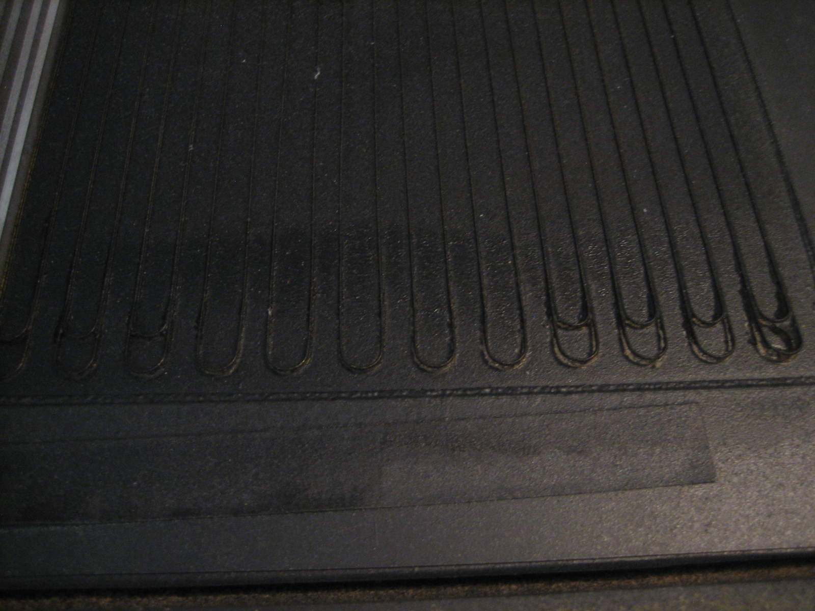

Quick question for you folks regarding wire replacement on these speakers.
I have a pair of SMG-b that I am just about to start on.
Why is it that some of the loops of wire are double loops whereas other loops are single wires?
And..
do the double loop of wire complicate laying down new wire when attempting the repair?
I'm assuming the SMG's and SMG-a's are the same in this regard as the SMG-b's that I am dealing about to repair.
The picture posted here shows what I am referring to.

Hi Curt,
The double loops are important for a couple of reasons. For a start, the total length of wire is important, to get the appropriate DC resistance of the "voice coil" if this changes, the load on the amp, and balance with the tweeter will not be per the design.
Secondly, the extra pass through the magnetic path will act to increase the drive on the diaphragm, achieving the specified sensitivity. This is all a careful balance that I'm sure Magnepan spent a lot of time working out empirically.
As to layup, it doesn't complicate things too much. Mark the vertical positions of the two sets of end loops before you start - a guide on the edge of the panel frame is really helpful here. Then choose a couple of round forms (pens, drill bits, wood dowels etc.) that match the curves needed at each turn, and use these to help form the bend as you lay out the wire. Be extra careful not to kink the wire, it is alumium, and very easily fatigued. Careful handling, though, will avoid trouble.
I first looked at this and thought "No way to tackle this without a jig" But it turns out that care with hand layout of the wires can provide excellent results if one takes time and care.

another thing to notice they do double loops near the side ways of the membrane, where the membane is more limited by the spacer/tension to get higher excursion out of these spots then normally would be possible.
making good pictures or draw layout is crucial as someone stated already , its verry easy to forget how the wires went🙂

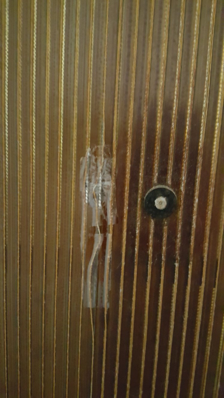

Glad I found this! I picked up a pair of MG IIc's that I'm getting ready to re-wire
Glad I found this! I just picked up a pair of MG IIc that need the treble sections re-wired. However, just to see what they sounded like I hooked them up. To my surprise they worked for the full range and really sounded pretty good!
I thought for sure I'd have an open circuit on at lease on of the treble panels, but I got a full spectrum response on a 20-20k sweep.
On closer inspection what looked to me like an open circuit had actually been a 'repair' job with some wire and scotch tape. 🙂
