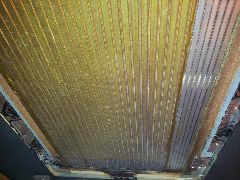

Hi everybody.
I own a pair of smga. Unfortunately the tweeter wires were not working, since they were corroded.
I stripped them of and I am searching for the appropriate 34 ga or 0.16mm aluminum wire. Unfortunately it seems very difficult to find the original wire in Europe and magnepan does not have an email to contact them (maybe I can try the phone). So I would like if anybody has any suggestions about where I can find such a wire in Europe.
P.S.
1) It seems that some people have tried aluminum foil. Does anybody know the what are the appropriate sizes for the aluminun foil tape?
2) Has anybody tried copper wire? Some people suggest the use of 36 ga or 0.13 mm for copper to get 3.7 Ohms resistance (and more weight also which is not good for the tweeter)
3) I prefer the mylar clean from this green sticky old adhesive Miloxane. I have some DAP to use with the new wire for a cleaner and more effective result.
4) In the future I plan to change also the bass/mid 22 ga wire. Has anybody tried copper with the same resistance? Will the added weight of the copper instead of the lighter aluminum drive the speakers lower than the 50Hz?

call magnepan for the wire, i tried sourcing alumnium wire for ages , and still nothing found. dont use dap just follow the procedure of magnepan if you want to be able to fix them again when somethign fails. copper is not an option to heavy. and foil is some debate about, it might drop efficiency by 3dB. your best bet is clean with aceton, order a repiar kit, or order the wire, get 3M super 77 and the 3m scotchweld 30NF, first use some of the super77 spray wait few minues laydown ur wire and then a verry thin layer of the 30nf. and ur done. in the kit is aluminium solder as well might come in handy to
I agree. I thought I was a wiz at finding things on the internet but the aluminum magnet wire eluded me. Oh, I could find it, but I'd have to buy 5,000 feet of it. Magnepan wants $50 for their kit: enough to do both speakers, etc. Not too bad. lol

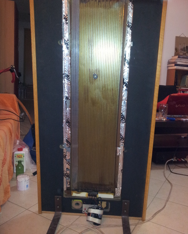

Well, I picked up a pair of SMGs yesterday. I bought them non-working, no treble from either panel. So on further inspection, it turns out that the treble wiring needed re-doing, but no evidence of peeling of the bass wiring. This pair are "red-brown" rather than the green and according to Peter Gunn, that fits with the presentation above.
I already had contact adhesive, 32g fine enamelled copper wire, acetone - all I needed was the replacement for milloxane, Scotchbond 30N. This can be quite hard to get, and not in stock anywhere (even was onto 3M directly).
A bit of further digging shows that 30N is a water based polychlorprene adhesive (neoprene glue). The big application for this adhesive is for gluing down cork and vinyl tiles. Sure enough a search on products shows a number of alternatives. I bought one from a local DIY store (B&Q for those this side of the pond) - a tub for €6.
The repair was easy enough, but only time will tell about the repair lasts. My main thing here was just to let people in Europe know about an alternative to scotchbond 30. Interestingly enough the contact adhesive (scotchbond 10) is much easier to find.

Magnepan used aluminum wire.
Some on the Plannar forum over at AA have had problems when replacing the aluminum wire with copper.
What kind of problems?
The component values used in any passive XO depend on the (nominal) impedance (basically, pure resistance, in the case of Maggie drivers) of the drivers. By using copper wire, you have ended up with much lower driver resistances than what Magnepan used to calculate the filter components values.
Hence your XO will no longer be rolling off at the same frequencies.
Andy
Ok. So an adjustment of the crossover could sort that out. What is the resistance of the original alu tweeter wire?
Bear in mind I gave €75 for the pair.... 🙂
Search for the crossover schematics on the Planar Forum (under "Tweaks" at the top of the page). This should give you the driver values.
There are 2 other "problems" you have introduced by deciding to use copper wire instead of getting a wire repair kit from Magnepan:
1. The resulting speaker impedance will be lower than stock. 4 ohms is the nominal value and some amps have difficulty coping with that! I would suspect you are down, now, to about 2.5 ohms - which is a much more difficult load.
2. Copper wire is heavier than aluminium wire - so you have increased driver mass. I would expect your Maggies sound slower than stock.
Andy
Its actually hard enough to find a measurement for the tweeter wire. Assuming that the layout is the same as the SMGa then the target value for the tweeter is 4R. Measuring mine with the copper I get 3r8 on one and 3r7 on the other. Some DMMs aren't brilliant at measuring low resistances, but it should be pretty close.
They sound good, not at all sharp or dull either. The probably don't have the refinement of a well maintained set of quads, but nevertheless, I'm impressed with them.

I will post what my understanding of the driver resistances is, when I get home from work in about 9 hours. I'm pretty sure, though, that the drivers (and thus the driver resistances) are the same throught the SMG range - only the XO values changed.
Remember, you need to subtract from your values of 3.7ohm/3.8ohm, the reading you get when you short the meter leads together. On my multi-meter, this is 0.6ohm.
