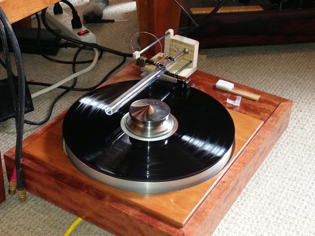

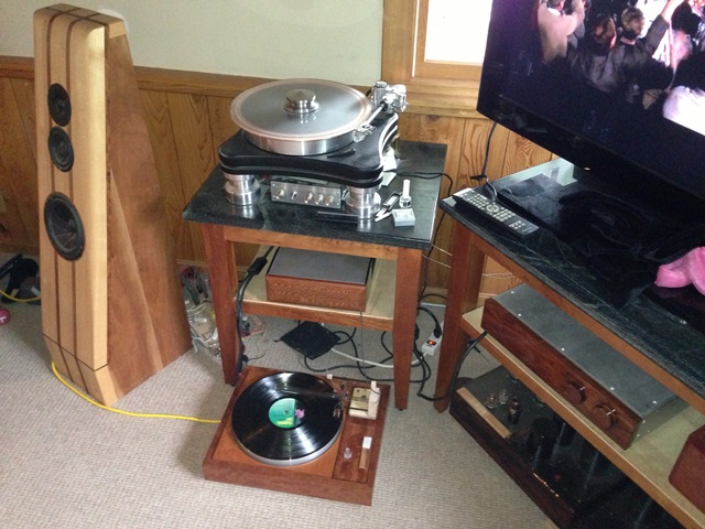

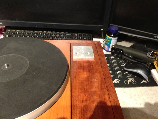

Here are the final assembly photos and some pictures of it running. The base plate fits in the "standard" location for a normal tonearm. The arm is then bolted to it. This give 3axis of adjustment to final align it. I did not instal a cue arm as I felt it is just too simple to lift it manually. The head amp is a Salas simple JFET with 58dB gain. My Phenix has never sounded better. Prior to this arm it had a Magnapan Unitrac I. Included is a photo of the jig I used to set the arm up with.
Impression:
It is a very detailed and quick sounding arm. Bass is strong and VERY tight. This set-up will make your eyes blink with a rim shot. Presently it is running the Denon103r cartridge on my Phoenix turntable. In the last photo is the competition. A Black Onyx/Triplaner VII/Lyra Kleous. This is a new 103r so before I do some serious listening impressions it needs to break in.
FYI, This was built with a 16mm heavy wall tube not the 10mm. No tracking problems, however I did adjust for the size with the bearing spacing. I will cut back the tube and pack it with sand soon. (maybe coffee creamer since the ends are to be sealed.

take it back..further investigation has found the sound is getting transmitted to the needle through the platter, not the arm assembly...The platter is a bell!..Bear is right it needs dampening
Nice build SGregory, that is the first thing I noticed once built up was its speed and phenomenal PRAT. I noticed a few threads back concerning antiskating, and riding a groove wall more. I have not noticed any of this and also at the same time there is not just a side force but a pulling force forward in the groove/stylus relationship, it's this pull forward that creates the side force in a pivoted arm since the headshell is offset towards the spindle. A linear arm is not advancing through a simple side force, it's a combination of the groove advancing and the forward pull which in 90 degrees to the horizontal movement causes no skating force. Muddy is the furthest from the sound of this arm, as those who have built it can attest to, it revels in detail and deep tight bass.

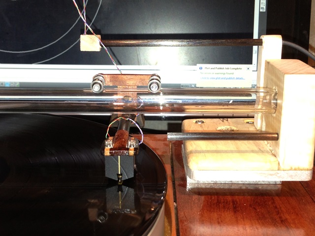

Hi S; what type of tubing is that - what is it sold as/for? And it looks as if you've simply made it an interference fit in the wood block - is that right?
Cheers
Stuey
Stuey,
The tubing is 16mm Borosilicate glass(pyrex). Obtained it from a glass blower, but I did see some forsale on EPay a while back. It is an interference fit with the wood block. Used a 5/8 forstner bit to drill the hole and then ran a coil of fine sandpaper through it to get sizing just right. In fact all of the tubing is press fit, including the CF tubes. The wood I used is hard curly maple, ebony, and bubinga, which are pretty stable.

I was looking at the photos of the arm from above and had some thoughts.
Just some random thoughts though... I have only been reading about that thing for a couple of days.
Since it is kind of an objective to get the arm to get lower mass, could it work to move the triangle thingy on the front of the glass tube?
That would move the balance point closer to the cartridge, so the axle that holds it can be shorter. This will also mean that we would need a smaller weight on the back for the VTF.
That reduced length could also eliminate any lever effects we could be facing because of the length of the cartridge's axle.
The pivot point is the center of the tubing in either design. Meaning that with the triangle thingy in front you would need more mass to balance it.
Hmmm I forgot the mass of the triangle which is a bit more significant by being further away from the pivot. It actually works nicely there reducing the required weight on the back. Actually, if the bearing axles were super light, we could probably minimize the back weight by pulling the triangle further to the back.
dimkasta, You are right regarding moving the triangle back to reduce weight. I think the limit becomes the rigidity of materials used, ability to adjust VTF for different cartridges and the cue process.

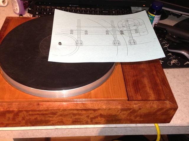

There is enough info in the thread to make it. In my case I drew it up for my system based on the info and then built it. This build doesn't take very long, meaning don't over think it the first time. I will let V.A. post the dimensions if he wants to.
Dimkasta,
Imho the most important part of the build is carriage mass and bearing arrangement. There have been some accidental benefits with this arrangement that came to light as the design went in which is mentioned.in the thread. Materials being such a short arm and as long as they are light but rigid seem to have minimal impact on the overall sound, but subtle impact in finer points. Carbon fiber seems to my ears to be reigning champ however. Also for the glass tube system, the goal here is also rigidity with adjustment, but keep it simple so that it doesnt become a symphony of resonances.
