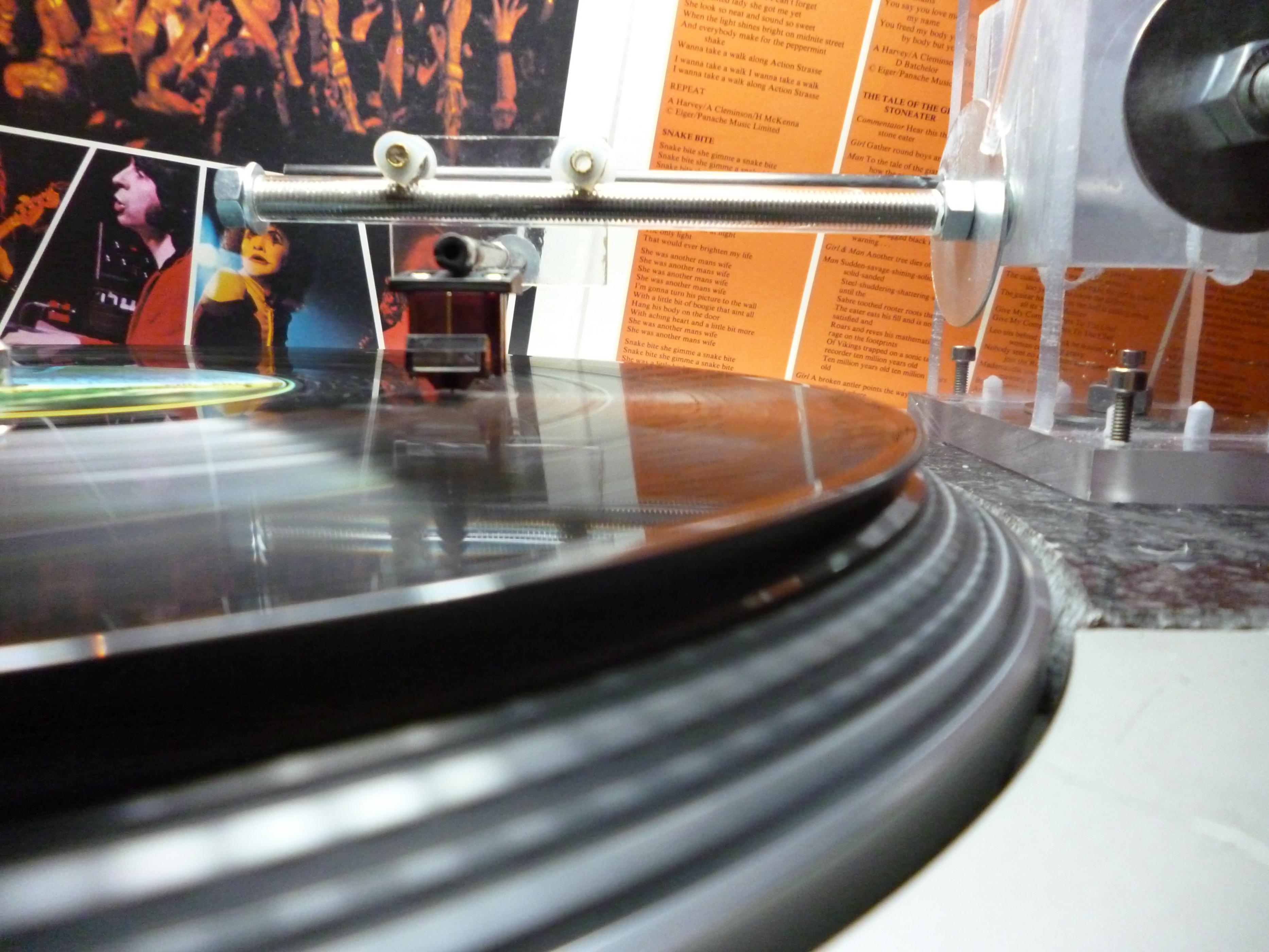

generic glass tubing can be found in plumbing supply stores - it is used in gauges on old school hot water boilers. Perhaps not the ideal tubing, but it is glass and tubing. Thinwall though... maybe not suitable?
I used 10mm Pyrex (borosilicate) tubing from a small laboratory glass blower. He doesn't generally do retail materials supply but if I could come to his shop I could pick up the small piece I wanted. So I did. The actual tubing is very nice. Looking through it (sideways not down the bore) and rotating it while looking at some printed material there was no discernible optical distortion in the image. Tells me is pretty accurately made and finished tube. I doubt that old school Gage tube would be this well done and maybe softer glass than the borosilicate. I would try to find the good stuff in your area. Good Luck,

Yes, Pyrex and borosilicate are one and the same, even kimax. Do not use standard glass, easy to scratch. Quartz is used in lab work only to withstand higher temperatures and looks good in ad literature. I would have done a materials list but my arm design has changed so much and it's latest iteration is the definitive of all prior of my changes, ive given the details in the rest of the thread that will give a very satisfying tonearm and enough to provide many future arguments over theoretical opinions 🙂. One addition I've noticed with this arm is that vinyl I own that has had prominent surface noise seems to be much lower than with the pivoted arms Ive owned, and this is with the same stylus profile.

How do you cut a slot in the glass tube ? Apologies if this question has already been asked and answered, but it's a long thread and I may have missed that information

I have some of the 10mm dia.tube if its any good to you.
(Siddley) No slot in the tube for this design. The bearings ride on top of the tube, not inside

I found some enamelled hair thin wire in an inductor choke in a abandoned lcd tv in an alley. Changed over. Glued the arm into the block ,shortened the wand to 2.5 inches from 3 inches and glued the screw rod into the glass rod with silicon...much much better sound. This arm does have bass

cut glass tube with diamond saw and coolant (water is ok).

For tube.size I found 10mm to be the best. Remember the larger the.tube the lower the arm hangs below the ideal pivot axis. There are a couple of spacing tips to reduce errors immensely on the carriage, the first being try to use no larger than 10mm for the tube.

Lateral load on stylus?
I experimented in the "old" days with two different Rabco linear arms. One was mechanical advance and the other was motor driven (Rube Goldberg would have been proud of this one 🙄).
As with the Rabco and with your design, my main concern was the amount of lateral force required to advance the cartridge.
Your design obviously requires the needle to be pressed against the right wall of the groove before the arm advances the carriage. This means the total weight of the arm and the force required to start to move the bearings has to be advanced purely by the pressure against the needle (of course this is true with a conventional pivoting arm as well).
Have you ever measured this required force? I imagine this may place an excessive wear on the left wall of the vinyl and diamond tip.

Probably the reason of the slightly sloped tube. sliding downhill towards the center of the record. It was talked about earlier. Though I don't think some grasped the picture. This might be called "auto-advance" for lack of anything better.

so what do you think moves a pivoted arm across the record surface? I always figured they were much the same except that pivoted arms will cause more damage since they are never even close to lined up straight. Best regards Moray James.

Not really true. The pivoted arms also have anti-skating control, which basically minimize those forces.
Although the matter is a bit more complex. There is the force driving the arm to follow the groove, and there is a force pulling the arm towards the center of the turntable.
I guess a slightly variable angle to the glass rod could provide some similar control for this project, and fine tuning could be better achieved with a test record, like with any other tonearm
The problem is that the rod's angle would also alter the azimouth... hmmm... Perhaps some sort of spring then?
