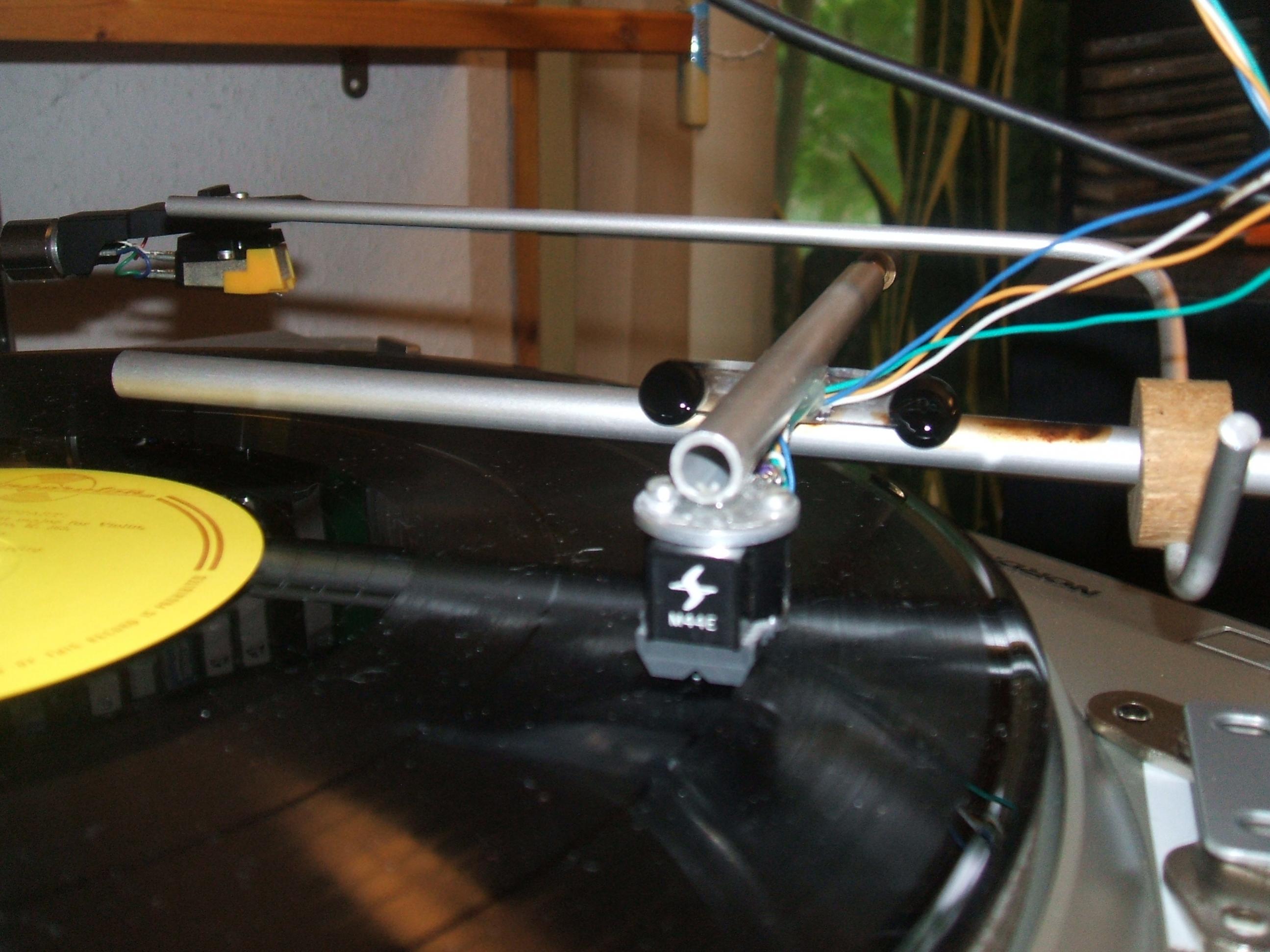

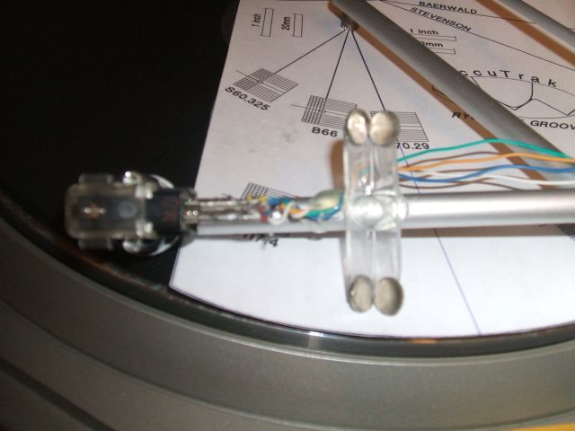

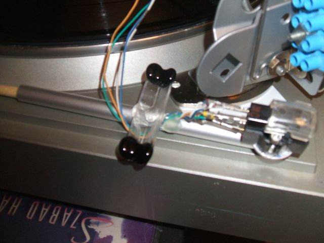

Tonearm gliding on ferrofluid
Since I have an aversion to ball bearings I made thoughts on how I could make without them. The idea was a cushion of ferrofluid on which the tonearm can glide and which is held in place by four magnets.
I built a proof of concept. On the first picture you can see the four magnets (sorry for the poor focus).
On the second picture the magnets are wetted by the ferrofluid.
The tonearm worked as devised. I could write about ink dark silence and opening up of the soundstage, but I am not a subjectionist.
I can make no statements on long term stability. The ferrofluid must be of high quality, not the kind which evaporates fast. Those sold for educational or entertainment porposes do not qualify, only the type which is used in speaker coils.
I suppose the magnets dampen effectively any vibrations in the horizontal plane through the eddy currents induced in the aluminium wand.
The magnets hold the ferrofluid on the four corners of the tonearm slide.
I do not quite grasp what you mean by flat pucks - if you mean the magnets, yes, they are simple disks.
oh, so your magnets hold the ferrofluid to themselves and then slide??
How long before the ferrofluid slides off and/or gets spread across the rod?
Are you able to adjust VTA.? looks pretty high to me .....![]()
That is not my tonearm. I just posted links found on the internet. But you can contact the Flickr member or post question on the comments section. I agree with you that the VTA does appear to be too high.

A very small amount of the ferrofluid gets spread on the rod, the bulk of it remains around the magnets.
From the picture it looks like you use aluminium.
As aluminium are paramagnetic some of the ferrofluid will stick to the surface..
Why not use a diamagnetic material?
Good idea! It was just a proof of concept I built with was at hand.
a liquid bearing works yes but it goes against the whole purpose of Bo's design which is to make the are as rigid as possible, this design permits motion in all planes. Motion of the arm equals loss of information. Best regards Moray James.
